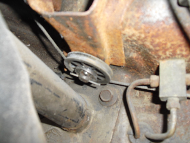

The cable looks new under the dash, and the only pulley I see already has a cable on it. I assume clutch. Does anyone have a picture of what its supposed to look like under the dash concerning routing of the parking brake cable?

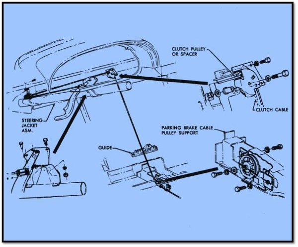

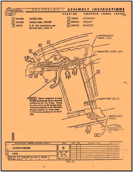

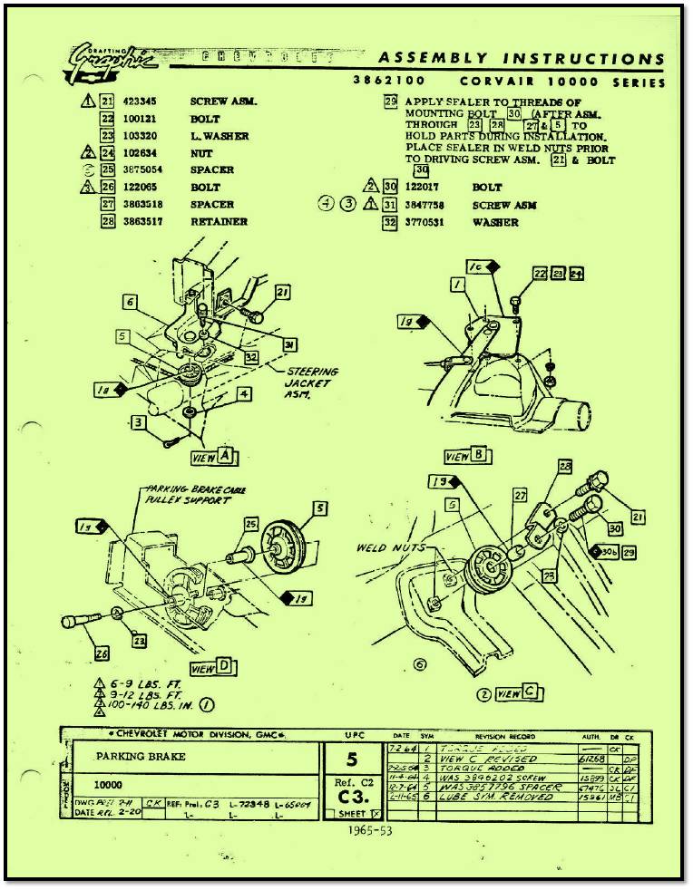

Here are some parking brake cable illustrations from the 1965 Corvair Assembly Manual - BRAKES (Copy Attached). The EM Corvair brake cable assembly is very similar.
Left-click each image with your mouse to enlarge for improved viewing...
I have also attached copies of extracts from the 1961 Corvair Shop Manual and 1962-63 and 1964 Supplements. This illustration is from the 1961 Shop Manual...
