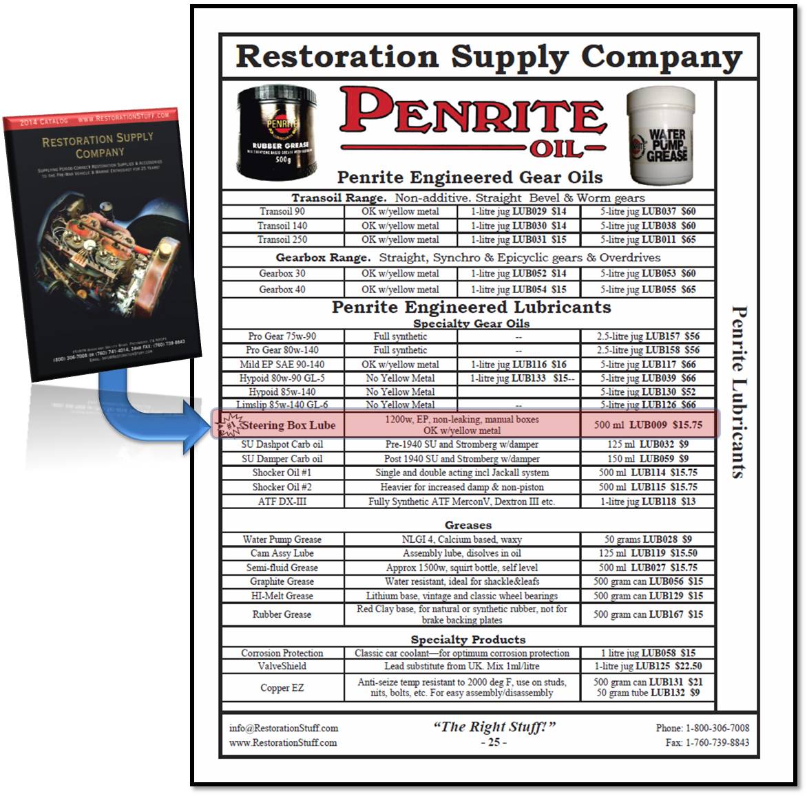

Here is some supplemental information that may be useful...
Nate Wolfe wrote:This is what I use and it works rather well and doesn't leak out. Only problem is it's hard to find. The only place in the U.S. I know of that sells it is restoration supply.
http://www.penriteoil.com.au/products.p ... roducts=90
Penrite appears to be an Australian company that primarily distributes its products in Australia, New Zealand, and the United Kingdom. I checked Amazon.com for Penrite Steering Box Lube. Although it was not a product listed in their huge inventory, there were a couple of alternatives...

ImageI did find a U.S. listing that carries the PENRITE product...
Restoration Supply in California stocks it. Their part number is #LUB009 and they sell the 500ml tubes for $15.75.
:link: http://www.restorationstuff.com
Restoration Supply Company
15182-B Highland Valley Rd.
Escondido, CA 92025
(800) 306-7008
The entire catalog in Adobe Reader format is too large to upload on the Corvair Forum website, but can be downloaded from the Restoration Supply Company website. I have extracted the appropriate page from the catalog and uploaded it here. The Penrite steering box lube is listed on page 25 (Adobe Reader page 27) of the catalog...
