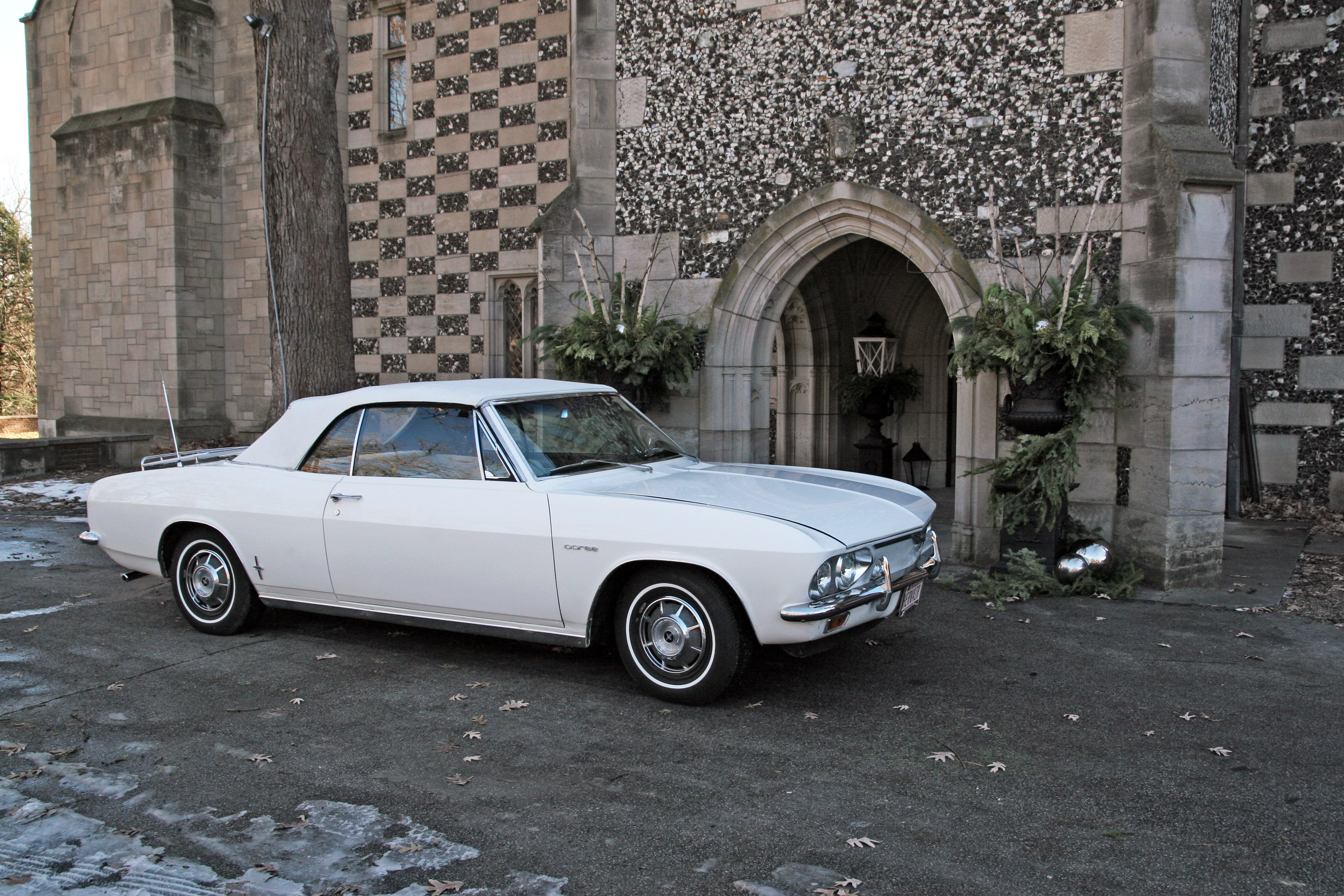

Dreaming of a white Christmas
A decent interior, but a little tired....

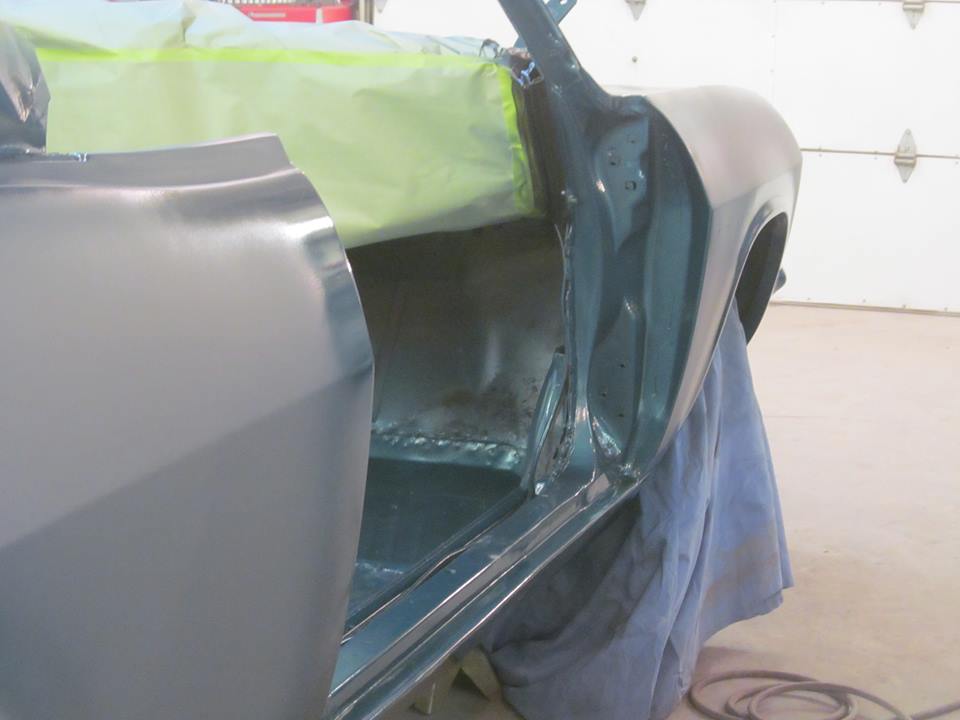

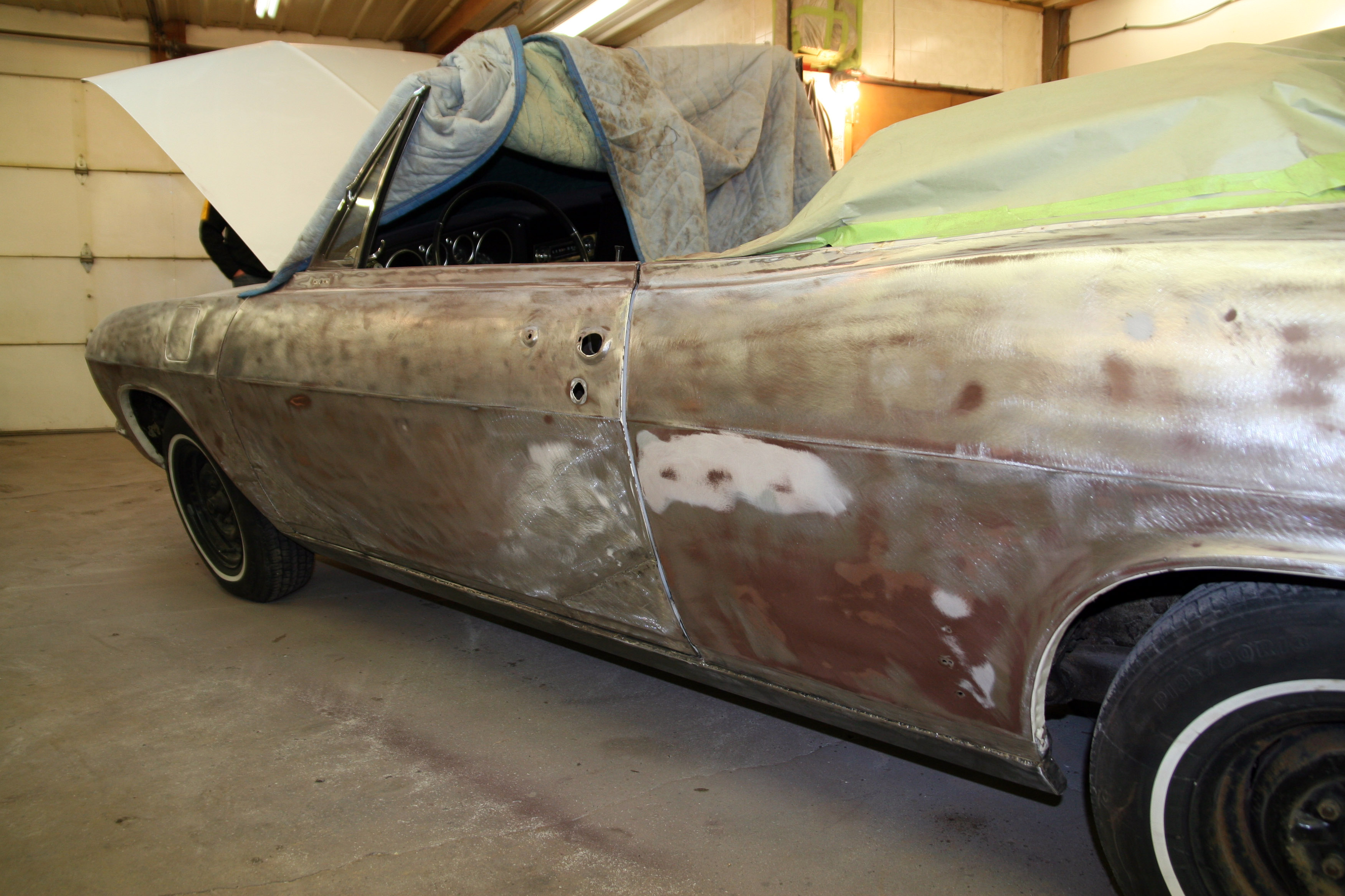

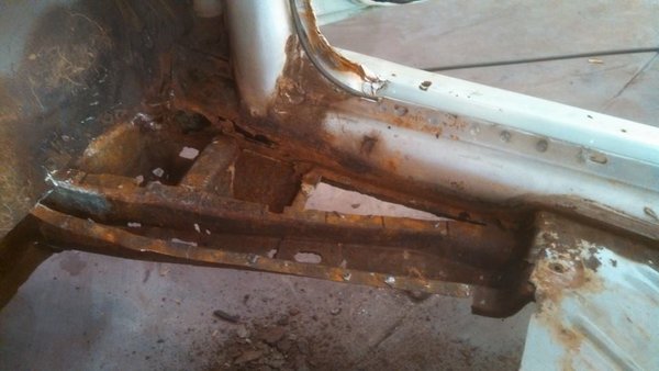

Certain things lead you to believe the low miles but of course anything is possible, all depends on how it was stored and used the last 48 years. At some point it was just a car, then just an old car. Driving needs were different then. When we say restored in this case I would imagine likely an original owner had an unhealthy body condition 'parade restored' meaning cleaned up on the exterior to make it presentable for occasional events and Sunday drives. There was lots of excavated rust even though it was coated heavily with cosmoline. These are some of the rusty areas that were repaired underneath. These are just a couple of pics uncovering structural areas, the strut in this pic was later fabricated, replaced....

Lets not start an Early vs Late thread since I am not so sure about that, perhaps just different areas rust. Kind of like different parts of the country have rust in different places than others. This shown area is usually affected by a plugged drain area, rocker, vent area, and bad/weak weatherstrips. People have different ideas of how rusty something is (always opinion based). This is near what I consider terminal, yet still fixable with new steel and modern rust products. Then again some think a light 'browning' and a couple perforations terminal and nothing can be done. Stuffing a rust hole with bondo or foam is not a fix in a critical area.

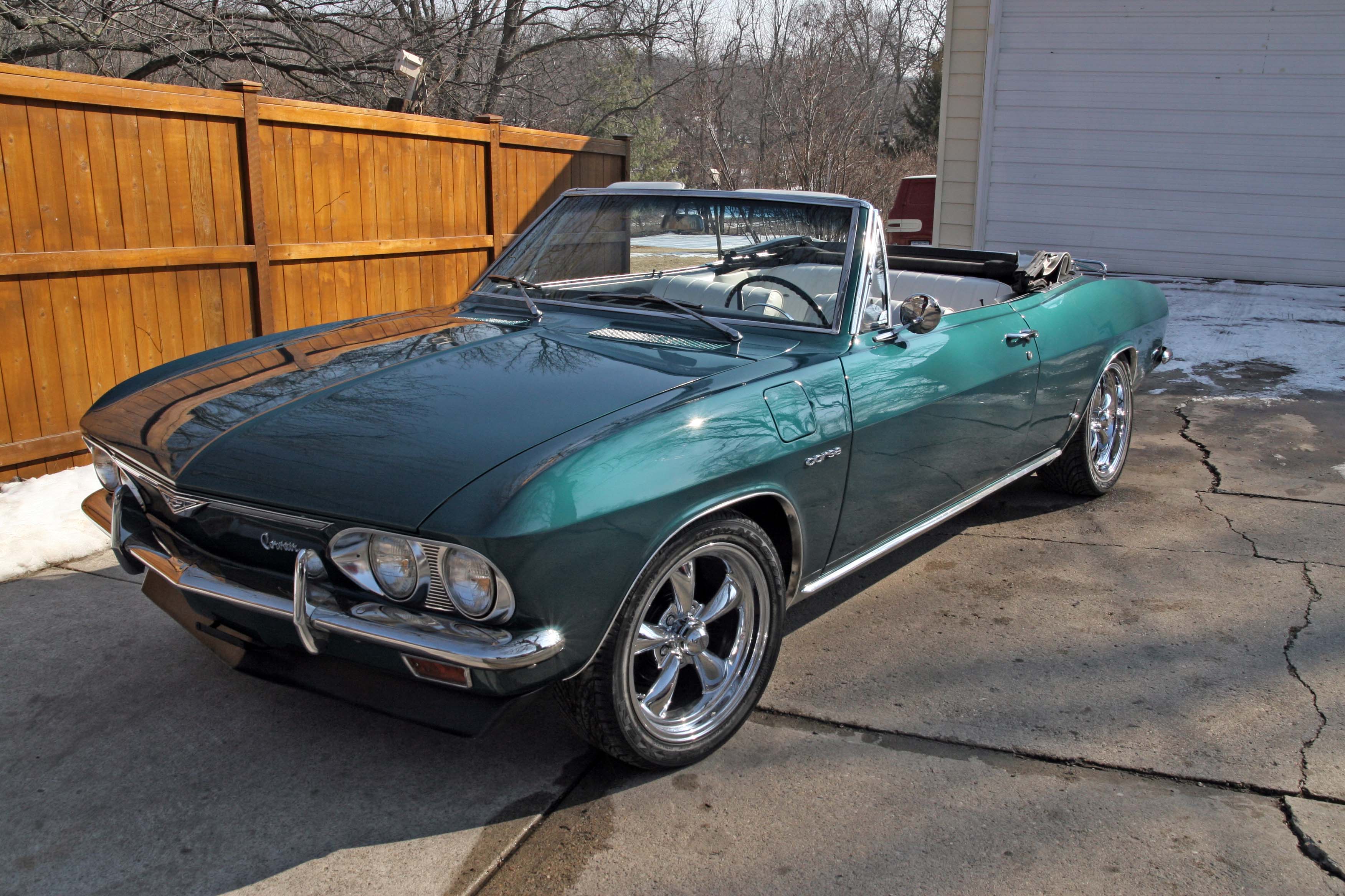

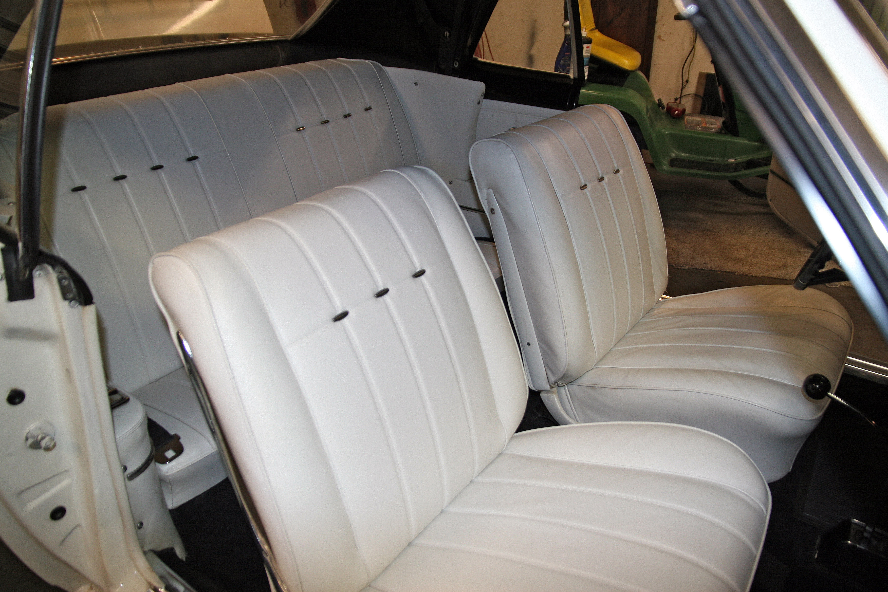

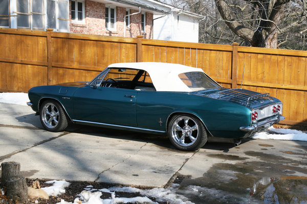

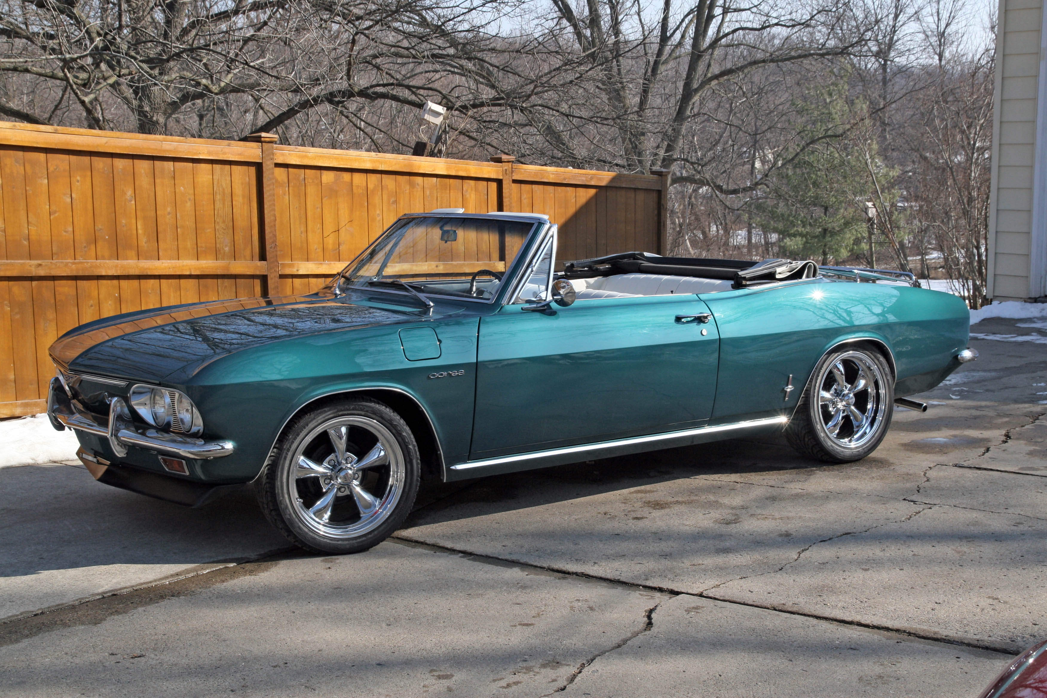

Ok, it's reveal day. Prepared a fun little video.... we took some video covering the car and after the work was finished, we pulled it off to reveal the new color. Fun. Not sure this format supports that, but if you're out on facebook you can probably find it.
Tropic Turquoise!~
Love the color and of course, you're never done with a car, but we're happy. Will join the Artesian Turquoise 65 Corsa coupe in the St Patty's parade a week from Monday!
Happy Trails, stay tuned for the next project. There are a couple more on the agenda.....

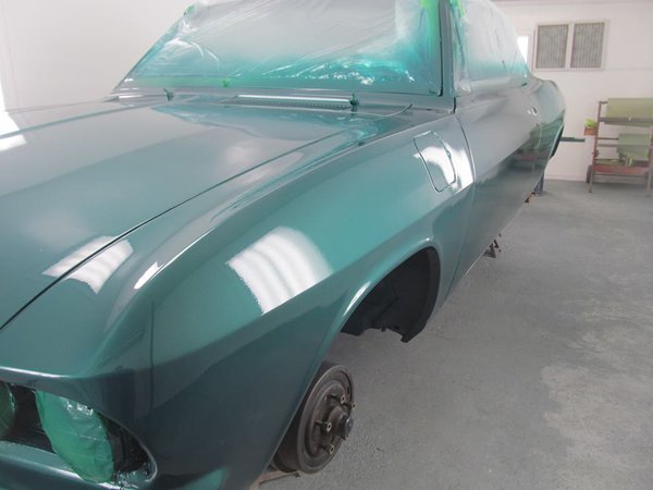

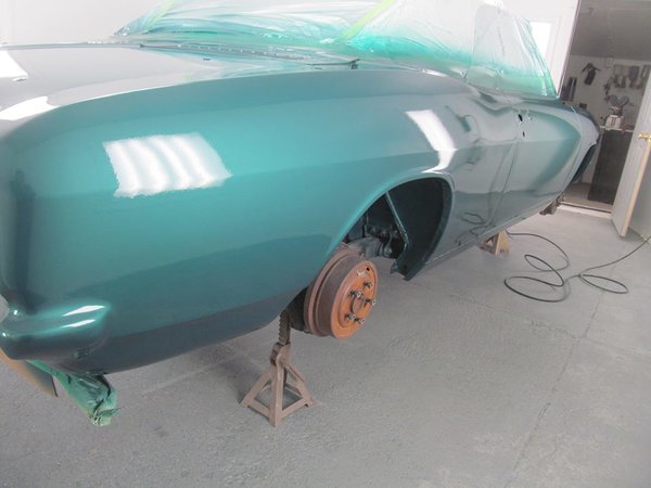

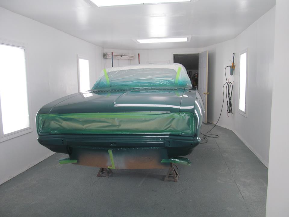

SSVairNut
Posts: 15
Joined: Tue Mar 04, 2014 3:26 am
Re: 1966 Corsa Convertible Transformation
Post by SSVairNut »

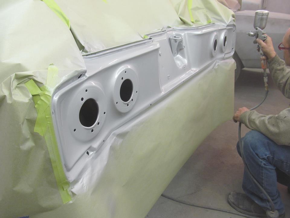

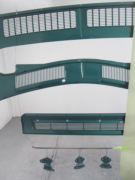

A few pics during paint process
