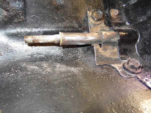

Hi, I'm having issues with the Accelerator Pedal also. Anybody have pictures of the Accelerator Pedal install? I'm having problems figuring out where the carpet goes. The pedal goes thru the carpet, but what about the two tabs in the back that attach to the pedal to the linkage? I presume the carpet goes over the two tabs? Any hints would be appreciated. I'm attaching a couple of pics

Ok, I have installed the carpet. Question about the rubber tab at the bottom of the accelerator pedal. Does it go on top of the carpet or does the carpet cover it? See the first pic above. It is the tab sticking out to the right.
