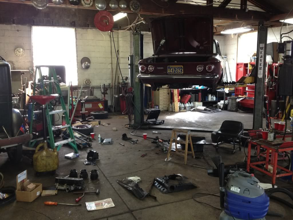

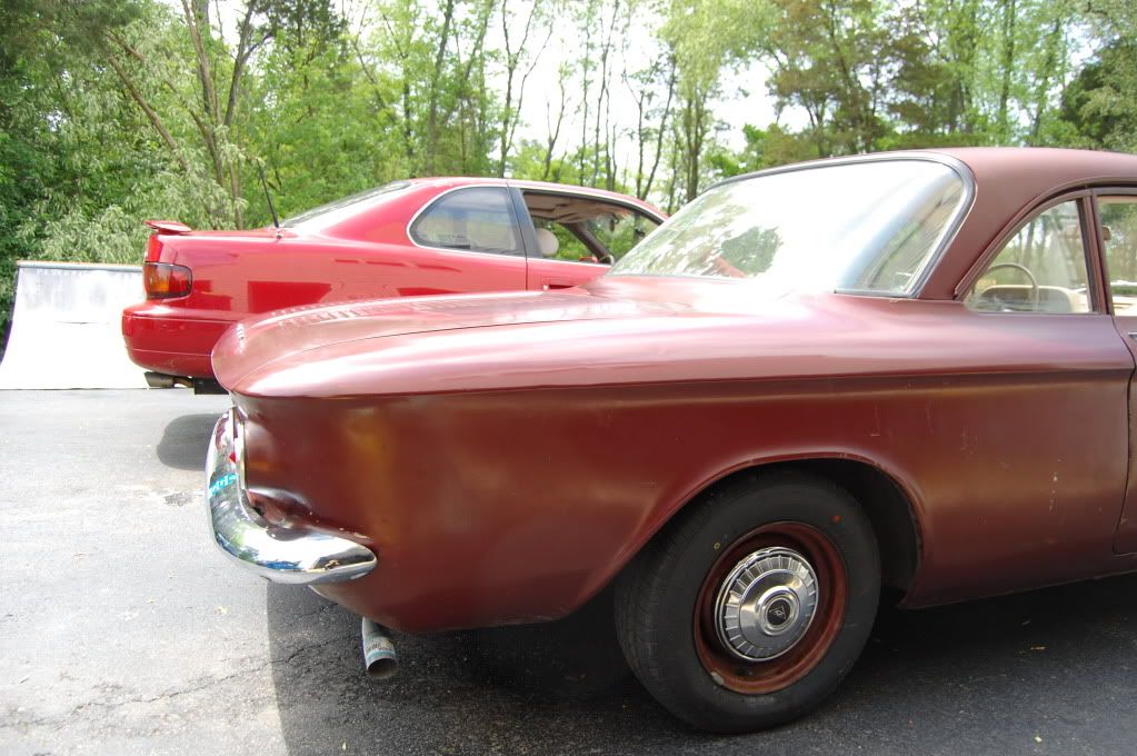

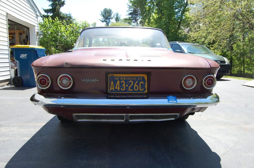

got this 64 corvair 500 from my boss, paid 1500, runs and drives. im cleaning it up and then going to just drive and enjoy it. now for the pics
as recieved
owners manual, accessories brochure, and an unused maintenance manual
83,000 miles on it
bad spot, will be repaired
an older repair
started the cleaning process
got new tires
more cleaning

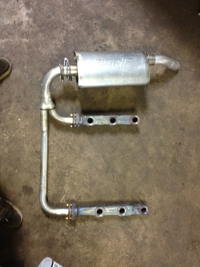

and i got a completely new exhaust, manifolds, y pipe and i used a borla muffler, and this cheap 90 degree bend to reduce noise and interior drones

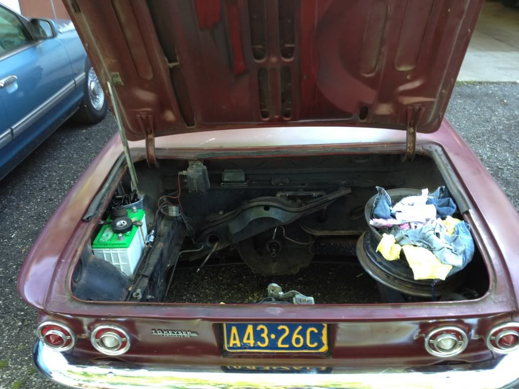

Post by fjp912 »
What a great find! You see so few of the 500's around, especially with a well preserved interior like that. I'm amazed at how well the paint is cleaning up.
One suggestion I would make is get yourself a proper battery hold-down ASAP. An unsecured battery will move around and if the positive terminal shorts out or arcs to any grounded metal it can start a fire. Clark's suggests for newer style batteries like yours that you use a 1960 style top piece (I think). I am using that in my '64 Monza and it works well.

Post by freedo »
already got a new batter in it, and a hold down in, that battery was temporary to just get it running

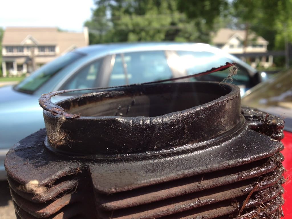

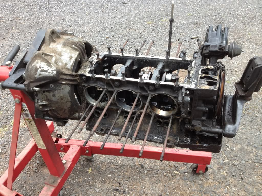

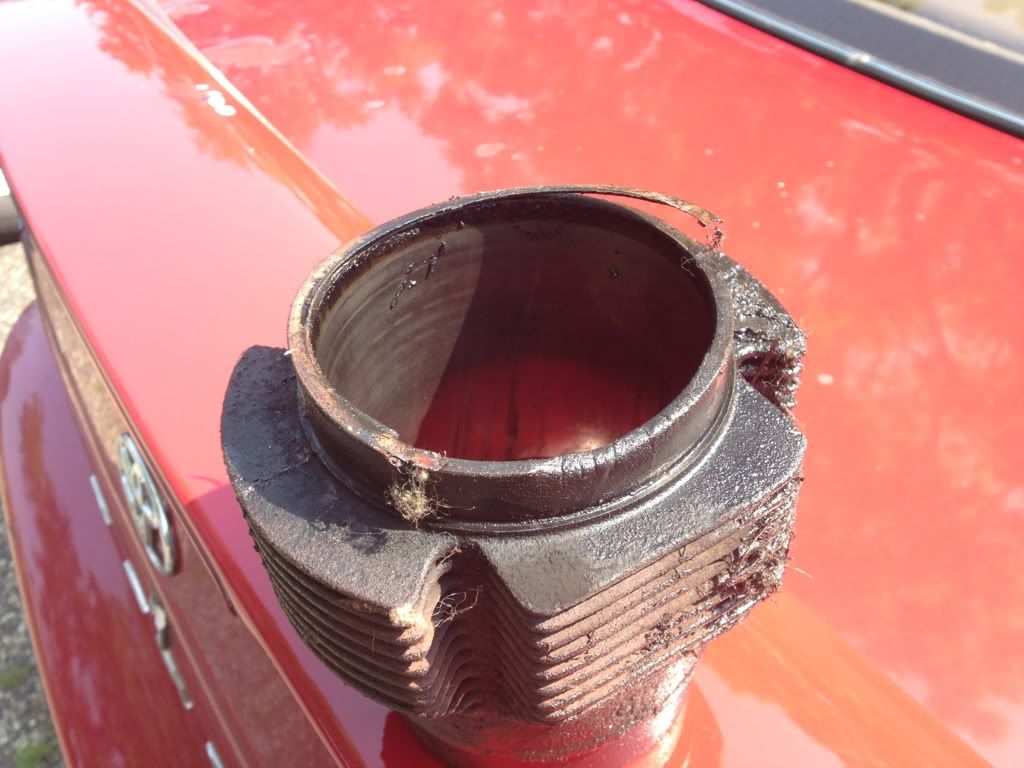

oh no!

Post by fjp912 »
That last pic looks a bit scary. What happened to that cylinder?

Post by freedo »
gasket blew, slowy started eating away the cylinder

Post by freedo »
new pistons, rings, and cylinder are on the way

Post by fjp912 »
How did you know that was happening, i.e. how did the engine behave?

Post by freedo »
well this was the first time i drove a corvair so if there was lack of power, then i wasnt aware of it, after i replaced the whole exhaust system, it still sounded like a serious exhaust leak so my boss suggested it was a head gasket

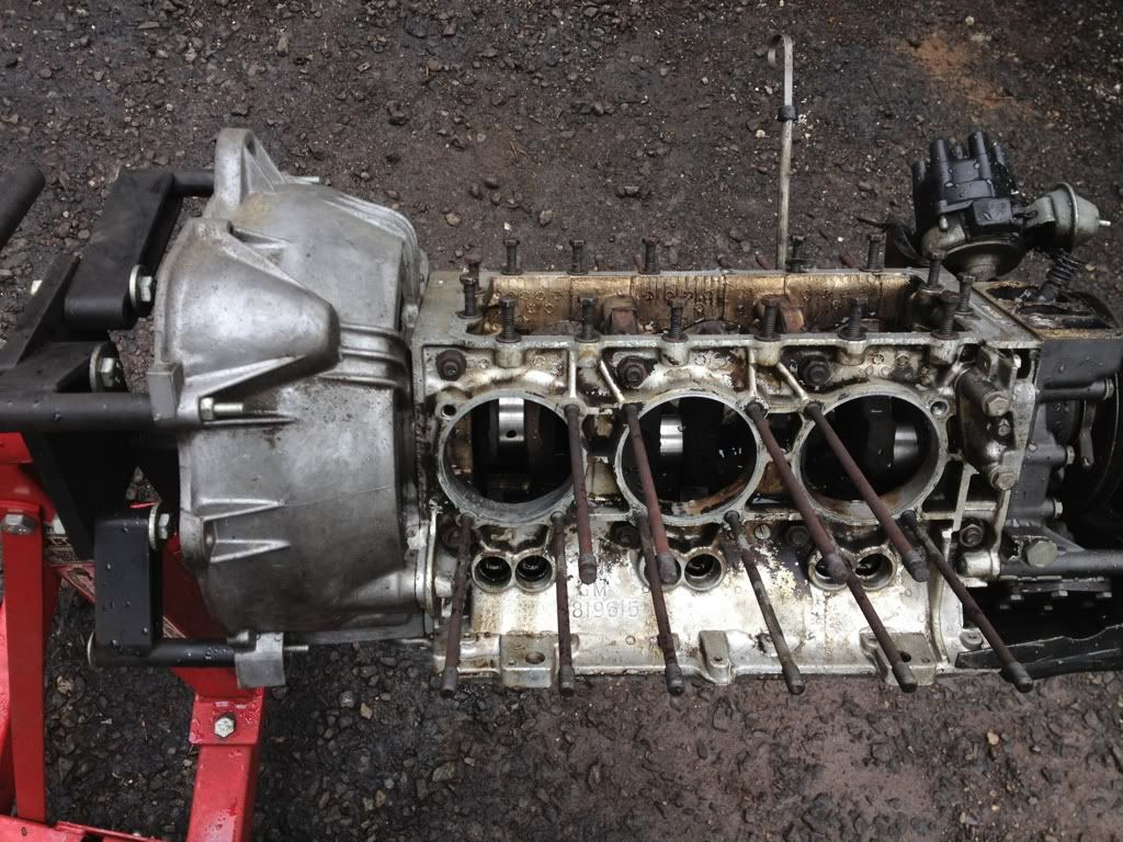

Post by freedo »

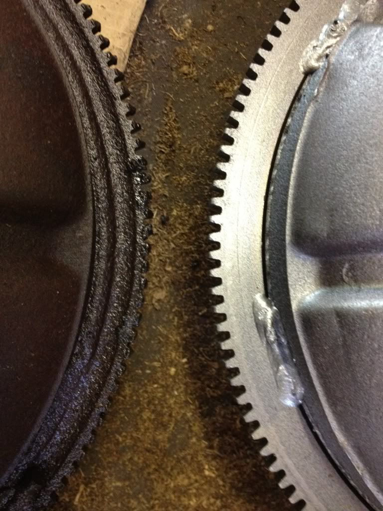

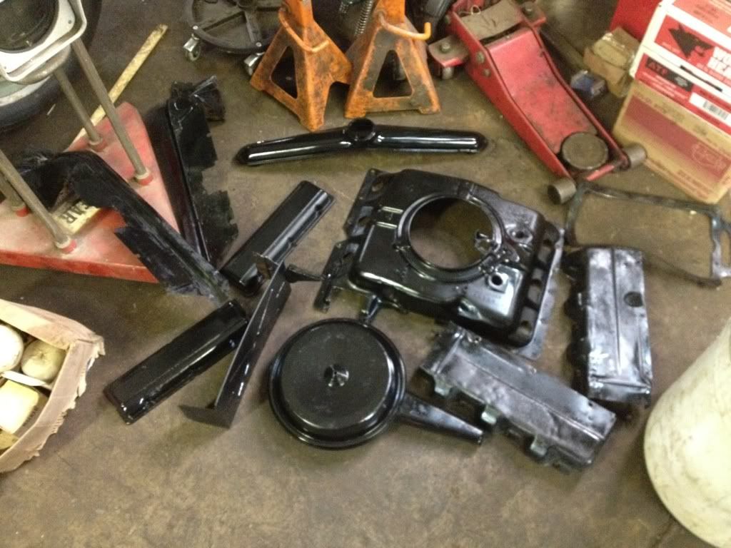

engines out, parts painted, engine cleaned, rebuilt torque converter, added new exhaust tip
Gregory_Miller
Posts: 921
Re: 64 corvair
Post by Gregory_Miller »
Not much left of the teeth on that TC. Looking good, bet it will run a LOT better soon.
