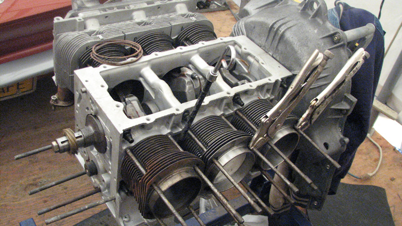

As far as I know 94mm is the largest cylinder that will fit.
Beyond that you could use a stroker crank for even more displacement.
I've been toying with the idea of a stroked big bore for about 3.6 liters.

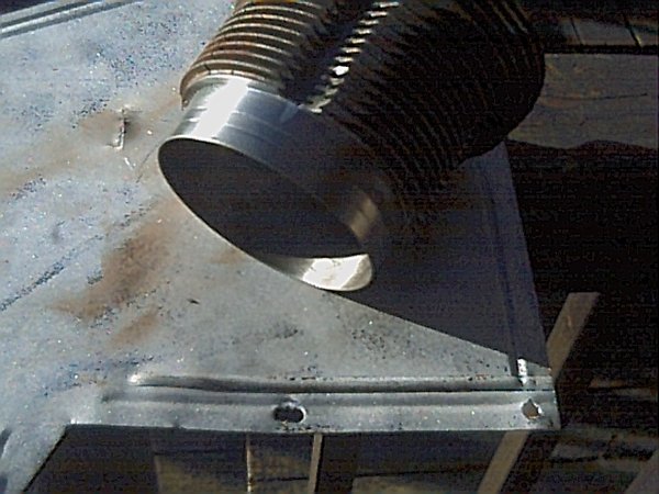

If you want true big bore power, contact LN Engineering: http://www.lnengineering.com/type1.html
If you give them enough money, I'm sure they can make you a set of billet aluminum cylinders at 104mm or so. There are very good reasons for having aluminum cylinders, main one being that beyond a certain size the iron ones just don't cool well enough. I put a set of 103mm jugs in my Type 4 Porsche engine, but that's as big as I dare go for the sake of reliability. The cylinders touch each other at just about every point, and there's next to no meat left in the case.

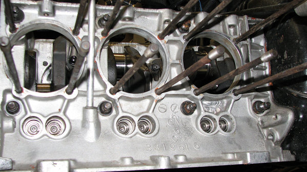

Here's a couple of pics to illustrate why it would become a major job to go bigger than 94mm.
You can see how close the cylinders are to the head studs as it is with the 94mm. The studs are already touching the cylinders. The base of the cylinder where it fits into the case is already paper thin . About 1/16th"
You would have to weld up the stud holes in the case and add material and then locate and tap new holes.
This would mean drilling new holes in the heads and modifying the pushrod guide plates . This would also change the pushrod angle.
And if you did all of that there still might not be room inside the crankcase for the pistons to clear the crank etc.
WOW -- 3 grand for pistons and jugs and that's just for a set of 4 :eek:

UNSAFE wrote:WOW -- 3 grand for pistons and jugs and that's just for a set of 4 :eek:
You pay for what you get, those parts will allow you to do things you just plain can't do with the iron stuff. Heat dissipation is a lot better, in the VW realm they get used to build camper engines that get lugged a lot. It's not uncommon for those to see more than 150,000 miles before a rebuild, so I hear. A guy called Wally has a 2.2L in his Bug with those, he runs 20+ PSI boost relaibly- in his daily driver. Try that with iron. :evil:

Nick - I don't doubt that the cylinders are superior to iron but Ouch !!!!!!!!!

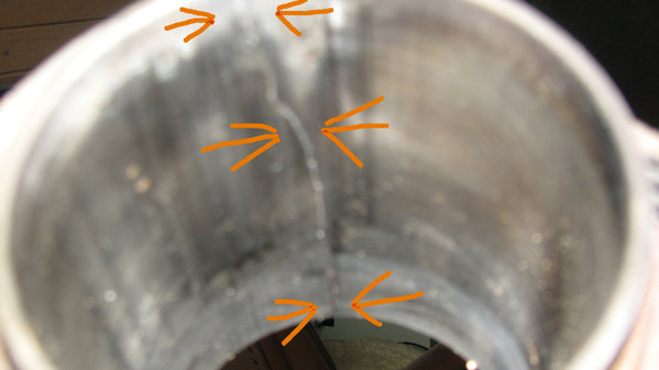

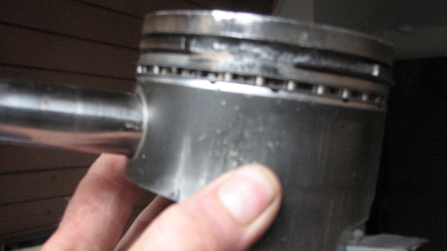

Except for the kerosene incident in 2008 I haven't had any trouble with my cylinders ------
Of course I'm not "Cheatin" ::-):
