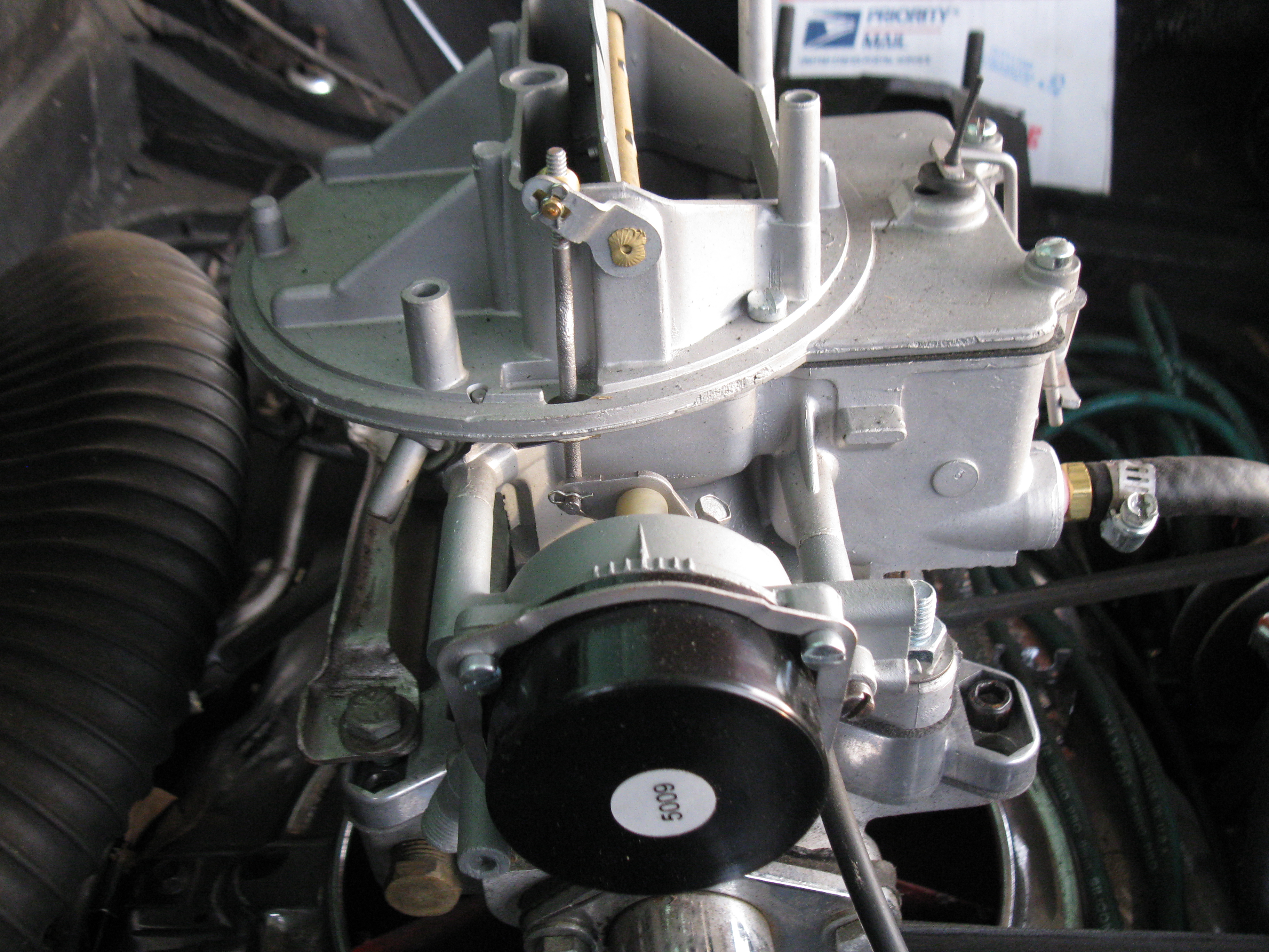

Re: 2 Barrel or 4 on a Centermount
Here are a several pictures. I do not know details about the cable or the bracket mount that you see attached to the fwd two attach points on the carb. The clamp is temporary till I figure ou where to drill or modify. I hope these help.
I forgot to tell you that the 4 to 2 adapter has a front and back with this carb. The carb has a bump on the bottom and the adapter will only go one way.
Thank you for posting these pics. Time to get that linkage together!

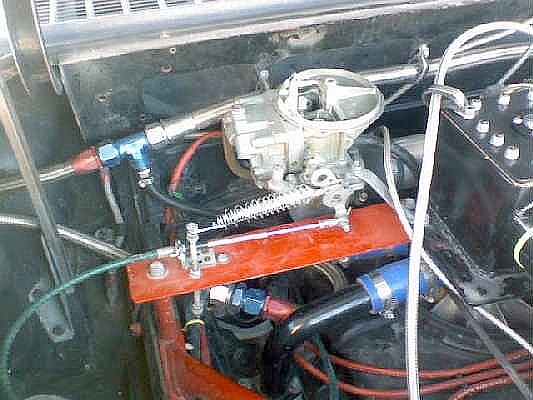

I have a 2 barrel Holly on my racecar.
I use a Morse cable from the tunnel bell crank.
These pictures are cell phone quality but you'll get the idea.
I recommend a Holly because you always know what you're going to get.
Plus parts are vairy available at all regular normal auto parts stores.
Either a 500 like mine or a 390 4 barrel like the one pictured.
Jegs, Summit, and Speedway all sell them both and Morse cables ready to bolt on.

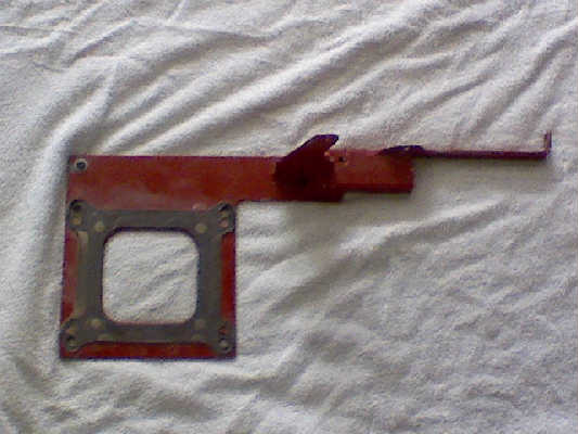

The last two shots are my original Morse cable bracket that is for sale.
It bolts under the carburetor and to the back side of the cove area.
No vibration problems because the center mount is connected by the 4-leg rubber.
The Morse cable is flexible and can be mounted from any direction.
P/M me if your interested in that bracket for $25 OBO...I'll ask Mr Kat if I can sell it.
