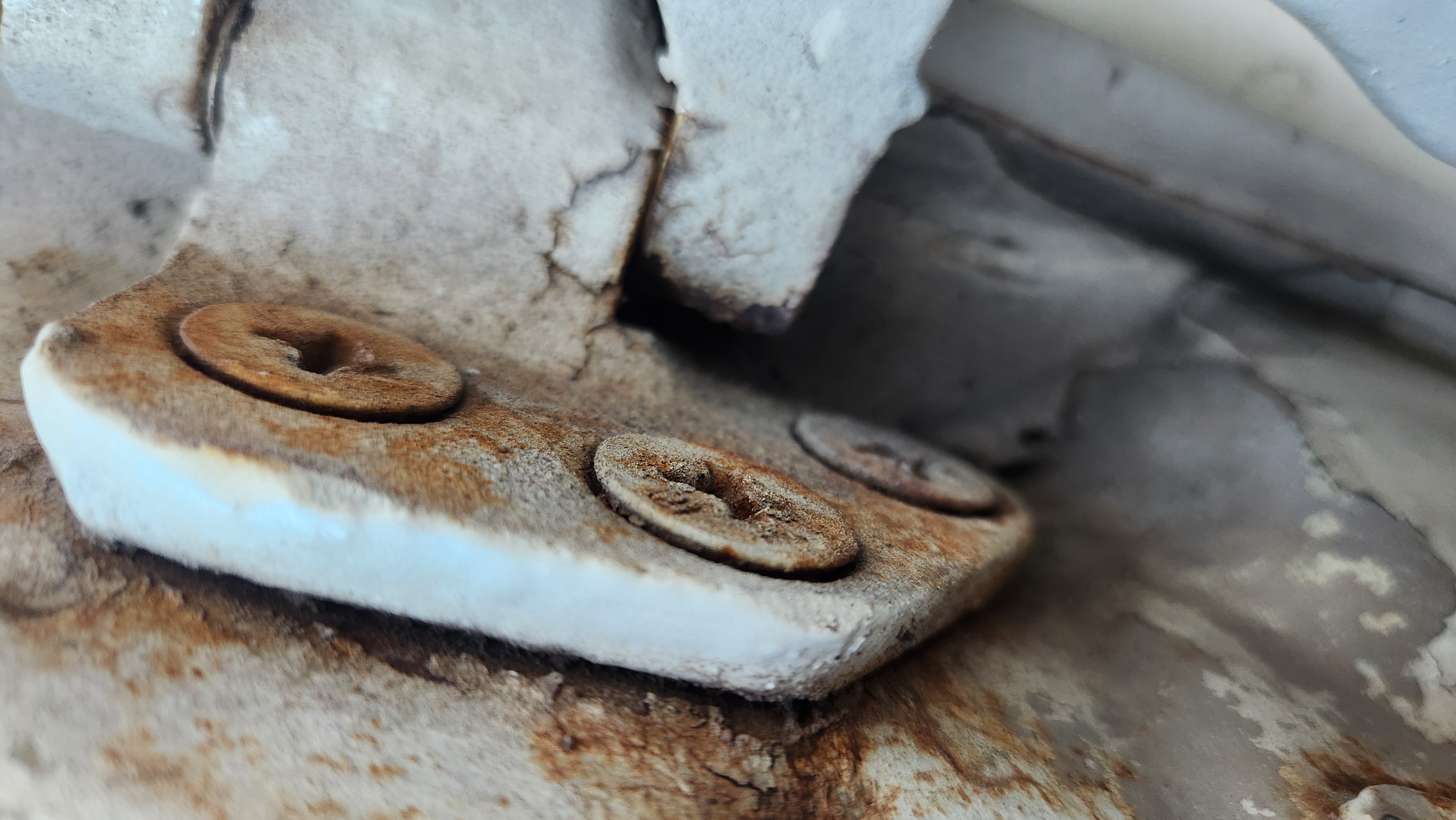

I have a question: How do you use an impact driver and hand sledge when door is still mounted on car? Just curious.
Posts: 6476
Re: Door screws.
vairchet wrote: Mon Dec 09, 2024 10:19 am I have a question: How do you use an impact driver and hand sledge when door is still mounted on car? Just curious.
Good question. Being on the salt free/dry West coast I've only used the impact driver to get hinges off the doors. I remove the door hinge screws with a ratchet and #4 Phillips bit in a socket. I apply force to push the Phillips bit into the screw while moving the ratchet arm. This is AFTER a day or two of soaking the inner fender with penetration oil. Always worked, but maybe not in the rust belt areas.
Keep in mind the screw goes into a sliding plate that is ONLY about 3-4 threads deep!!!! Replacing that sliding plate if you strip it out is NOT fun.
vairchet
Posts: 315
Joined: Thu Oct 11, 2012 9:43 am
Re: Door screws.
Post by vairchet »
What I meant was: How do you gain access to remove screws using described tools when there's not much room while door is still on the car?
Not Much Room to Remove Screws!
Kind of a Tight Fit!
Posts: 1430
Re: Door screws.
Post by Frank DuVal »
If the ratchet doesn't do it, then it is remove the hinges from the body time. :wink: :tu:
