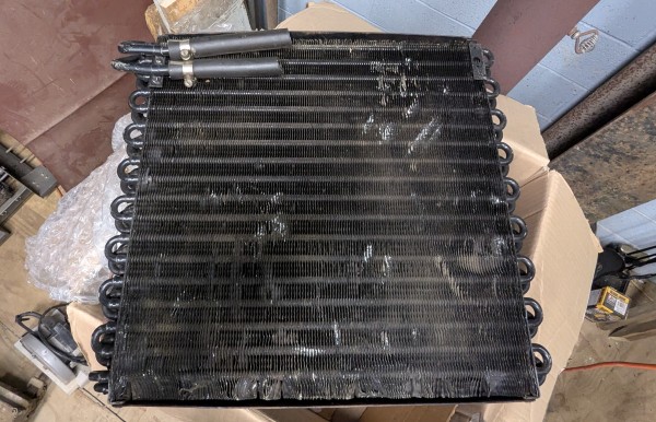

Still working my way through the collection. Will be for some time. There are A/C parts all over the place. I'm not intimately familiar with how the designs for these changed from model year to model year. Hoping you guys (and gals?) will be able to shed some light on each of these things as they pop up. This is likely to become a thread that continues to get new material throughout the Winter months.
Victims 1) and 2)
These two were screwed to a board so that they wouldn't get bumped into. Evaporators? Condensers? Early? Late?
3)
This thing. I'm not sure it's even Corvair. The possibilities are Corvair, C2 Corvette, or G-series Chevrolet van.
Victims 1) and 2)
3)

Re: Help Identify Corvair A/C Components
The first picture shows two 66/67 Corvair condensers. The second picture shows a typical condenser for a front-engine, water cooled "something", definitely not for a Corvair.

4) This other guy:
followed by
5) THIS monster:
In the same box is this gallon crack bag. I don't know whether its contents are (at) all related to the above.
5) THIS monster:
#4 is the same as #1 and #2, a condenser for a 1966-67 Corvair.
#5 is for a condenser for 1965, or earlier Corvair. The condenser mount bracket and fast idle actuator is for #5.

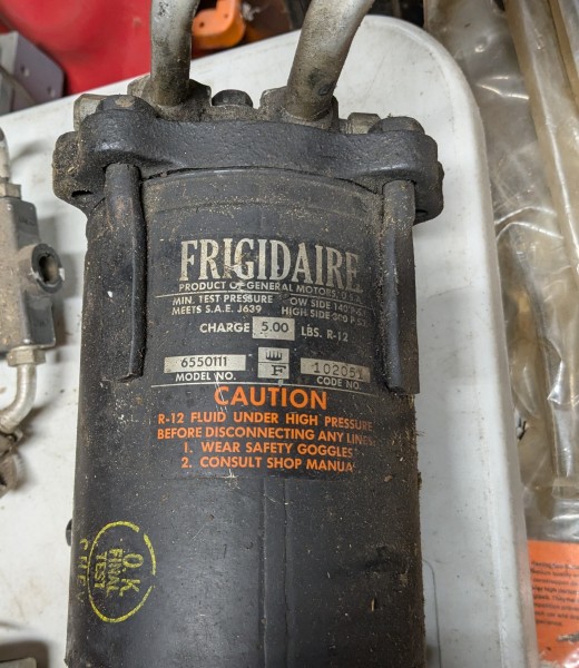

7) Crate #2 of A/C Components
Questions:
Which items can you identify? I see a dash vent, a spare tire hold-down, the cowl-mounted rain gutter, a compressor, and a receiver / dryer. Not sure which years any of these belong to.
The band clamp. Corvair, or other?
Note the model number and refrigerant hose routing on this compressor. See #8.
8) Crate #3 of A/C Components
Now note the model number and refrigerant hose routing on THIS compressor. The model numbers on the compressor in this crate and on the compressor in Crate #2 are identical. However, the refrigerant hose routing differs.
This is the first LM fast idle solenoid I've had my hands on so far. Somehow expected it to be smaller.

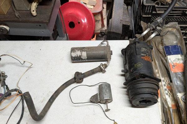

9) Wiring Harness
This harness was in another crate of A/C parts. From what you can see, is it A/C-related?
The knob on what looks like a headlight switch appears rounded. Thinking back to part of the discussion about the evolution of knobs on the radios and on stereo multiplex units, I'm wondering how late a LM this was originally a part of.
On the other hand, the ignition switch pigtail has barbs. Is this for a 1965?
Questions:
9) Wiring Harness
#8 is a late model AC fast idle solenoid.
#9 looks like the under dash harness for a 67-9. That is according to the knob on the light switch.
