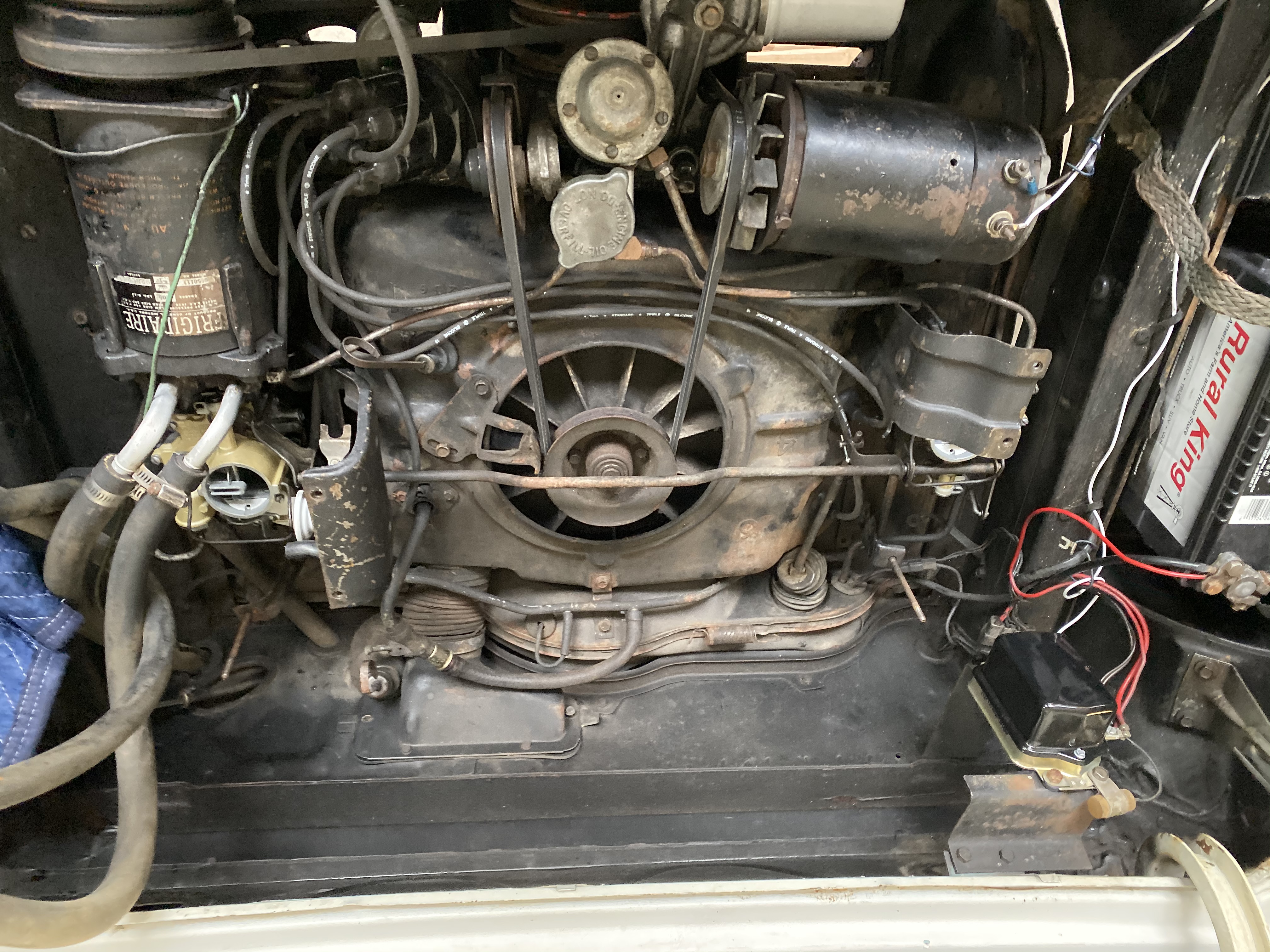

Back to the strange noise - it’s happening while in drive or in neutral and it’s mostly noticeable in low rpm.
I can’t tell where exactly it’s coming from but it’s from the area of the back where the engine meet the transmission

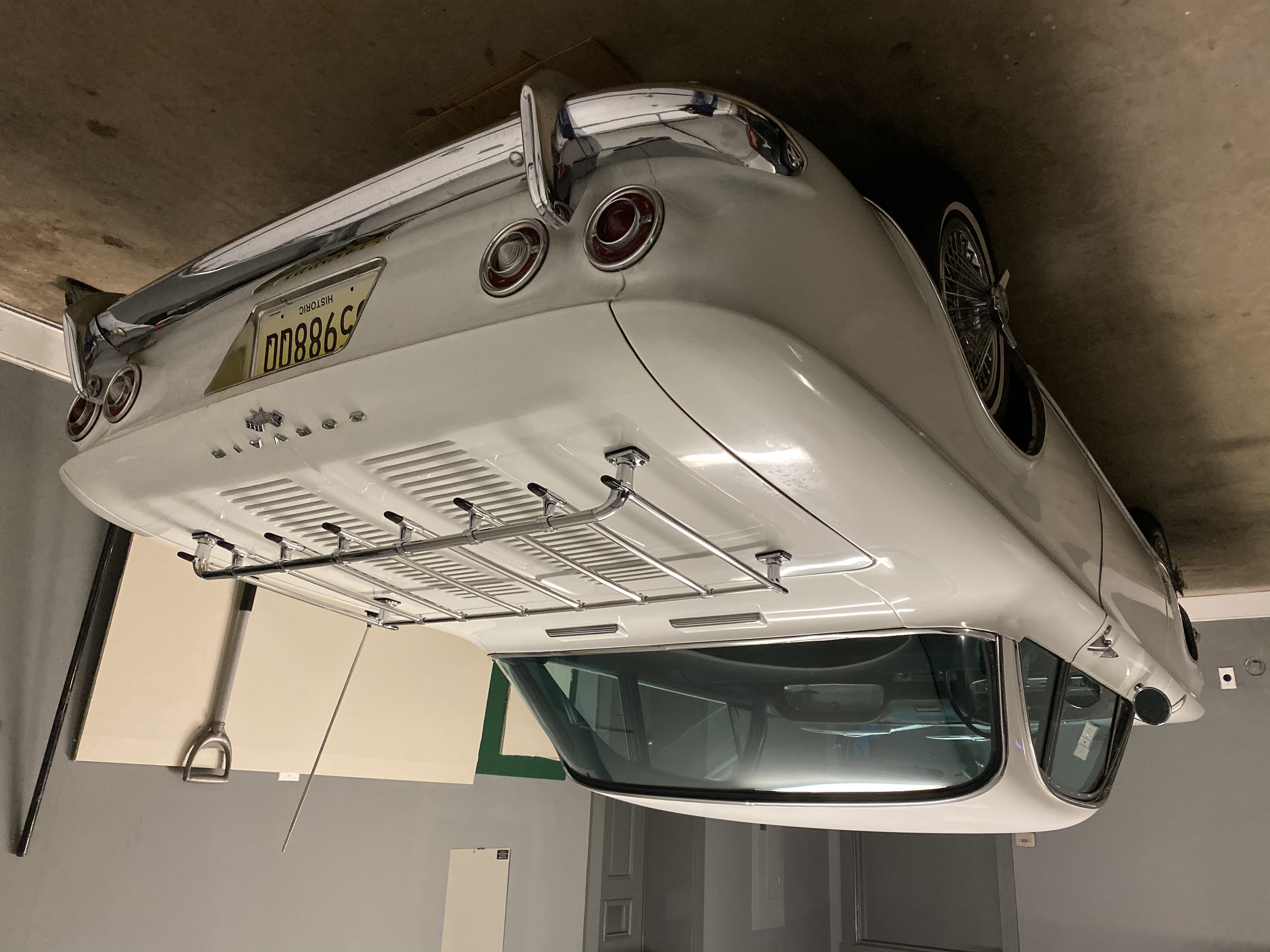

Here are some picture of the car

Check to make sure the three bolts holding the trans. flex plate to the torque converter are tight.

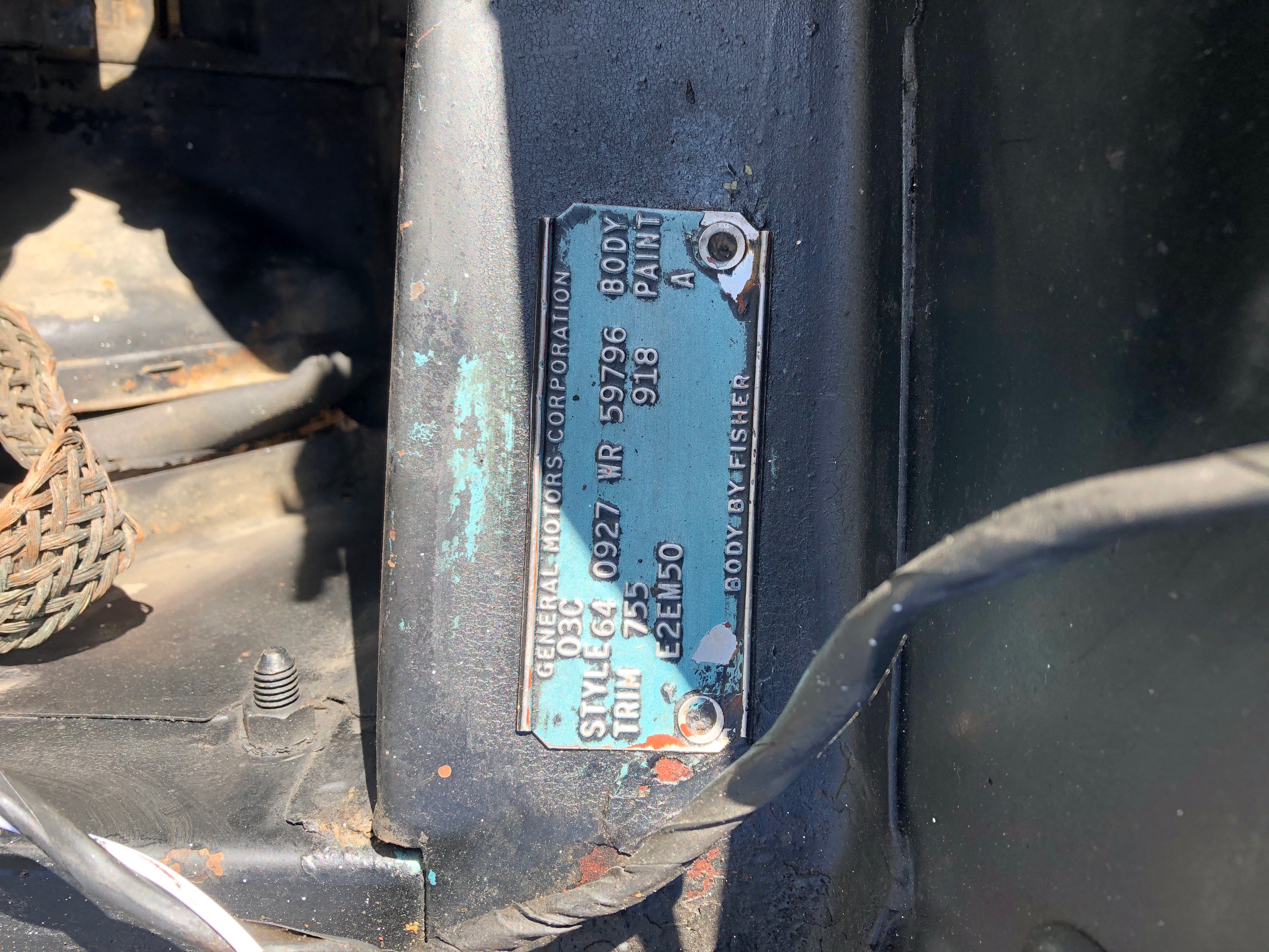

BODY TAG INFO:
03C
Body Build Date: 03 = March, C = Third Week
The first digits are numbers 1 through 12, indicating the month of manufacture. The letter is A-E, indicate the week of the month. If the letter is a "C" it indicates the third week of the month.
STYLE 64 0927 WR 59796 BODY
64=1964
Model 0927 — 2-Door Monza Coupe — 4 Passenger, 09 = 900 Series Monza, 27 = 2-Door Coupe,
WR = Willow Run, Michigan, Production Sequence No: 59796
1964 Monza 2-Door Coupe — 4 Passenger, Total Production: 88,440.
TRIM 755 = AQUA
This 3 digit codes represents the interior paint and upholstery color and seat type.
INTERIOR PAINT CODE
1964: A= Aqua B= Blue C= Saddle D= Red E= Black F= Fawn Q= White/Red
BODY PAINT 918
918 = Medium Aqua "Azure Aqua"
918 = "Azure Aqua" Lucite No. 4253L, Rinshed-Mason No. A1476, Ditzler No. DDL12525
1964 Fisher bodytags ACC line. (WR only)
The Letters are listed in groups. Letters following a number is in that group. The code letters are listed in the order they would appear. Some letters are in more than one group

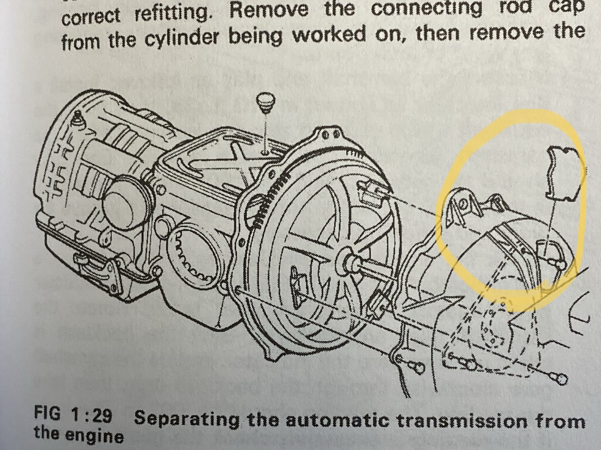

Since you have an automatic transmission, I wonder if the flex plate that secures the crankshaft to the transmission torque converter might be loose or missing a bolt?

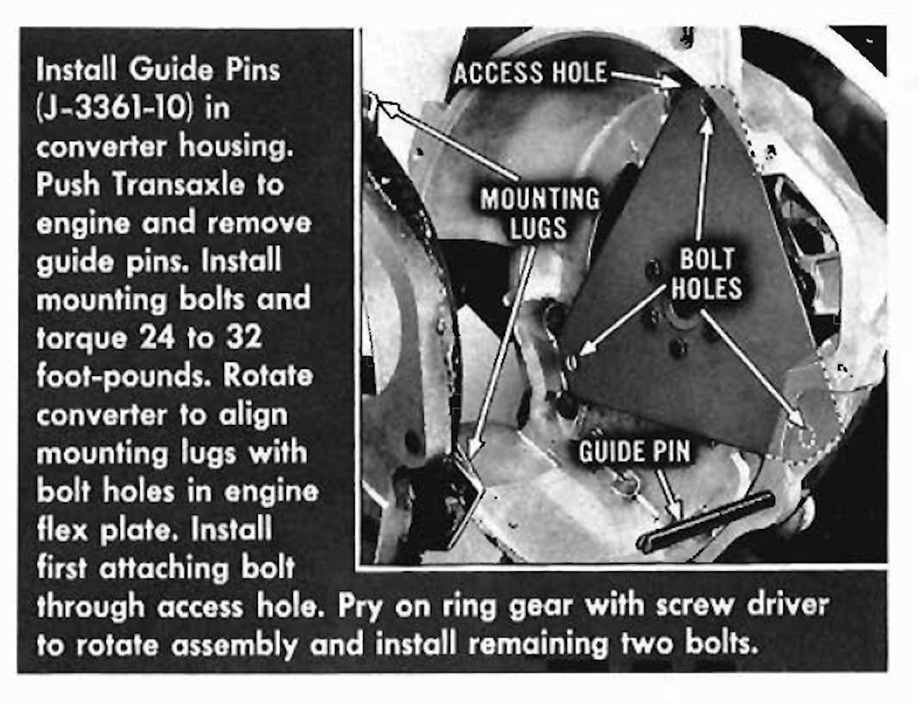

Steps 3 an 4 below indicates that all three bolts should be hand-started prior to torquing. I believe the bolts should be long enough to reach the torque converter.
The flex plate has a convex and a concave side. Installation is addressed in the link to the Corvair Center...

This is what I would do first. If these are good I would guess an internal differential issue from listening to the video but can not hear things like this well from a distance:)Wagon Master wrote: ↑Sun Dec 01, 2019 7:32 am Check to make sure the three bolts holding the trans. flex plate to the torque converter are tight.

Don't forget a broken flex plate. I've had this quite a bit and it continues to get worse until it sounds like a broken crank. The bell housing is also often broken.

You can get to the access panel shown in Brad's post without engine removal. You may have to remove front shroud sheet metal.

You can inspect the torque converter flex plate attachment bolts via the metal access plate shown on the bell housing. Some engine sheet metal at the front of the engine will have t be removed to expose the cover plate on the aluminum bell housing.
You can also see a portion of the torque converter and the starter ring gear via a large opening on the lower right side of the bell housing.
NOTE: DO NOT CLIMB UNDER THE CAR UNLESS IT IS PROPERLY SUPPORTED ON FIRM GROUND (I.E. CONCRETE OR ASPHALT PAVEMENT) BY JACK STANDS. DO NOT TRUST A HYDRAULIC JACK OR MECHANICAL SCISSORS JACK TO SUPPORT THE CAR! NEVER USE CONCRETE CINDER BLOCKS OR SIMILAR MATERIALS TO HOLD THE CAR UP IN THE AIR FOR MAINTENANCE.

The bolts that hold the flex plate to the torque converter (3) can be accessed, inspected, and tightened via the metal access plate at the top of the aluminum bell housing. if one or more bolts are missing...
1960-69 flexplate bolt, used, #RTP89
https://www.corvair1.com/index.php?main ... ts_id=1907
You would not have to remove the engine and transaxle unless the flex plate or torque converter had to be replaced.

Thank you brad for the information
I was planing to drive the car on Saturday 12/7 to the monthly meeting for the first time. I guess it’s not safe to drive it like this. I will probably will go to meet those member and look for help with a local mechanic that know that car. My guy is not familiar with corvair.
I will try to get access to those bolts and check them
I have attached two images.
This is the cover that need to be removed ?
I guess I need to check it from the top of the engine (not from under the car )
Thank you
