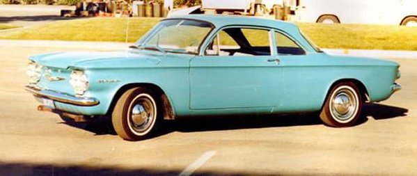

One-Eyeless In Gaza. Had to gouge out one of its peepers to get into the trunk.
I believe I will 86 the front Chevy doo-dad- it makes the vehicle look like it has a small self-satisfied smirk and I can't have that, so will probably weld up those holes.
