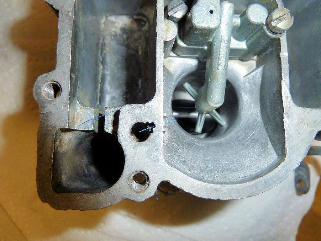

There might be a problem with the accelerator pumps in one or both carburetors. Each accelerator pump mechanism includes a rubber boot that forms a seal to force gasoline through the pump passage. If one or both of these rubber seals has become worn, or if one of the passages has become clogged with some form of contamination, the jet of fuel that should be squirting into the carburetor throat may be weak or not present at all, which would cause the warm engine to stumble each time the throttle is opened.
You should check the operation of your carburetor accelerator pumps. If the expected injection of fuel is weak or nonexistent, you may need to repair or replace the accelerator pump plunger mechanisms as a part of a carburetor cleaning and overhaul.
In the picture below, part of the float bowl can be seen on the upper left. The passageways between the float bowl and the accelerator pump reservoir on the lower left allow fuel to pass from the float bowl reservoir into the accelerator pump reservoir. As the plunger pushes downward into the accelerator pump reservoir, gasoline is forced through the passages into the carburetor throat, so that a pair of fuel jets are squirted into the air passage in the carburetor throat. This momentarily enriches the fuel/air mixture to reduce a lag in power that might occur as the carburetor transitions from a closed throttle to an open throttle condition.
As previously described, a cold engine runs better with a richer fuel/air mixture. This is created on a cold engine with a closed choke butterfly. With the choke open the engine is configured to run with a normal fuel/air mixture. However, the design of a carburetor requires airflow through the carburetor throat to create a Venturi effect to draw gasoline from the carburetor float bowl into the carburetor throat, for mixture with the air as the air passes through the throat and is drawn into each cylinder. There is a brief delay as the air begins movement through the carburetor throat, before the Venturi effect can draw fuel through the carburetor passages to mix with the air. This brief delay can cause the engine to stumble as it gets mostly air with little gasoline mixed in. To compensate for this, each carburetor is fitted with an accelerator pump, which is a mechanical plunger that is forced into motion by the mechanical movement of the throttle linkage. The moving plunger mechanically injects gasoline through the accelerator pump passages to squirt a jet of fuel into each carburetor throat. This mechanical injection of fuel momentarily provides additional gasoline to mix with the airflow, until the Venturi effect can draw fuel from the float bowl, through the main jet and into the carburetor throat to continue engine operation with the throttle open. The accelerator pump is intended to mechanically injects additional gasoline each time the throttle position transitions from closed to open, which helps to eliminate a momentary power "stumble" until the fuel gets moving in a continuous state through the carburetor.rnd5553 wrote:Thu Jun 22, 2017 10:52 am
