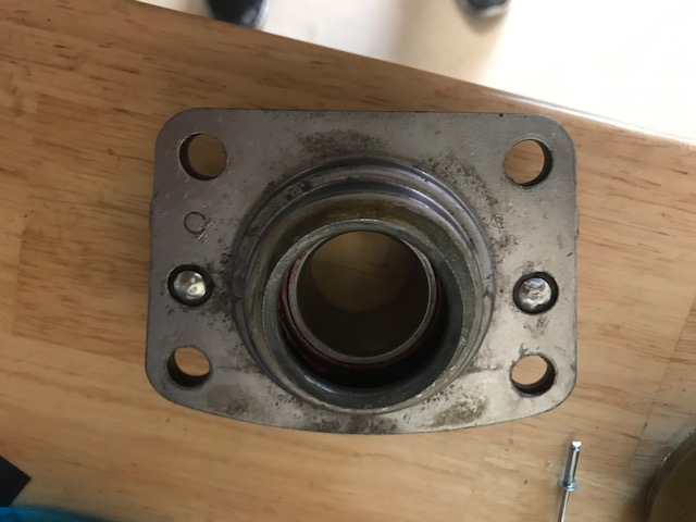

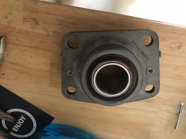

I finally found a shop to press my bearings off the rear axles. So I am in process of rebuilding them with the kit from Clarks and I am a little confused on measuring for the correct shim.
I am assuming I put the races in clamp together and measure from the side that goes towards the transmission. Any help would be appreciated

I can't help you with the shims, my 64 has the one piece cast housings & it has a big snap ring holding the bearings in. I just added shims up to the snap ring groove. Your kind look a bit harder to figure out. Look for a Davemotohead1 video. Dave doesn't mention anything about shims in this video. I wonder if your type uses shims, Clark's may just put the shims in the kit so they are there in case you have a 63/64 hub.

update finally got one bearing completed today have speaking with Clarks about using shims correctly
