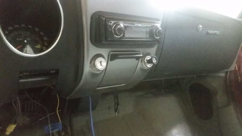

Since I'm using a single DIN chassis head unit, we're only going to talk about that. There's some options for mounting. In dash, under dash, and hidden.

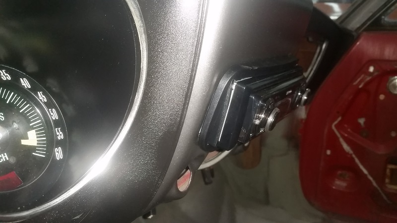

While I thought long and hard about the under dash mount, my stock radio was a pockmarked rusty mess. Didn't want to leave it in there, and I wasn't fond of having the radio hole, then having another radio mounted underneath. This may be an option for you if you don't mind the look or have a nice radio delete plate to hide the original opening.
I also don't have an IR remote that can beam through the glovebox door and wanted to keep my glovebox anyway. Went for the in dash option.

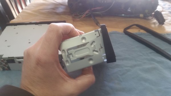

Kind of bulky, but it'll work. I REALLY like the DIN radio adapter plates that were made awhile back by Bucketboss, but sadly they're really tough to find. Maybe someone with a 3D printer will start tooling them up again? Please, lol?
2 concerns with the dash mounting. First is the radio knob thingy's in the stock radio hole and the other is the inverse slope of the dash.
You do NOT need to cut up your dash to install a single DIN receiver. By carefully bending the tabs back, and I mean ALL the way back, you can JUST scrape the mounting sleeve in the factory cut out. I did.
To address the second issue, you'll have to get a little creative. I went and bought a Scosche install kit for a newer Jeep. The only thing I needed out of it was one of the trim plates. It's just wide enough to cover the factory hole on the sides, and is a clean oval, so smooths out the finish a little.
The other piece of the puzzle is the slope. I dug through all my old leftovers and found an angled mount ring that worked. It's not perfect, there's still a little down slope to the stereo, but it's much better and perfectly usable.

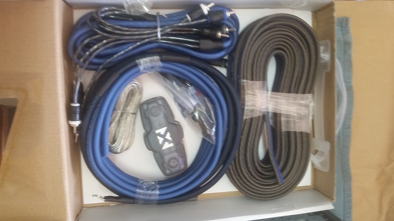

My amp wiring kit. Good stuff, pleased with the quality.
Includes a 4ch RCA cable and a small 18gauge remote wire to the amp.

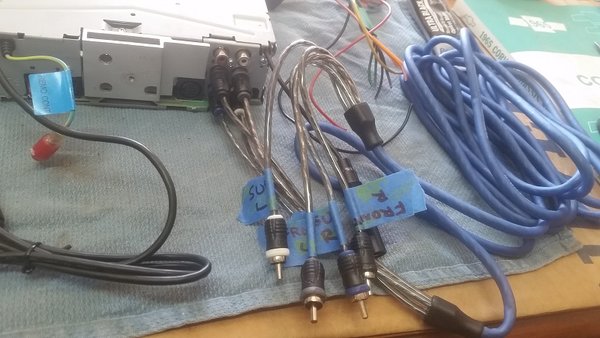

Installed the RCA lines and marked the other ends with tape before I slid the deck in. Much easier, but make sure you take some tape and mark the other ends of your wiring so you don't forget later!

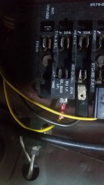

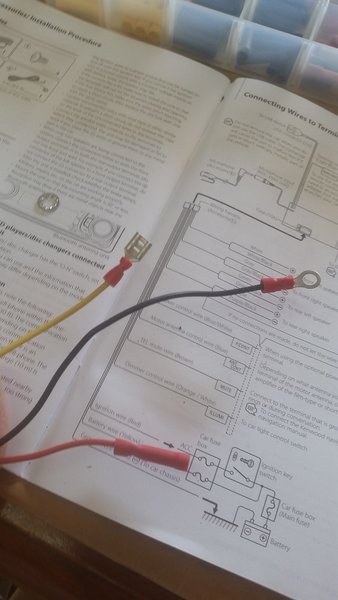

That leaves the 3 you actually have to wire...switched power, constant power, and ground.
The factory radio has 3 wires, 2 to the speaker and one yellow one. The yellow one is switched power that is only on if the key is in there. I'm using the factory yellow wire as my switched power, so need a simple splice onto my red wire because that's what color it happens to be on the Kenwood pigtail.
Constant power is where I put a simple slide connector on the end and plugged it straight into the fuse box. Don't get confused by my wire colors, it just happens to be what my radio pigtail has.
***Caveat! I don't have a battery in my car yet, so not sure if this will be a constant hot or not. If not, I'll find a different spot. ***

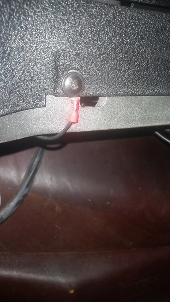

Lastly the ground. There's some options, but I just used one of the glove compartment bottom screws. Easy to get to and unobtrusive. IMPORTANT! There's only going to be 2 grounds in this system. Head unit and amp. Make sure they're good! I always dremel off all paint and rust, then used a star washer with the little teeth that will bite into the metal of the eyelet and metal.
The order from in to out is, metal of the car/star washer/eyelet of ground wire/dash surround/screw. Important part is the star washer is biting into the ground wire and the real deal metal.

The only thing in hate about the single DIN install in the late model, is that the radio kind of faces downward because of the curve in the dash, but there's not too many options, so we're kind of stuck with that.

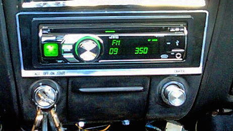

Yup. Unless you can find or make a sloped mounting ring. Actually, any trim ring you find that at least 1/2" or more thick could probably be trimmed down more on one side to make an angled mount and straighten her right up.
There's always the Custom Autosound head units as well. They're $250-$350, but have all the modern niceties and look more stockish. Honestly, I can't remember the last time I bought a CD. I'm just using what I have because I know it sounds good and has the preamp outs.

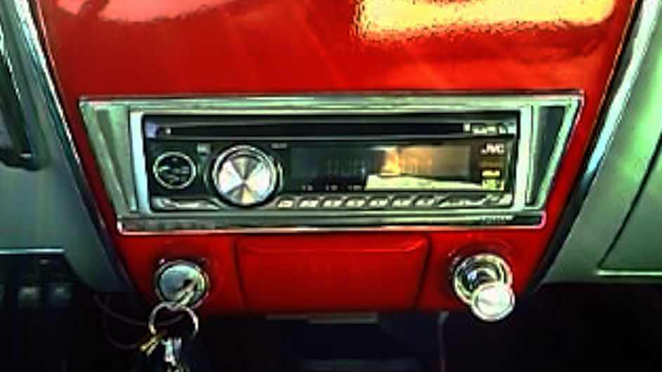

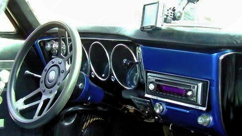

With the likely demand for a well-designed DIN faceplate adaptor for LM Corvairs, it is surprising that Clark's Corvair Parts — with all their contacts, design experience, and knowledge of reproduction and fabrication — never came up with such a kit.
Here are some LM faceplate images I found on the Internet...
http://corvaircenter.com/phorum/read.ph ... 164,page=2
ubuck wrote:Date: November 19, 2009 06:21PM
Here's mine. Used a standard front plate. Fabbed the inset to straighten the face and attached with JB Weld. The DIN insert holds the plate tight to the dash, along with the radio's rear support bracket.
