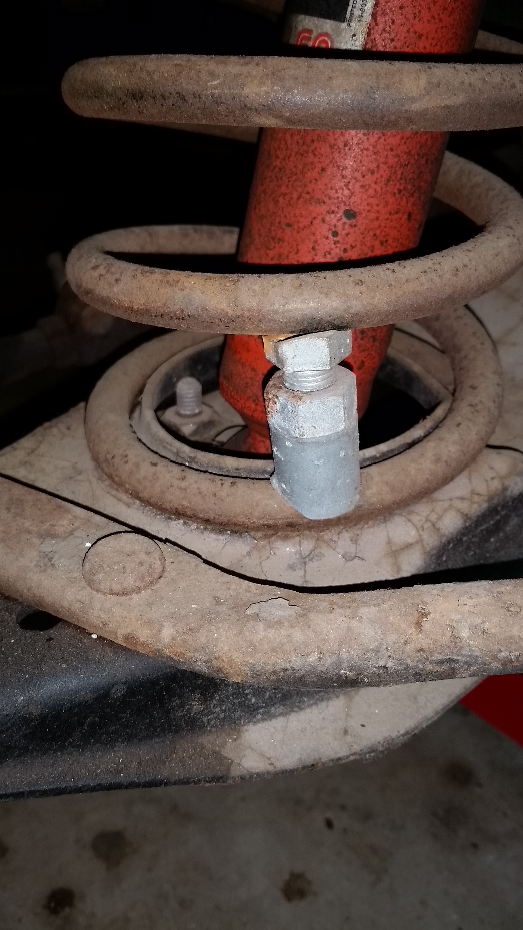

I have a strange bolt on my front driver coil spring. I was doing a brake job and found this. Any ideas?
Thanks,
Jon

It's an old school way to fix sagging springs or run bigger tires.

Sometimes folks put a spacer up front to level the car, but the problem is with the rear spring. Don't assume it's the front spring.

Back in the mid 60's everbody used that type of spring spacers to jack up the front end. Then the drag racers found out it was better to keep the front end lower & those went out of style. I have some in the garage now that twist in to raise the car.

The Corvair always have been a little high in the front. This is compounded by the fact that as the cars age the rear springs tend to sag while the fronts DO NOT. The most common correction is to simply cut ONE coil off each front spring.
BEFORE you go replacing springs determine if the front or rear springs are an issue and why the spring spacer was added. Jack up the front of the car with a floor jack centered under the cross member until both front tires are just off the ground. If the car is level side to side the front spring spacer was added to compensate for a weak front spring. If the car leans to one side, then it's the rear springs that have a problem.
BTW - NEVER jack up the back of the car via the engine or transaxle - it ruins the drivetrain rubber mounts. So no you can't do a center test raising the back.
