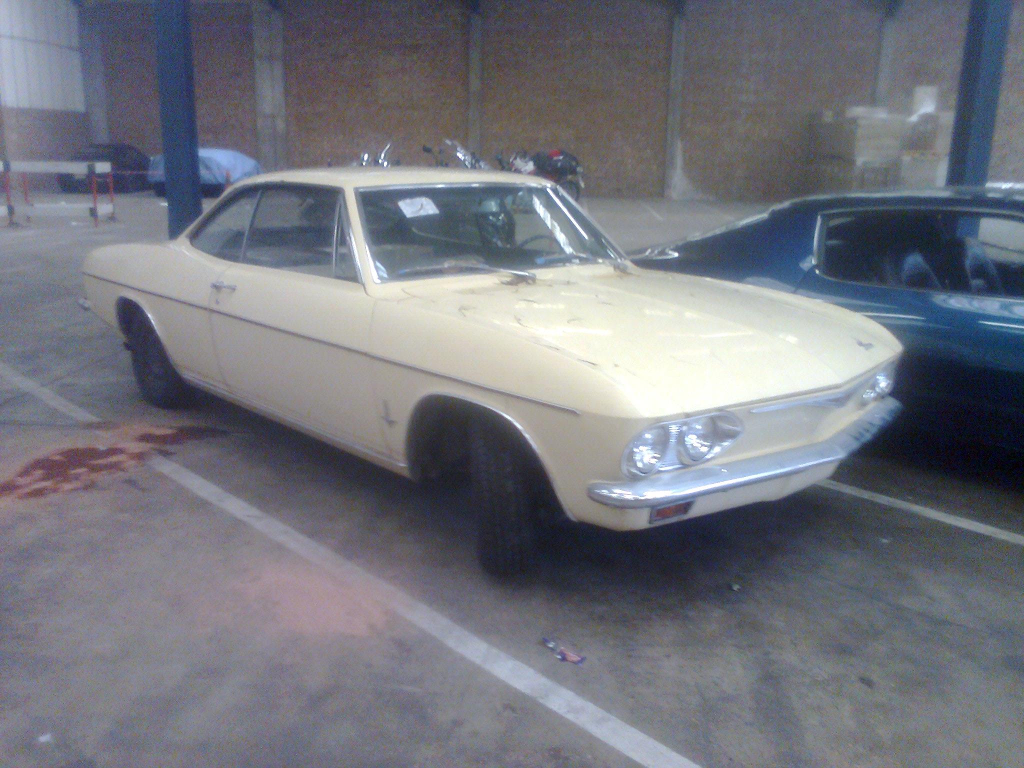

hello,
i've got a question about the original springs and shocks.
I want to replace the original (front) springs and shocks on my 65 sedan because they are all worn out after 50 years .
but i was wondering what would be the best or the alternative for the original springs and shocks.
the original are hard to get here in europe, so i'm looking for a set of new springs and shocks.
I found a set of springs, but unfortunally they are a bit to short i think. the springs are 9.45 inch and the original are 13.39 inch a differenc of almost 4 inch :eek:
I was planning on lowering the car about 1 inch for a better stance, but 4 inch is probaly a bit to much. i guess the tires wil hit the fender when i'm steering in and out.
:ty:
(BTW) has anybody a good suggestion for getting the springs back into his place ? it's a hell of a job to get it in because the springs are very long and there is not enough room for using spring spanners :sad5:

On a LM car (65-69) the front springs rarely need to be replaced. In fact the Corvair sat front high from the factory to accommodate the full trunk weight rating. Many actually cut a coil from the front stock springs.
There are a lot of opinions on springs and shocks. It comes down to the kind of ride you want, do you want the car lowered, etc. You sound like you are trying to keep the costs down. If the original front springs are not cut I would NOT replace them. The rear springs are ALWAYS collapsed due to the weight in the rear. I just change the rear springs with reproduction units from Clark's and the car usually sits level. Only Clark's sells the correct length shocks as far as I know. Gabriel has a contract with Clark's Corvair to make the correct length shocks and Gabriel ONLY will sell to Clark's direct. A fellow that once worked for Gabriel posted the even he could not buy the Corvair shocks from Gabriel. I like the Gabriel strider since it is adjustable (out of the car). Be aware that the rear shock is also an integral part of the suspension since it limits the rear wheel travel downward so the travel length is important. The Gabriel Red Ryder shocks are typically firmer. I have no experience with the Corvair Koni shocks, although my past experiences with Koni shocks is excellent. You might check with Koni and see if they list shocks for the Corvair you could order locally. Good luck.
