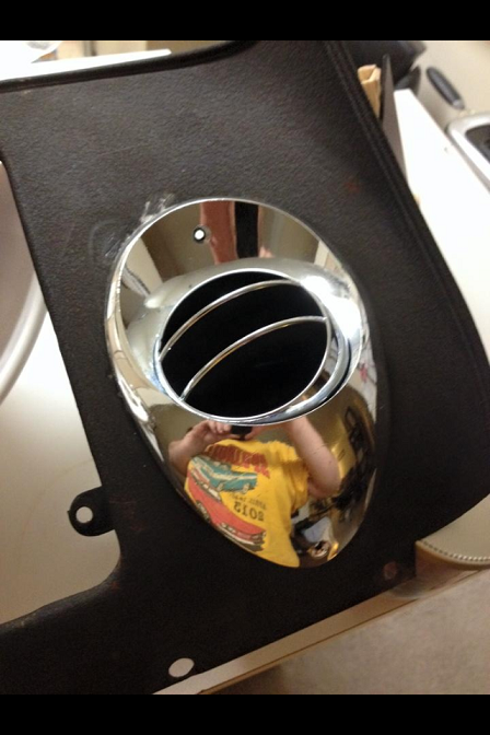

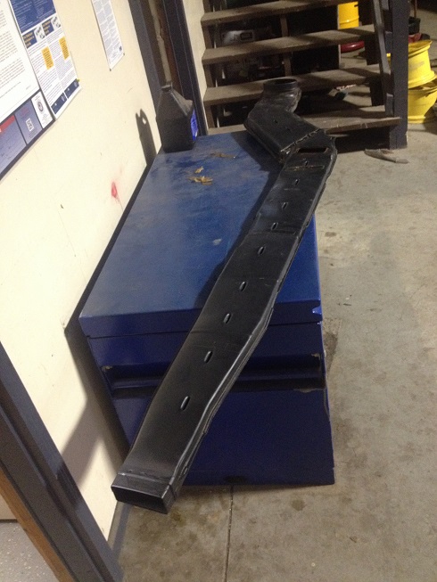

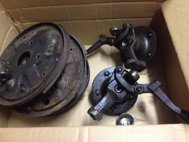

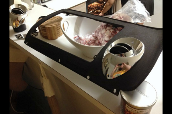

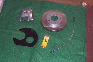

Havent posted on here in awhile, figured I would hop on and get caught up to show what I been up to. The 66 corsa I have is now being put on hold while I work on my convertible. Just needed more work than I could do right now, while the convertible needs a lot less. Anyways my 68 is a 110 PG car but will be converted to a 140 4spd with a/c. All parts are coming from a rotted out 69 coupe and a/c from a wrecked 65 sedan. Been fitting the a/c vents into the dash panels and will be getting the center vent in the car when i get time to work on it (currently stored at my parent's place). Then comes the fun part of cutting out the trunk to fit the airbox. I know they sell a sleek more modern unit you can put in, but heck what's the fun in that I may as well just cruise my kia ::-): ! I like the big clunky unit its kinda cool how it all works and the air box does give you fresh air vents in the dash when your not using the a/c. Also I tore the front end down from the 69 coupe (Got that 68-69 correct protect o' gas tank panel even) and will be rebuilding with disc brake and cut a spring coil off to give that little stance! Busy busy now to just get the dang thing on the road.
Fits like a glove! The metal this panel is made of was a bear to cut into...
Big thanks to Mike Corbin who is the man when it comes to a/c parts for Corvairs! Had these babies rechromed and ready to go

front hubs heading to be machined for disc brake
local guy makes kits I will be using

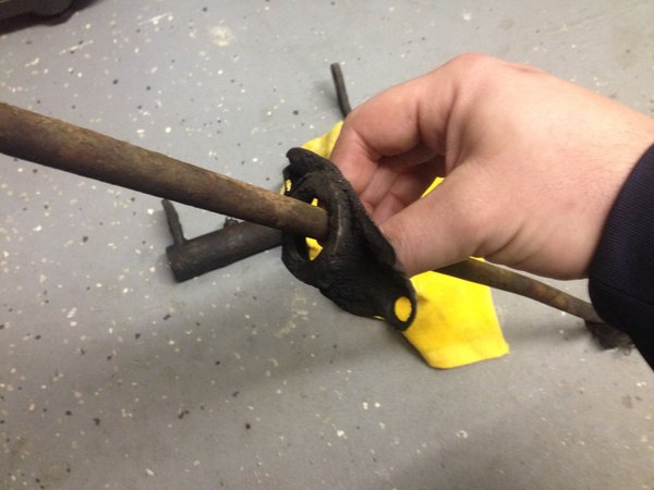

Prepping parts for converting the PG into a 4spd. So far everything is looking good with minimal need for replacing other than the norm, had to do some emergency repair on the clutch shaft dust shield. Also cleaning out the heating duct and applying new foam tape to help make it more efficient! Slow but positive work being done.
What the dust cover looked like
And after some persuasion from a socket and hammer as well as cleaner

heater duct all cleaned and metal painted
A little foam tape to help get the heat proper

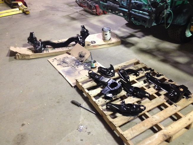

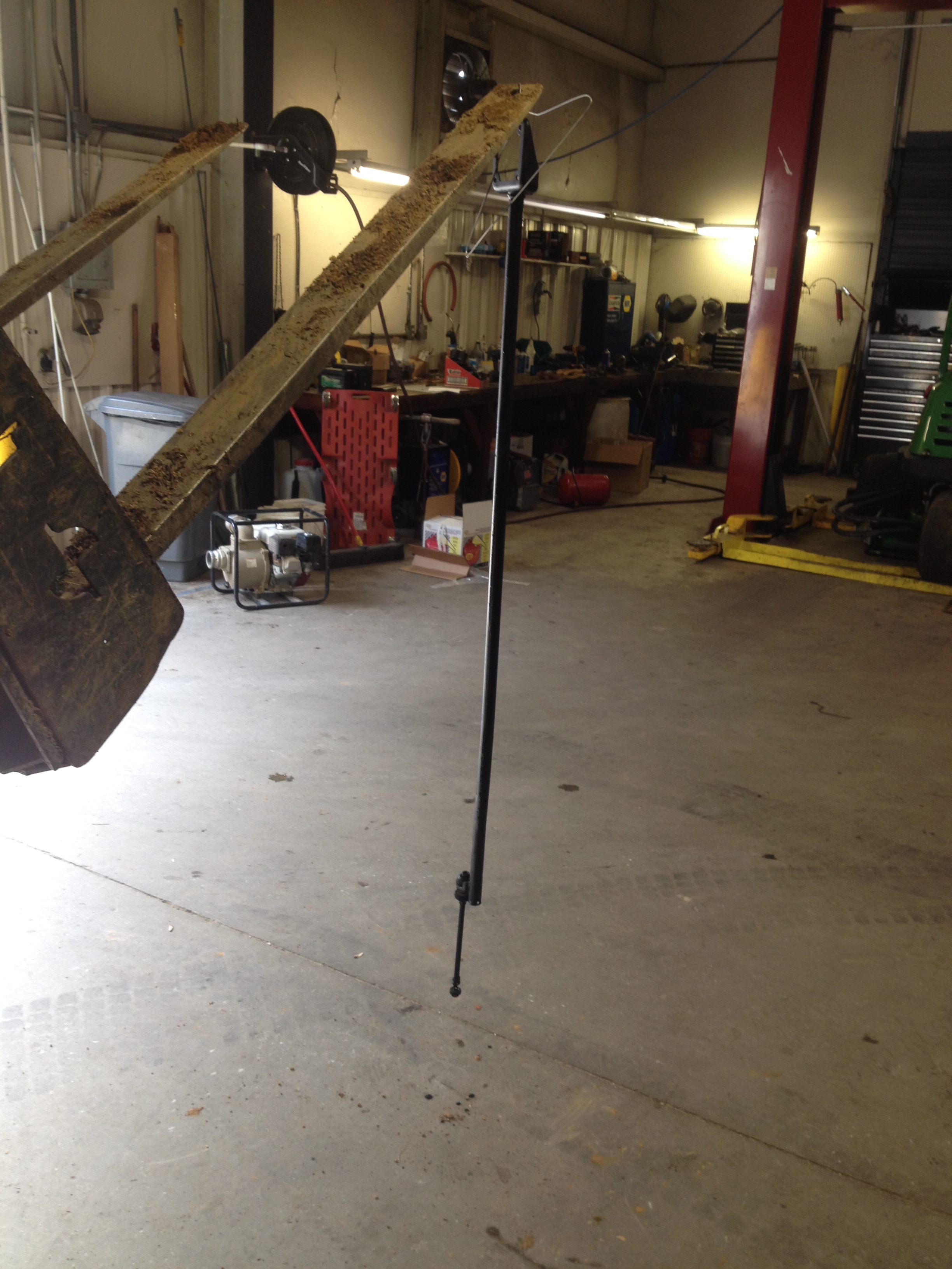

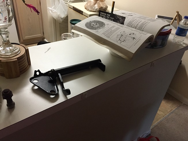

Been digging into the front suspension rebuild, I have most of it painted and prepping for a disc brake conversion along with a drop on the springs. Got the clutch cross shaft rebuilt, it was some nasty grease in that thing. Next step is to clean and reseal the transaxle, concerned about its condition because I noticed a lot of excessive wear on a lot of the brackets when pulling it from my parts car also the transmission crossmember had two stripped bolts and one stabilizer bar had replaced bolts. Also the engine had been rebuilt in the past due to a crankshaft failure (I got receipts with the car) which makes me believe that the trans may of been sagging at some point and caused stress on the rest of the drive train. I am wondering what to look out for on the trans in case it was damaged as well.
cross shaft looks good as new
brushed on some oil based paint
whoops lost a loop!
whoops lost a loop!
redneck paint booth!
Dirty dirty. Any ideas on paint to use?

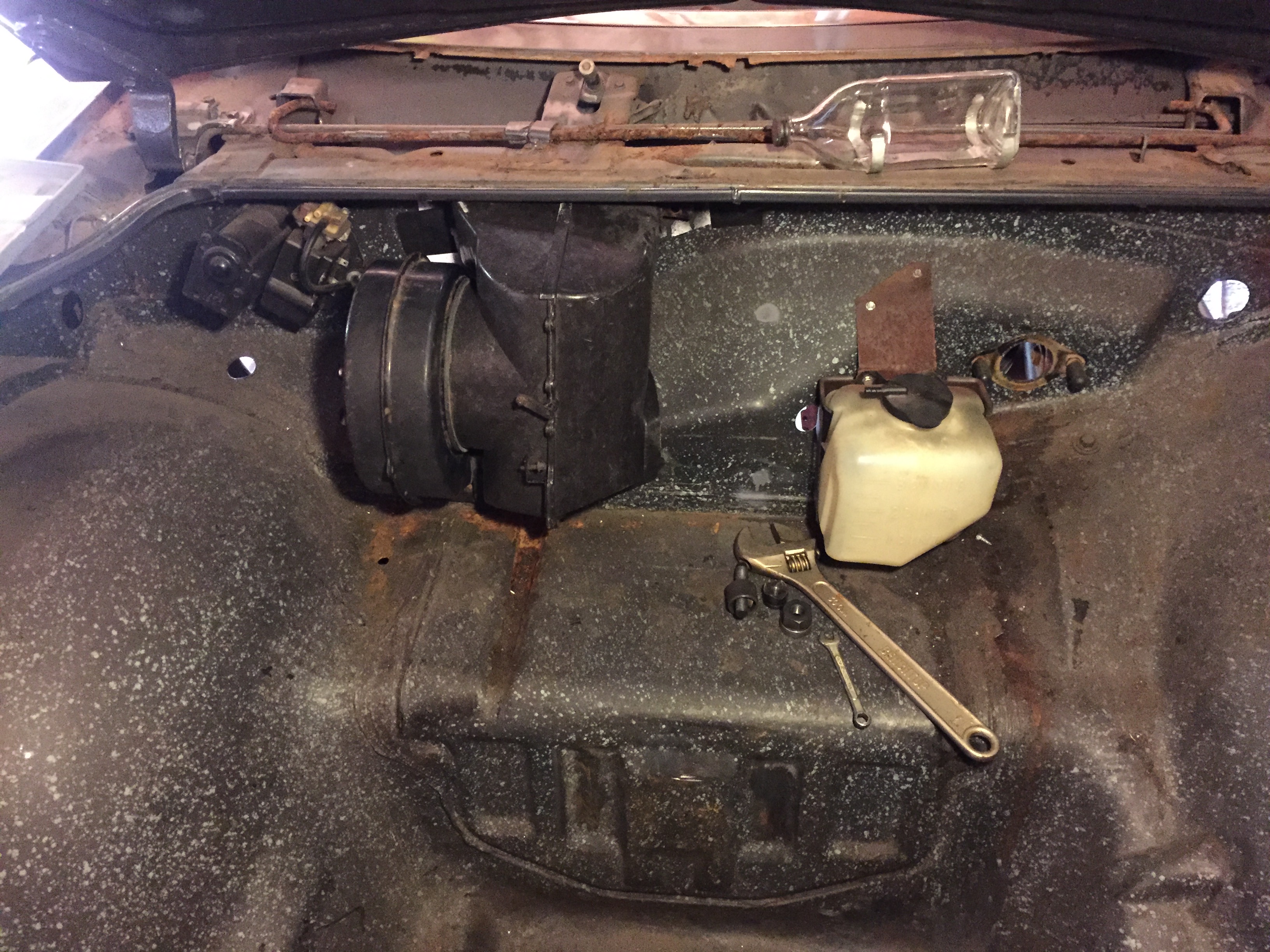

ac box in
ac box in

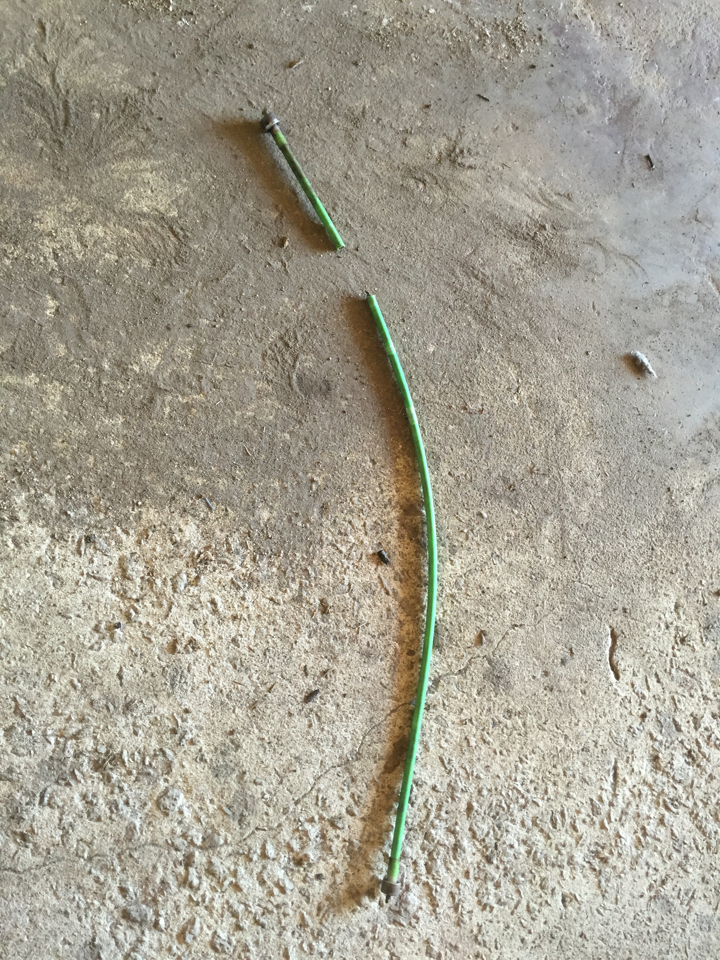

Well that would cause a problem

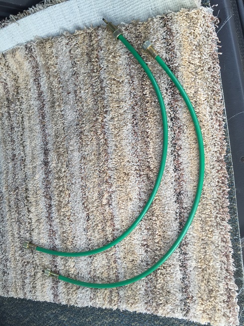

New cables going in power top
