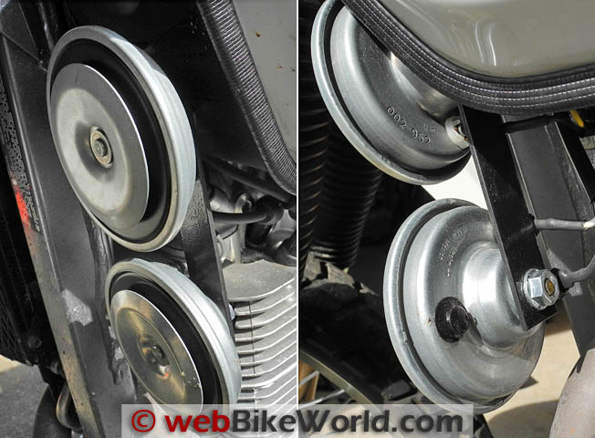

I don't think I ever got an answer to this question but I need to buy and install the new horns before I mount the headlight assemblies. I mentioned that I want to change my horns to one that sound like the road runner. The majority have two prongs just like the motorcycle horns do. Are the single prong,higher amp tolerable? I think the two prong are a direct hit and for applications where grounding may not be suitable or available. I don't have any to test, so my question is>> IF I mount the horn while running a grounding wire off one of the two terminals to the mounting bolt leaving one terminal open, and then plug the car's positive wire (+) to the remaining pin on the horn, won't that work the same? The horn is getting a positive and a negative and the horn button activates it to complete the circuit and we already have a relay. IF this works, then I don't have to hunt for single hot pin meep meep horns. I'm sure the pins are labeled positive and negative also.
The HELLA SUPER HORNS have a more adult like sound and still a low toned meep meep and original Plymouth Road Runner horns are around $100 each...... Yeh, I like them that much LOL.. Hella dual tone sound great IMO.. See video for the Hella sound difference.. What is your preference? Thanks.

The 12V horns are a 2 wires system. Positive input and ground. The stock horn uses its metal body as the ground path. Horns like you are looking at with 2 wires use one wire for + voltage from the switch and one wire to go to the ground. The ground wire can be mounted to the body about anywhere, but, I would suggest to getting body ground at the mounting bolt for the horn might be expedient:)

Hella dual horn system

Thanks and I agree that the Hella dual horns sound great together.

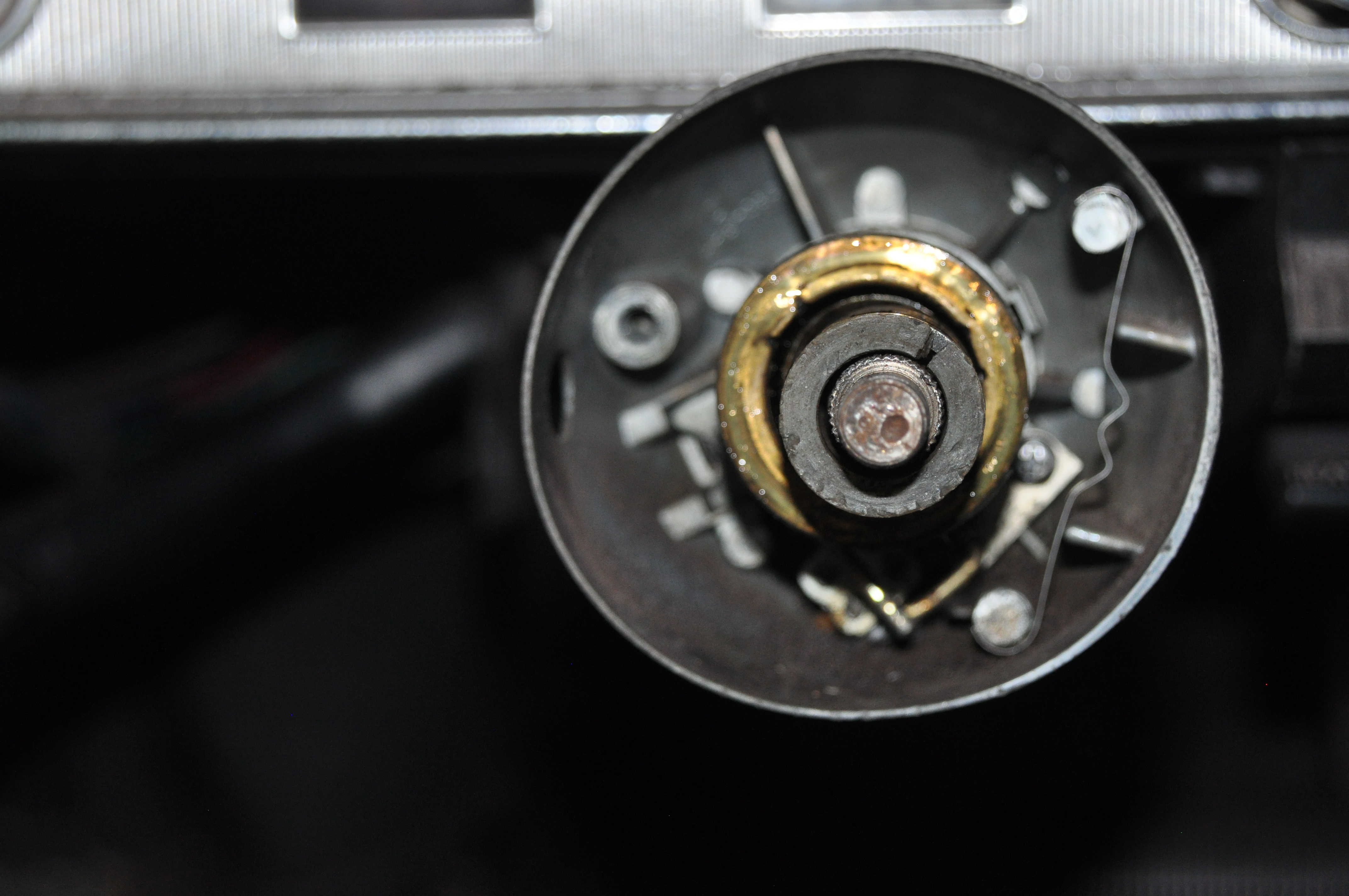

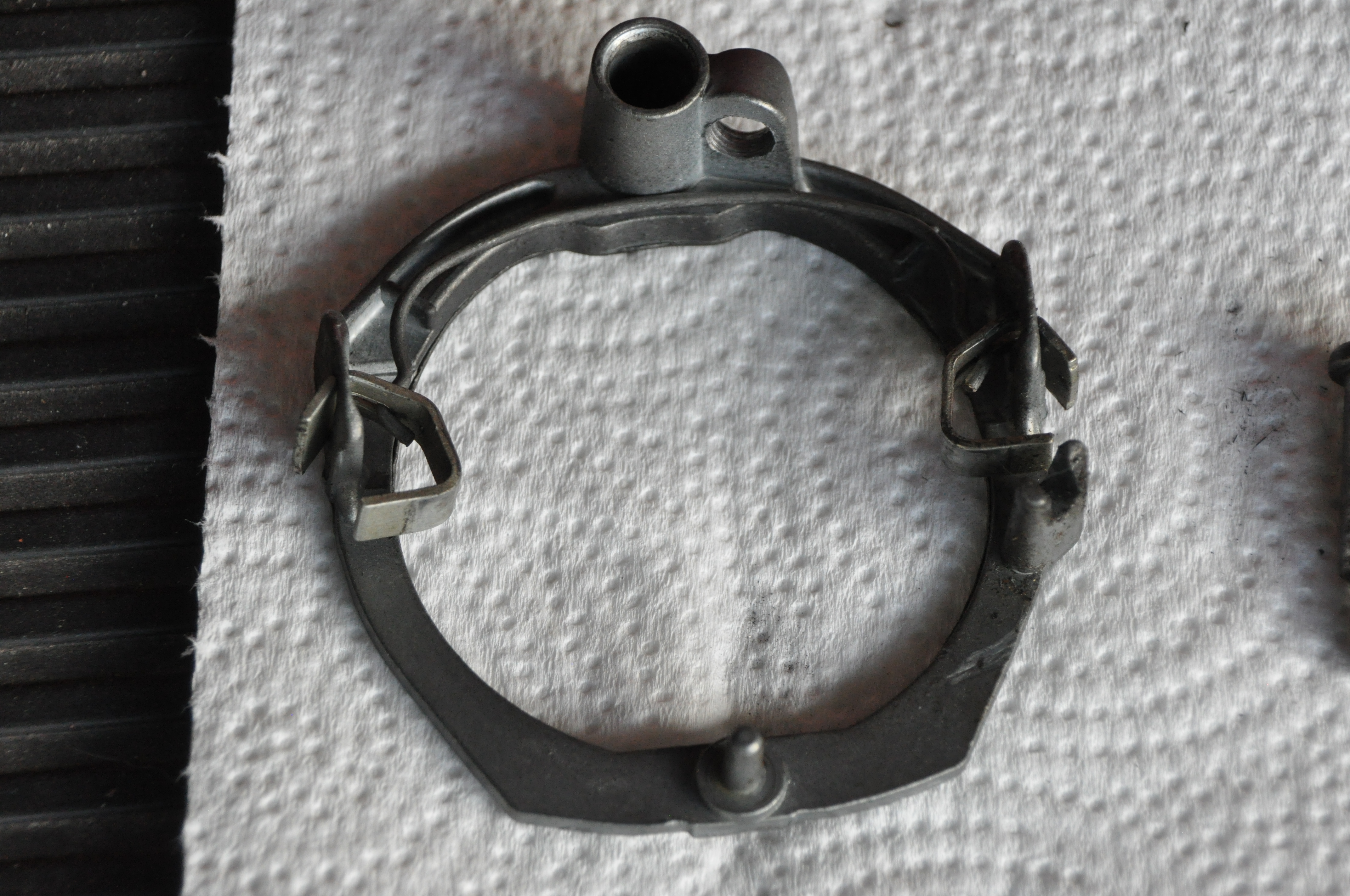

Well, I'm stalled for the time being. I have transferred the items over to the new ring, installed the long spring on the outside of the two posts in the column and was ready for assembly but I'm just not sure that the spring is on the right side of the posts in the column and if it is, the nylon bushing looks as if it would ride on the inside of the spring. I'm just not sure. I thought the bushing would ride on the outside but then the spring would have to be flipped for that cause it just cant be pulled back as tight as it is. Can anyone tell me just what position the spring and bushing be in? Spring on the outside as pictured and bushing riding on the inside? My guess is because of the 'stopper' in the casting that would prevent that spring from dropping downward, I have it right. IF so, the bushing rides the inside?? Thanks all!!!! Have a Happy New Year!!
Here's the one I just removed.
Bolt de-greased, re-greased and parts transferred over.
The nylon bushing won't slide on all the way.
The inside of the column is so simple!! I guess that all changed in 1965 with the plastic insert.
Is this spring placement correct? I'm guessing yes by the way it looks like the area was made for it.
Sorry about other areas out of focus but I am on 'pinpoint focus' . What side of that spring does that bushing ride on and is that the correct position for that bushing to ride on that pin?
Again, Thanks for all your help. Scott

I looked at these photos and by the looks of the one with the ring installed, they pulled the spring inward and dropped the bushing over the outside of it. THIS is the position that I can see to have the bushing located in a neutral position after the cancel cam ends the turn signal activation. I can see three positions for that bushing to ride on. Am I correct? Bushing on the outside?

"The little roller is supposed to ride on the inside of the detent spring so the roller catches in the V in the middle (signals off)."
IF I mount the roller on the 'INSIDE of that spring, there will no no NEUTRAL position. However there is a V facing outside for a neutral position. It also looks like the molding in the housing is used as a stopper so you don't go too far either direction..

It needs to ride on the side you have outside in the above photo.

terribleted wrote: Fri Dec 27, 2019 3:57 pm Yeah the wide washer part of the roller goes up so the lower side of it rides on top of the spring keeping it from falling down into the column and yes the roller rides on the outside of the spring.
This is what I needed to find. And I take it my spring is mounted correctly. Tomorrow I can go out and finish mounting my steering wheel. Happy New Years!!!!!!!!! 2020 will be a year to remember........ :beavisbutthead: :beavisbutthead: :beavisbutthead: :beavisbutthead: :partydudes: :partydudes: :partydudes: :USA:
