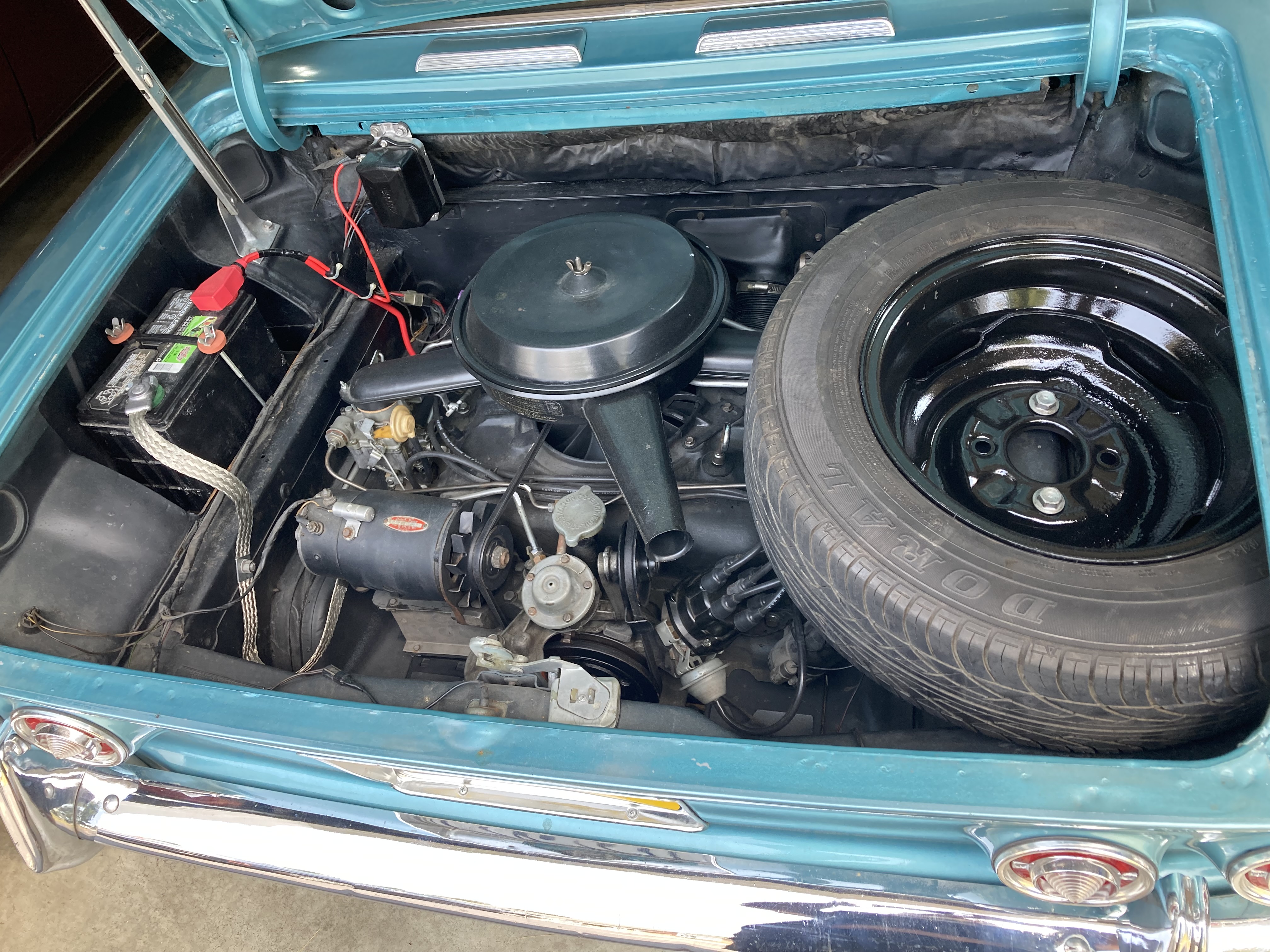

And for today's "well that's interesting, but not great" moment - I present to you a generator on an alternator mount:
I put this belt on the car about 2 weeks ago as a replacement for a Clark's belt that seemed to keep getting loose (had the same issue with a Clark's belt on the Corsa as well). This one is a Gates 3V560, and I noticed yesterday after we ran some errands that it had rolled over - you can kind of tell in the picture. It's still tight and didn't jump off, no overheating or charging issues, but not great that it is flipped either.
I started looking at everything and finally realized that the generator is installed on an alternator mount, and probably throwing things out of alignment. I dug out my spare mounts and put them side-by-side for some measurements:
These aren't exact measurements, but it looks like the generator is sitting about 3/16 of an inch lower on the alternator mount, and maybe up to 1/8 inch to the driver's side of the car. Looks like I found a project for this weekend....
John
1966 Corsa Convertible
Posts: 6433
Re: 1964 Monza Sedan
Good catch!!!! That will flip the belt. BTW I have also had issues with the Clark's fan belts stretching.
Well the upside is you have an alternator mount, which are getting scarce! Folks have been converting from generators to alternators for years and that has used up a lot of the alternator mounts.
Nothing wrong with a generator, but it is getting more difficult to find a shop that can rebuild them.
On a EM it is easier to just install an internally regulated 10DN style alternator since the re-wiring is actually simpler vs. wiring in the stock 10SI alternator with the external regulator. Also the 10DN rebuilds are plentiful (so far) and I've noticed the rebuilt Corvair 10DN alternators are getting harder to find. The only issue with installing a 10SI is you need the front housing and fan from an old 10DN Corvair alternator.
