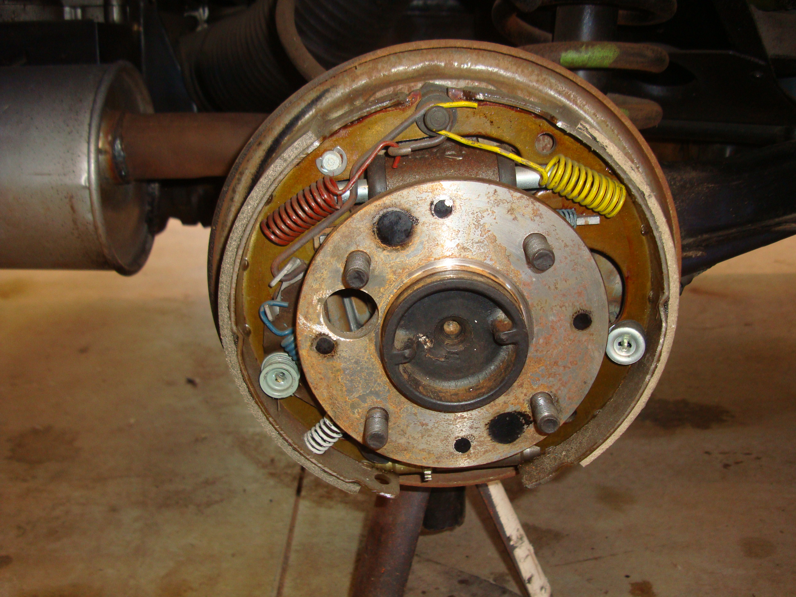

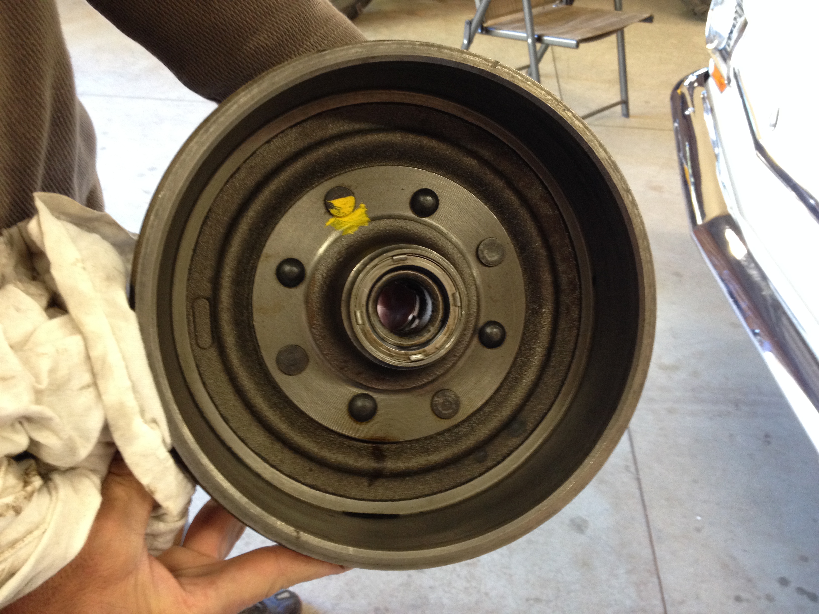

LF brake drum/hub removed for first time.  Note rivets, knockout plug and yellow inspection marker

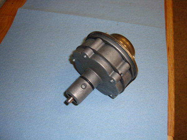

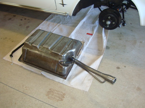

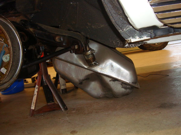

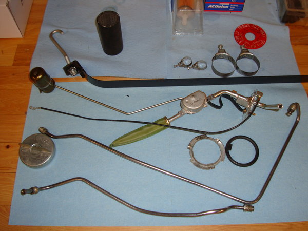

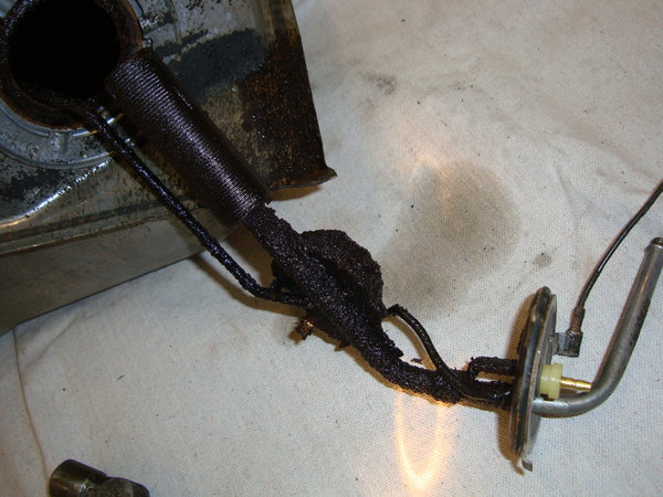

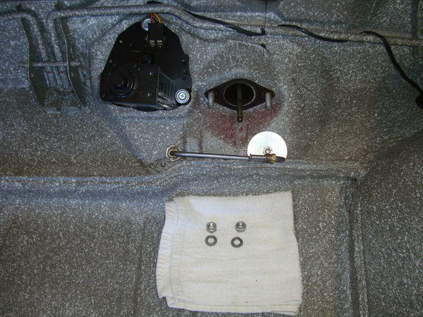

Good afternoon all, today I will discuss the actions taken to get the fuel system back in working order.
Since this car had not run since new I knew that the tank and fuel lines would most likely be fouled and the fuel pump would need to be replaced. I was very surprised to find about 3 gallons of fluid still in the tank, I did get some drainage when cutting the rubber fuel line at the tank outlet. The "fluid" was dark red in color, somewhat thick and smelled really bad. When I opened up the tank it was fouled bad, but poking at it there was no rust. I took this and the filler to a local radiator shop to get cleaned out. After boiling out for a few days the tank was fully cleaned. When I got home I flushed it of any remaining "finds" and sprayed with WD-40 inside and out to prevent any rust till it was installed in car.
I then performed a fuel oil flush of the fuel lines (tunnel, fuel pump inlet and carburetor feeds) followed by air blows until I was happy with the results. All lines looked good when completed. This took about 5 days to complete. I then put a temporary fuel filter in the left fender well (soft spot) to monitor any foreign material transfer. After 2 months all is well and this filter will be replaced with 3/8" rubber fuel line as original.
I replaced the fuel sender and O-ring, fuel pump and filler rubber. Once all was put back together I did a final fuel flush discharging from the carb feed lines. The filter socks showed no sighs of foreign material. All together I spent about 2 weeks on this. brakes came next....
new fuel pump, got this at NAPA, on the shelf and new (not NOS)
tank on its way out, note undercoating, overspray and "blackout" of rocker bottoms

Looks bad but was completely cleaned out and in use today
the sender and O-ring were replaced
all parts original except sender and O-ring

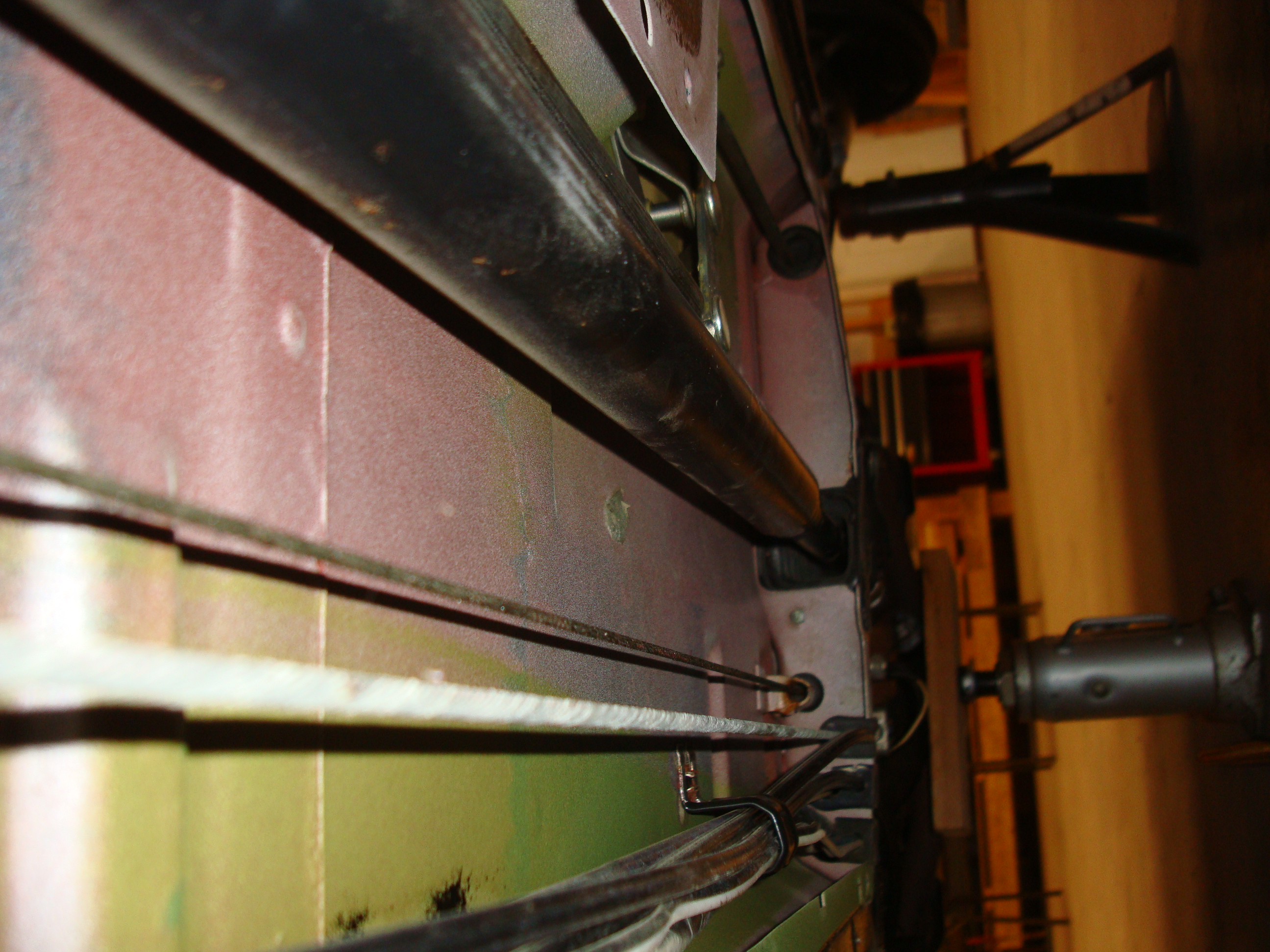

tunnel with green primer

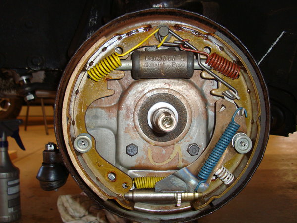

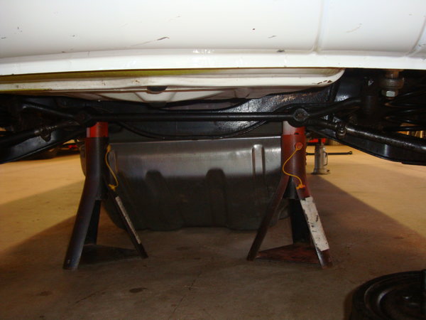

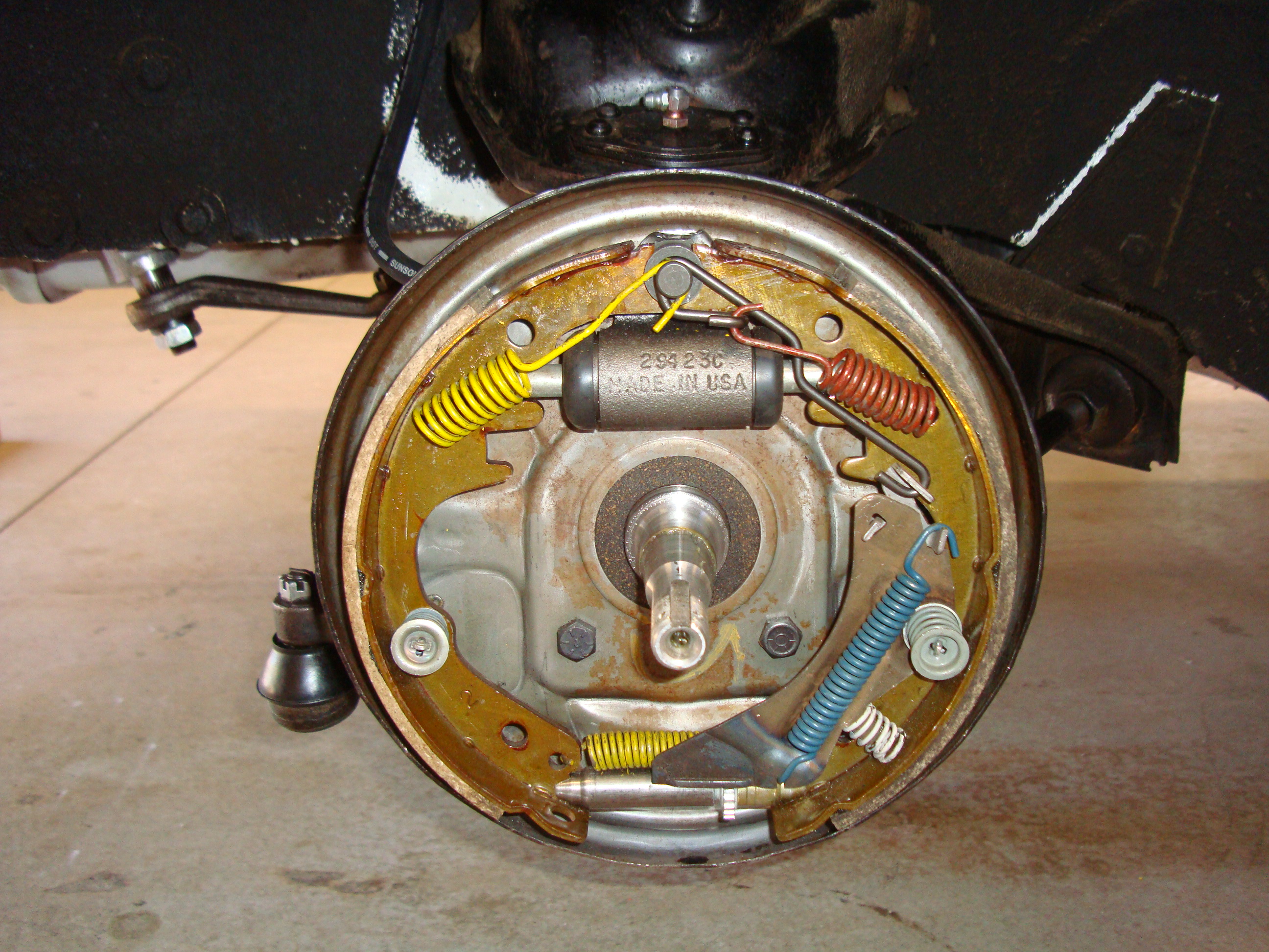

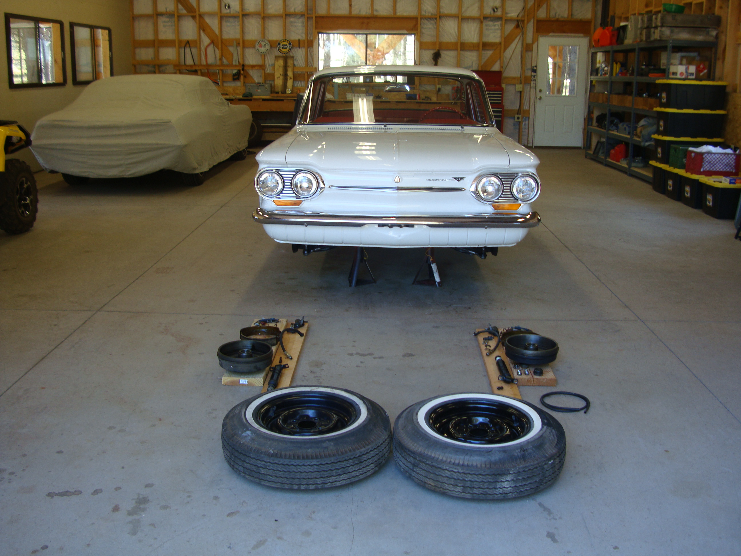

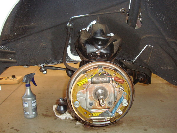

Good evening all, today I will discuss what was done to the brake system to bring it back to life.
When I purchased the car the brake pedal was stuck in the "up" position. Not surprised since the car had sat for 50 years. When I got the car home I opened up the master cylinder to see what the condition of the reservoir was. To my surprise it looked absolutely new but was empty. Where was the fluid. I would investigate this in about 2 months after the exterior cleaned and polished.
Now for the brakes. I jacked car up on stands, removed wheels and started to investigate. I pulled all rotors and no indication of brake fluid loss. Then checked all backing plates and there it was, the left rear backing plate and rim had indications of brake fluid loss from some distant past. Further investigation showed that the copper gasket from the flex line to the wheel cylinder had failed allowing the loss of fluid.
All brakes and rotors were absolutely new condition. The "self adjusters" would not move as the white grease has hardened. I removed all components, changed all the wheel cylinders and flex lines as well as the master cylinder. I flushed all brake lines through the flex lines until I was happy with results, then connected lines and completed bleeding. All steel brake lines were very clean, obviously very little air (oxygen) has gotten in the system. I used less than a quart of fluid to flush and bleed the system. This was the easiest part of the "return to service" of this 63 Monza. Some pics to enjoy.
absolutely new, note rivets, yellow inspection mark and knockout plug

as found condition, note undercoating on inside lip of backing plate and yellow inspection marker (for bolting).  All wheels had this marking.  Also note large brake pad to rear all wheels
flex lines, wheel cylinders and shocks replaced.
note placement of label and spatter paint, beautiful.  Hadn't seen light for 50 years.
close-up, note wire placement and sealant dripage

all disassembled, rear
all disassembled, front
left front reassembled with new wheel cylinder and flex line, mad in the USA
note undercoating and chassis paint
