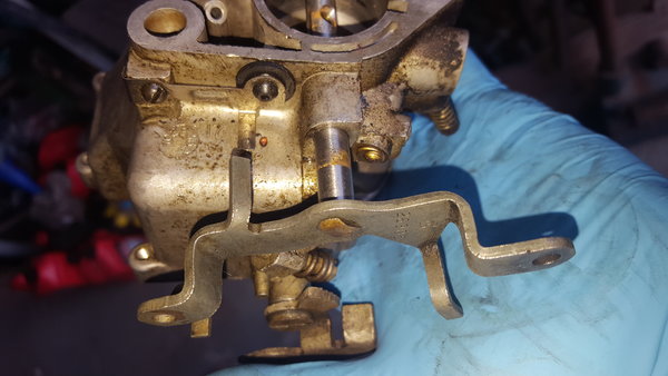

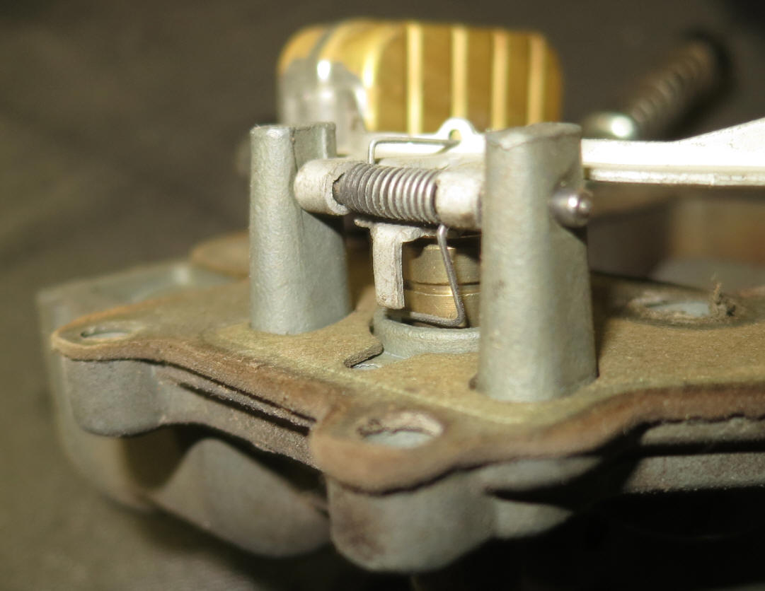

Well...this is a tedious job!!! The teflon bushing upgrade kit, from Clark's, needs a reamer. You can only do so much with the drill bit, and the teflon tube is so very crushable.
Finally got both sides, of one carb, in. And it looks good!!
Other carb has springs and o-rings, that i didnt see earlier...and thats the one that was vacuum leaking the most. LOL. Hope the left side carb comes out as good or better. Im sure it will take me less time, now that im a pro. (yeah right)
Instructions are kinda hard to follow...

Well...finally figured out what was wrong, and got my venturi clusters to stop leaking, and gas to stop puking out of the carb vent holes. Yea...we have prolly all done it, but hopefully ill not let it happen again. I am printing this picture, and stuffing it into the rebuild section, of the Bob Helt Carb book. = / Driving nicely, and carbs performing better now.

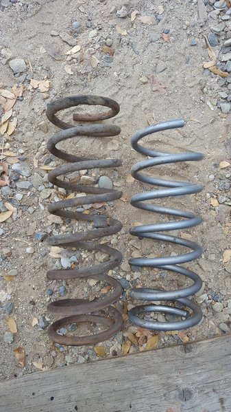

Hey guys, been driving this one daily, since someone pulled out in front of me, and totalled my commuter. Love driving the Corvair tho. My 65 Monza sports sedan, project, came with 2" cut, stock coils, so I have been wanting to see what driving a more "raked" car looked like. Well...my bro came over today, and helped me swap them out. Looks great, hood is WAAY down there, while driving. Will see how she handles commuting tomorrow morning. ![👍](//cdn.jsdelivr.net/gh/twitter/twemoji@latest/assets/svg/1f44d.svg)

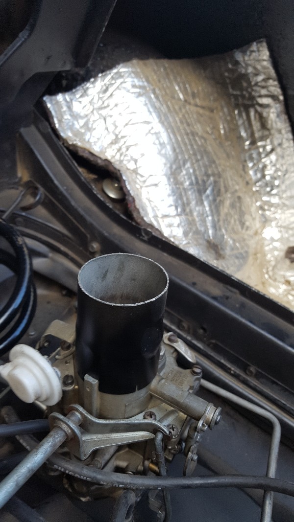

Got my individual air cleaner setup, and PCV system built/installed. Stock, on-shelf parts used, and didnt break the bank. ![👍](//cdn.jsdelivr.net/gh/twitter/twemoji@latest/assets/svg/1f44d.svg)

Well....as some (or most) here were prolly figuring to themselves, the air cleaners used were a bit more than a little restrictive. Went back to stock this A.M., and mopped up the oil mess. ![😐](//cdn.jsdelivr.net/gh/twitter/twemoji@latest/assets/svg/1f610.svg)
