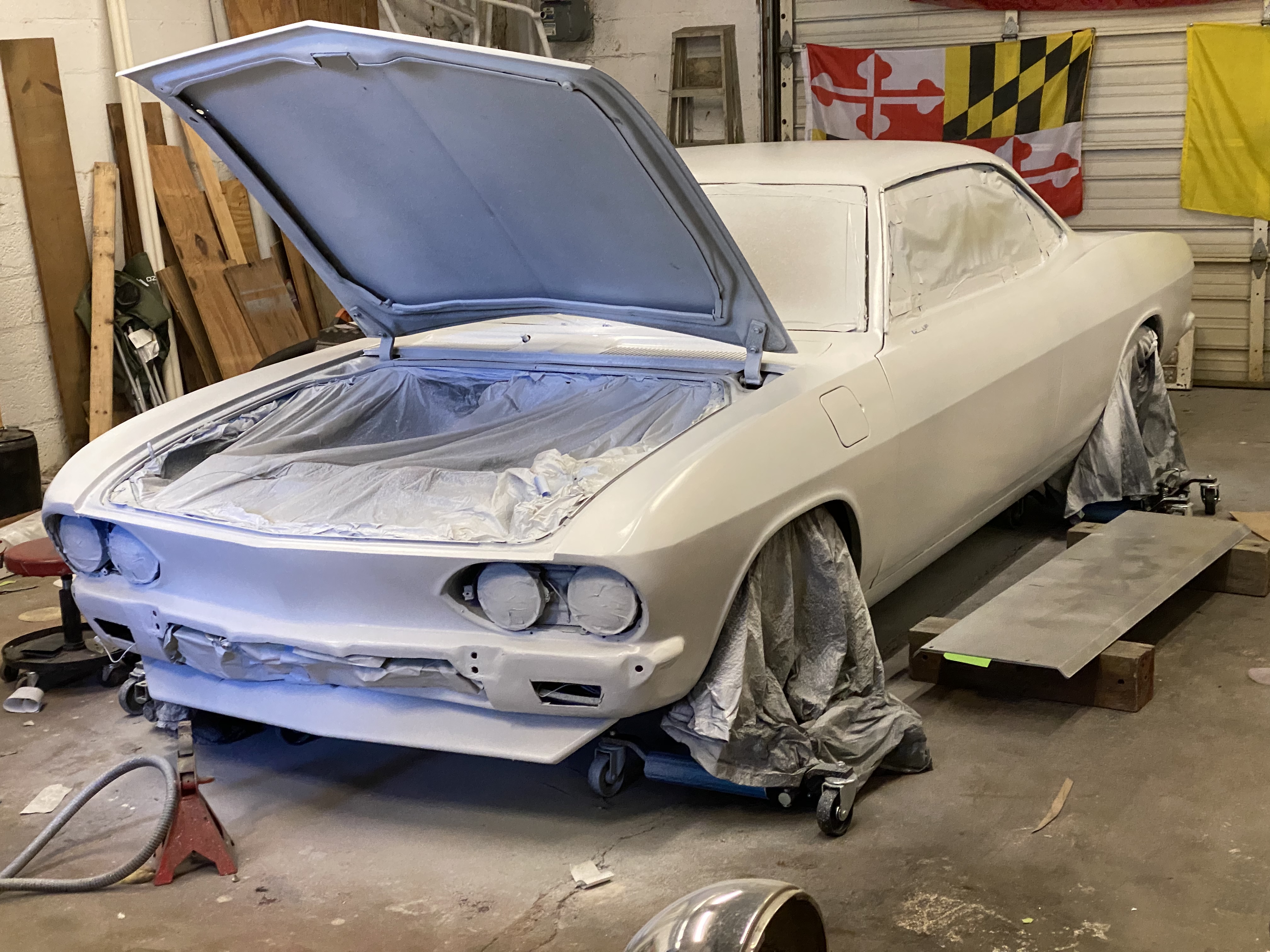

First coats of Championship White

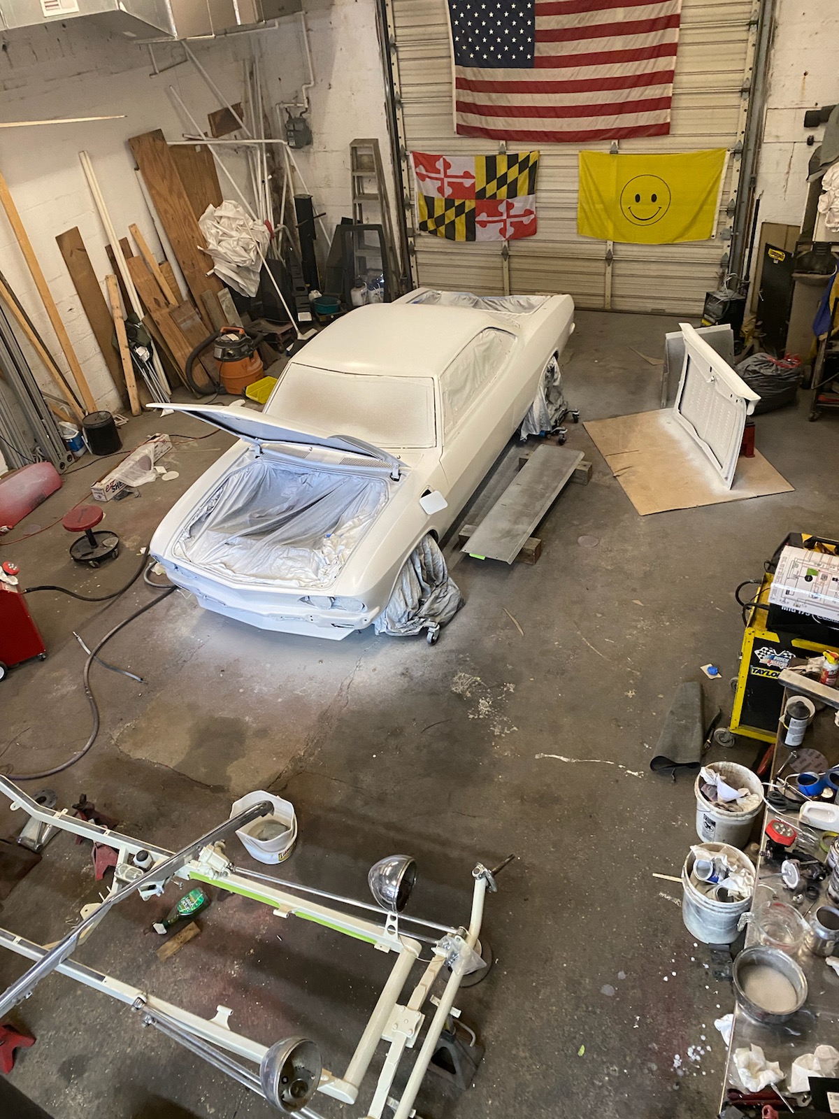

I got the second heavy coat of white on the car today. The third and final coat of white goes on tomorrow ( Monday 11 - 8 j
Then sanding with 600 grit. Hopefully I wont need to touch up any of the white.
The 4 heavy coats of clear filled with Roth Snocaine metal flake. Then 4 more heavy coats of clear…….then cut and buff

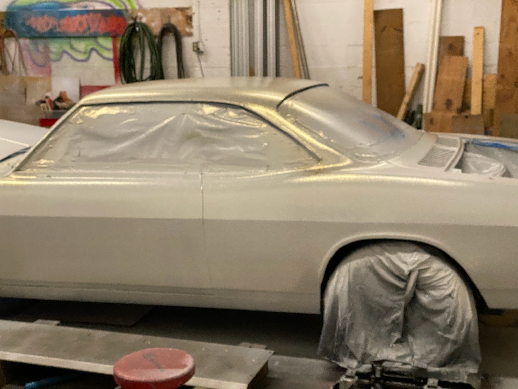

Once again, doing shit that I have no or very limited experience with. I added warm beer metal flake to clear. It sprays real easy. This is just the first coat but you get the idea
Film at 11

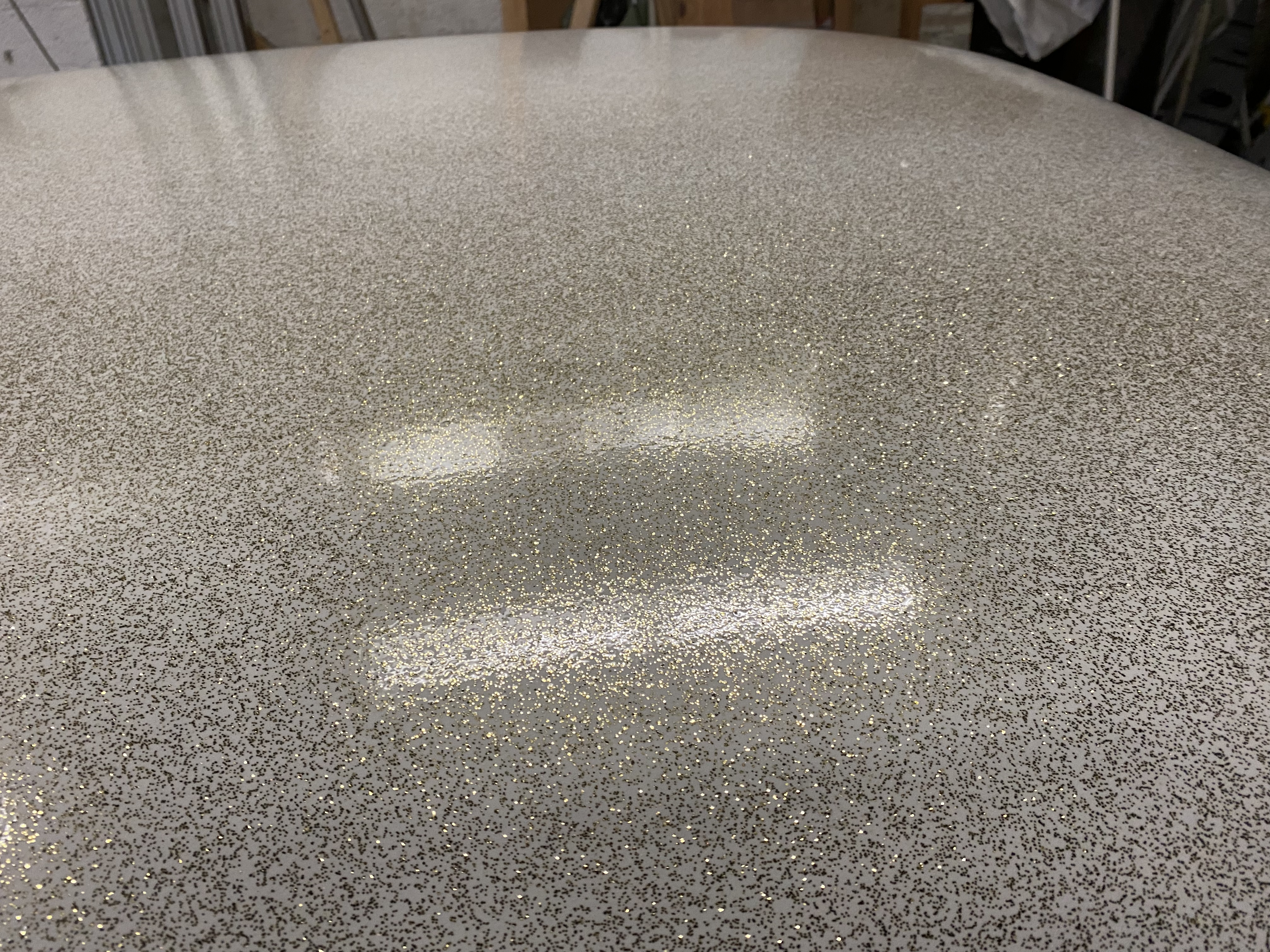

I did a second coat today. The roof is looking good. THe first picture was about 35% flake coverage. Today's photo is more like 65% flake coverage. I have ordered a bunch more flake....gets here on the 7th of December.

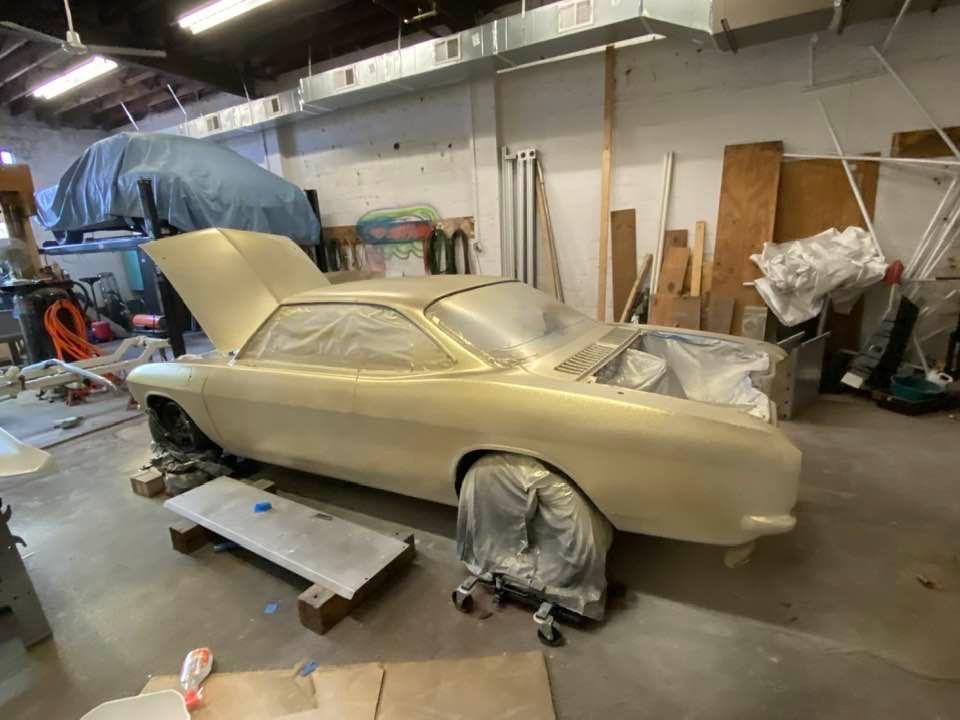

Third coat today……about 75% coverage…..more to do
Film at 11
