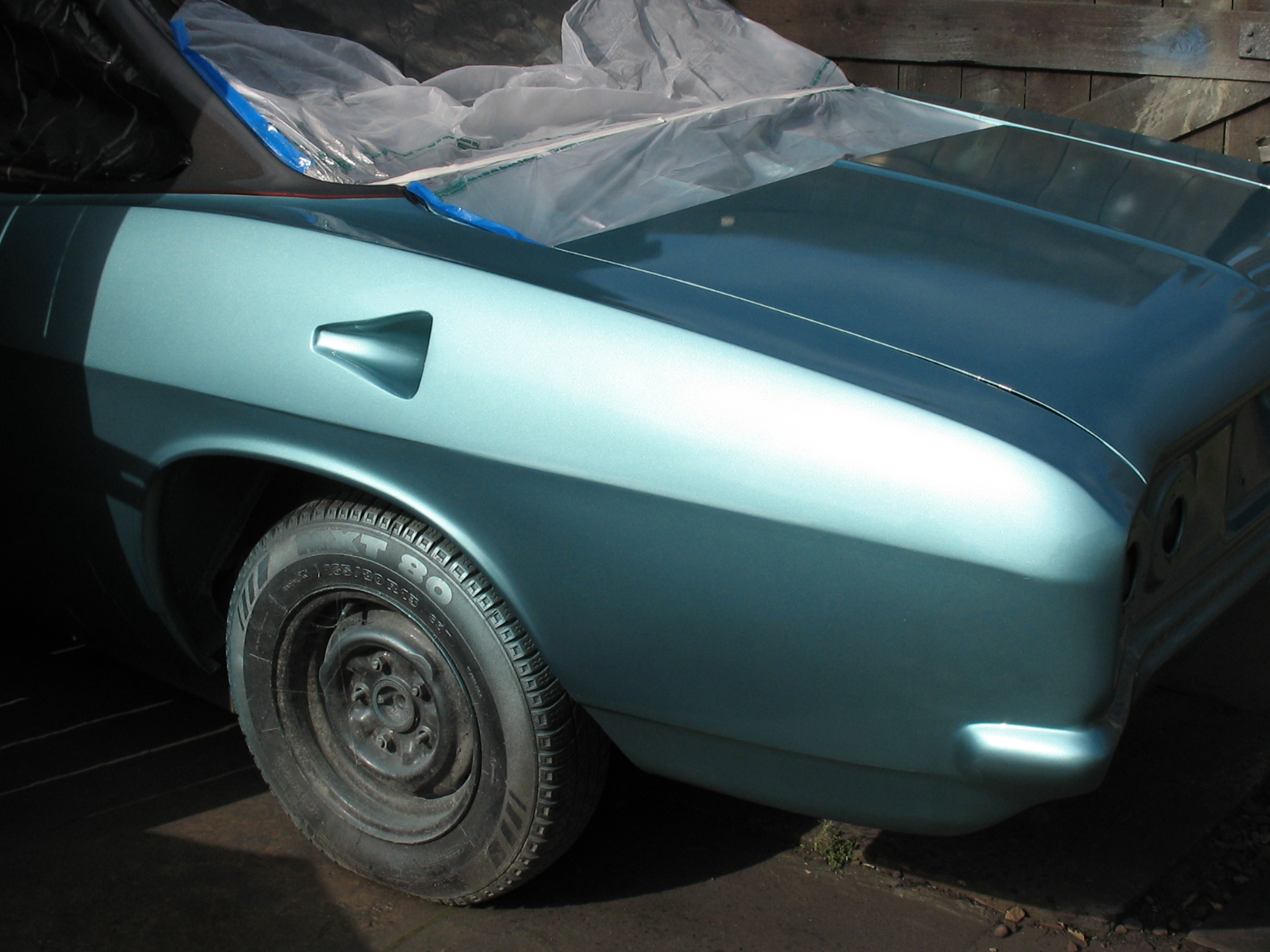

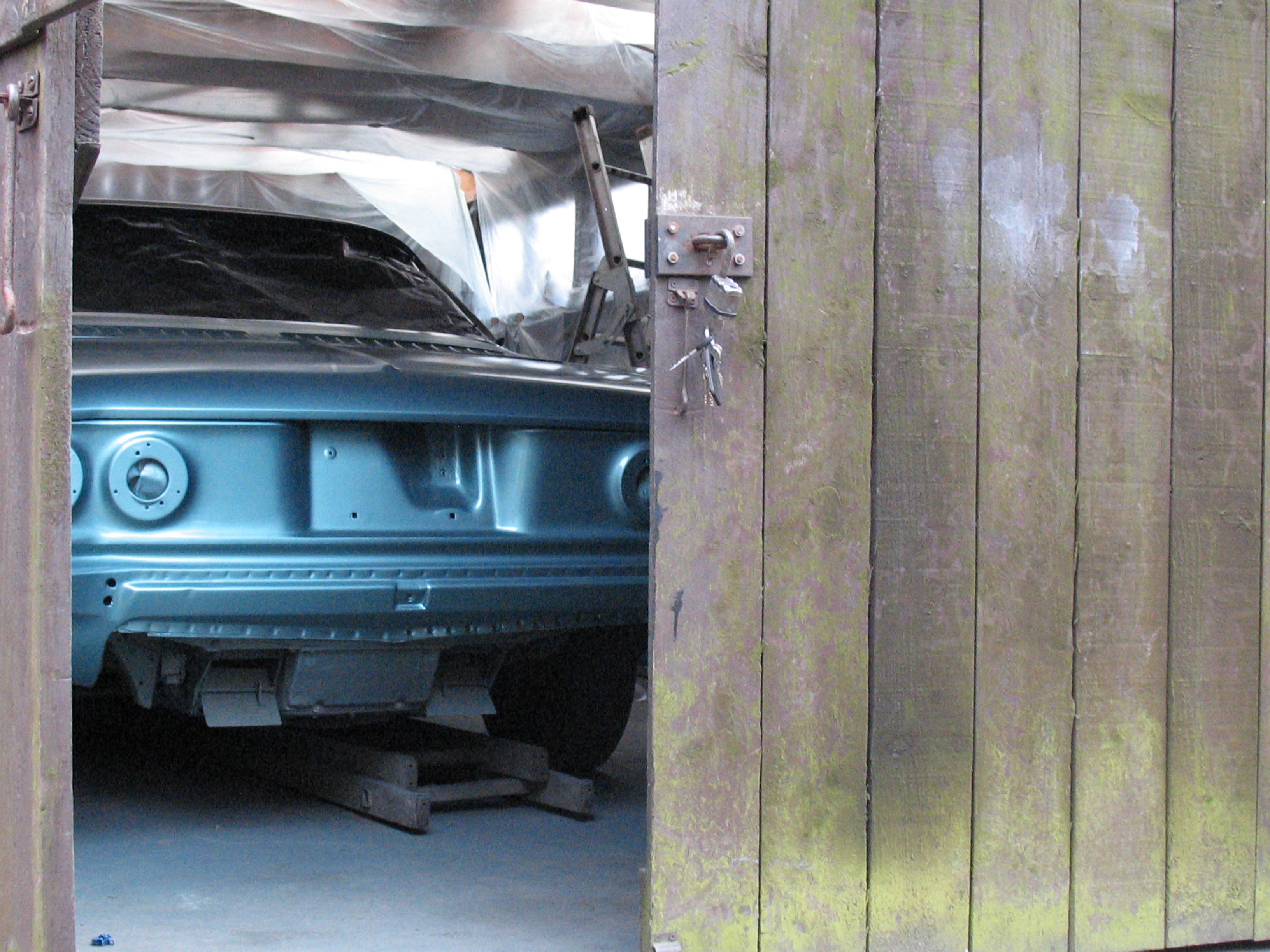

PEEK-A-BOO
Gregory_Miller
Posts: 921
Re: pensylvania bondo bucket
Post by Gregory_Miller »
OOH! Image

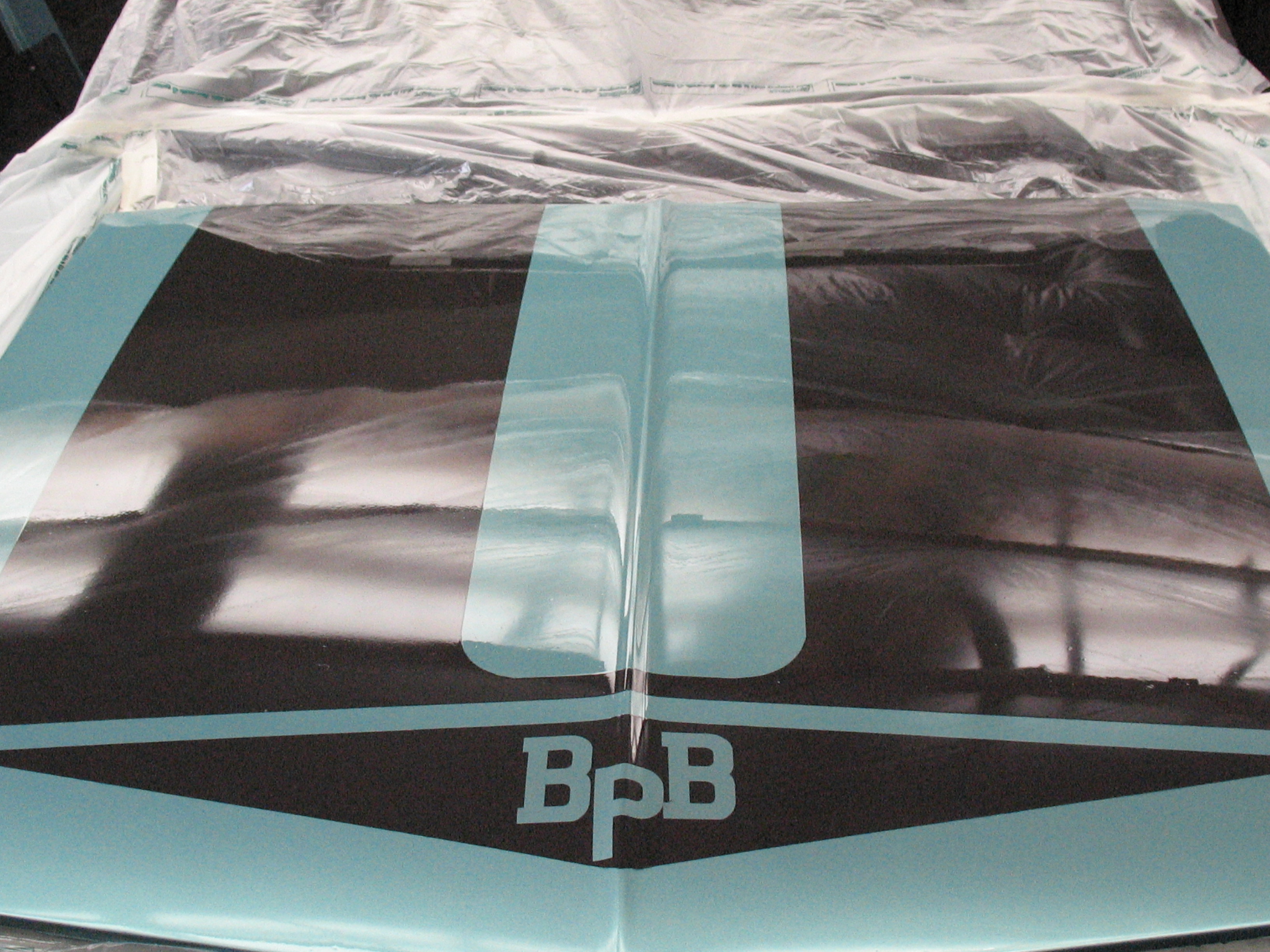

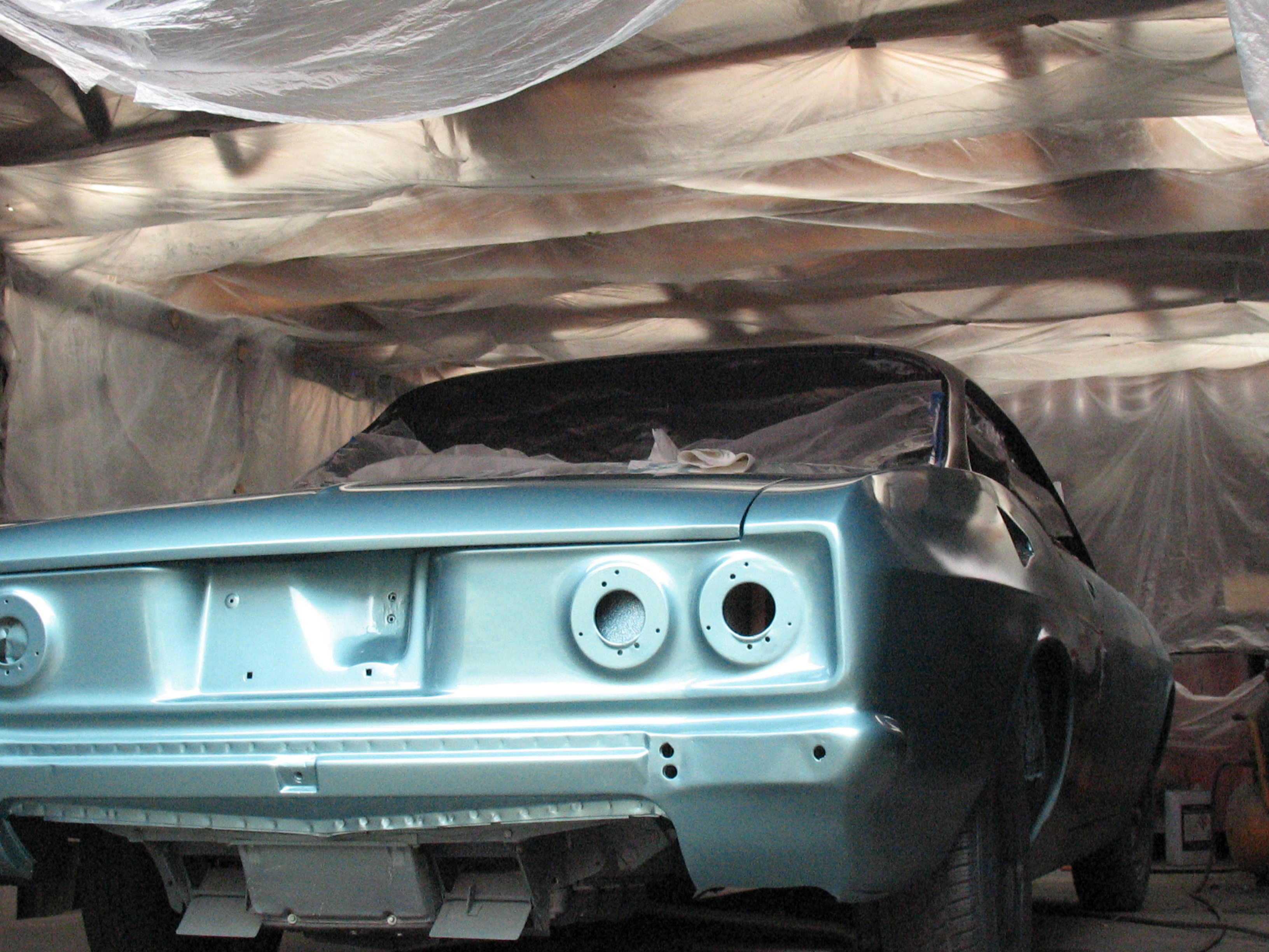

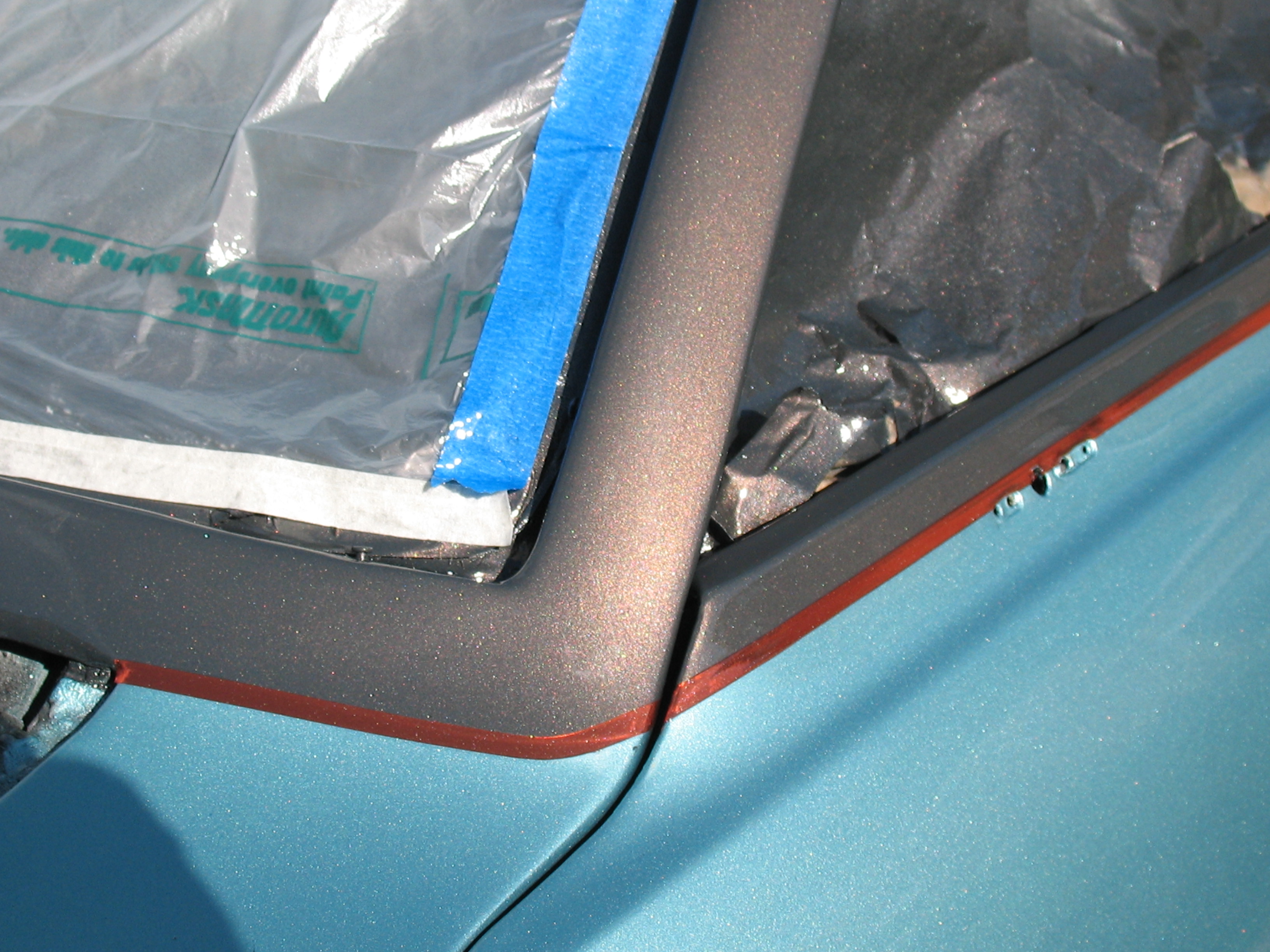

way too much dirt flying around inside garage, despite my efforts to keep it out.....this is my second attempt ...might try to repaint clearcoat outside....had decent results before....why does this thing have to fight me at every turn?

rfw66 wrote: Sun May 21, 2017 6:11 am Stunning color! Show us the rest! [emoji102].......not done yet, clearcoat keeps giving me problems with dust.....will try it outside when winds drop off...if they ever do

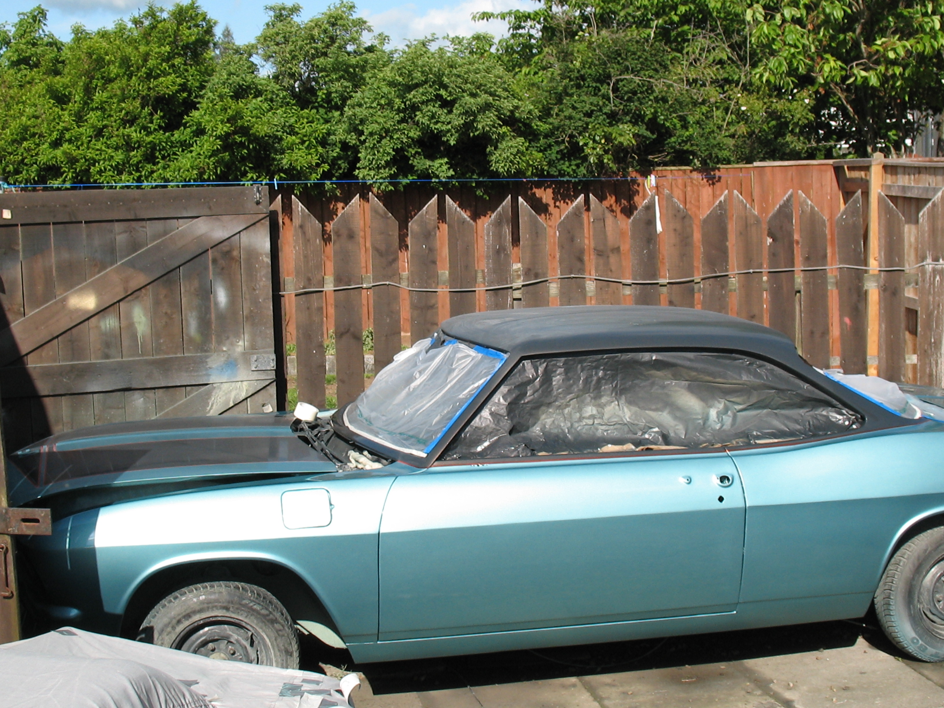

just did the rear end outside to test the water, much less dirt in paint, but showed up a few flaws which might be hard to put right at this stage...far from perfect but might live with them

You mentioned that there was too much dirt flying around in the garage.
Many many years ago my dad showed me some tricks to painting cars in a regular garage. He would first blow down everything from the ceiling then sweep, then do it again and then hose down the floor and squeegee it. Hang plastic along the walls. Wet the floor again then roll the car in. Wipe down the car and prep it. We got the best results from that even though we didn't have a professional spray booth.

Love the pBB logo! Although no more bondo here.

getting there...still a little dirt, might flat and give one more coat of clear later....happy with the copper and orange pearl
