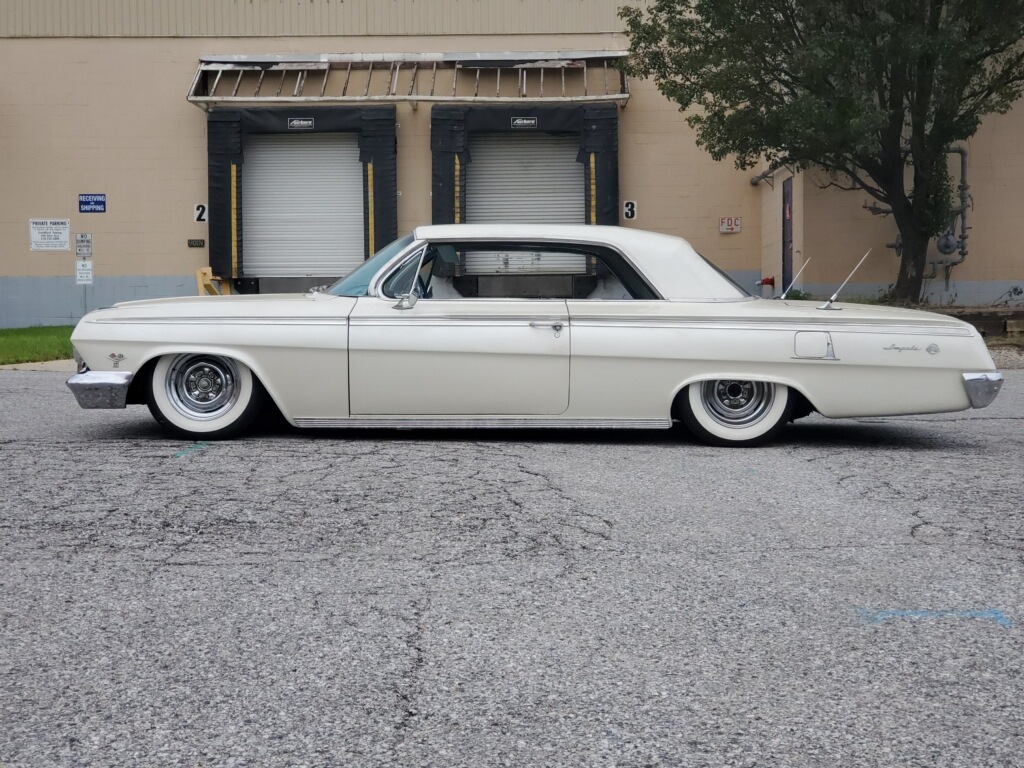

For the last 9 months, I have been helping a close friend of mine with his 62 Impala. It was to be a 2 week deal and back to work on the Corvair. The project just exploded as we did the work. We did all new aftermarket suspension front and rear with air ride. We replaced the front floors, put new rockers on both sides, new trans tunnel, complete new electrical system front to rear, added power steering…etc.
Today we took the beast out for its first ride outside the garage. We have a cracked fitting on the left front brake and the right side brake light is inop….easy stuff to fix.
So since this took up Corvair time and space, I thought you might like to see what we did

Wow, that Impala is nice!

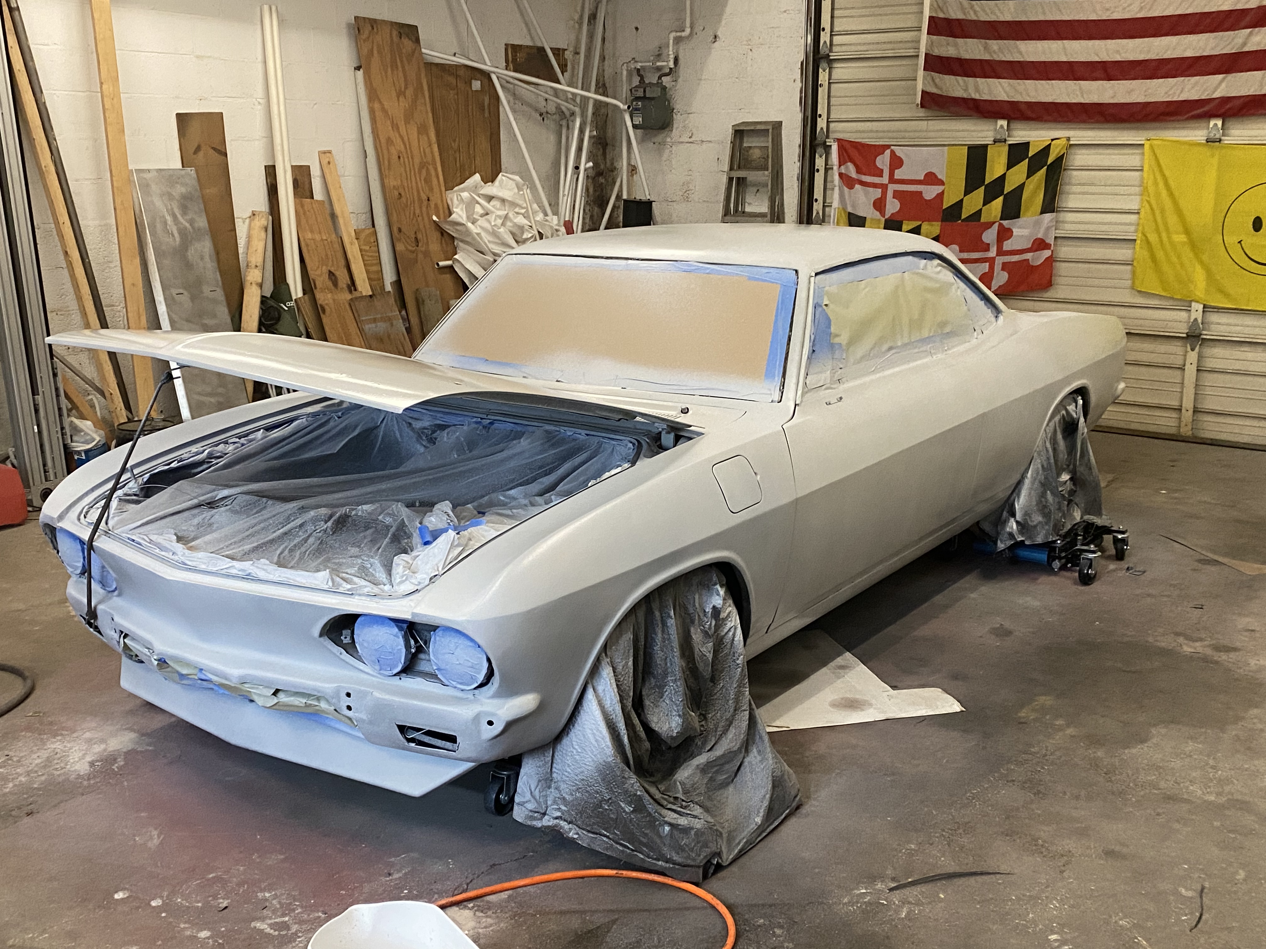

FINALLY….. stuff is about to get real. Primer goes on tomorrow morning

Roof, pillars,hood and left side blocked to 400 grit.
I did find a couple of spots to touch up other wise, pretty damn happy so far

I now have two coats of primer on the car. I have blocked just about everything with 400 grit. One more heavy coat and the guide coat blocked…. Almost color time
