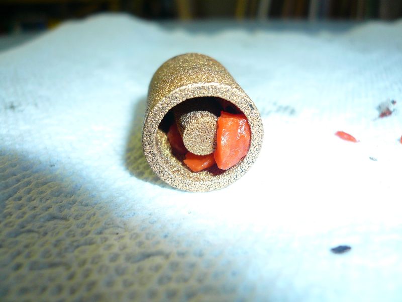

scottydont wrote:Well.... I found the problem, but this really confuses me.
Something caused the fuel in the float bowls to gel. The fuel in the lines is good, no gel upstream of the sintered brass filters. but in the float bowls, and throughout the passages, there were globs of gelled fuel.
This isn't contamination from the tank or lines, and it's not left over varnish. I chem dipped and scrubbed the carbs and blew the lines out before rebuilding them initially. I also drained the tank and lines, changed the filters, and refilled with new gas at the beginning of this whole process. The only thing I can think of is some kind of chemical or microbial action that caused the gel... I've seen this with diesel, but never with gas. At least it explains the crazy shifting symptoms as passages blocked and cleared.
Anyway the carbs are all cleaned up and back on. Hopefully whatever caused the problem is out of the system. Time will tell.
Glad you found the problem. I had a similar issue a few years ago, did your gel look like this?
I never did figure out what caused it, only happened once but was a mess.

Similar looking Marty, but mine was a little more brown colored. Also no globs that big (BTW isn't that on the fuel line side of the filter? Mine was all in the float bowl, the lines were clean.)

scottydont wrote:Similar looking Marty, but mine was a little more brown colored. Also no globs that big (BTW isn't that on the fuel line side of the filter? Mine was all in the float bowl, the lines were clean.)
Anyway, I have the carbs pretty well tuned. It's a little choppy at idle, (dunno if that's normal or not) but considering the NEW problem I had this morning that might pass....
Apparently I'm getting fuel running down the carbs and into the engine. Enough that yesterday before I removed the carbs, the engine was hydraulically locked. I assumed at the time that goo had caused a float needle to stick open or something. It was locked up again this morning though and there was at least a quart of fuel in the crankcase. So I pulled the plug and let it drain while I went to the parts store to get more oil. 45 min later it was sill dripping oil/gas at the drail plug at about a drop every two seconds, so I MAY still have a fuel leak at the carbs.
This is one very reluctant engine.....
Yes, that picture is of the bronze inlet filter. I also had a canister filter in the fuel line before the pump. It was full of that crap. Cleaned it all out, never happened again. Very strange.

Gee wizz Marty,,looks like jelly beans in your filter? that is weird? I have not had any problems with weird stuff like that with the new gas,I have cars that sit for months and they fire up with no problems,That is just strange.

In my case Marty, the lines and in line filter were clear. All the "grunk" was in the carbs. So far it hasn't come back, but it's only been a few days.
