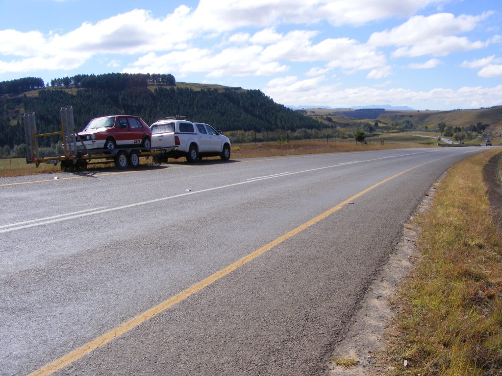

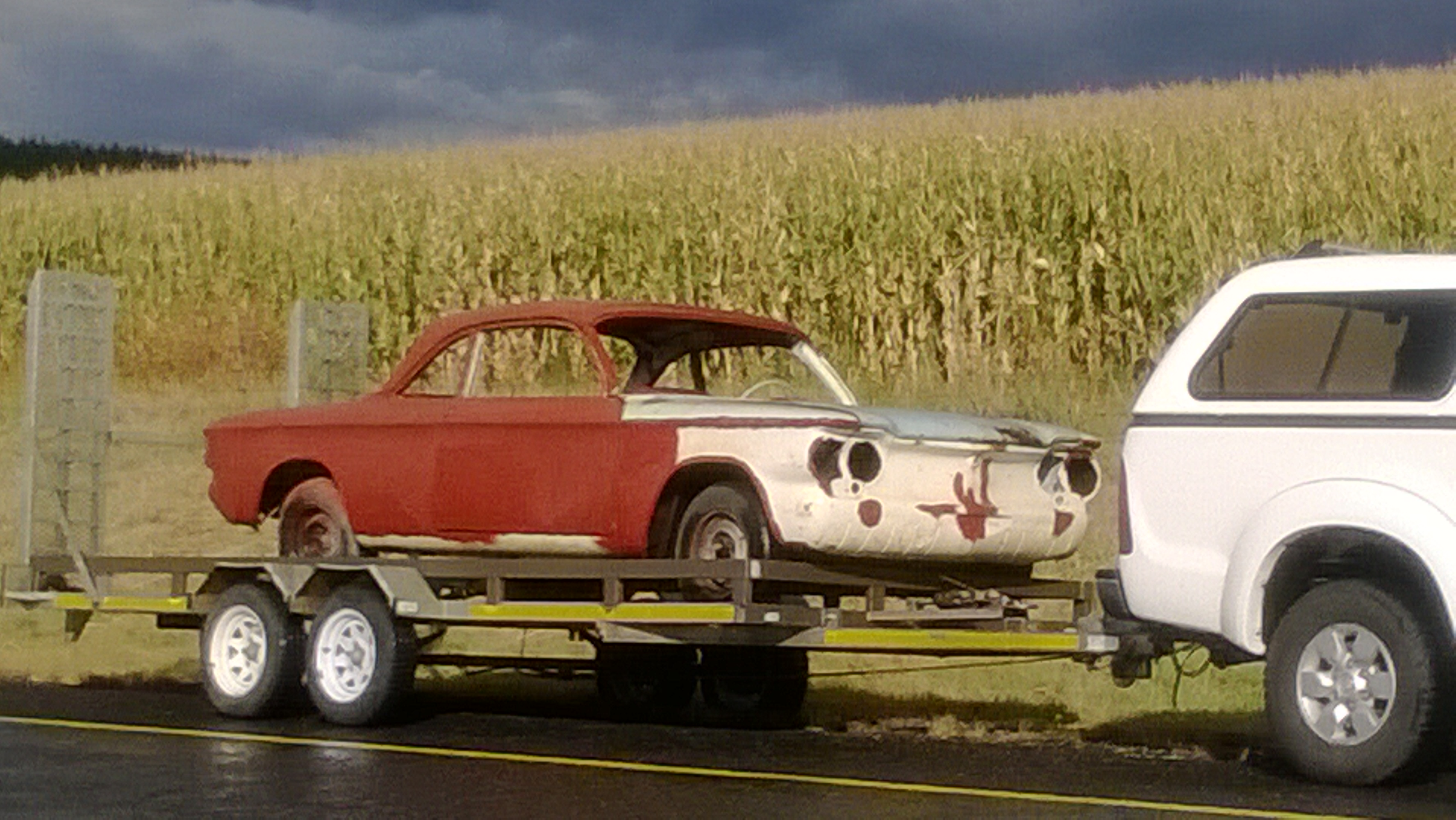

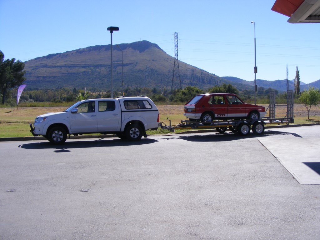

This trip did not go without it's own bit of fun I might add :rolling: . I stopped in a small town called Cedarville to fill up with fuel and took the opportunity to get some exercise by walking up and down the Gas station driveway at quite a pace, much to the delight of the locals who ten to one thought what is wrong with this old man. And so a minibus pulls up next to me and a guy lets down the window and asks "can you please lend me R100.00", I looked at him and said "do I look like father Christmas :think: , he gave this quirky smile and said, "no, but maybe, I am father Christmas" and held up a rim and tyre :tu: . I then looked at the trailer and saw I had lost a wheel :dontknow: . Pans out it came off oustside Queenstown, these guys saw it come-off and had been trying to catch-up with me for the last 300kms. Needless to say I offered "father Christmas" R300.00 for my tyre and rim. BUT IT DOES NOT END THERE Nooooo :nono: . Before I left Pietermaritzburg I refitted the "lost" rim and tyre as the spare I had put on went flat. Listen carefully now, yes Mr so clever forgot to torque up the wheel nuts and yes I lost the same wheel AGAIN, this time for good. Cost me R1400.00 to replace :banghead: !
Anyway there is quite a story behind this car and how it became what you now, the best person to tell the story is Gary, maybe he will tell the story first-hand so that I do not get the facts wrong. A story that will be a testimony to what lengths we as South Africans will go to, to own a Corvair Coupe, I think some will not believe what Gary will tell you. Gary when you read this post please tell the story in your own words my friend. Once I start the rebuild thread I will start a new thread.
Thank you again for an awesome forum and platform to share my love of Corvairs with fellow enthusiasts :wave:

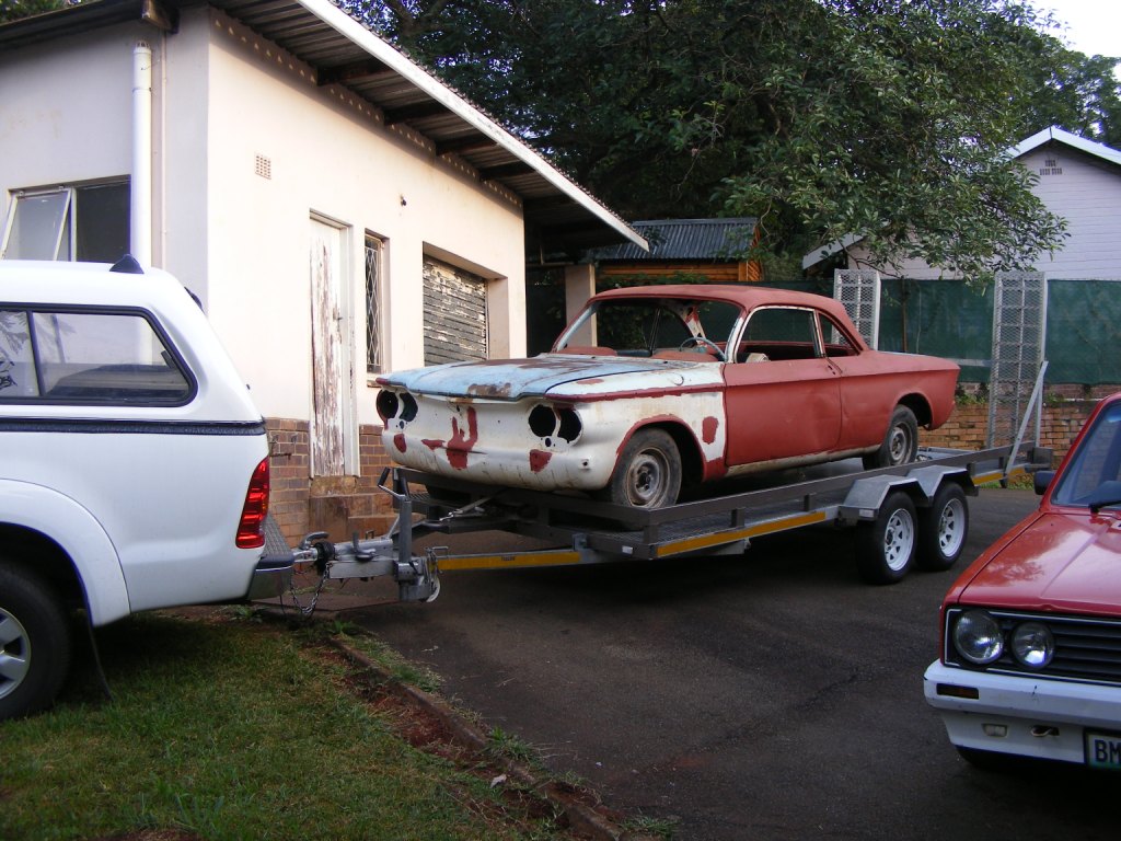

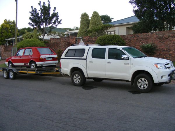

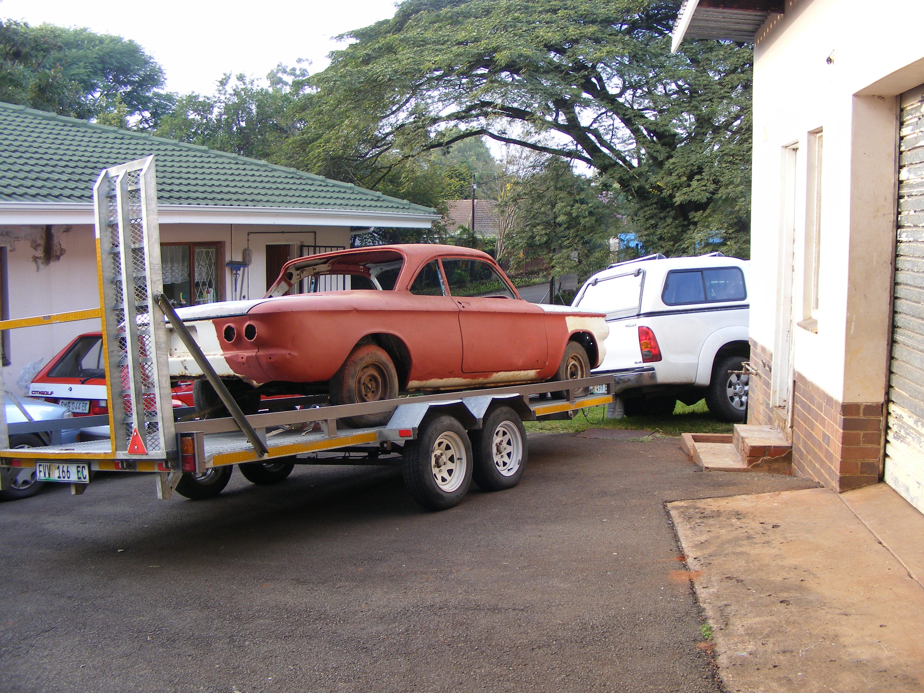

Coupe has been loaded and Golf at its new home

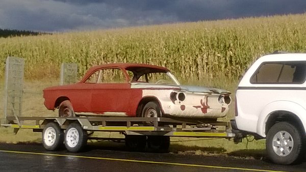

About half way back to Grahamstown outside a town called Maclear

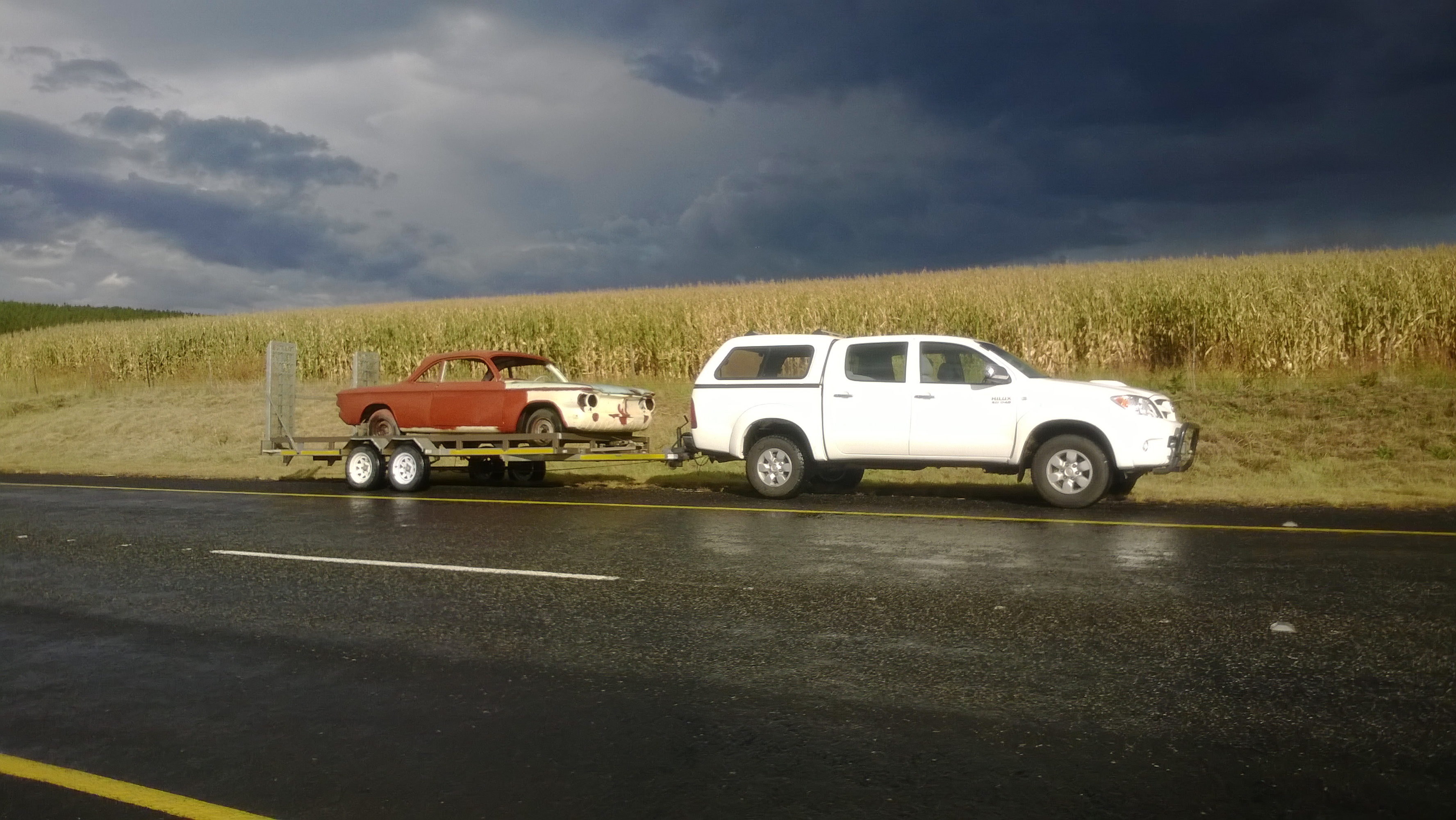

Had to stop and wait for a thunderstorm to pass last I experienced a thunderstorm like this was in Angola

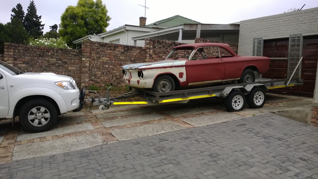

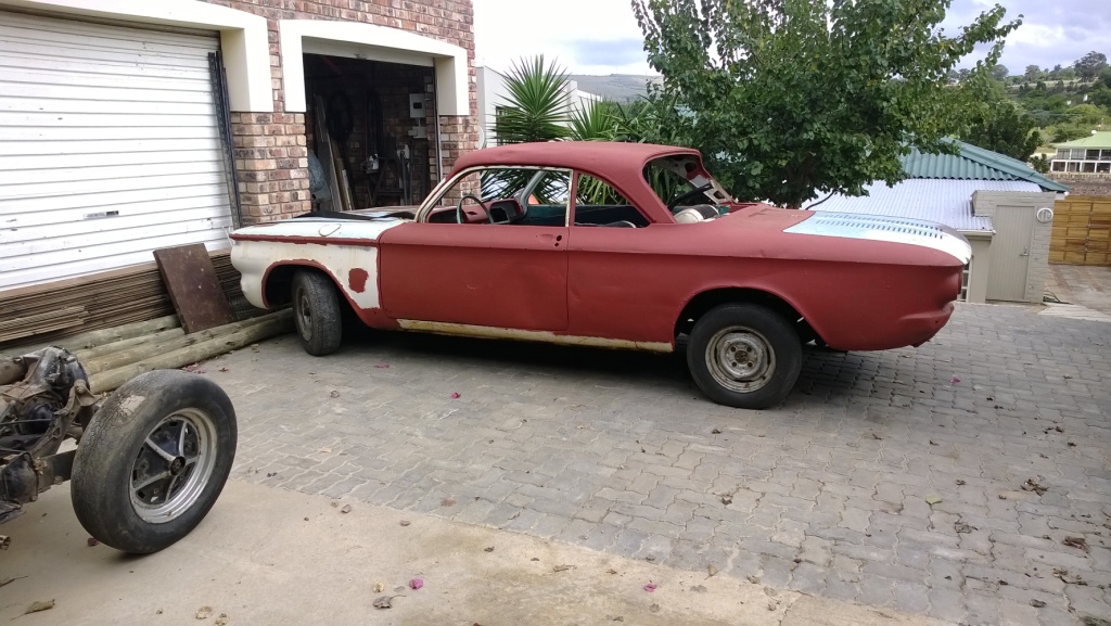

Back at home in Grahamstown 7:30pm on Sunday evening. Thankyou for a safe trip!
Finally got the old girl up to my workshop. Sadly she has not been touched since then :(

I have spoken to Gary and asked him to tell his story of this car as it is built out of a 4dr and a Coupe and that is all I'm saying for now. Gary is also under the whip at the moment and is on his way to Brazil to go and test a new Ford Ranger 4x4 Dakar Race that they have built for a Client, so he has also been at the grindstone basically 7 days a week for the last three months. I have had the privilege of been taken on a tour of the workshop where these 4x4's are built and it is something to be experienced :eek: talk about professionalism these guys take it to another level :not worthy:

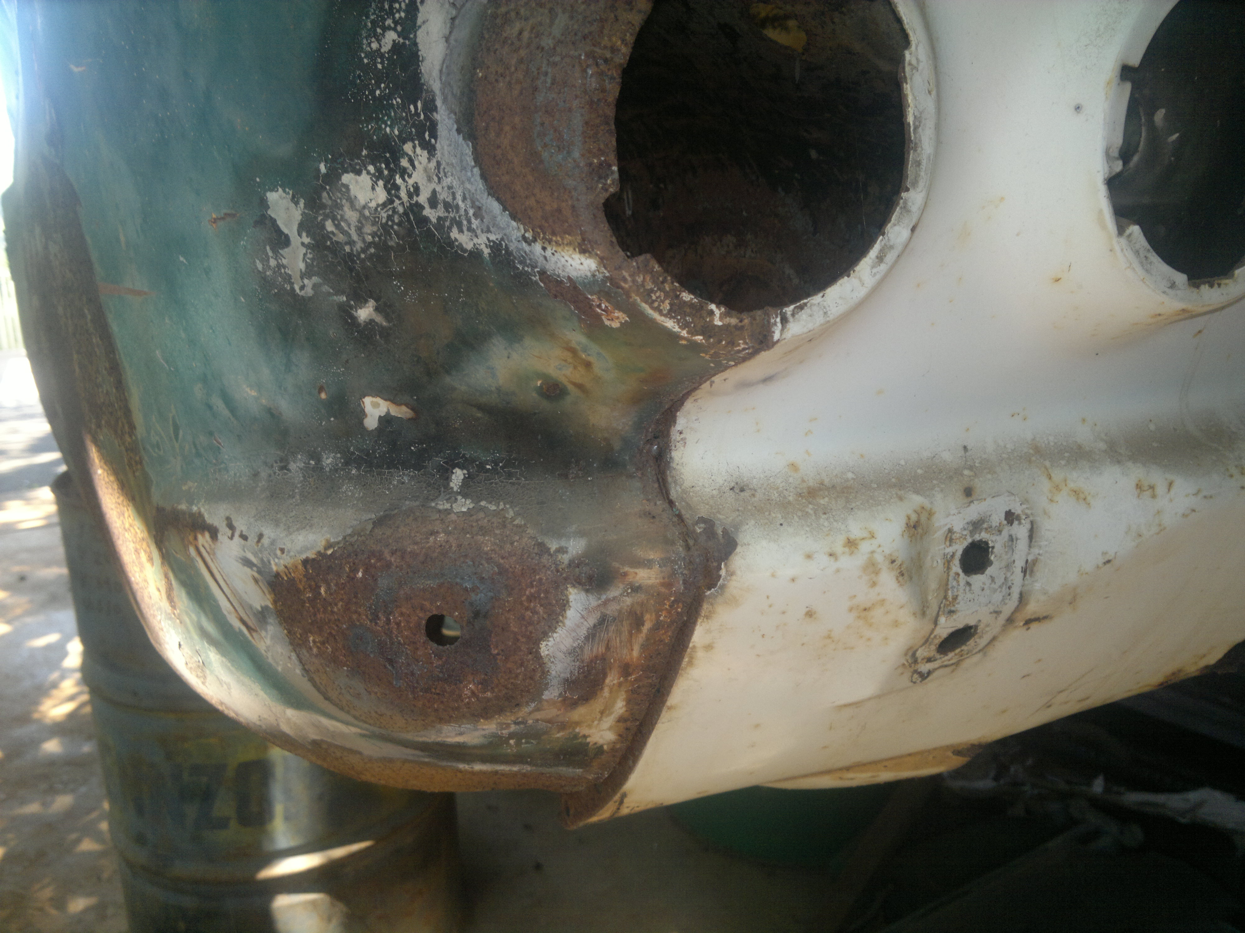

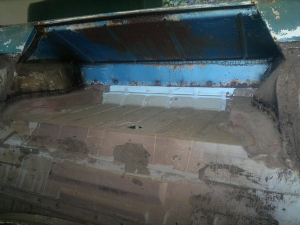

hello all,well i know its been a while but like henty my job is a huge demand on me,besides being chief technition im now also parts quality controller,this means not only do i check the quality of the parts we manufacture,but i preassemble everything as well.the day goes quickly for me and i love it,but i also love my corvairs and that is a bit of a challenge for me at the moment as i have very limmited time to spend on them.henty has had his eye on my 60 monza coupe for about 2 years now,it was really hard to part with it as it had real centimental value to me.my whole life iv wanted a 60 coupe 2 door and i found one in a place called tarlton,the same place which is south africas international drag strip for top fuelers.every year for the past five years we use their premises for our offroad racing event.4 years ago i found this coupe but what a mess,made hentys 62 coupe look like a rolls royce the car had been left on the ground and was bascaly rotted from the sills down,there was no floor and no boot well,i contacted my cousin that lived about 30kms away and he picked it up for me and about a month later trailered it down to me.i had already made up my mind that i was going to fix this coupe one way or the other.i was able to get my hands on a good 4 door 60 body and between the two i started to look at what i could do.i first started with the doors from the coupe,i took the doors off the four door and mounted the doors from the coupe,this told me that both the 4 door and the coupe shared the same windscreen and everthing was the same up to the door hinge pillars and a pillars.i then looked at the door sills and they were also pretty much the same shape as the coupe ,only the coupe had an outside skin right down over the sill.istarted to put two and two together an realised what gm had done.the whole under carrage,monococque,is exactly the same for the 60 coupe and the 60 4 door from front to rear.the front windscreen appature is also identical.so once i decided i could interchange body parts on to the 4 door i set about how much work would be involve to cut off the roof of the 4 door and the entire rearend but leave the floor and the monococque still connected to the original 4 door.the thing that worried me the most is i did not want it to look like a backyard job.i started off by rough cutting the 4 door roof and rear fenders off and then the teedious job of grinding off the metal thickness at all the spotwelds and stepped joints,i did the same on the rotten coupe body and found that the only rotten pieces i was left with on the coupe body was two small sections on each side just above the sill line to the rear.once i finished all the grinding,6 saturdays and sundays in a row and a fight with the neighbour and 42, 1mm cutting discs and 19 grinding discs later i was ready to do the transplant.i was really amazed by how everthing fitted as the two cars were built in two different countries,the coupe was built in canada and the 4 door was built in south africa,amazing that the jigging of the boddies from two different countries was so accurate,the only problem i had was at the top of the windscreen appature where the roof overlapes and is spotwelded to form the appature,there was a negitive on the top sides which i had to cut off and weld back on once the two sections married,i installed the doors an aligned everything before i started spotwelding,then i put a slight downward pressure downward on the rear by about 2mm noticed by the door gap and started to spotweld just by watching the door gap and a string line front to rear on the body line both sides.when i was finished spotwelding i still had about 1mm less gap at the bottom of the b pillar,when i released the ratchet straps that i used to pull the two sections together everything eveaned up all round,i then spotwelded the roof section.
then because of work the project was never touched again for the next two years and now henty has it,i will try to upload some pics but i battel with this.ok henty my brother i hope this is enough info,for those wanting to know more just ask and i will try to answer,sorry about the spelling .
garydup
Posts: 54
Joined: Wed Mar 31, 2010 9:40 pm
Re: I HAVE FOUND A COUPE from South Africa
Post by garydup »

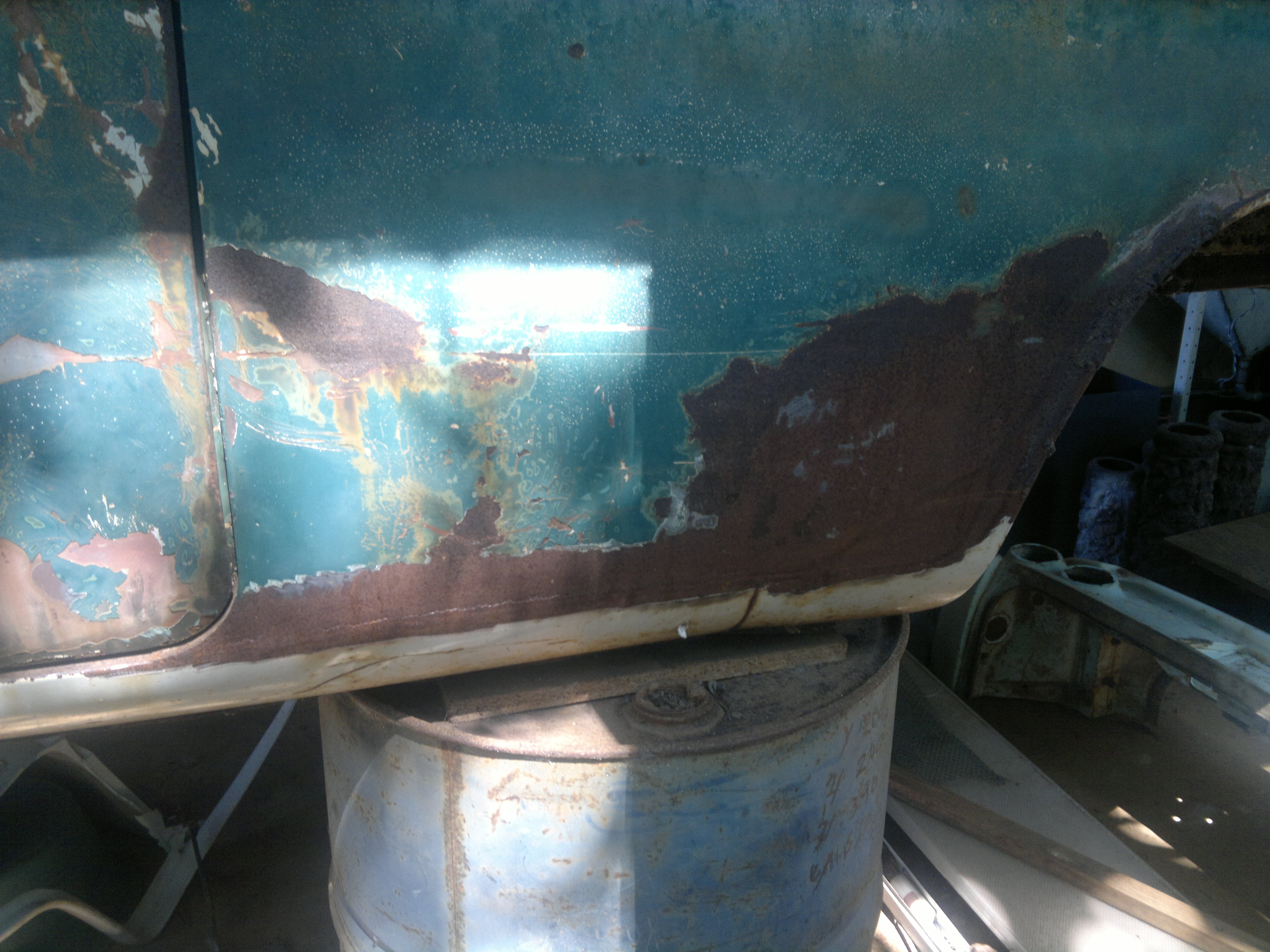

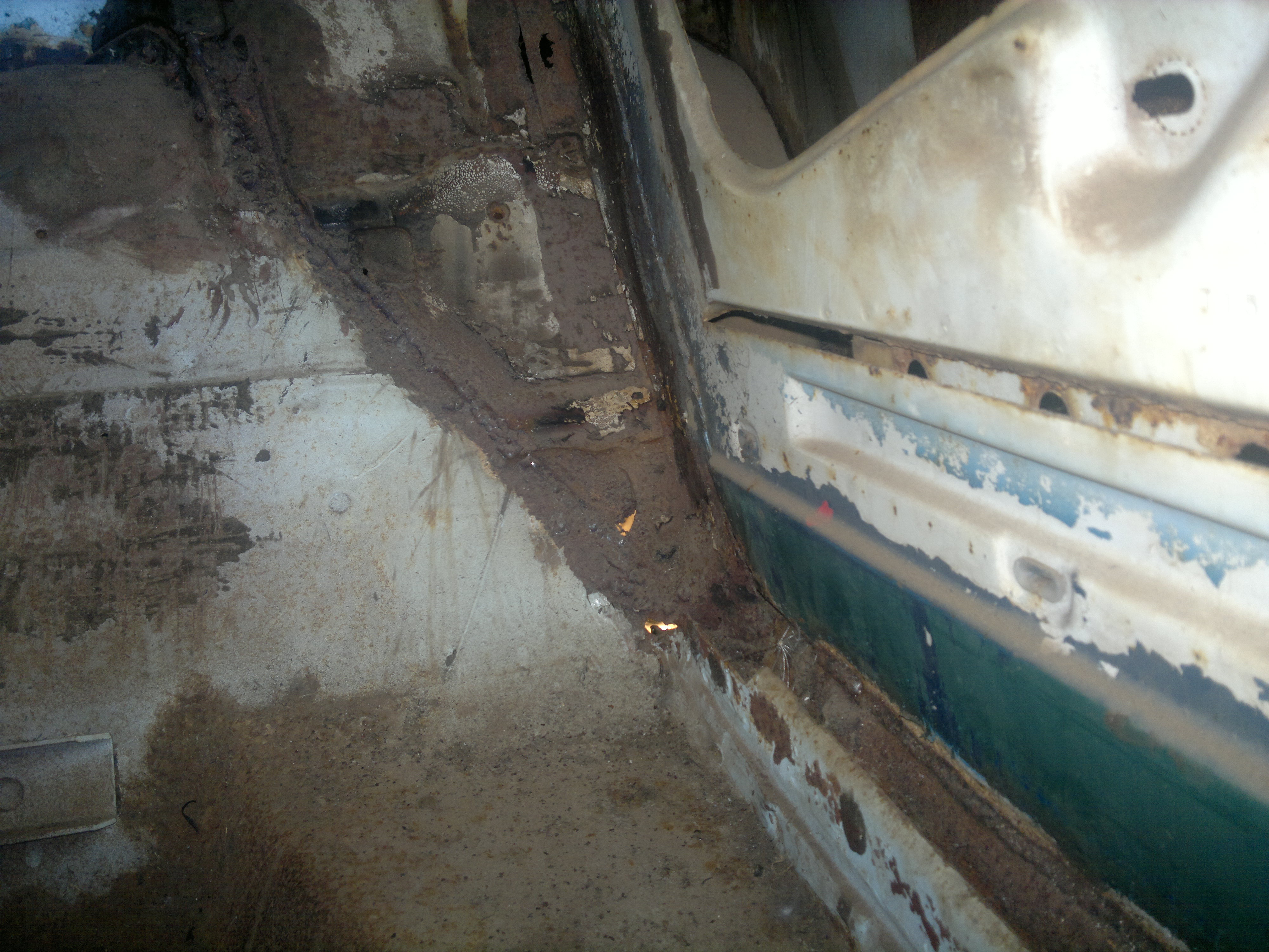

the rusted patch left on the coupe,see where the join is to the 4 door sill

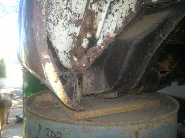

from the back after the joining
the rear part of the coupe on the 4 door sill just as in coupe

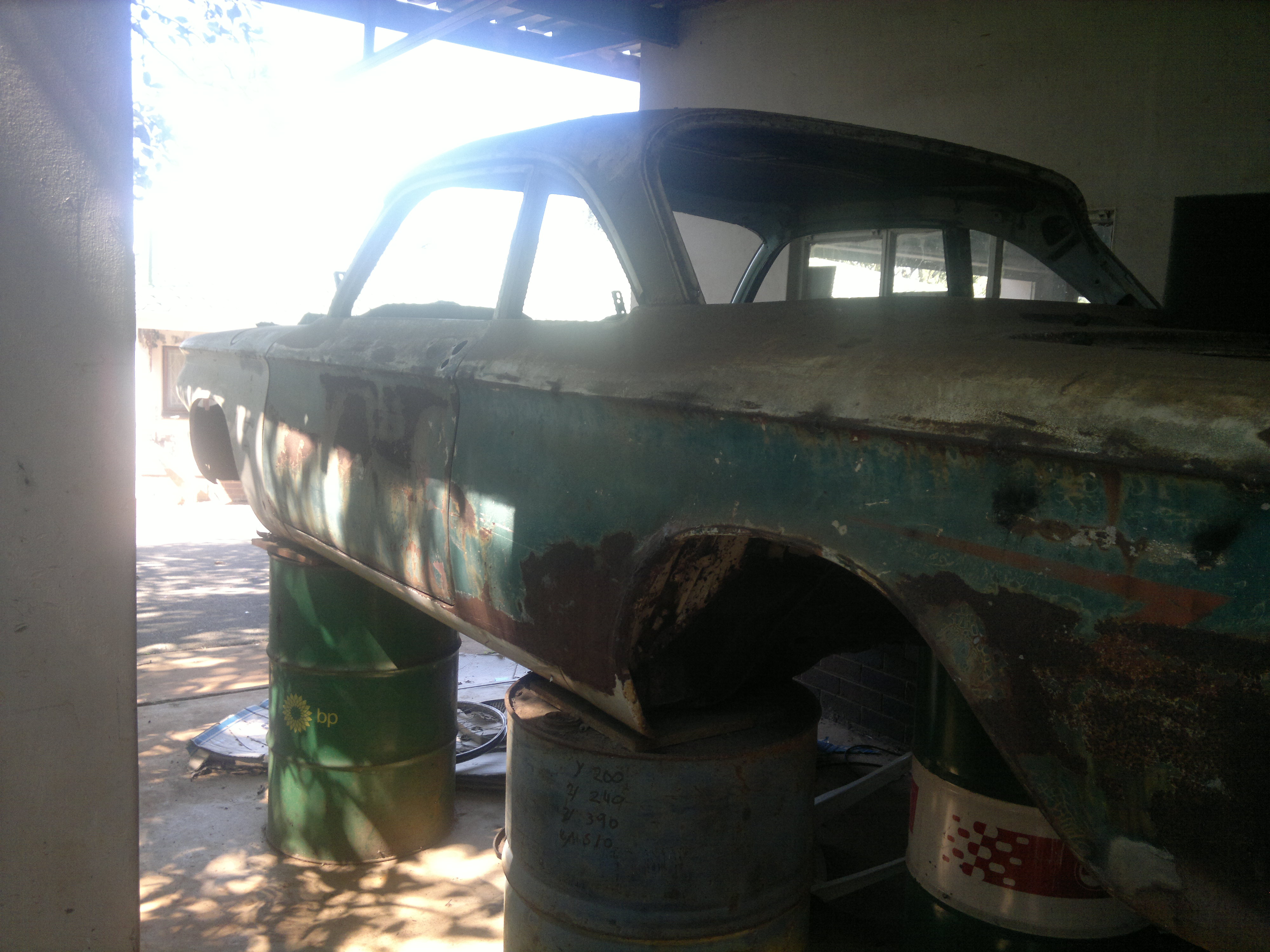

dikkie area grafted from 4 door to coupe

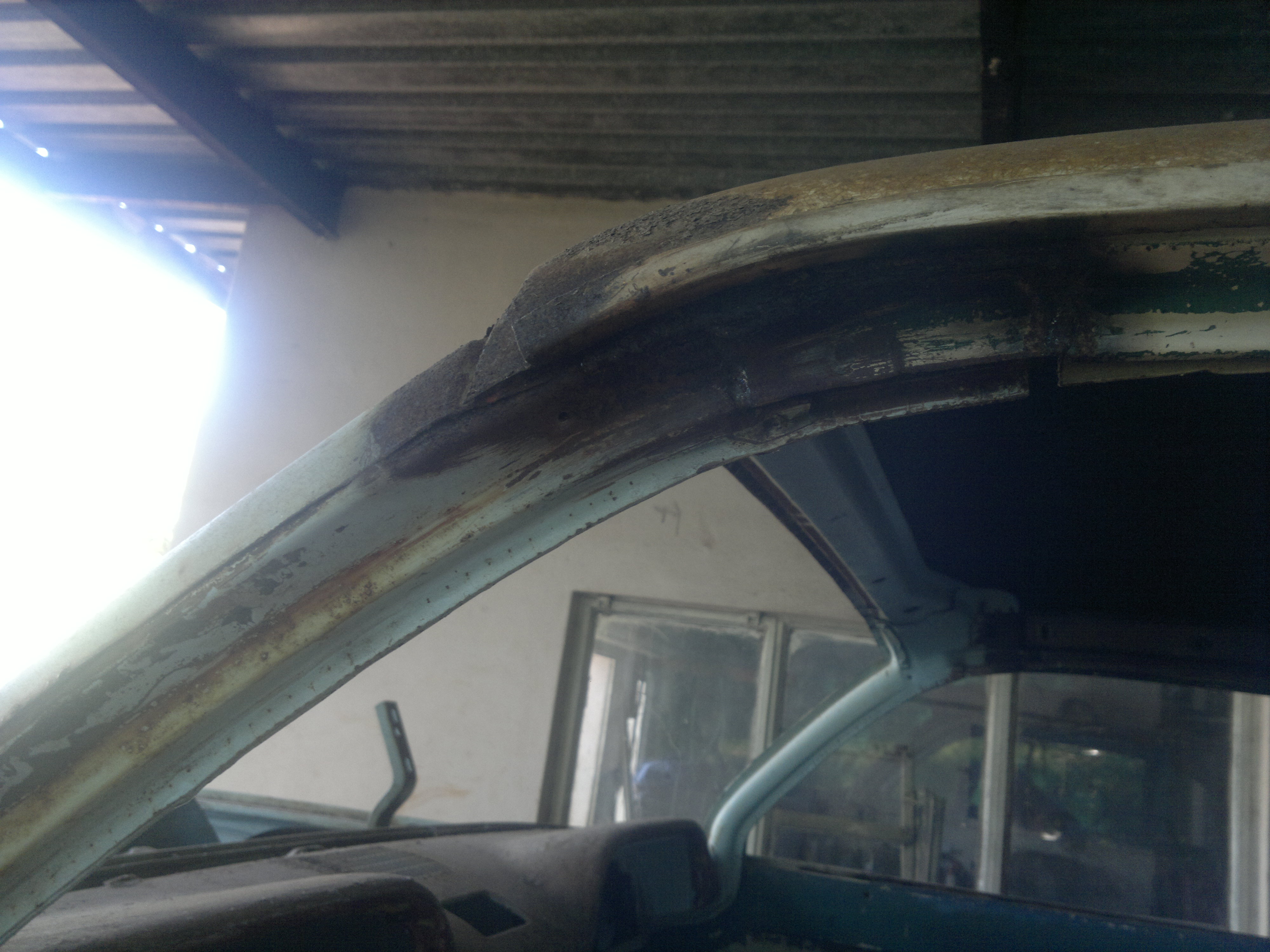

roof section grafted on to windscreen appature
engine compartment graft on
white is original 4 door with grafted on coupe green section

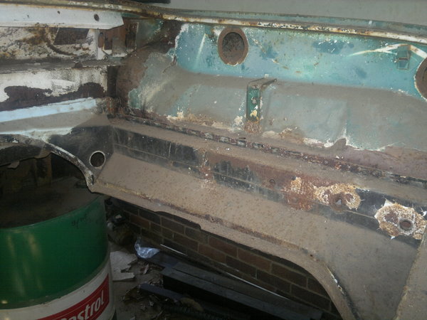

bottom rear wheel well
