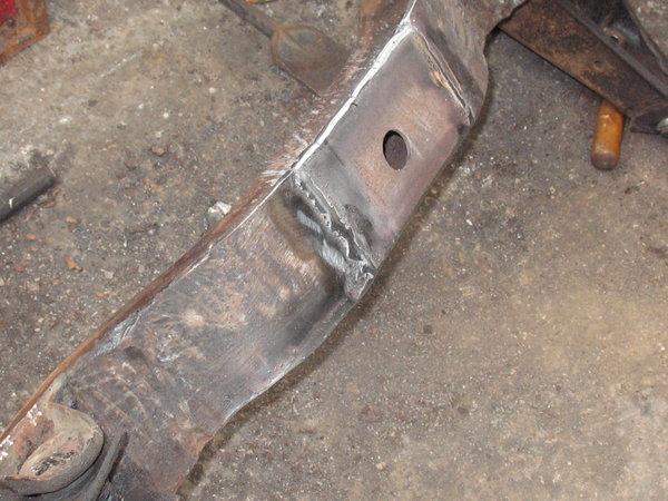

crossmember repairs starting to take shape, found a few more holes. Dont trust my little mig to weld tie rod area,penetration of 4mm plate is not great, waiting to borrow arc welder for this and some oxy acetylene gear to heat up and form bends as close to original as possible

One side done, I think I had better do the other side as well

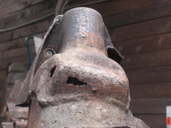

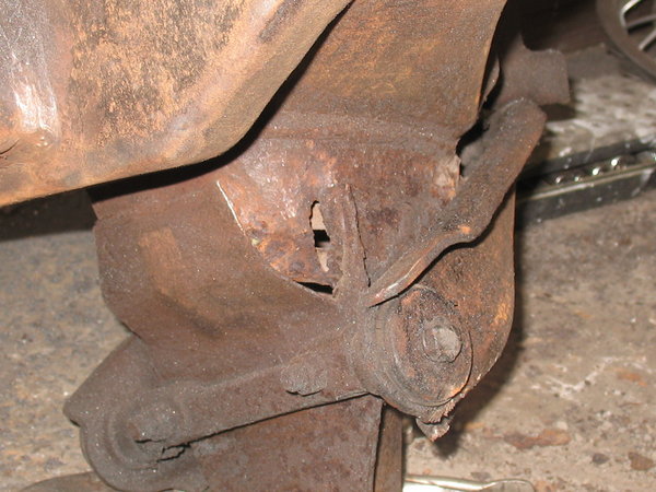

OH DEAR!!!!! I think I will have to give up on this crossmember, look what I just found after a little digging around
Where can I get a replacement?

THAT...is unbelievably creepy!!

Mart is that a front or a rear Crossmember ? than i'll check heremart wrote:OH DEAR!!!!! I think I will have to give up on this crossmember, look what I just found after a little digging around![]()
Re: pensylvania bondo bucket
Hi, its the front from a 66, I'm wondering if I got a good half cross member ,i could marry them up? anyone done this,? its the drivers side thats bad

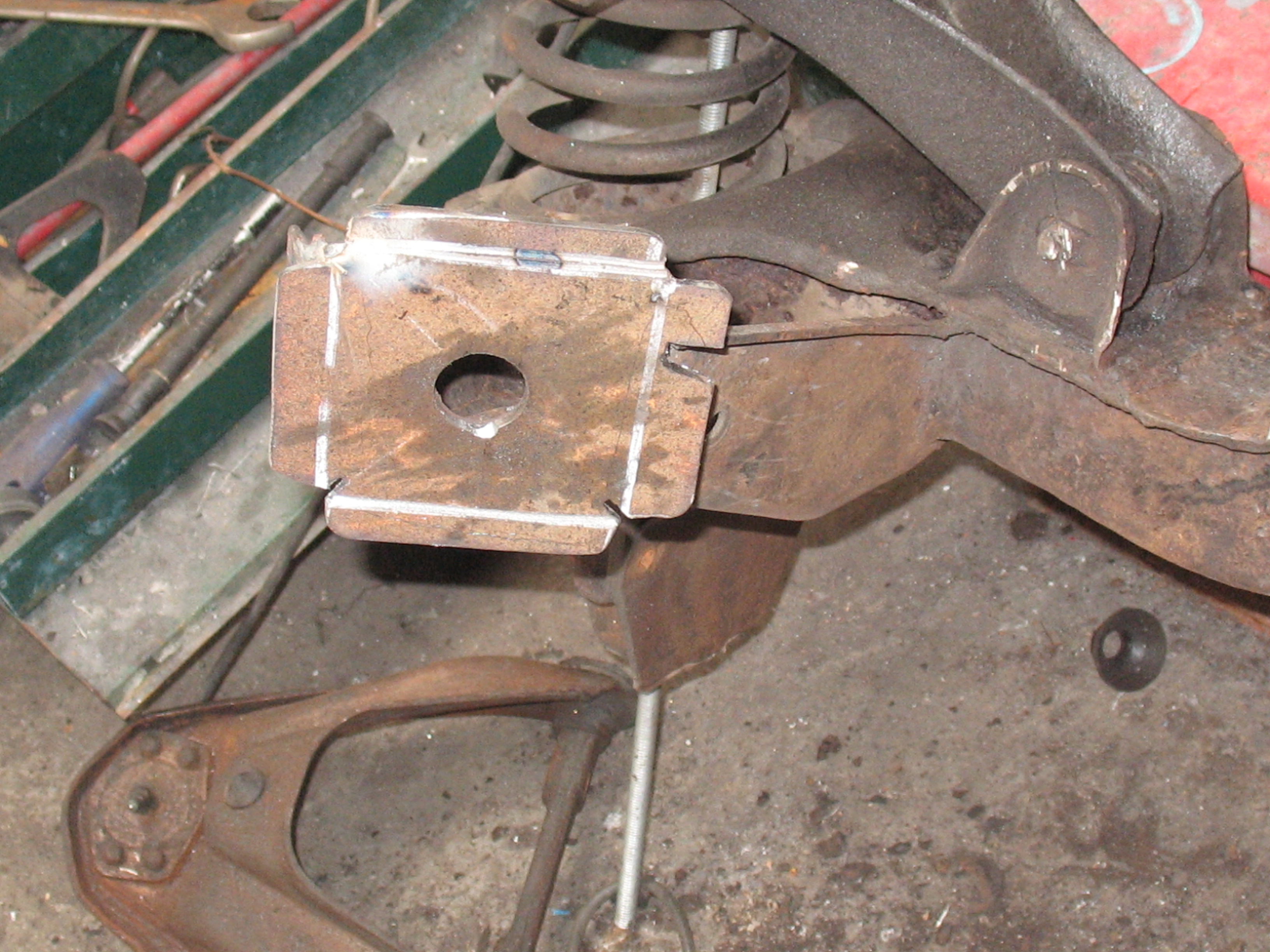

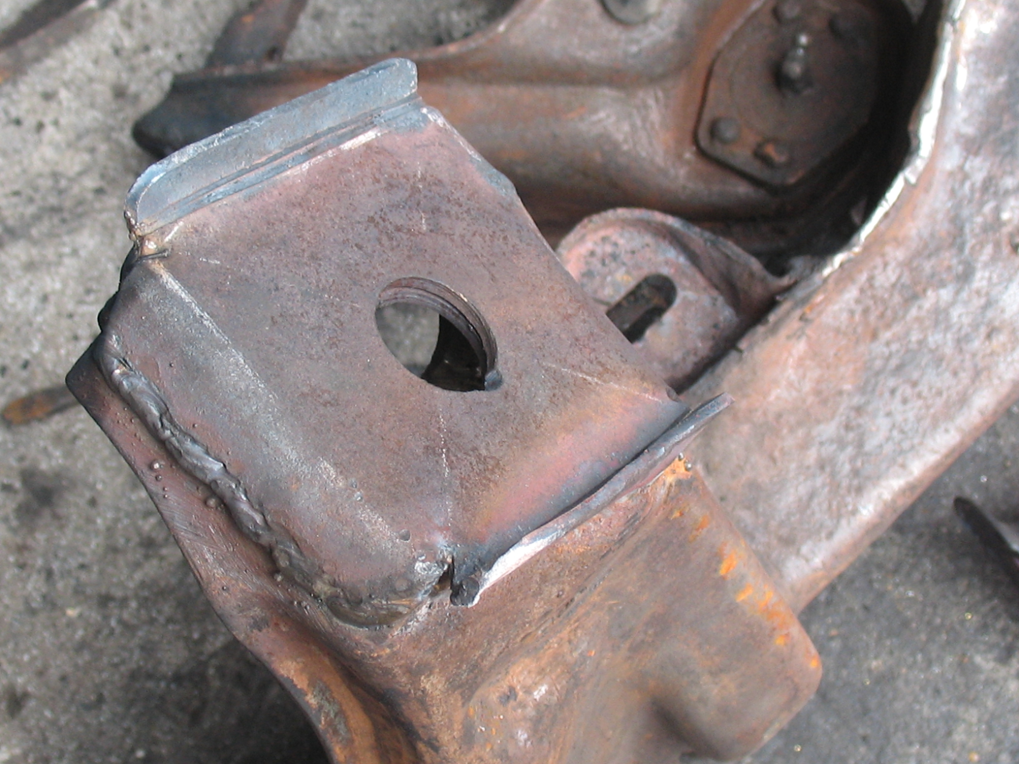

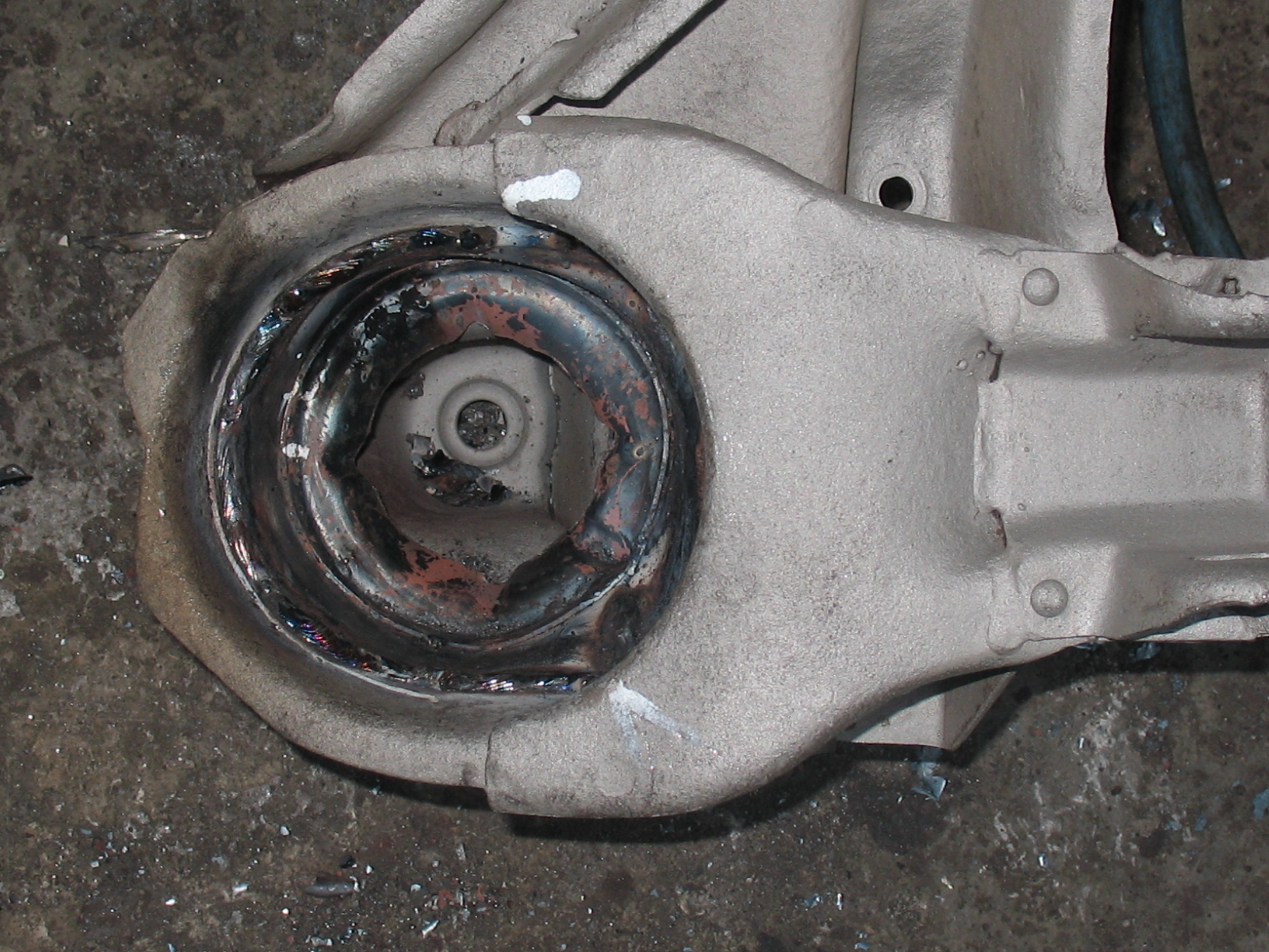

Crossmember repair is coming along. I managed to find a spring cup to fit exactly with the corvair front springs, from an old Ford Fiesta, modified with an extended shroud . Had to cut away some of the outside stiffening to get at rusted area, but will replace them easily, cost so far , including sandblasting, around $18 , well pleased so far, I just hope I have it set up right
