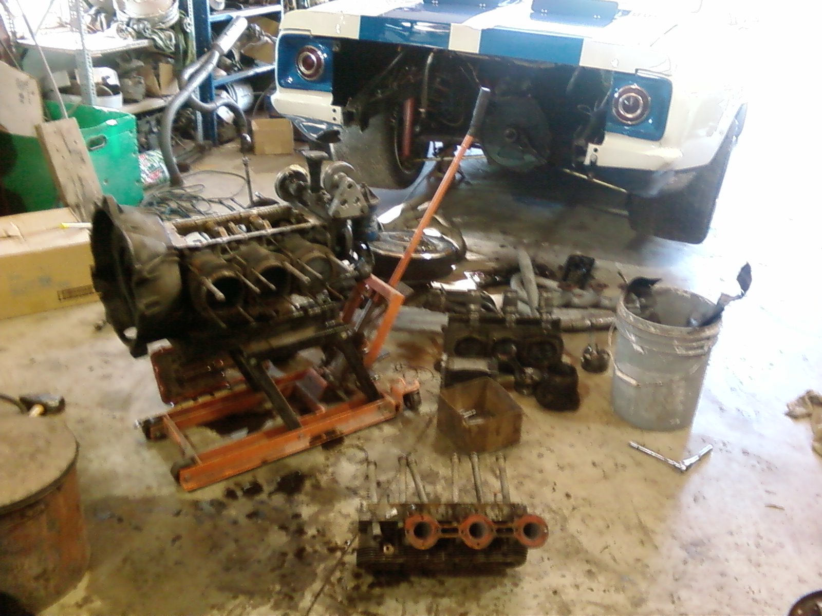

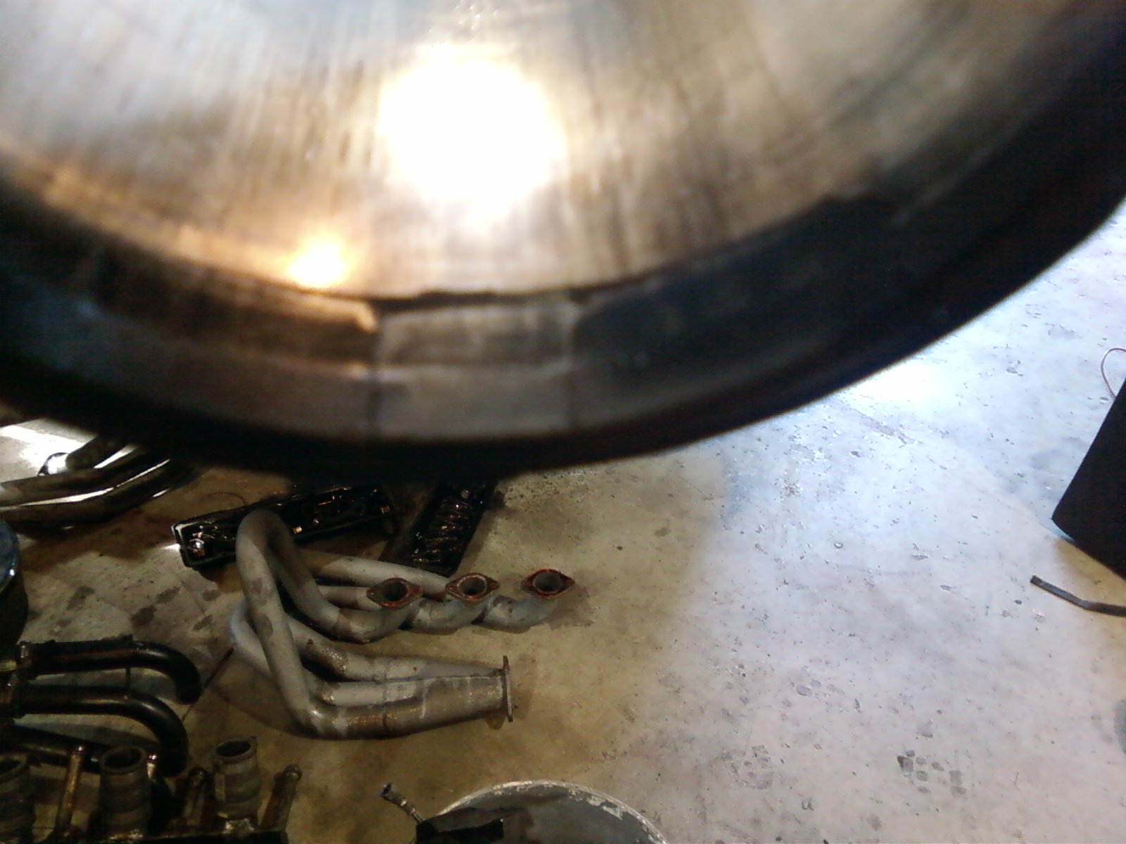

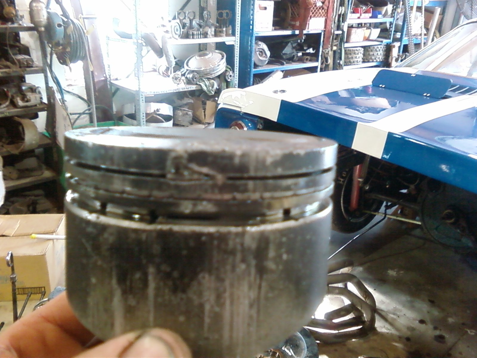

Sometimes owning and or racing a car can really suck! My car broke at Marshalltown but I kept running it at the convention Autocross. I checked the compression yesterday and I had 0 on number 3 so I tore it apart and I found a broken cylinder and a bad piston. Here is some pics.

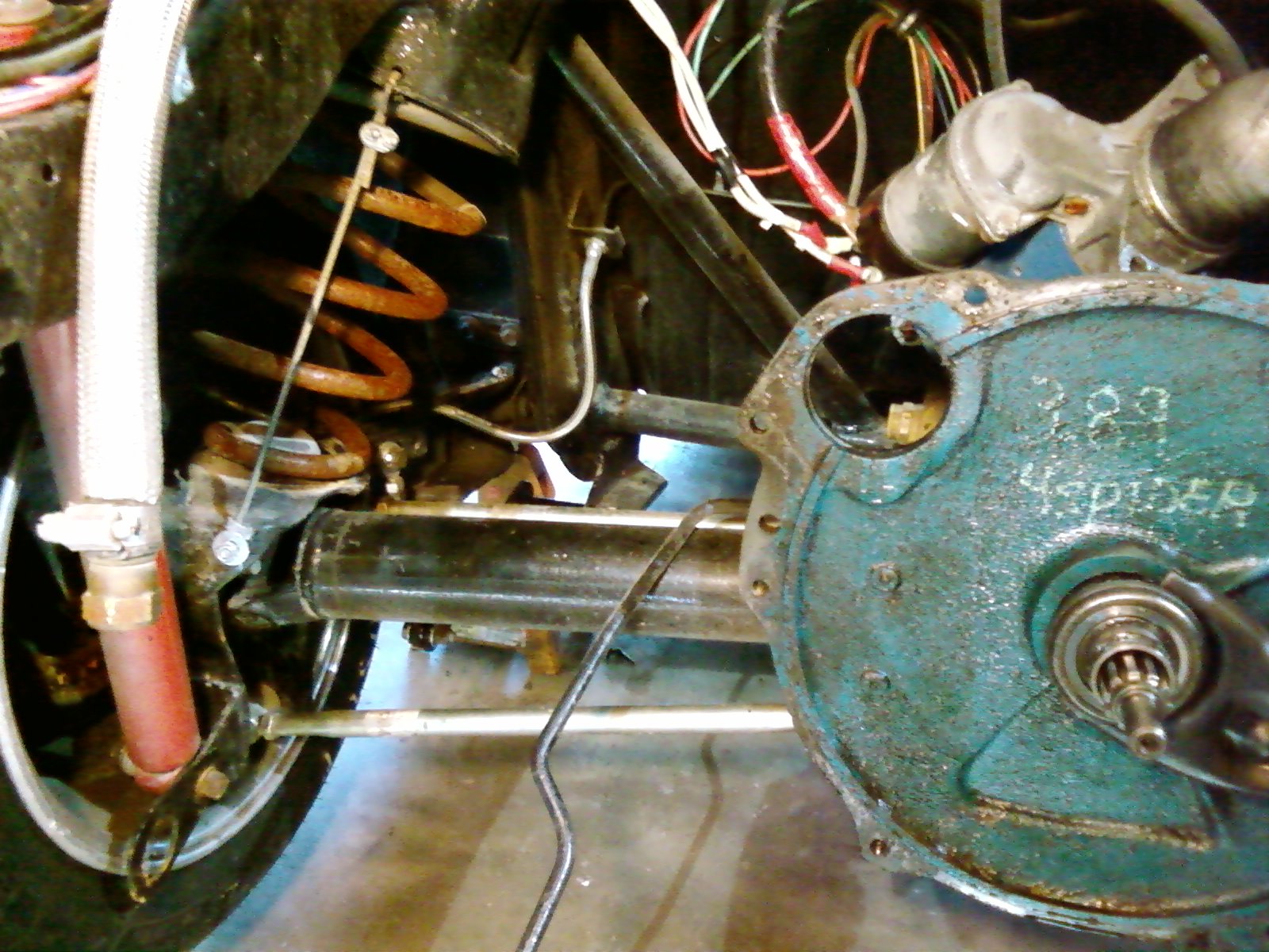

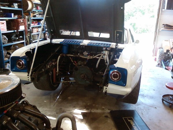

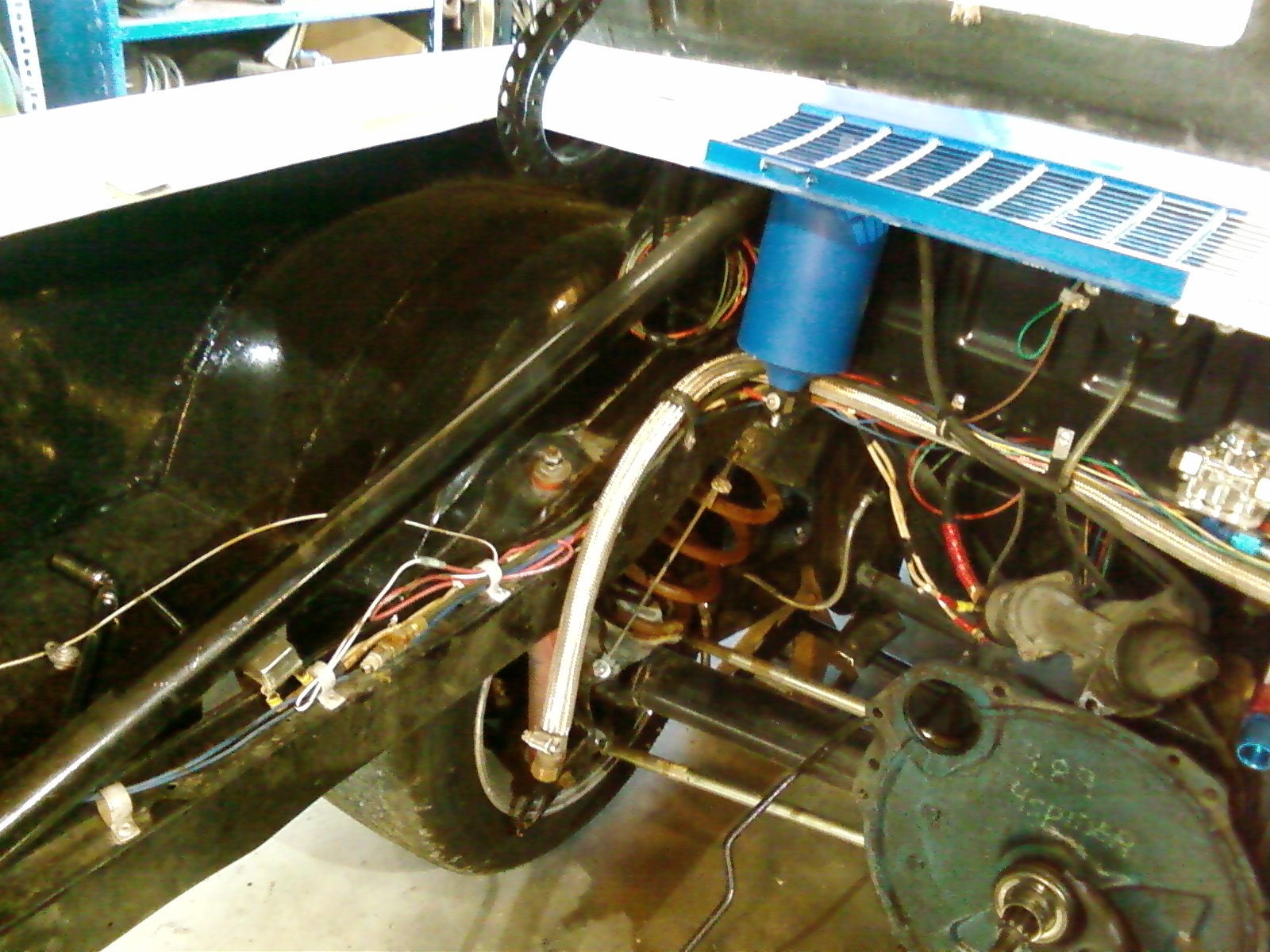

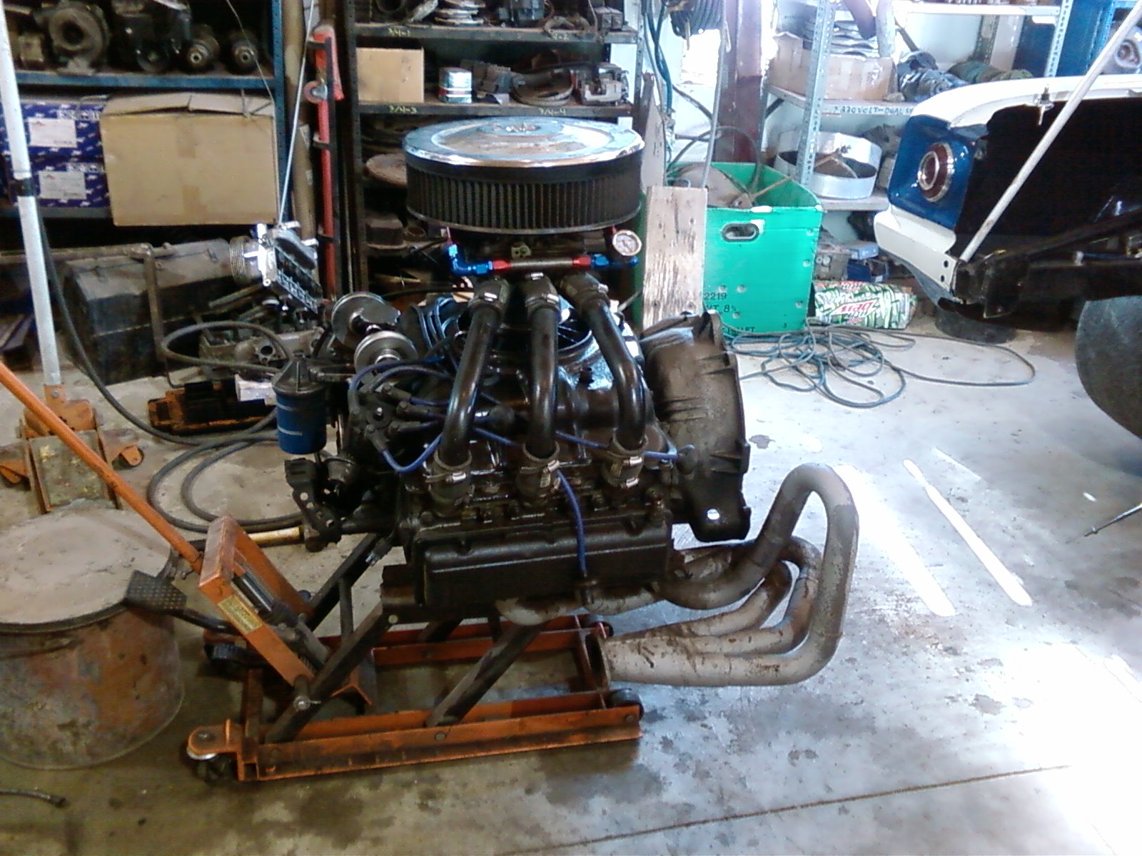

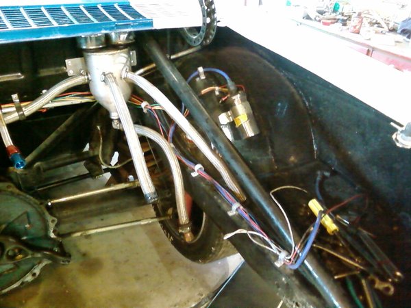

Here are some pics of the back of the car while I had it apart. I keep trying to think of parts of the car I havent taken pics of.

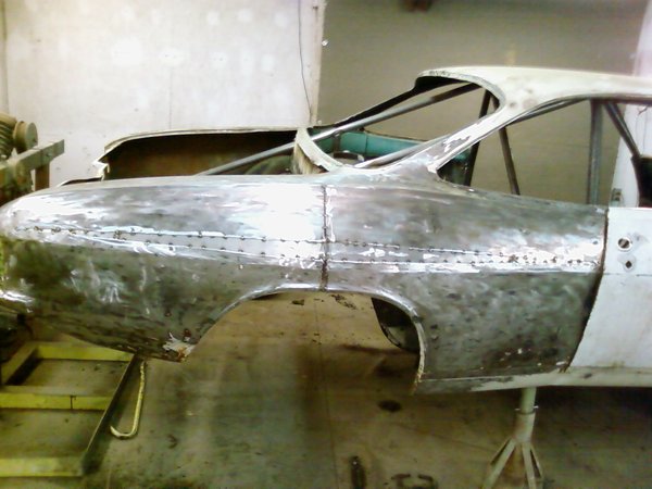

Michael, would you mind giving a quick "how to" on the fenders? I am planning on some for a V8 car in the future and would like to know what to look out for. Maybe 1 1/2" for me. That car is really looking good!

Post by mlevair »

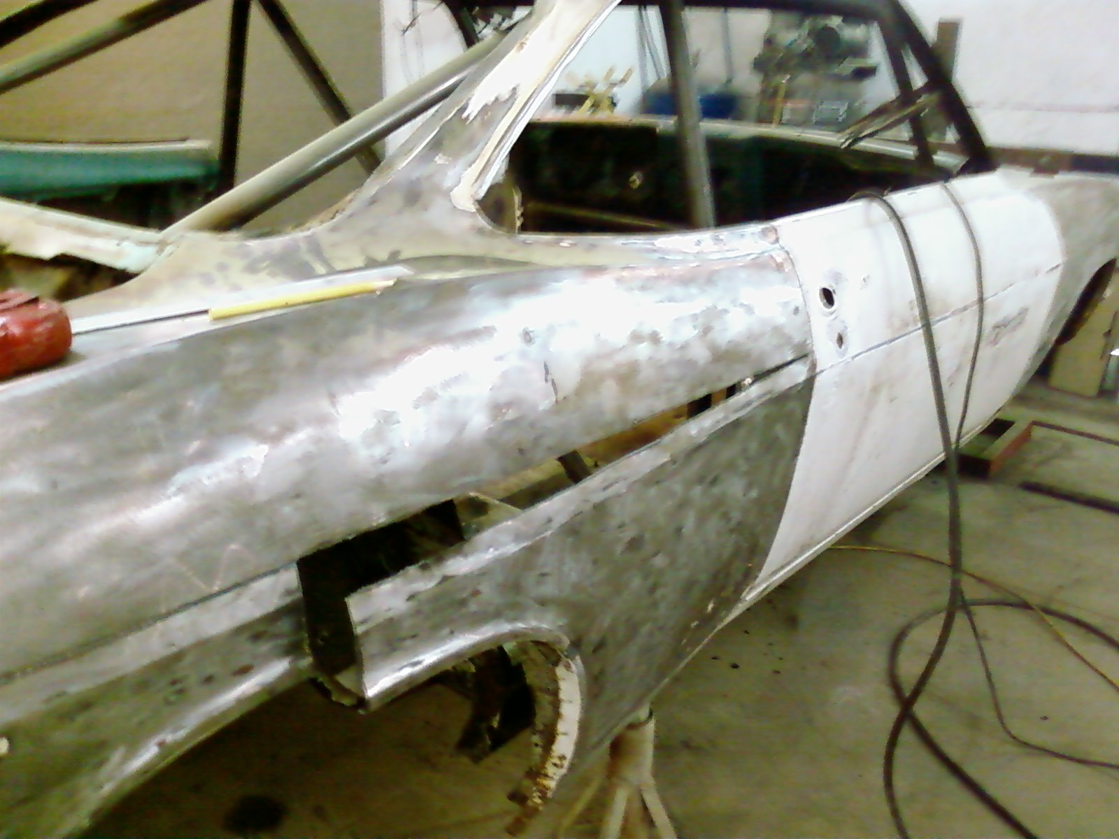

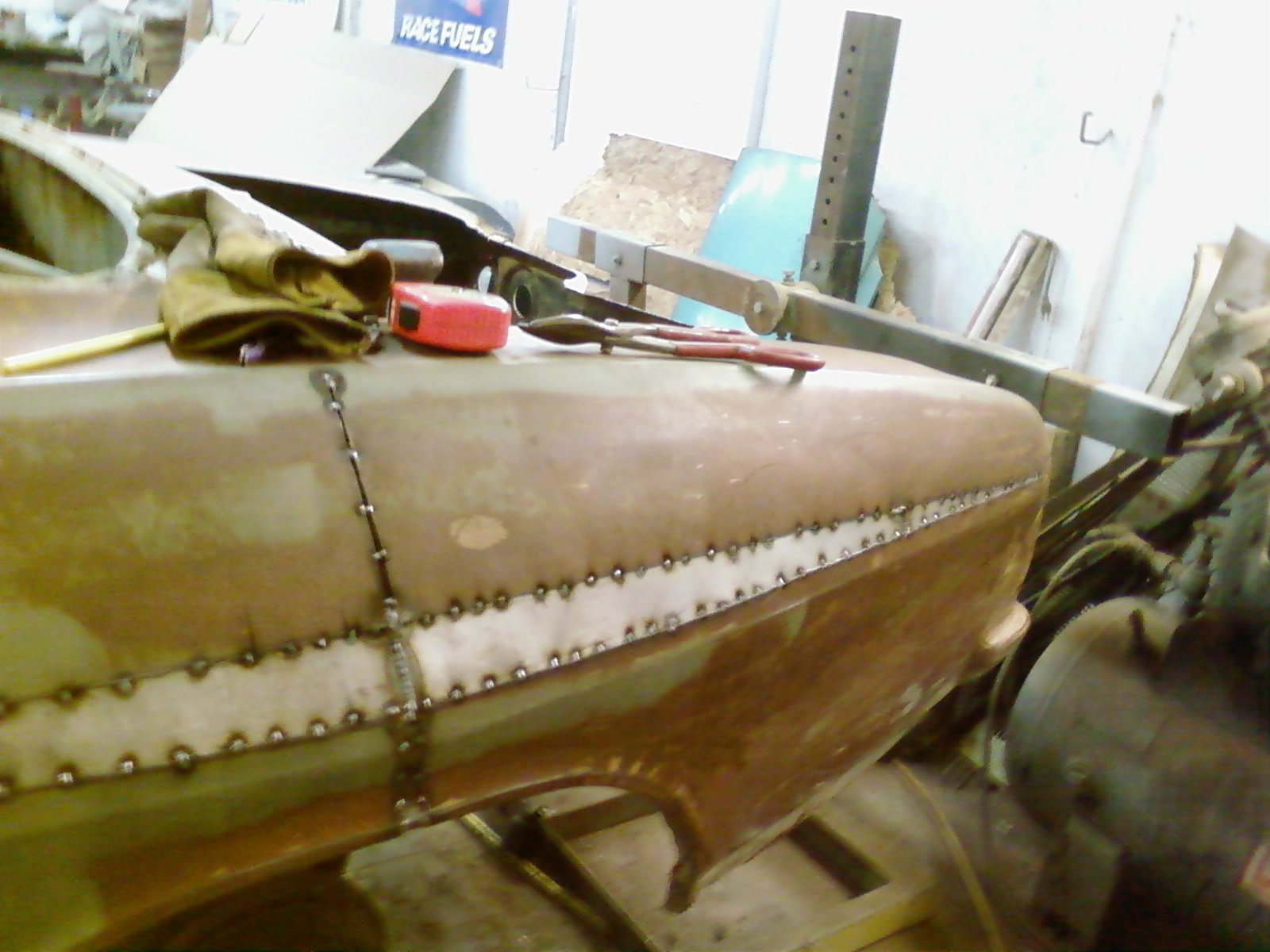

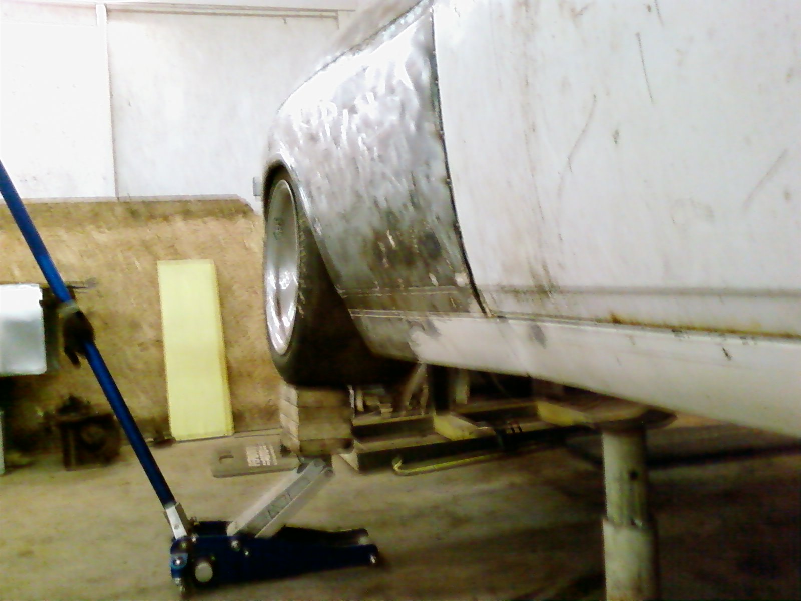

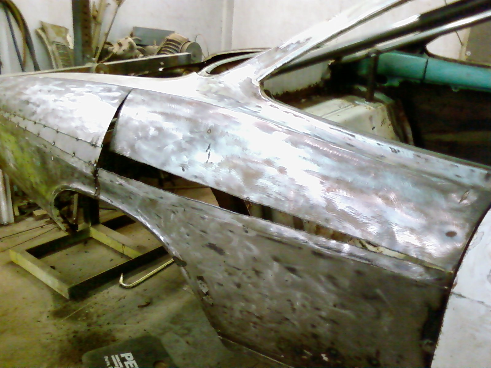

As you can see in some of the pics I tubbed my car so it might be more difficult to keep the original inner wheel wells but I am going to do this to a street car. The first thing I did was to cut the fender loose from the inner at the top where it starts to arch then I cut the vertical section of the inner fenders about 2" in from the outer fenders this allowed them to be pushed outward. Next I cut the fender vertically down the center then I cut it horizontally 1" above the body line. You also have to cut the top and bottom of the rocker panel so it will move then cut loose the rear quarter supports.
When I moved the fenders out 2.5" the front half of the fender moved forward into the door so I had to cut the fender vertically and over lap it about .25" right next to the door.

Heres a few more pics and you can see where I reattached the inner fender by the weld marks.

Thank you Michael. That is an incredible job!

Ya, Good Job!! Nice fit with tire, what size are you able to run with the fenders being flared?

I run a 15x13 wheel with 23.5x11.5x 15 tire.
