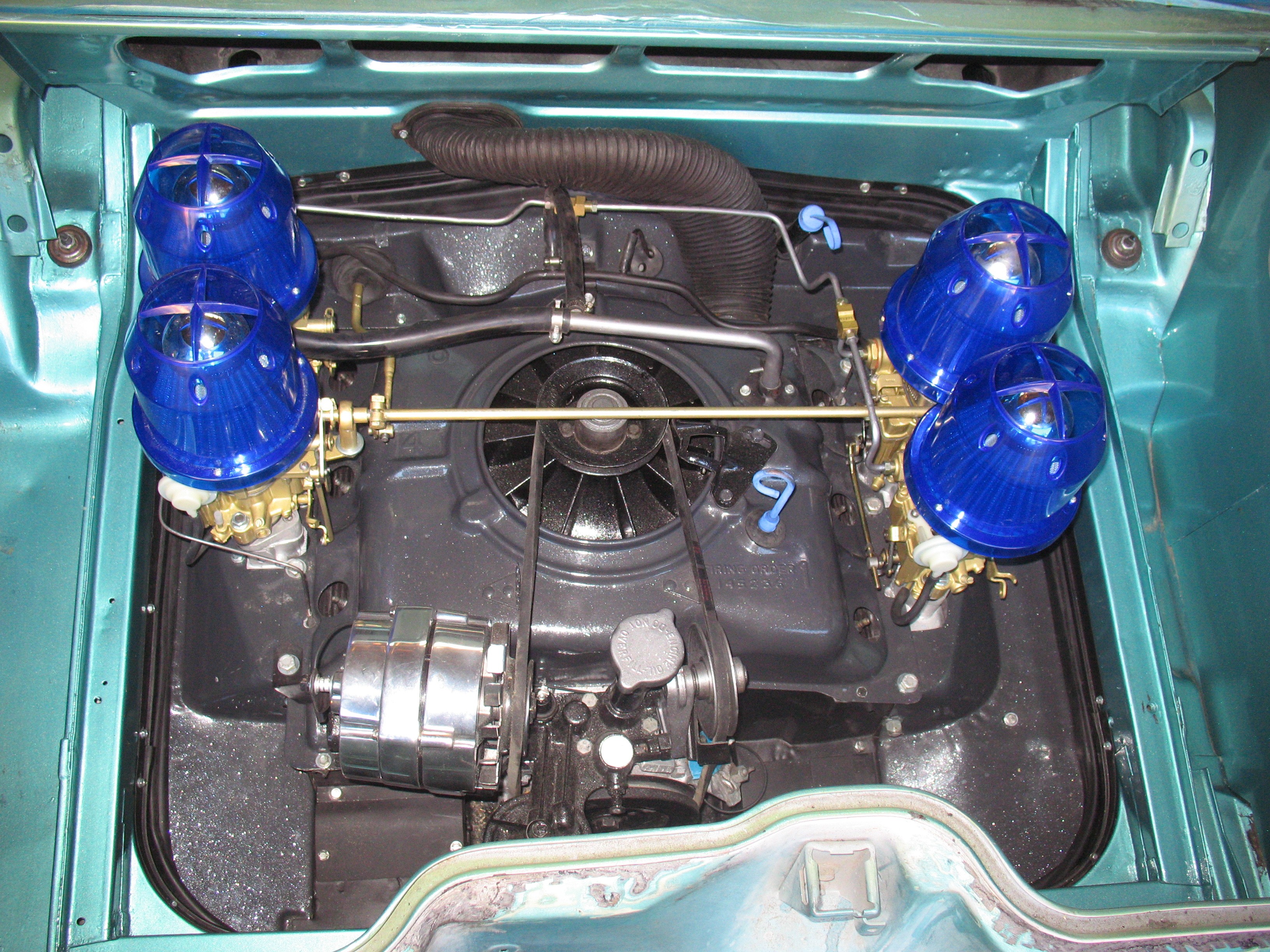

its too tight to remove with my fingers....dont want to wreck an expensive bit of kit, will give it a gentle prise with a screwdriver sometime. I might re locate the battery to the trunk in the future, so a good rewire/rethink is needed to keep things neat
- TexasUK
- Posts: 227
- Joined: Tue Jul 31, 2012 12:27 am
- Location: Church Crookham, Hampshire, UK
Re: pensylvania bondo bucket
I think it will need an earth back to the engine as well as a live, I personally wouldn't trust the body to provide a good enough grounding.
Wire that thick is quite expensive, and I'd route through the inside if possible.
I like the idea of getting as much ancillary wise as possible into the trunk, just to help with weight distribution. I'd put it on the passenger side as well.
It worked fine with my Studebaker, all steel cars use the body as their earthing, although, Corvairs have thinner metal than anything else Ive ever restored. Theres a very useful tunnel under the corvair to route any cables along, which will have loads of room as I wont be using the stock heater system ducting

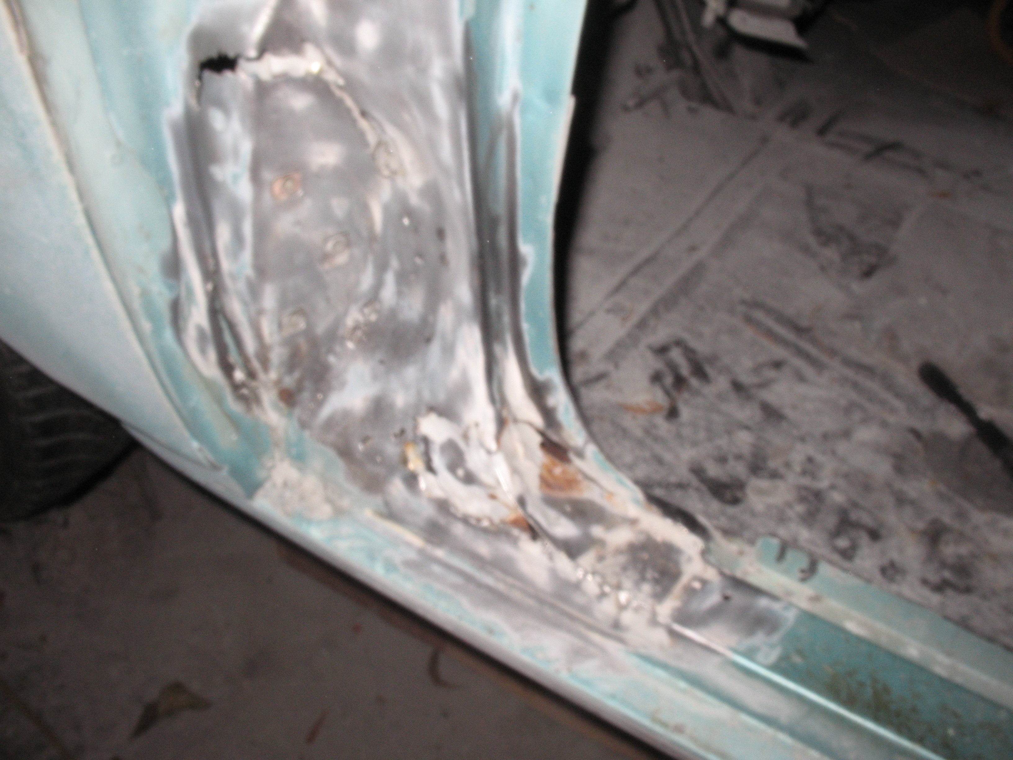

Yup that is not uncommon. I sense the fabrication of involved patches in your future. Have fun!!

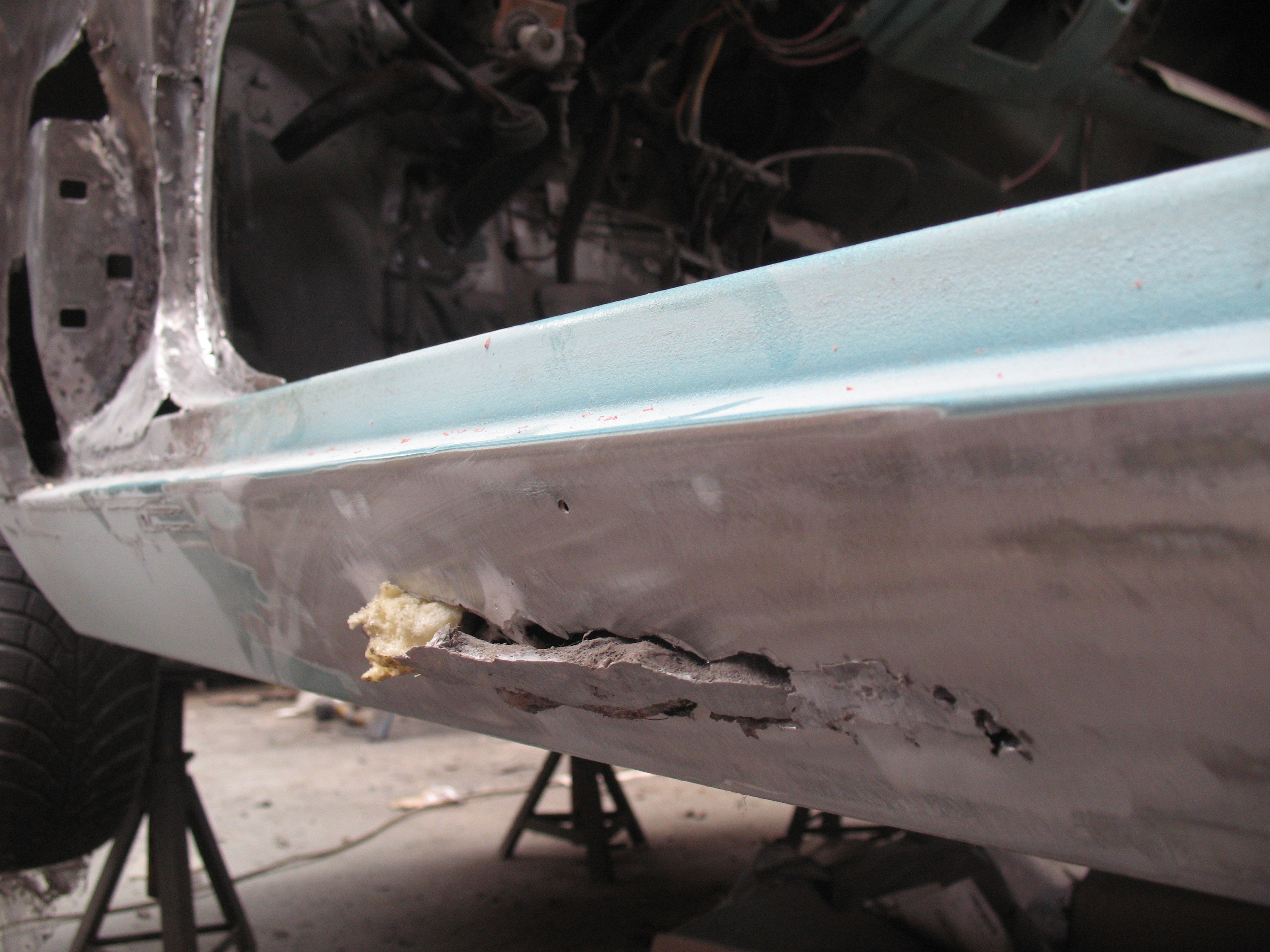

I guess car butchers really like expanding foam. It can apparently be used to rebuild structural items as well, like the subframe under the drivers floor as you can see in these photos (the foam on the floor in the first one is what came out of the drivers subframe and floor in the second one...the floor looked excellent from the bottom before I started digging at it):
I still havent worked out if these people are criminals or just stupid
Exactly!!mart wrote:I still havent worked out if these people are criminals or just stupid

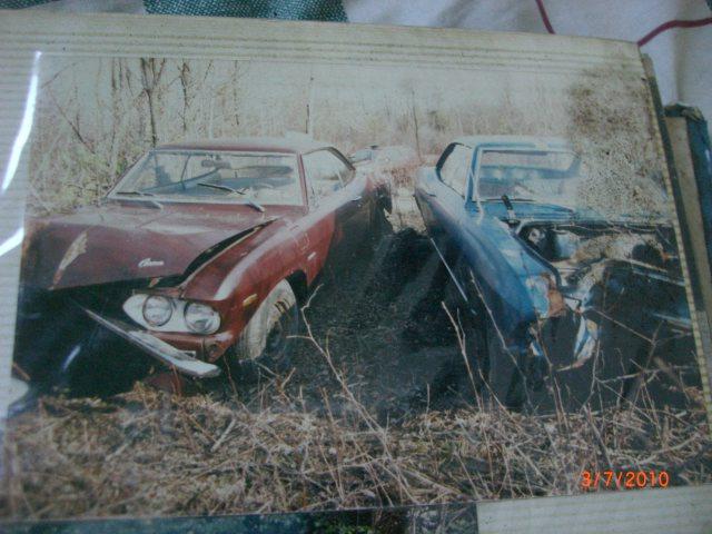

Wow!!! I just read all 19 pages, every word! Here's a couple of Corvairs I pushed into the woods 30+ years ago... They may still be there. Ignore the datecode, the pix are in my photo album

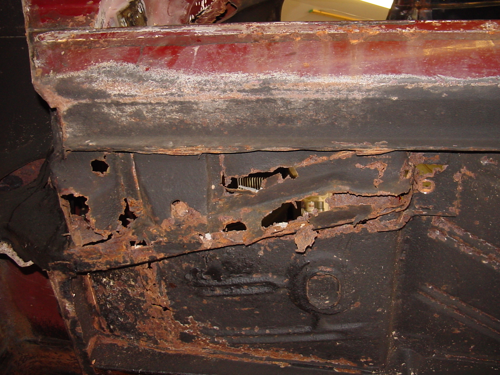

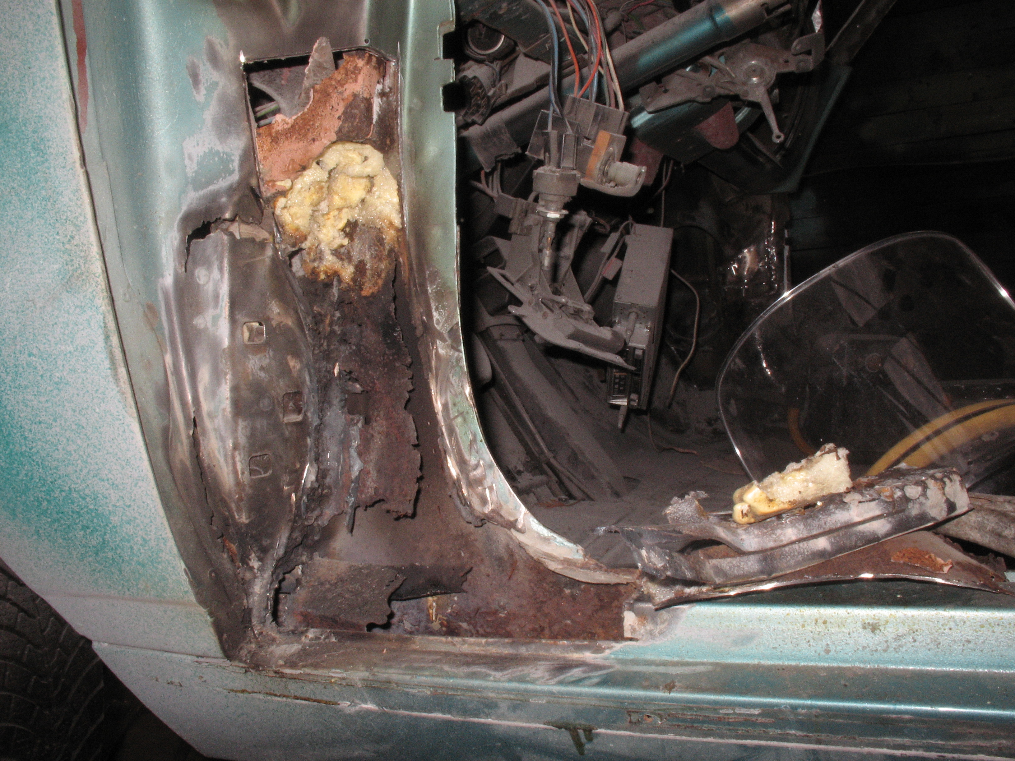

more PA style structural repairs, I'm surprised this poor car didnt fold up in half, it wouldnt need to go to the crusher thats for sure, an eight year old kid trained in origami could do it
