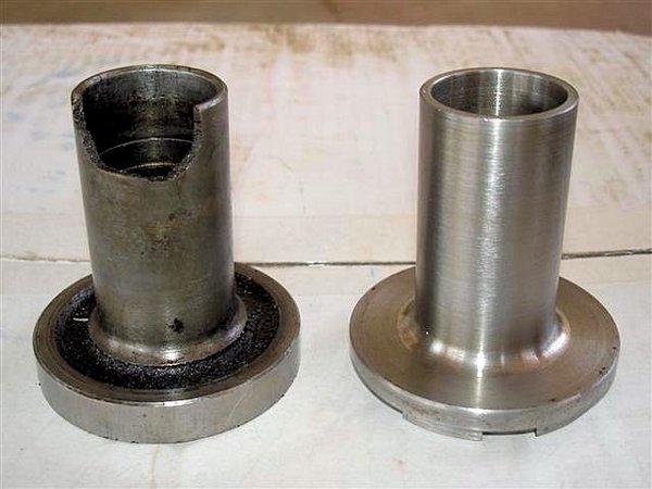

The reason with pulling the entire powertrain as an assembly is that it is difficult to separate the engine from the transaxle — especially with the transaxle and engine still in the car!
:wrench: The problem with the manual transaxle is that the long input shaft (23-24 inches) tends to remain embedded in the pilot bushing and clutch disc, while the other end of the splined shaft pulls free from the transmission. As the two heavy components separate, any misalignment that is permitted risks leverage being applied by the input shaft against the throwout bearing shaft, which can fracture this machined casting. Replacing a damaged throwout bearing shaft requires dismantling the differential.
Even if you remove the powertrain as an assembly, use caution when separating the heavy transaxle from the engine. If the input shaft remains embedded in the clutch, you must pull the transaxle straight back about 24 inches until the other end clears the transaxle. If you have an assistant, the assistant may be able to reach between the differential face and the bell housing to grab the input shaft and pull it free from the clutch assembly — reducing the risk of damaging the input shaft, clutch disc, or throwout bearing shaft.
