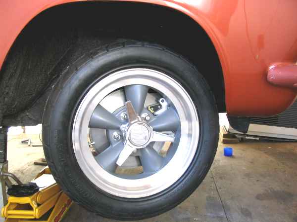

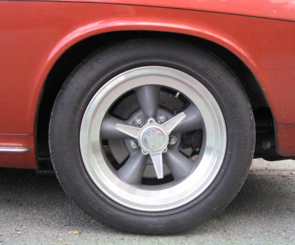

Dang Tony - the disks look almost tiny in those huge wheels .

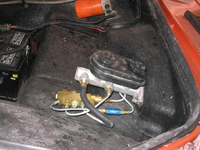

Here's what I used -- The MC is an aluminum Wilwood for 4 wheel disks. It was made for a Chrysler product so I had to modify the mounting ears. It has a 69/31 split and I reversed the ports so that the rear gets the 69%.
I also used an MP Brakes combination valve for 4 wheel disks . The combo valve allows the rear brakes to react before the fronts and makes for less nose dive and smoother application.
I also used Rp valves in both lines to keep slight pressure in the calipers at all times.
I bought an adjustable pressure valve but have not felt the need to use it.

Good post Unsafe! He says he chose the one he went with based on the size of the reservoir it is pretty huge. Since we went with rears only, the calipers are only single cylinder each. So he's guessing there will be adequate volume. If not, he may change his mind. It's still a prototype setup after all. heck, we may even have to bolt up the dual piston calipers on the front if it isn't enough stopping power. We'll see next weekend.
