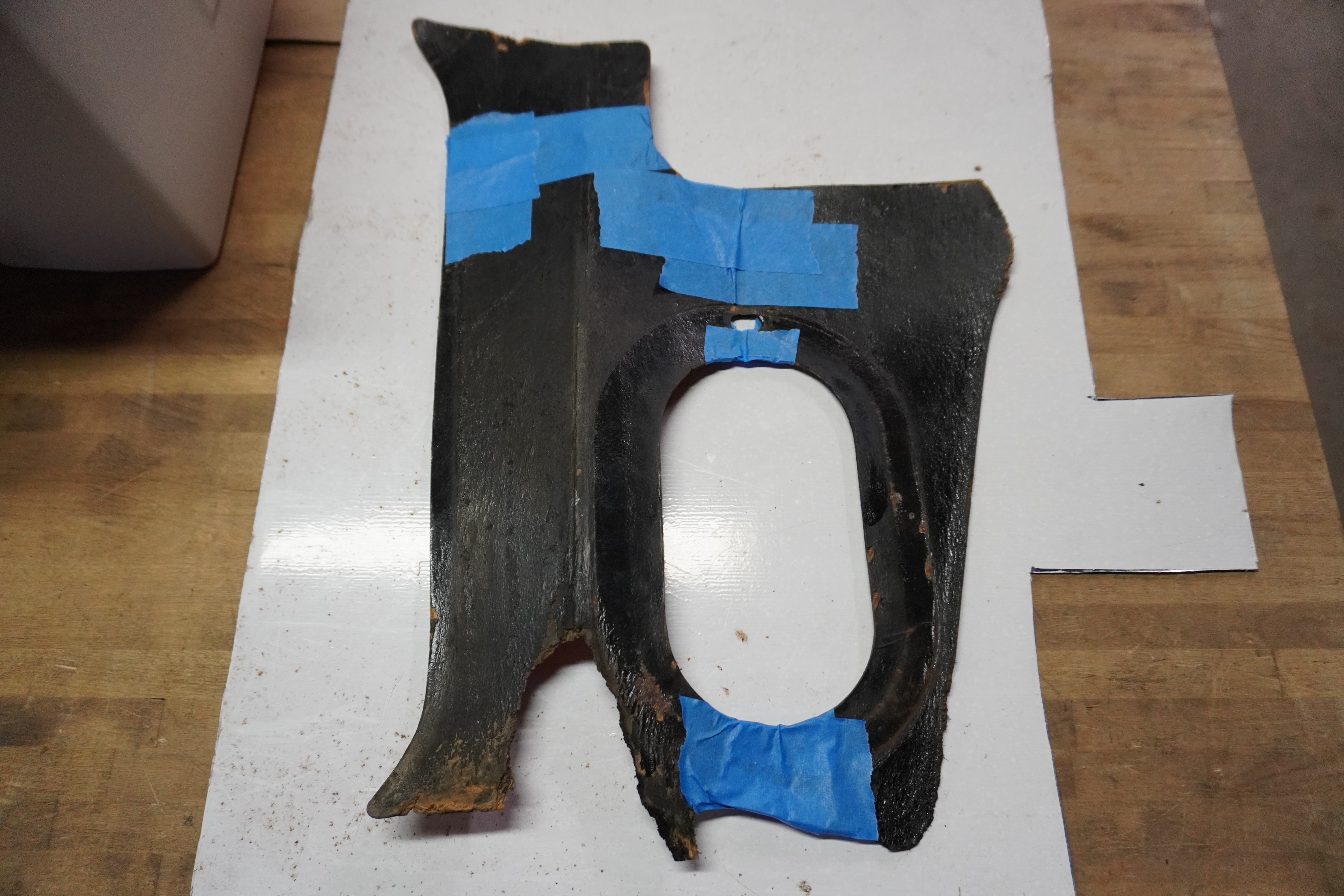

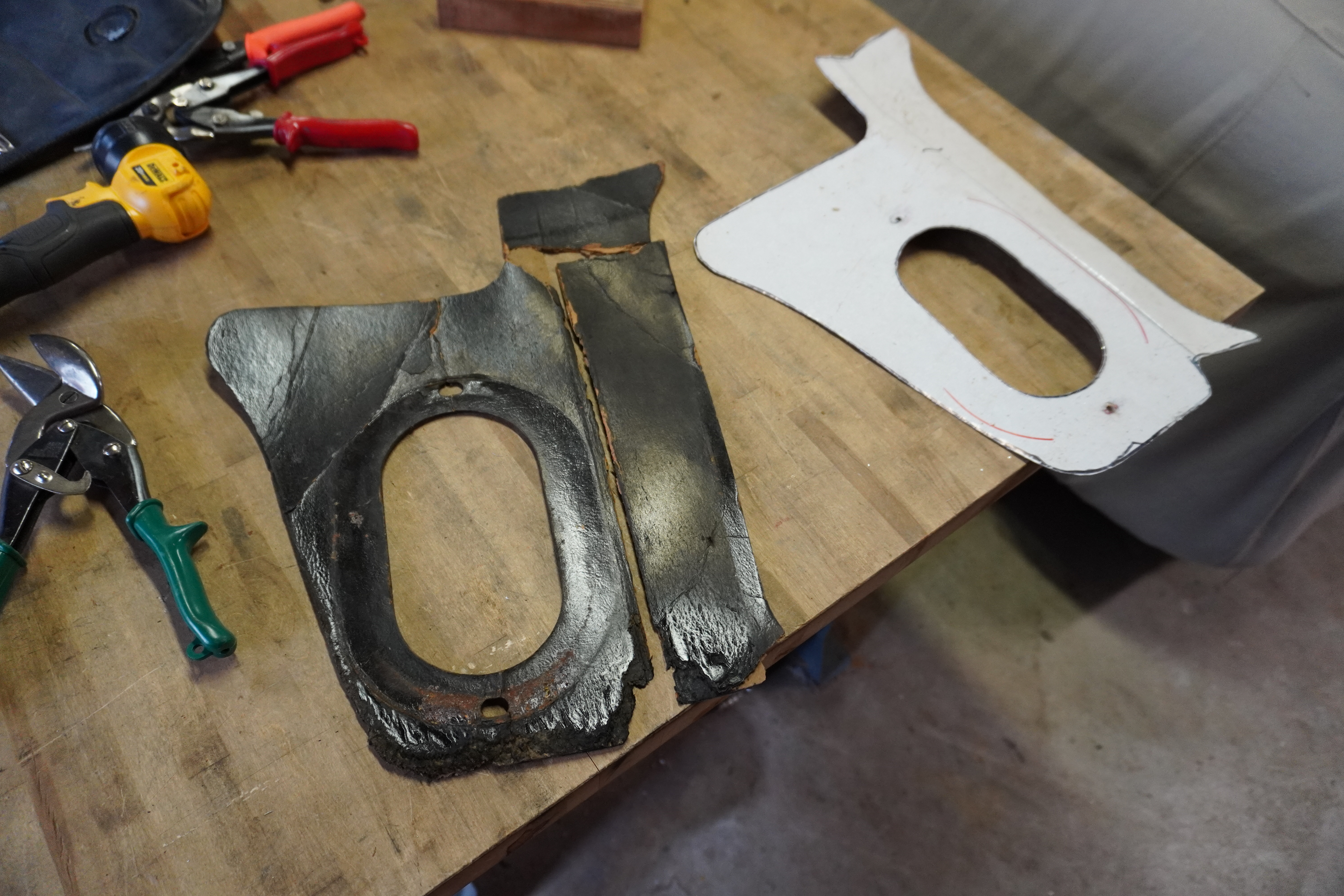

Painted the tin junction boxes under the seat and blocked off the 3" tubes that went forward. (2-3/4" PVC caps fit perfect.) Removed the little doors on those floor vents and installed screens. pic

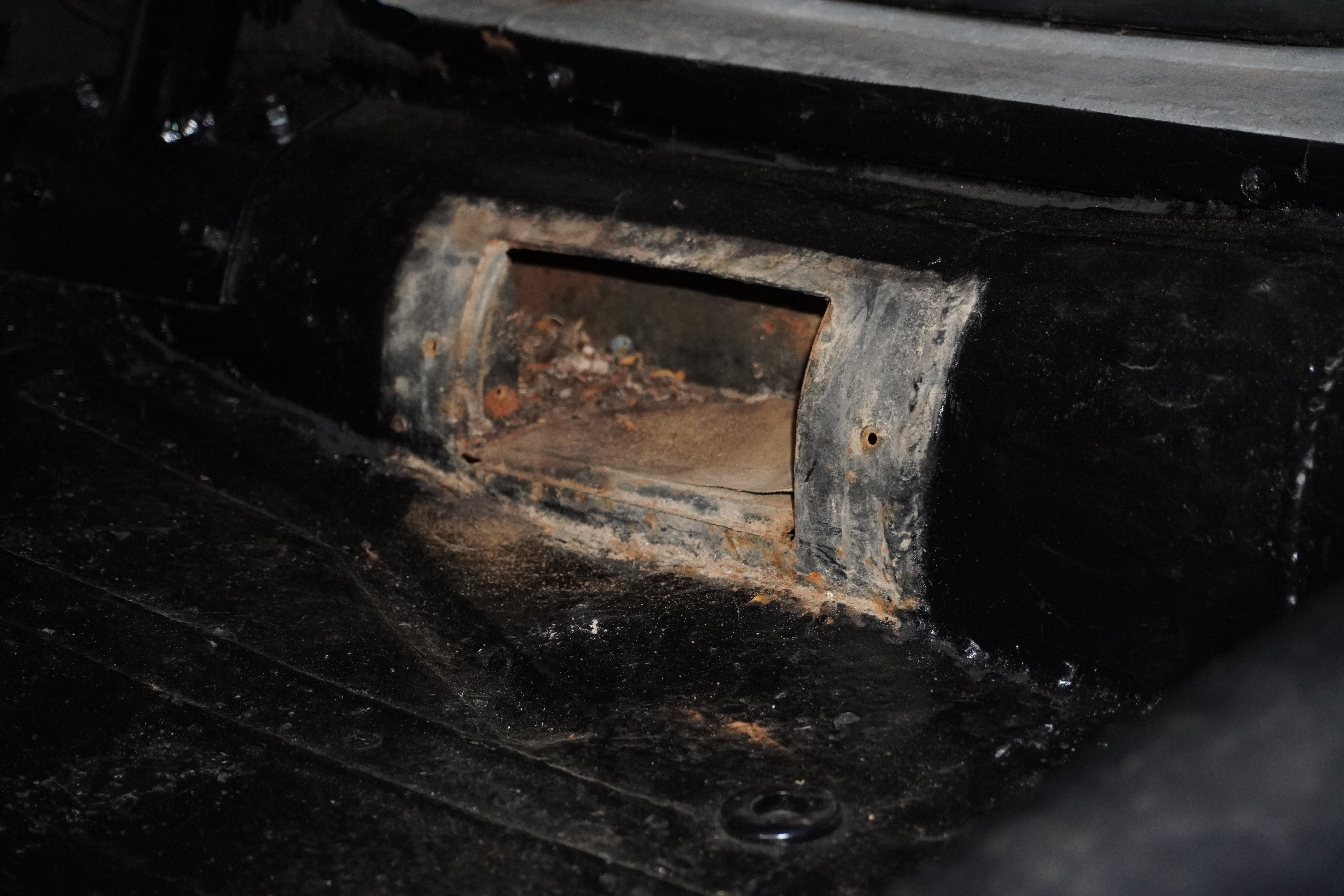

After deleting all the rotten hoses and broken stuff inside the rockers, I pulled the cast grilles that Dad had blocked off and You guessed it! The mouses had chewed through the cardboard at the bottom of the lower front vent and made their way into the pipe that used to hold the defogger hoses down into the passage and made nests in the rockers ahead of where it was blocked off! Both sides! Vacuumed out and Febrezed. Made up some aluminum covers and riveted them on where the cast diffusers were. Now capped the 2" fogger ducts (between the car door and the vent doors pointing up) and will make up some aluminum kick panels to cover it up. No more cardboard.
Pulled the outside air vent doors and checked, no mess in there. For the love of Pete, tell me if there is a spot I haven't checked. Not much more car.
Bob
