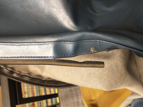

Here is a pic of the beed that is ripped. I was able to pull/slide the top cover out of the channel without too much difficulty. Wish I'd have known this earlier. IO will be talking to the Upolstery guy tomorrow and wqill see what he says.

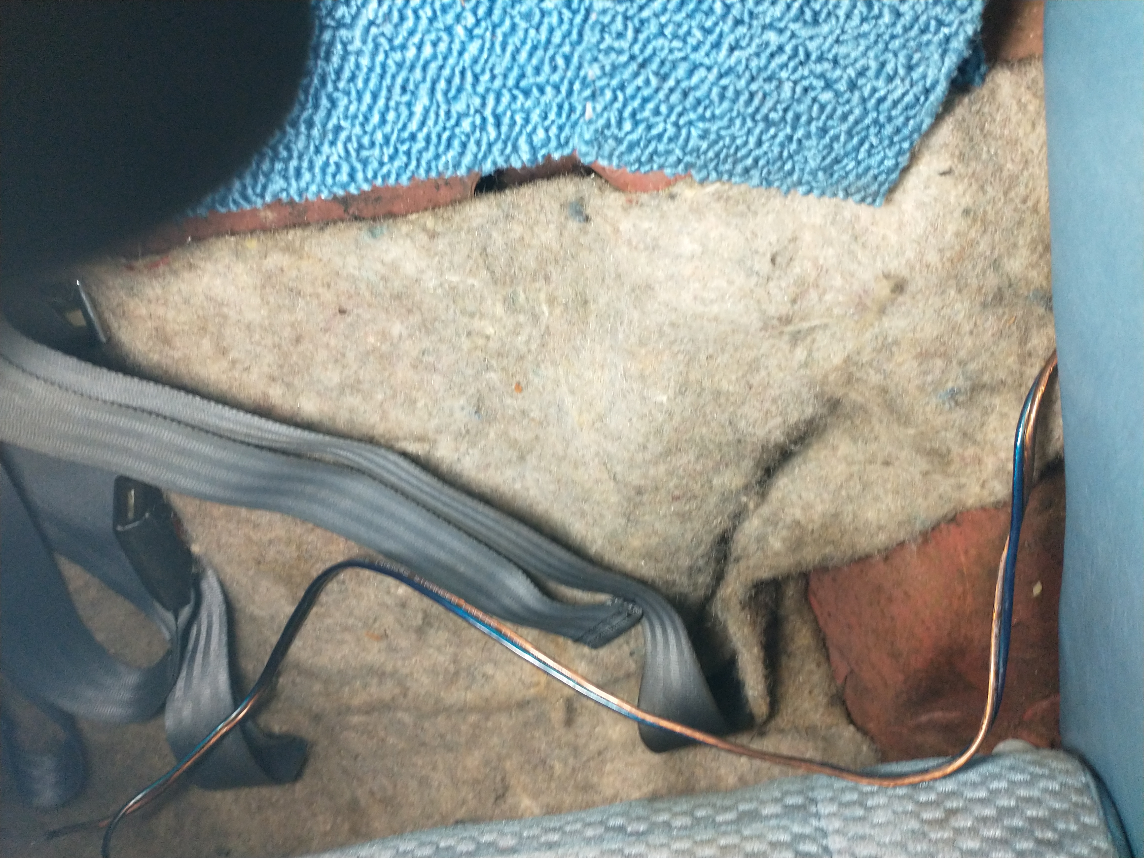

Another things I've wondered about is this thick padding under the rear seat. It looks to be a thick Felt/wool blanket of some kind. It goes up into the area where the pump for thew top is and goes all the way under the bottom bench seat.
Is this a factory blanket to help with noise? Or was it added latter? I know its got a bit of smell so I was thinking of replacing it with something. Opinions???

Sound deadener and rust multiplier

That sound deadener "Blanket" is NOT Factory!

On the LM (65-69) cars there was a pad behind the rear upper seat on convertibles, but NEVER under the seat which is a notorious place for water to gather. AFAIK no pads were used on EM convertibles. As other said --- a good way to cause rust if it gets wet. Throw it out.
Convertibles tops have a number of controlled leaks when it rains, or when you wash them :rolling: :rolling: :rolling: :rolling:
If a convertible gets a good soaking - ALWAYS pull out the rear lower seat to check for water.

I think i will through it out. It smells and being in a Vert I cant imagine it help much with engine noise.

The plastic part of the top cover that slides into the groove on the back of the rear seat wasnt an easy thing to find. I contacted a few local places and got with the guy doing my Upholstery and wasnt having much luck. So I called Clarks.
They said they dont normally sell this part separately but happen to have a couple extras. So they agreed to sell it to me for 20 bucks. No telling on what the shipping is going to be but at least I know I will get a correct part and at a decent price. The Upholstery guy said he would replace it at no charge as its a simple thing to fo compared to my seats.

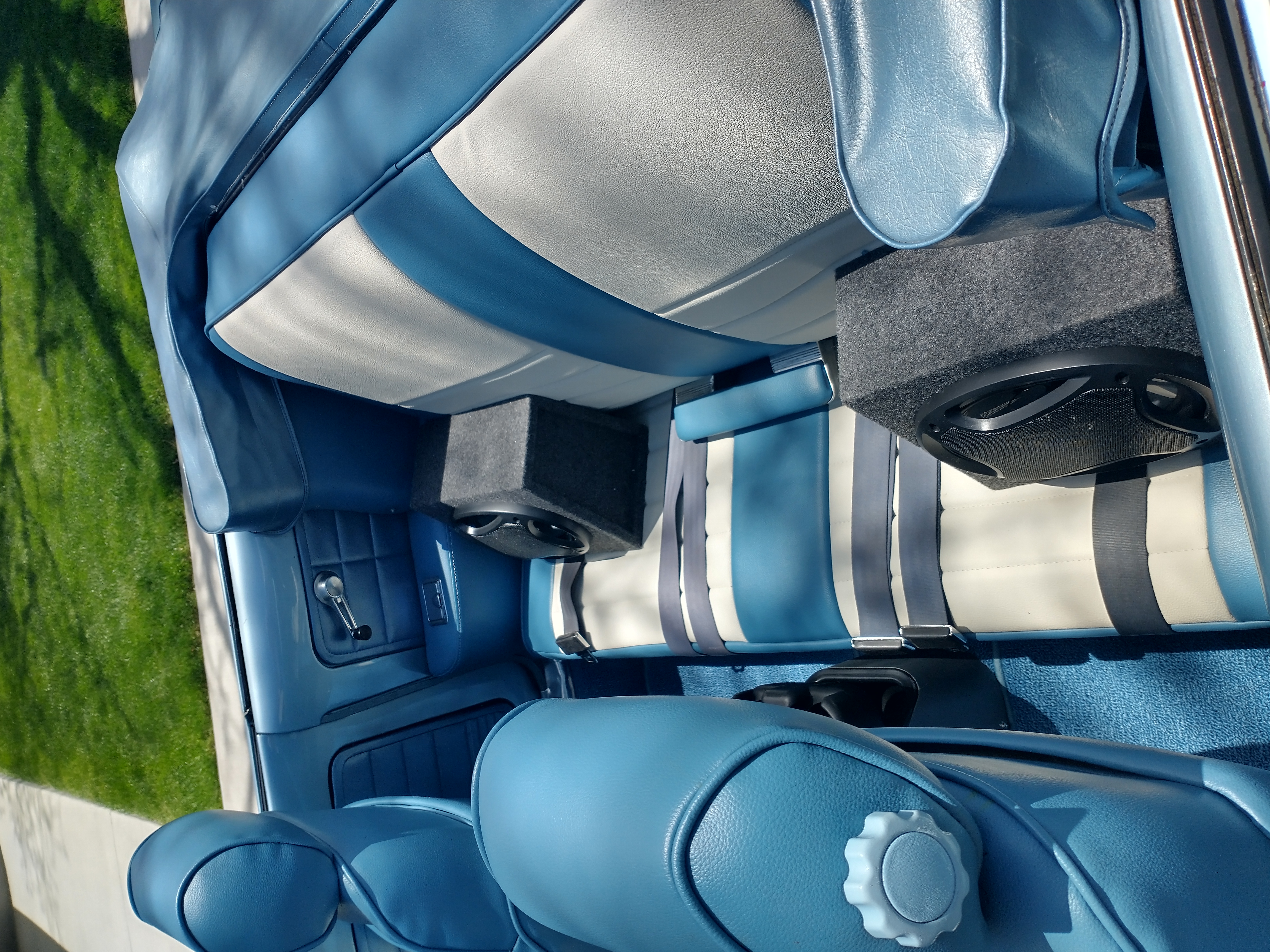

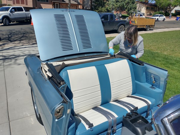

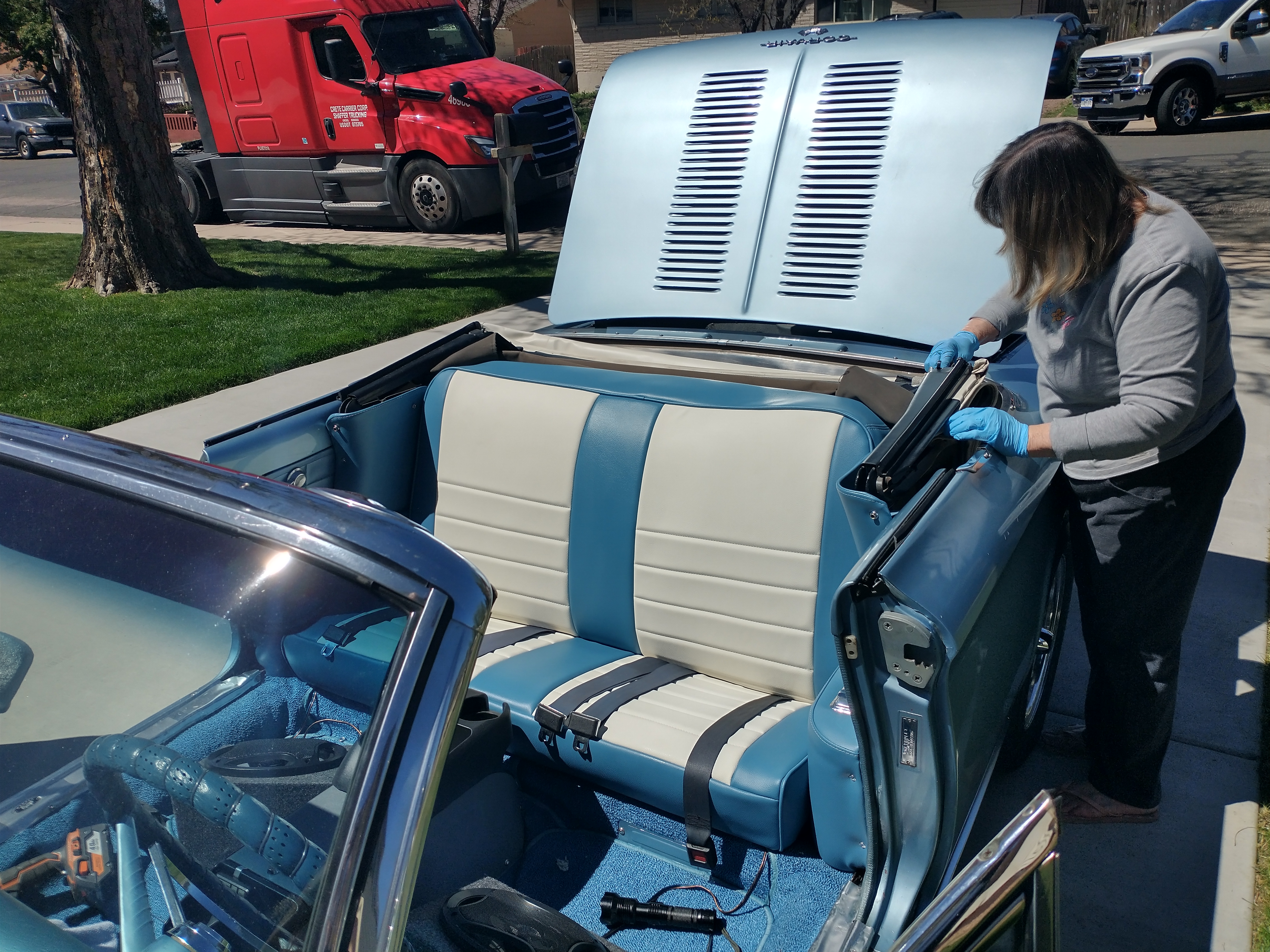

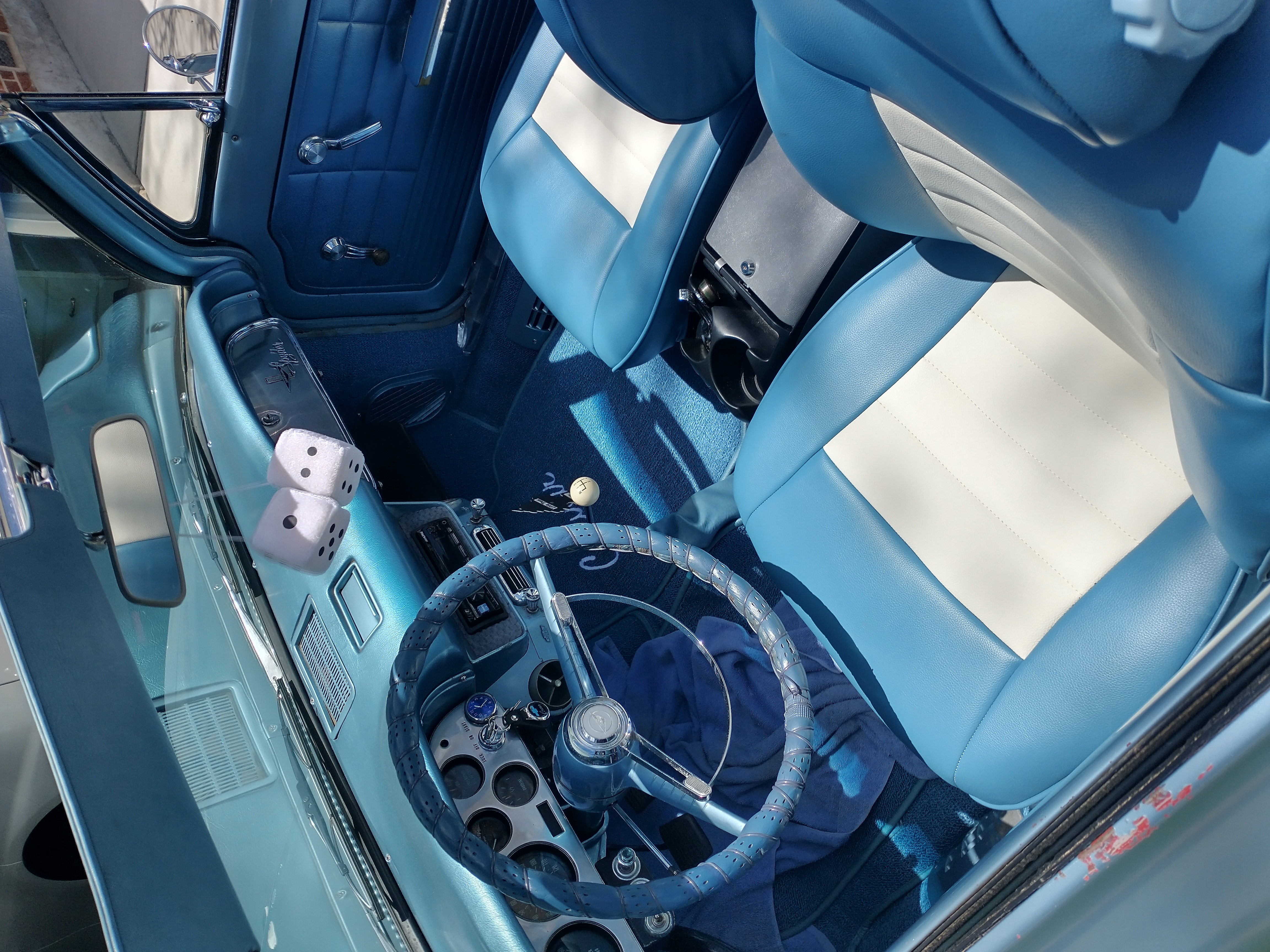

Finally got the job done. I couldnt find a blue color in leather that worked, luckily the wife is good with colors as Im color blind. So I went with a quality vinyl. I had the front buckets, rear bench, both side covers in the rear that hide the top mechanisms and the beed part of my top cover/boot all replaced/recovered. I also had to find replacement foam for the drivers seat bottom as it was torn too badly to repair well.
A couple pics. The wife was out helping do some cleanup. Im happy with the outcome. Next year will be paint! I have a few questions about getting ready for paint. New thread.
Couple sideways pics. Bummer. I must have had the phone turned.
Jerry...
Colorado Springs :wave:
