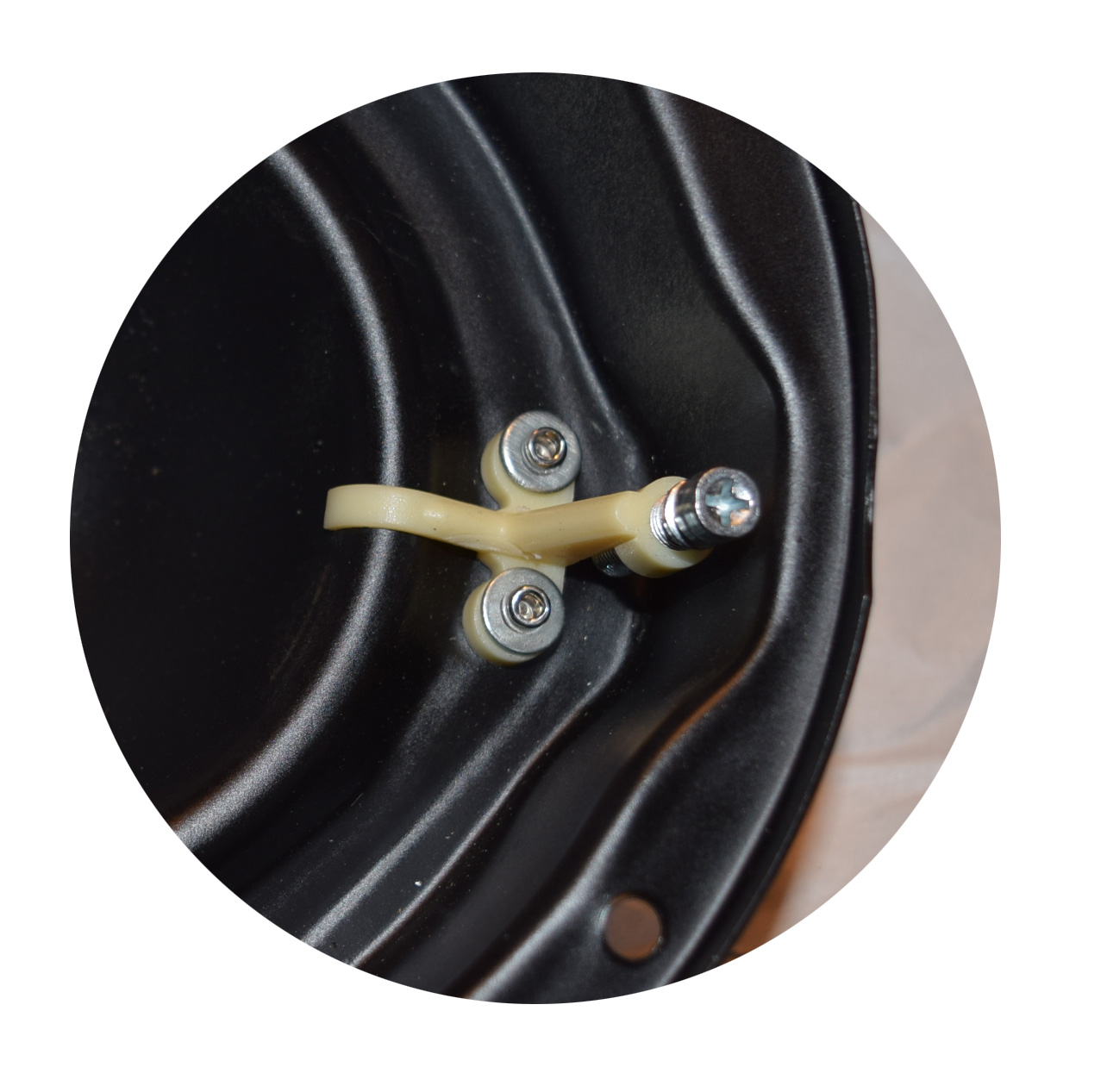

Before the bottom fell out of the thermometer, I made headway on a couple of fronts. This first one was another of those disappointing surprises. Stripping the paint from the bottom of the rear doors showed the severe rusting that had occurred, especially in the left-hand door:
The headlight buckets were finished working in the basement (with heat). I prefer to reinstall the everything to look as close to stock as possible which means using rivets; and not ugly-looking pop rivets. Here's an adjuster attached with semi-tubular rivets. I add the reinforcing washer to prevent the bracket from breaking when the rivet is set. These are the rivets I use for the adjuster brackets (left) and the springs (right). The adjuster rivets are set with a actual rivet setter, but that's not so easily done for the springs, So those rivets are set using an actual rivet setter, but that's not possible for the springs, so I used a broad center punch and a nail set to round over those rivets.
The rivets shown are really excellent for securing the springs because they fit into the spring rather tightly These rivets are nice also because the heads are wide and flat like the originals. Clarks provides harnesses for both the headlights and directionals. There's not much to installing the headlight harness. Just need to make sure the harness with the long wires goes to the right-side bucket. Although Clarks provides a bolt for connecting the ground wires to the bucket, but I prefer to use a hollow rivet that better resembles the original one The directional harness is more work, the problems being the light socket and its boot. The prongs on the light socket break if bent all the way down, and the boot is poorly designed. The original boot was like that of the tail light socket and securely cover the wires individually. That boot is available from Clarks. I substitute a Dorman 85803 socket instead, soldering the wires to new contacts The prongs of the Dorman socket can be hammered flat with a nail set without breaking. So the finished buckets look pretty nice and resemble the originals.
These will now need to be stored away for quite awhile.

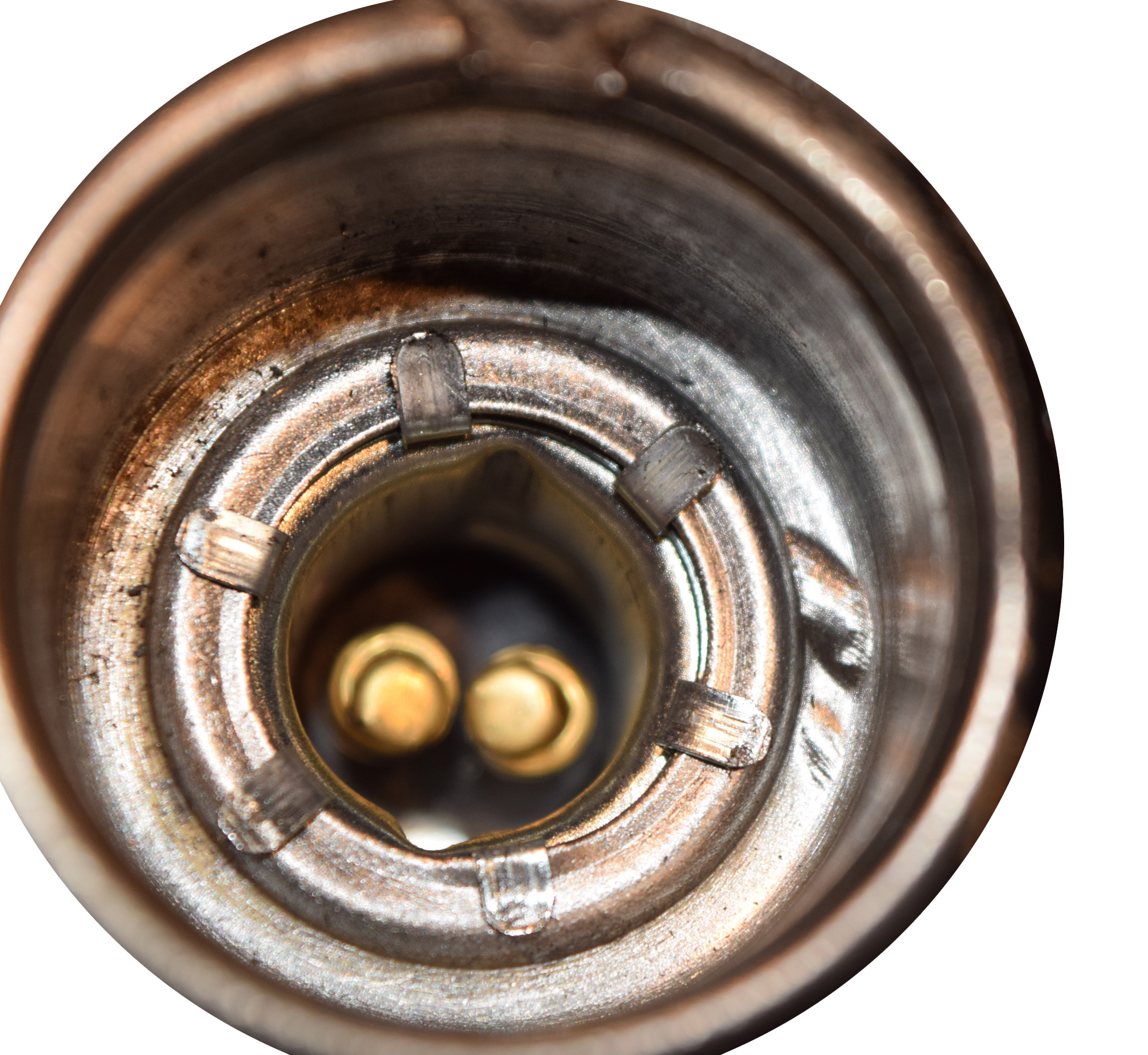

Help! I'm having a problem getting the ignition switch cylinder out.
Any suggestions?
Steve
I have the key (not shown) so I can put the switch in the 'lock' position, and with a metal wire probe I can feel the little plunger push down, but the cylinder will not turn. I've tried this with and without the key in the place, turning clockwise and counter clockwise (which I believe is correct), initially without and then after spraying WD40, and with and without cursing. Even cursing didn't help! Any suggestions?
Steve

Having a good working key should be all you need along with something to push down through the retainer pin access hole as you are apparently doing.
There is a chance that even though your key works, it could be worn just enough that the sidebar is not fully retracting.
With that said, the only thing I can suggest would be to wiggle the key while at the same time pushing gently on the retainer pin and turning the key and cylinder counter clockwise. This action might help encourage the cylinder to turn enough to release the cylinder.

Thanks both for the suggestions, and the cylinder has been set free. While it could have been any number of factors - continued wiggling (i.e., persistence), the WD-40, pushing the button just the right amount, or maybe key wear was, well . . . the key!
Steve
I do have two keys, and I was using the other key when it came apart. You can see how worn are these keys. But I also observed after a closer inspection that if the release pin is pushed too far, the probe used to push it can actually block rotation of the cylinder. I think. At the moment I'm not inclined to reassemble the lock and try to open it again :)Steve
