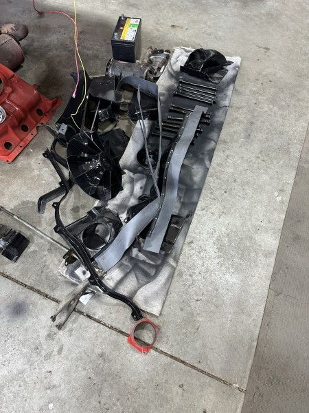

So after y'alls expert advice, what I have decided to do, is replace one cylinder, with the accompanying piston and rod. I ordered a new cylinder, piston, reconditioned rod, rings and rod bearing from Clarks. I had Clarks press the wrist pin on. I have had time waiting for parts to put my engine to body seals on as well, tried the staples, pffft, that sucked, I just drilled and riveted
I have found all kinds of tomfoolery and fu*#ery while taking things apart. I have had to helicoil some valve cover bolt holes (2), I found a wood screw in one of the holes, a sheet metal screw and washer in another, all sorts of things that make me nervous about the joker that did the last valve cover removal. One side has 3/8 inch bolts, while the other has 5/16 inch and an old helicoil in that side as well. I have found myself deep down the rabbit hole of "while I'm in there".
The advice I have received has been so helpful, many, many thanks. I used some pvc to keep the other cylinders in place while I rotate things, love that tip.
All of the tins have been cleaned up and painted, new o-rings for the tubes, oil cooler, and gaskets for the oil pan, bell housing, new seal there too. I put new exhaust manifold packings in and I have been running thread chasers in EVERYTHING.
