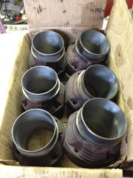

Engine case is clean,
cilinders are cleaned from the inside (no overbore)
the pistons, just clean them, need some more work, but they look good, after some more cleaning, thay can go back in
Cleaned my head, eeeeh the heads, outside almost done, inside need some more cleaning, but looks good

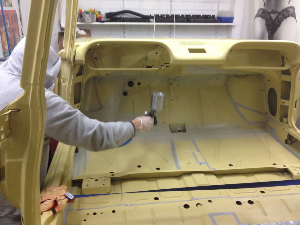

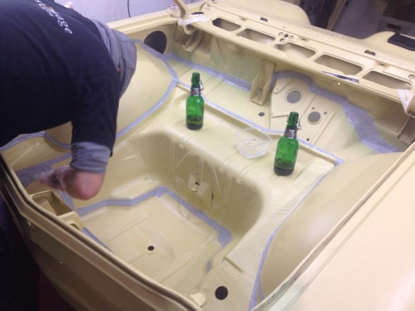

Ready for some bodyseal
After some sealer, we put on a basecoat
:woo: pretty happy with the result, yeahhhh ready for the next steps!

Those are Clarks modern full fin cylinders. Did you know the engine had been rebuilt before you got it?

@ TexasUK: no i didn't know that, but i looked it up and yes you're right damm,
i didn't know anything about the engine before i took it apart, there are different things done to it, other heads (102HP) and some othher things, but this i never noticed, thanks for giving me the information

TexasUK. For my future reference, what did you see that told you those were Clark's full fin replacement cylinders and not 1960 stock units?

http://i1274.photobucket.com/albums/y43 ... de4f50.jpg" onclick="window.open(this.href);return false;
Having trouble finding an image of a '60 cylinder but they also had full fins. Just trying to avoid any issues when ordering parts. Is that a shadow towards the top of the cyl. wall or the remnants of a ridge that was honed over? :coolphotos:

Is a 1960 Cylindar a little bit smaller i think??, because of the engine size 2.3 and a 1961 engine is 2.4 , maybe i can find a parts number in the cylindars or something.
yes there was a small line with engine cooked grease on the edge, we honed that away, and slightly grooved the wall, should still work with standard sice piston rings (i hope, need to measure them again hahaha)

Don't want to be a pain, I'm just trying to make sure you don't have an aw s_ _ _ moment with mismatched parts. You are correct the '60 model had a 3.375 bore while '61-'63 was 3.437. A difference of .062. The '60 also had the unique full finned cylinders I spoke of.
You really need to measure your pistons and cylinders again.
http://www.corvair.com/user-cgi/catalog ... N&page=27C" onclick="window.open(this.href);return false;" onclick="window.open(this.href);return false;
Read the part under stock size about the modifications Clark's made. ALL of their cylinders have the notch on the bottom, to work with the early and the later long stroke crank. The full fin jugs in the picture have no notch.
