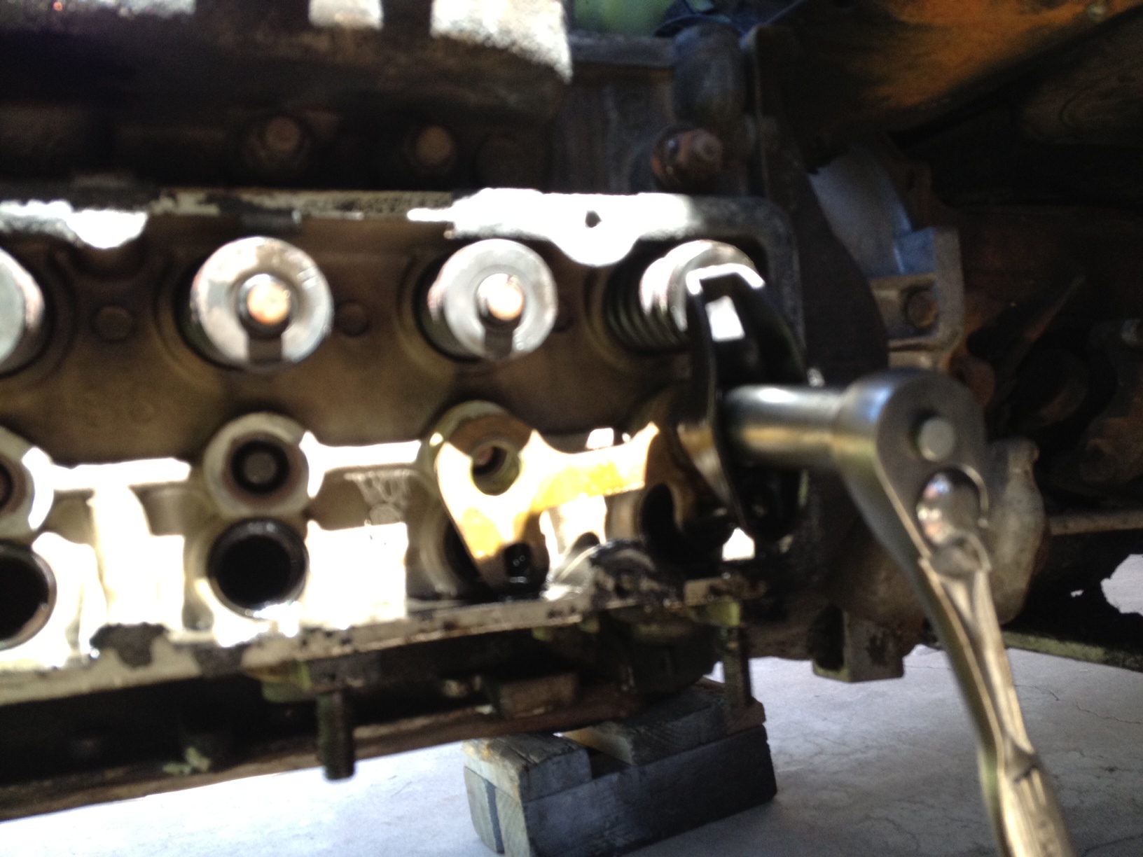

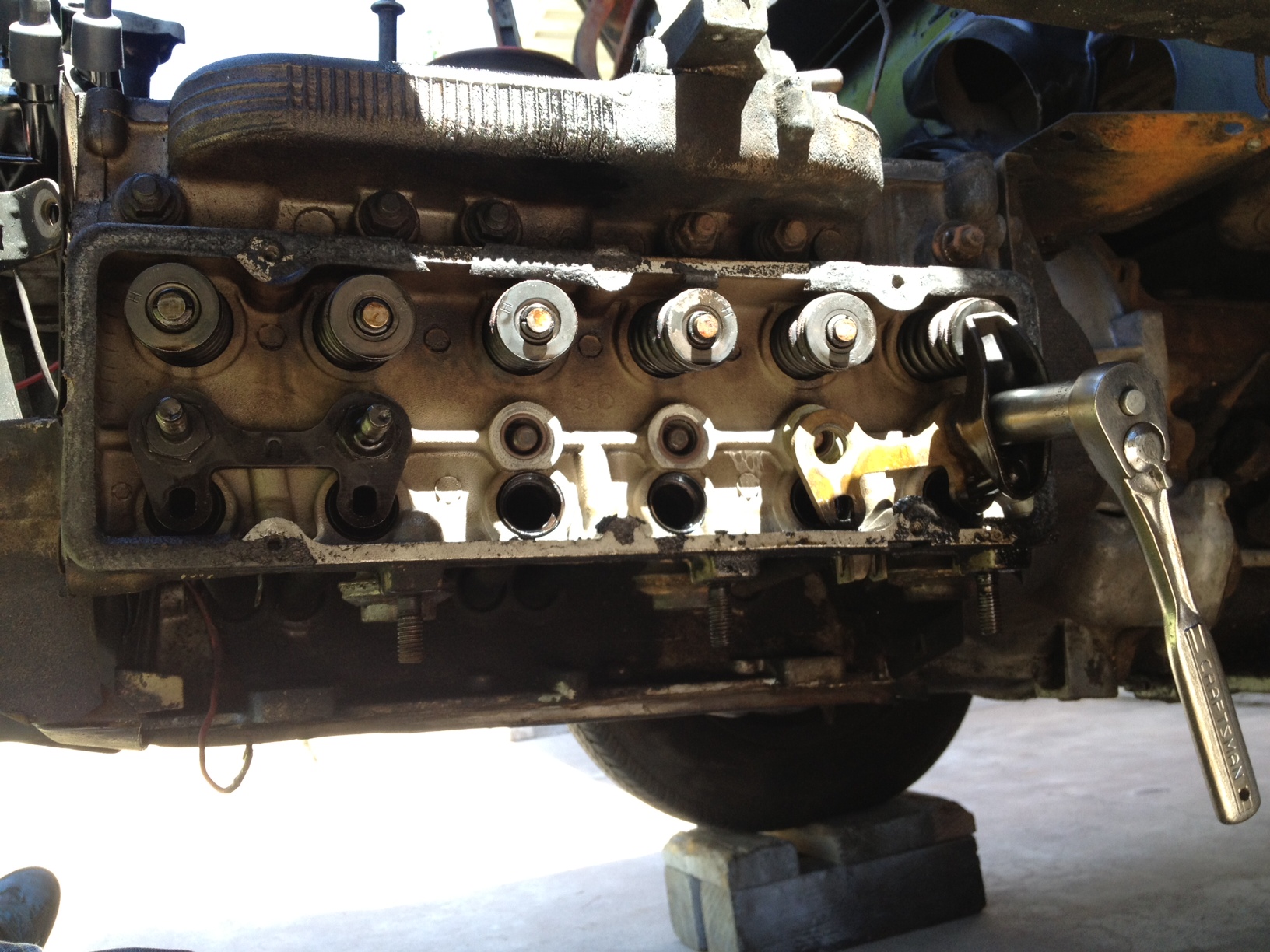

Bill and I started taking apart the passengers side of the engine. It so nice to no longer be working in the parking lot! I'm going back over there this afternoon and I'll try to take better pictures.

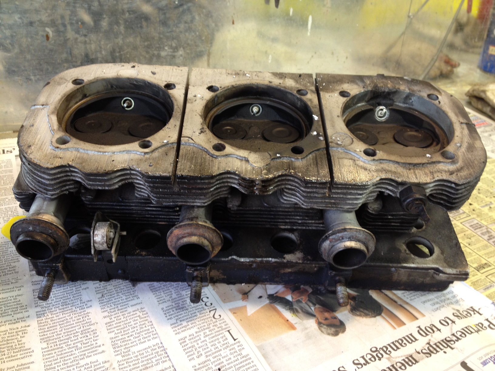

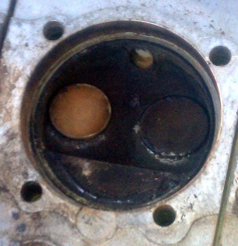

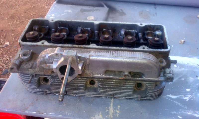

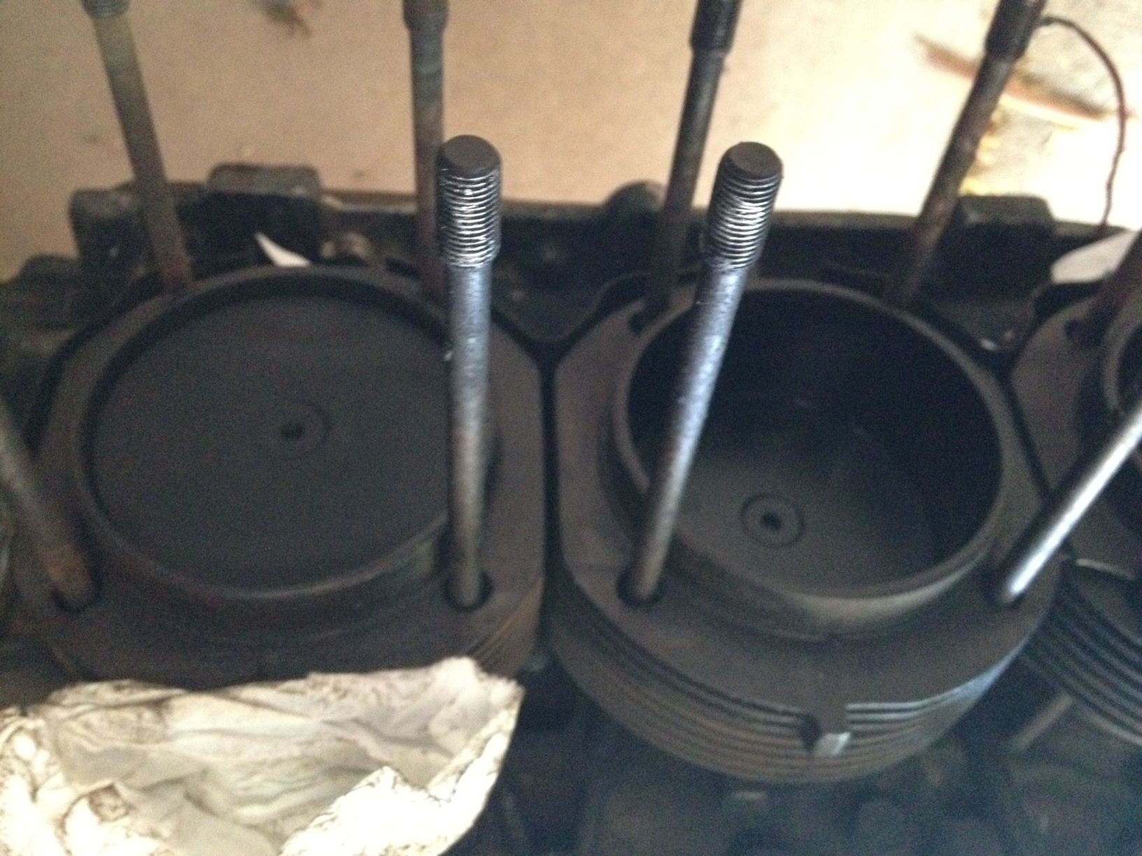

More progress today! We pulled the head off and discovered that it is toast. So I need a new head (used but functioning) with these numbers on it: 3856759
Bill said the pistons looked good. He also said the valves on the head looked good so I may be able to put them into a head with no valves....

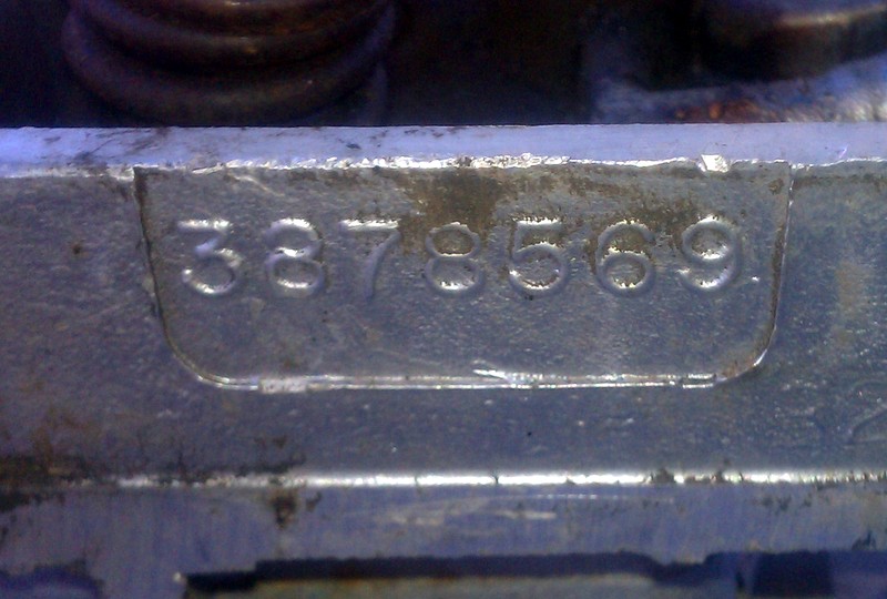

Sorry...the only single carb head I have is 3878569 which looks quite different in chamber design and I think is a 95 HP head from a 68-69.64CorvairEd wrote:Haha! That video is great. Thanks again Dave! We're trying to get a head replacement by this weekend so we can finish before Bill gets super busy. That would be awesome if you happened to have one.
