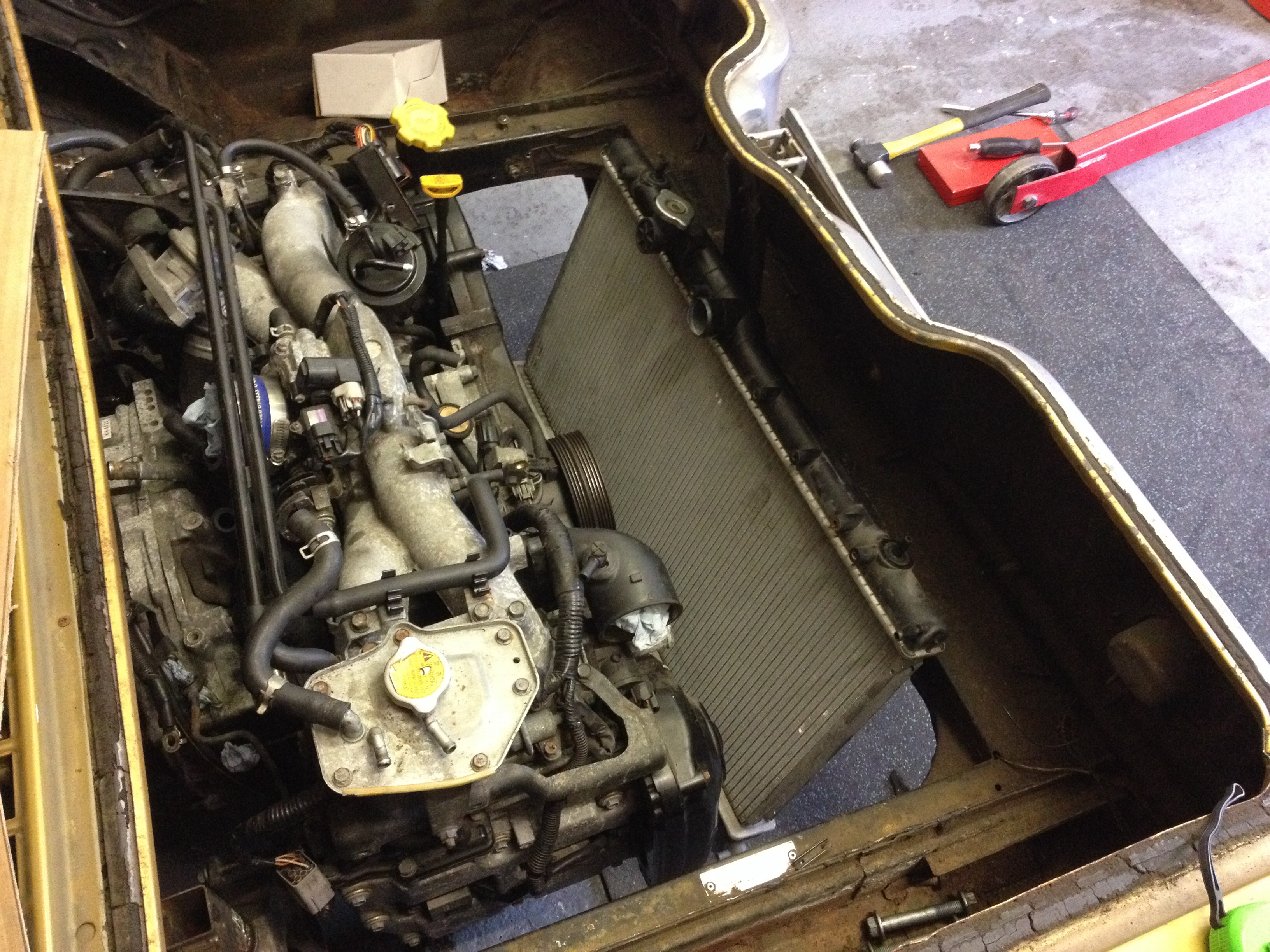

Looking promising for new location for the radiator!

i like it!! Do not cheep out on electric fans, they will work hard, but work well when used right! are you using the vair transaxle? if so how are you spinning the subaru motor the opposit direction

I am planning to use twin aftermarket fans, but as-per-me; there is going to be a further development on the radiator, before that happens ;)

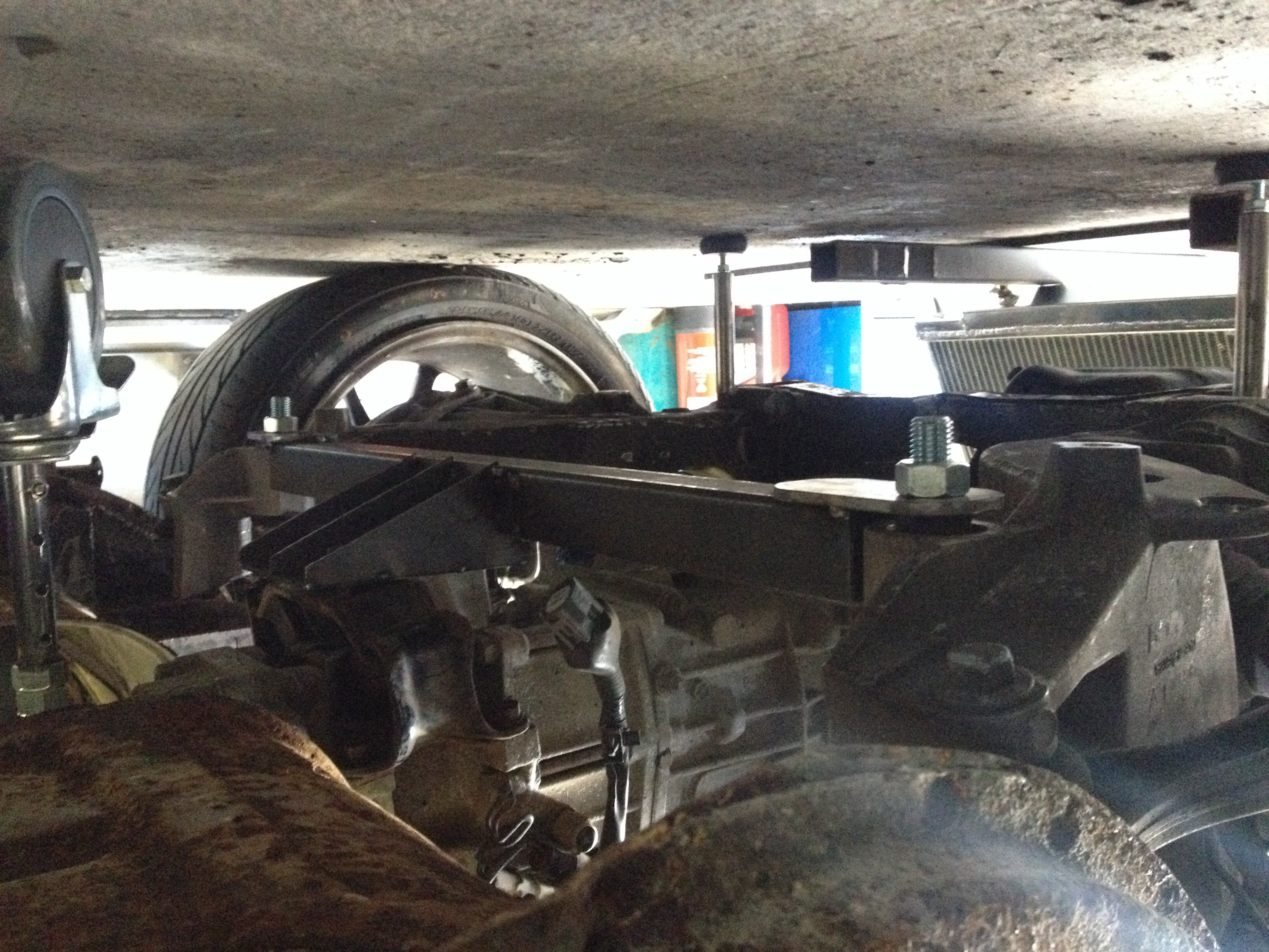

Not a very clear photo, but hopefully you can see the transmission crossmember is tacked up and bolted into position :)

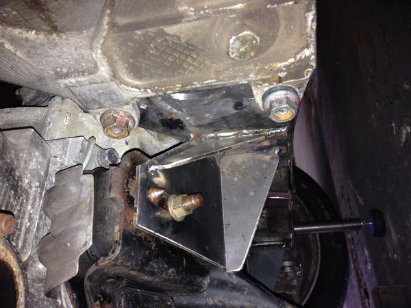

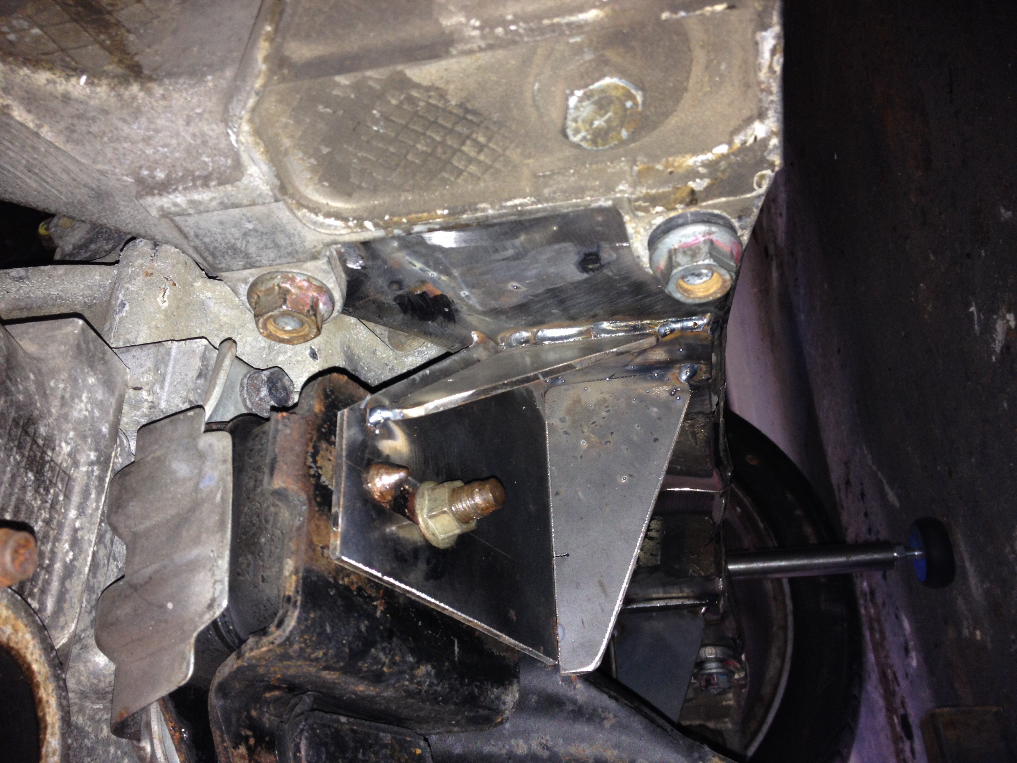

Re: Thunder Kiss '65 Project
Initial skeleton of engine mounts tacked together
Carrying weight of engine, but need gussetting to strengthen
Odd shape because of necessity to slide crossmember vertically down, out of suspension unit mounts

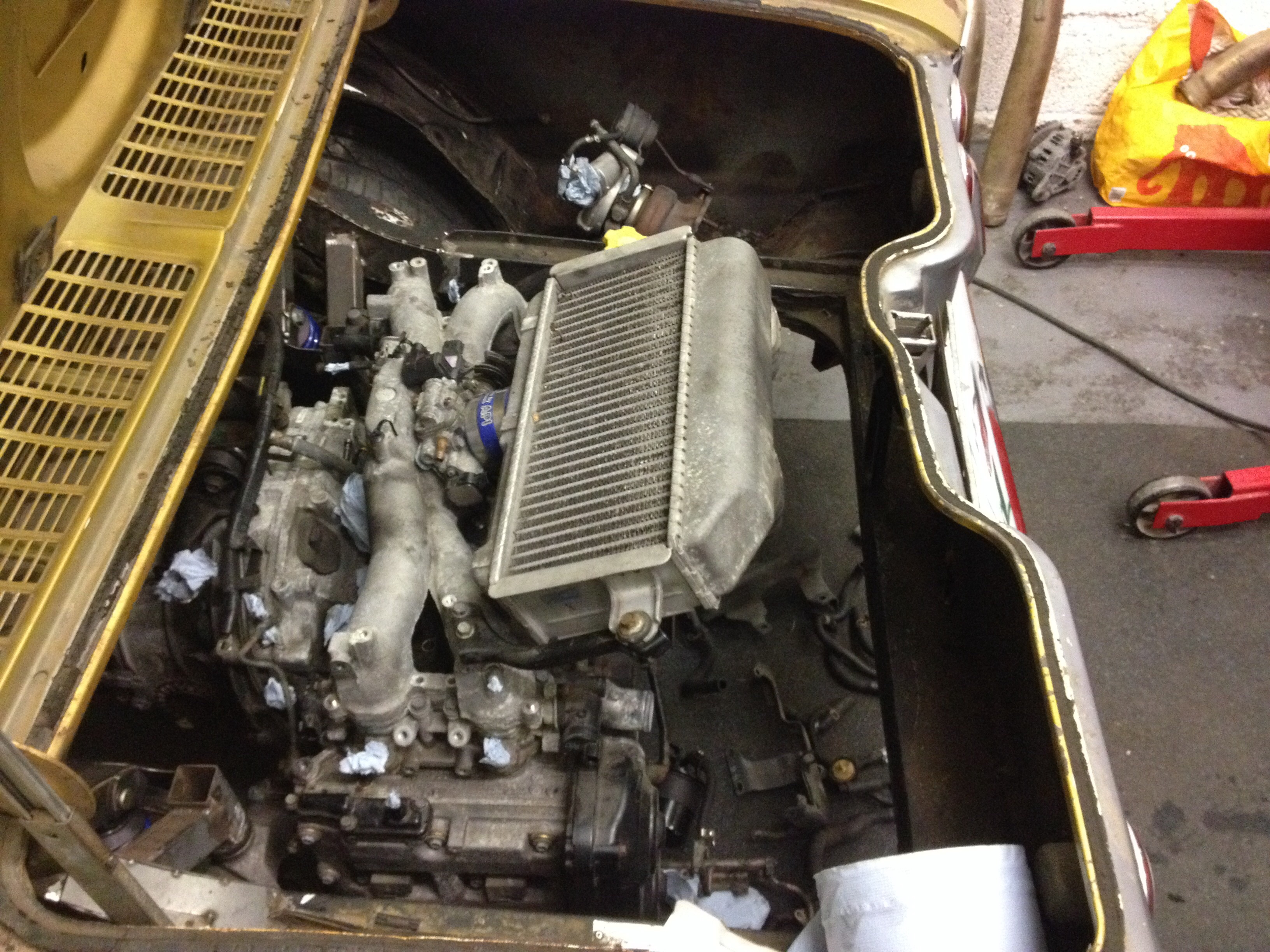

Turns out that you can unbolt the intake manifold on an EJ20, rotate it 180 and it bolts straight back on...
Except now the intercooler is in a 'clean' air stream :)
Surely this shouldnt be so easy?

i had some inexpensive "slim fit" rad fans on my honda powered corvair ealier, however they simply did not move enouph volume, I ended up swapping them out for fans from a 1986 saab 900, and they worked much better!!!! you need some depth to make a fan work properly

MikeD - I'm still mid process with the radiator, but am going to have some under bonnet ducting to guide air out of the cold-air 'box', over the top of the engine, and onto the radiator. The heated air will then exit through the rear valance; as-per original. The intercooler air is ducted from a separate source, but will ultimately join the airflow through the rad. I hear what you are saying about the fans; I think I'm going to reach deep into my pockets for a pair of Pacet or Kenlowe units...
