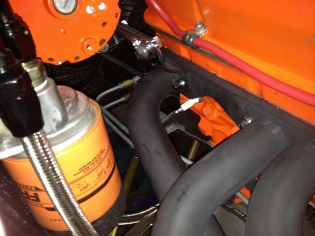

I went to the garage today to remove the radiator for repair. I picked up my friend Frank because he said he wanted to help......actually he said he wanted to keep me from screwing up anything else. After that statement, he proceeded to tell me that after we brought the engine around to TDC, he could remember putting the spark plug in but could not remember putting the plug wire back on.........A_HA !!!! I was wondering if I was the only one hearing a miss while it was running. So as soon as we walked into the garage we took a look and I got it in picture to prove I was not the only screw up.................I present exhibit A in the case of the missing plug wire
So what does this mean.............Another f*@$^&%# video
I spoke with the tech guy at Dakota Digital this morning. Damn nice guy and wanted to make everything right. I have the correct oil pressure sender along with the correct water temp sender on it's way from Dakota Digital on their dime...........pretty nice !!

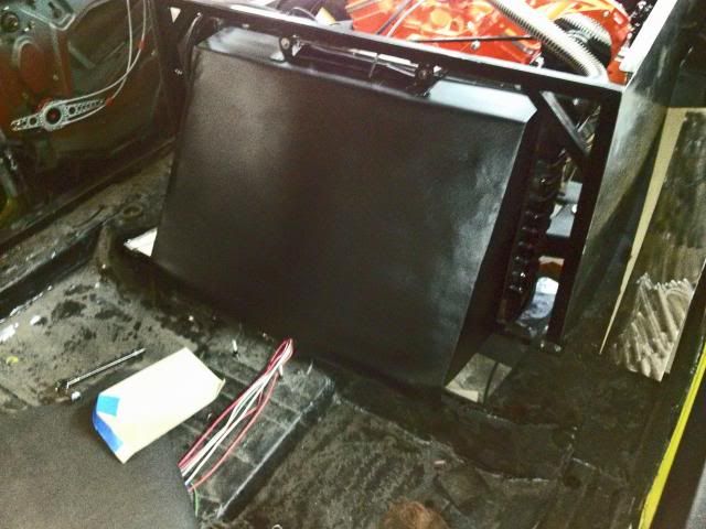

After screwing with this steam bubble, I got back into getting more work done. Today I finished up the air chamber that will direct all incoming air directly into the radiator. I also got the firewalls on each side started. All the firewalls / covers should be done before this weekend.

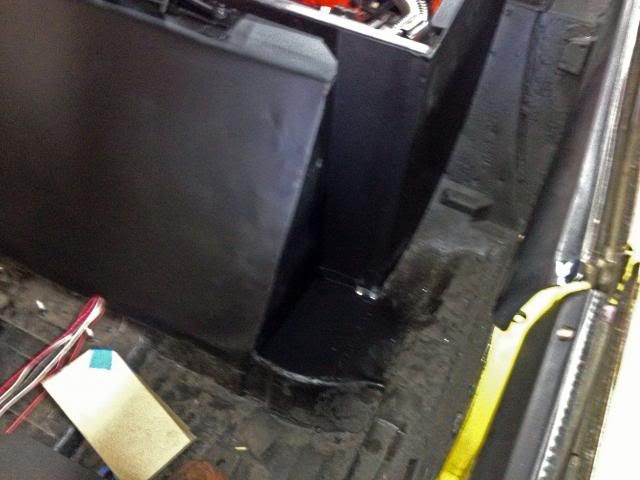

Life sure can get in the way sometimes. I have only been able to get to the garage a couple of times and only for short periods of time. I did get one side of the firewalls close to finished. After all the work that has been done, my friend whom I share the garage with asked why I had not been using the brake to bend metal. I told him the brake was broken and wouldn't bend anything.....................Damn thing works great !! I feel like such a dipsh*# when this kind of stuff happens.
So I made a piece to cover the whole in the floor by the radiator. I added a flange to the piece so it can hold some of the firewall. I also added a flange to the from piece of metal before welding everything together. Sorry for the somewhat shaky photo but I wanted to at least post something.
Here is how it looked. I still need to drill some holes in the flanges for some sheet metal screws but you get the idea

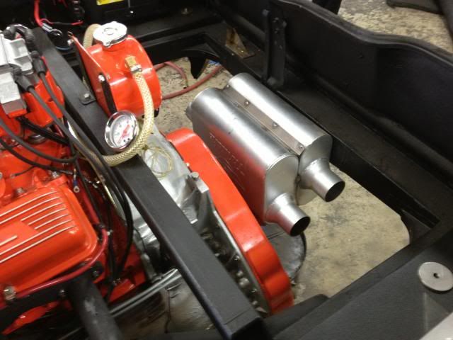

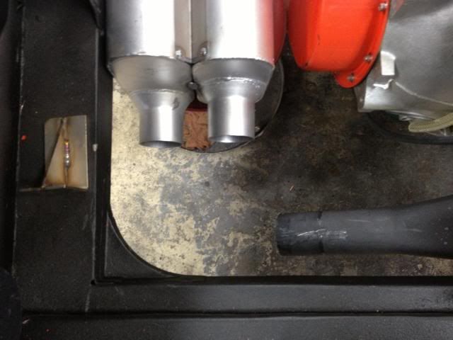

I decided to take on the exhaust system today. My Thrush Mufflers came in so it was time to see where and how they would be mounted. I ended up welding them together to facitate mounting them. So this is where they ended up...The stainless bracket that you can see on the rear frame rail will be welded to the mufflers and bolted to a plate that will be welded to the verticl part of the frame rail.........the bracket will bolt to the frame with a couple of 5/16 bolts om each side.
As you are looking at these mufflers, the lower tubes will be the inlet and attach to the collectors. The tube on the top side will be the output to the tail pipe and tips. This probably could not have worked out better if we had planned it this way...........here are some above shots to show how everything is just perfectly aligned
I am ordering a couple of J bends this evening...............the mounts have already been figured out..............It sounds great through these mufflers........................just not as loud

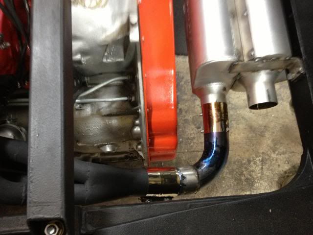

The weekend work time got eaten up with family things. So I went in a couple of hours on Monday and Tuesday and I am proud to announce that we got it working. It was really hard trying to get the pipes from the headers to the mufflers but I finished it today and it looks OK.........not great but OK.........here you go
The tail pipes to the tips is going to be another adventure.........got to get some 90 degree bends to cut up...........
