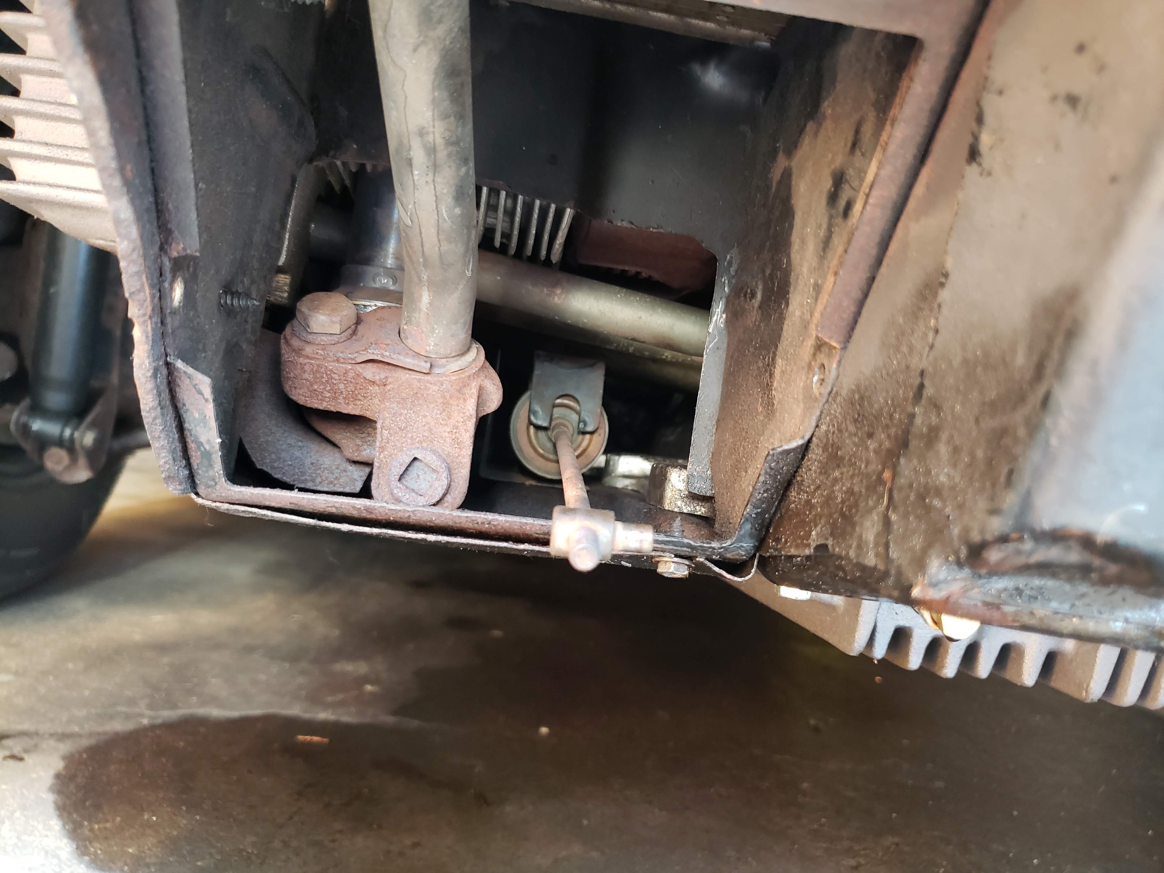

Thanks for all the help, really appreciate it. To address a few things that have been brought up. The previous owner did a lot more than I realized, as you will see in the pics below. It looks like the engine has gotten a lot of love. The valve cover, sump pan, exhaust and rear shocks look new. The wife of the PO who sold me the car said they started it every couple of weeks at minimum, kept it on a trickle charge, etc. Seems unlikely the problems stem from sitting up, it seems to have been a pretty active project until recently.
As for 87 octane gas, guilty as charged. When I first got the car, I topped it off with premium, thinking I would spoil it. It still pinged a little. But before that Milwaukee trip, I gassed it up with Citgo regular. Bet that is a big contributor. It also has a full tank of regular now. I bought a little bottle of octane booster and dumped it in, hopefully that helps a little. Ralph gets a steady diet of 93 octane from now on.
I am just back from the garage where I took some pics and started looking for possible causes. The carbs are very clean Rochesters, no sign of lacquer looking down the throats. I have gone around the vacuum lines, and some came off pretty easily, so they are all on as snug as I can get them now. But here’s maybe the biggest thing I found - the vent actuator on the left side feels totally different from the one on the right. Sitting cold, the one on the right is tightly closed, and you can open it against what feels like smooth tension against a spring. The one on the left is kind of hanging there limply, and won’t really move in either direction. I took off the rear vented body panel (hope I don’t have to do that too many more times) and popped of the vent door. Sure enough, the actuator is frozen almost all the way against the bump stop, but the door is barely open. There’s a fresh puddle of oil under that left cylinder bank, leaking from the valve cover. I think that side was really hot when I parked after that bad trip to Milwaukee.
Anyway, I’m heading back over - I bought a timing light, and an oil pressure gauge. I will see what I can figure out and post the results.

Yep, failed thermostat on left side. You need to fix that heater hose rubbing on drive shaft also. That’s not good. From the look of those underside pics I would question that low miles claim, imho.
