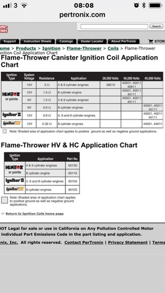

Pertronix wrote:
  • NOTE: REMOVE OR BYPASS EXTERNAL BALLAST RESISTOR OR RESISTANCE WIRE WHEN INSTALLING THE RECOMMENDED FLAME-THROWER COIL.
  • Do NOT remove the ballast resistor or resistance wire if the primary resistance is lower than specified or if you are using the stock coil.
  • Pertronix Ignitor Operating Voltage: 8-V to 16-V DC
The Pertronix instructions are recommending a full 12 VDC voltage feed to all of their high output coils, and those listed on the chart begin with the assumption that any ballast resistor or resistor wire in the vehicle primary ignition wiring has been eliminated as a basis for the Pertronix equipment installation. If one exists, Pertronix wants it removed or bypassed. Their recommendation chart assumes that all primary current control resistance is to be provided only by their coil internal primary winding, with 1.5 ohms for a V8 and 3.0 ohms for a 4 or 6 cylinder engine. (This sets the stage for proper support of both the Flame-Thrower coil and the Ignitor distributor electronic module — providing 12 VDC for both). Pertronix then compensates for differing engine configurations (8 cylinder vs. 6/4 cylinder) by recommending different high performance coils (1.5 ohm primary resistance for a V8, and 3.0 ohm primary resistance in the coil for a 6 or 4 cylinder engine). The 1.5 ohm primary winding coupled with a V8 engine short duty cycle and 12 VDC power source produces the advertised 40,000 volt secondary output to the spark plugs. The same coil connected to a 6 or 4 cylinder engine, with its longer duty cycle, would allow excessive primary charging duration — more than needed to attain a 40,000 volt output from the secondary winding. The results would be more heat buildup within the primary coil, which could shorten the life of the coil.
Switching to a 3.0 ohm coil primary resistance coupled with a 4 or 6 cylinder engine duty cycle would reduce the current flow, but the charging cycle for the primary would be lengthened by the longer 6/4 cylinder duty cycle, which again should reach the desired 40,000 volt secondary output because of the longer duty cycle expected with fewer cylinders. The reduced current with 3.0 ohms of primary resistance would keep the coil within designed heat parameters. The factory stock design configuration that switches to a high output voltage provided by the starter solenoid during cold start cranking would not be needed, because 12 VDC would be present at all times at the new high performance coil input, providing the advertised 40,000 volt high output to the spark plugs. The Pertronix Ignitor module would eliminate concern about rapid decay of the points contacts when subjected to 12 VDC.
NOTE: IN THE ABOVE CHART THERE IS SOME ROOM FOR CONFUSION, BECAUSE UNLIKE THEIR FIRST CHART THAT INDICATES "IGNITOR ONLY", THE SECOND CHART INDICATES "IGNITOR OR POINTS" IN THE FIRST SECTION. The Flame-Thrower 3Ω coil would reduce the current that the points would be exposed to, so excessive point wear would be prevented.
Pertronix wrote:Flame-Thrower II coils feature a super low resistance which make them the ideal coil for Ignitor II ignition systems as well as many other high energy ignitions. Low resistance and improved turns ratio help to produce up to 45,000 volts. This higher voltage enables you to run larger spark plug gaps for added power and better fuel economy.
These coils have internal windings that were designed to tolerate more heat with ultra-high current flow produced when coupling 12 VDC with only 0.6 ohms of internal primary resistance. The high switching current seen with such a coil would quickly destroy ignition points, and the Pertronix Ignitor internal circuitry was also not designed to tolerate this much primary current. The Ignitor II was beefed up with a switching transistor circuit and dwell control electronics that can tolerate the higher expected current when using a Flame-Thrower II coil. Connecting such a coil to a factory ballast resistor or resistor wire would not only cancel such a high output secondary voltage by reducing the primary current, but it would likely overheat the resistor wire or ballast resistor with an internal coil primary resistance of only 0.6 ohms, instead of the stock coil internal primary resistance of 1.28 - 1.42 ohms expected by engineers when they designed the factory wiring.
Of course I am making assumptions based on the technical specifications and installation instructions published by Pertronix. Many installation decisions are left to the installer, without really explaining why these different combinations of aftermarket ignition components and the variables seen in factory wiring may cause problems if the purchaser and installer doesn't understand the implications of incorrect wiring. Crane Cams, with their optical trigger ignition system, designed the electronics in the XR700 to operate with the lower expected voltage when the resistor is left in the circuit. (In fact, it can overheat if connected to 12 VDC). Their XR3000 is similar to the Pertronix Ignitor II in its high performance design that tolerates ultra-low resistance performance ignition coils.

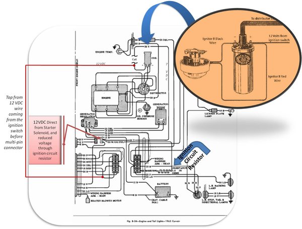

To summarize, the goal (from the Pertronix viewpoint) is to eliminate both the standard ignition points and condenser AND the stock coil AND the stock ballast resistor wire in the wiring harness. This leaves you with a full 12 VDC feeding the Pertronix Flamethrower high performance coil and the Pertronix Ignitor or Ignitor II electronic breakerless ignition module. With a six-cylinder engine in this configuration the 3.0 ohm Flamethrower coil would control its own internal primary winding current to restrict heat buildup when attached to a six cylinder engine.
It is common to tap off of the ignition coil positive terminal to power the electronics in the breakerless ignition module. That electronic circuit in the Pertronix Ignitor or Ignitor II module needs a full 12 VDC all the time. If the factory ballast resistor wire were to be left in the wiring harness, the voltage feeding the coil and the Pertronix module in the distributor would be correct for a 1.5 ohm coil (nominal 3.0 ohms total) but too low for proper operation of the electronics module inside the distributor, and a malfunction in operation could result.
This diagram shows a suggested bypass of the Corvair factory ballast resistor wire to power a 3.0 ohm coil and a Pertronix distributor module. This lets the 3.0 ohm coil take care of restricting primary current for cooler operation with the six cylinder engine, while the Pertronix Ignitor module in the distributor is happy with a full 12 VDC all the time when the key is ON.
Left-click the image to enlarge for better viewing...
