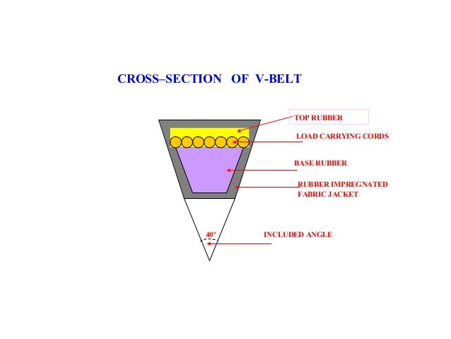

The image above displays the support strands that are embedded around the perimeter of the belt to provide it with tensile strength. A belt that has flipped off from the Corvair pulleys on its own may have suffered damage to these support strands that are internal and hidden from view. However, one or more damaged strands within the belt can severely weaken its overall tensile strength, which means it is likely to flip off again as it stretches if a damaged belt is reused.

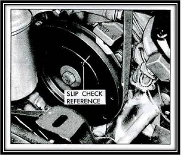

If you have a harmonic balancer on your engine, you should check it for signs of slippage between the center crankshaft hub and the outer harmonic dampener. The two steel components are held together in a press-fit by a rubber ring. This rubber component can deteriorate with age, which can permit slippage of the outer steel dampener. A slipping outer dampener makes for an inaccurate timing mark, and the outer ring will eventually completely separate. If the register mark between the inner hub and the outer ring shows signs of slippage, the harmonic balancer should be replaced with a new harmonic balancer.1961 Shop Manual, Page 7-4 wrote:Adjust belt (if necessary) to give a 3/8" deflection between blower and idler pulley under a 15 pound load. If a new belt is installed, adjust deflection as described above, then operate the engine at 1500 rpm for at least one minute to "seat" the new belt. Recheck deflection.
