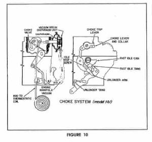

Re: High Idle Cold Engine = How to set
Carburetor adjustment procedures — including choke mechanism adjustments — begin on the 17th page of the attached manual: DELCO ROCHESTER - Models H, HV Carburetor Service Manual.
I have also included applicable sections of the 1965 Chassis Shop Manual.

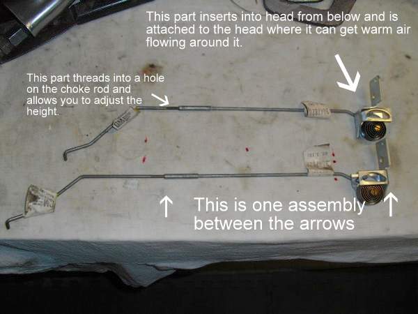

azdave wrote:
morgan95 wrote:The choke coil screws into the choke rod and the choke rod attaches to the car?
And if I'm not mistaken one end of the choke coil is threaded for the choke rod to screw into?
Did I get those two correct?
The choke coil has a straight rod attached that extends up into the head. This is normally one assembly when purchased. The straight rod has a threaded coupler fixed to it that is permanently attached. The angled choke rod that is in the engine compartment, threads into the coupler and has enough threads that you can adjust the final length to get the choke set correctly.

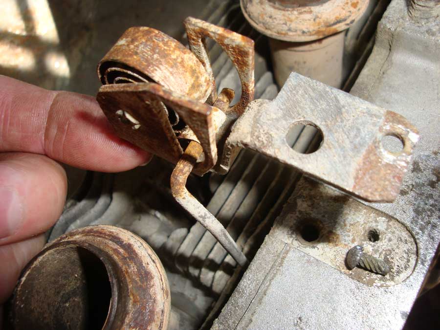

bbodie52 wrote:Yes, the choke rod from the carburetor is threaded into the rod that extends upward from the coil on the underside of the cylinder head. To clarify...
This is a view of the underside of the cylinder head, near the exhaust ports. The picture shows the mounting location where the choke coil is riveted to the aluminum head. A loose rivet is shown next to the rivet hole. When attached to the head, the metal coil responds to increasing cylinder head heat. It starts out when cold by applying spring pressure to the choke mechanism on the carburetor, forcing it into a closed position. As the engine heats, the coil contracts and gradually releases spring pressure on the automatic choke mechanism. When the engine is at full normal operating temperature the spring pressure is minimized, which allows the carburetor choke mechanism to move to the full open position.
