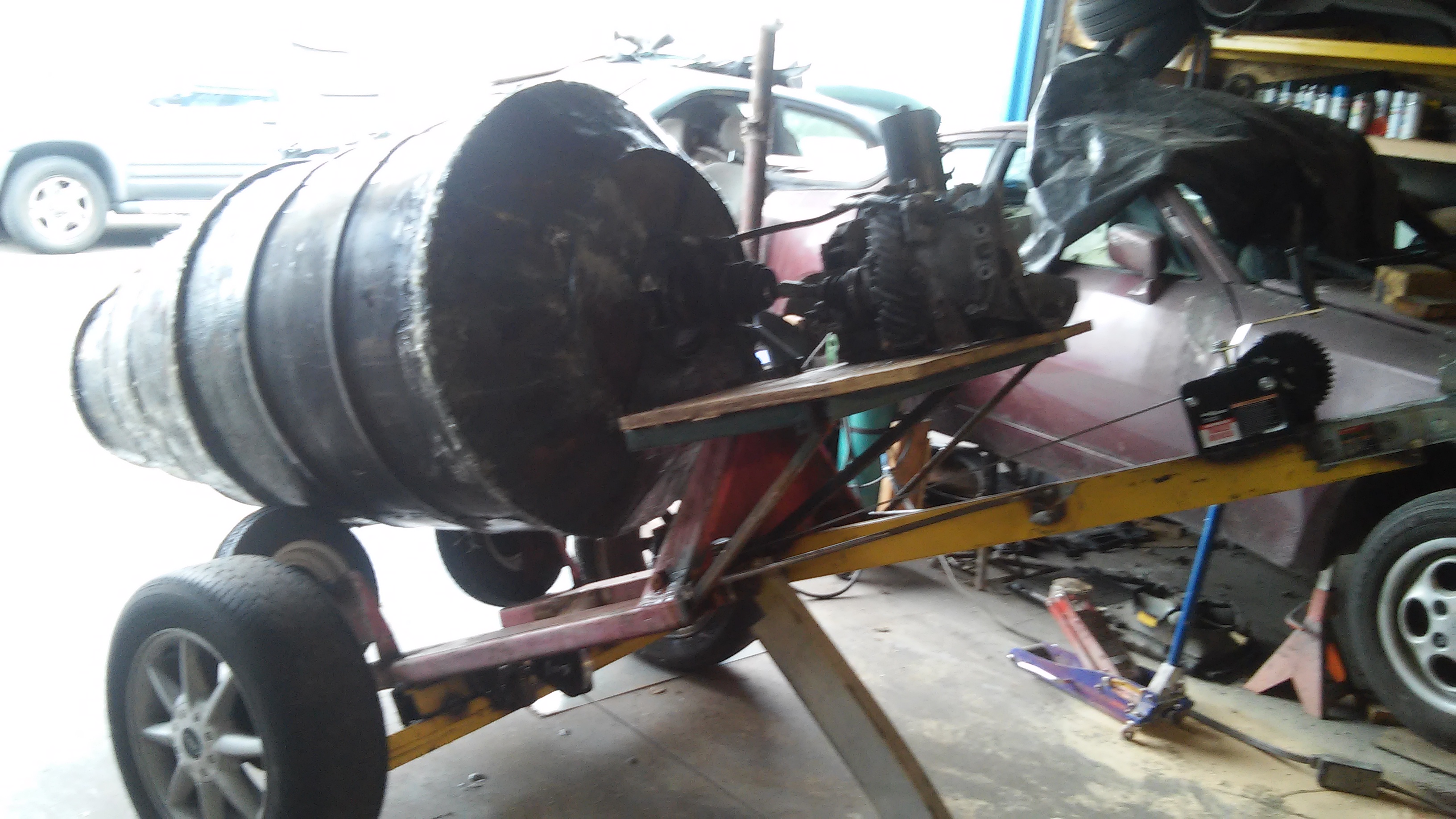

But just to give something to look at engineering wise, I built a second cement mixer, this one will mix a half-yard of concrete. Used some 55 gallon barrels, toyota transmission, old fork lift frame, trailer axles, ford contour fwd spindles and wheels, winch motor, and the most expensive part I had to actually pay for was a 50:1 gear reduction unit bought from a closed farm operation.
Pics shows first version without the gear reduction unit that blew up in the first test run. The winch motor spins 3600 rpm, the mixer needs to spin 10rpm, so I need 360:1 gear reduction, this is not easy. Just poured a 12x10 pad for a neighbor's shed for the new transmission test run, now I have 5 yards of foundation to pour for the house addition.
Here is a pic of the current with the industrial gear reduction, and the smaller one I made (used to pour the extended driveway, the rolling gate tracks for the alley, so I can get all my cars in the backyard... have 5 in the backyard.
