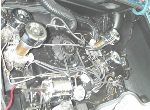

These are on my Rampside. I don't have the crank case vent worked out yet. The filters are from California Corvairs. The engine cover has 2x4s under it to clear the filters. They were very affordable.
And this is the setup on my 69 Monza.

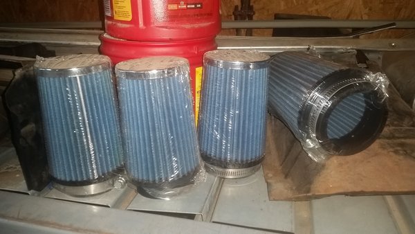

Crappy pic and they've been on my shelf forever. Got these from Marty Katz in Vegas. Weren't too expensive I don't think.

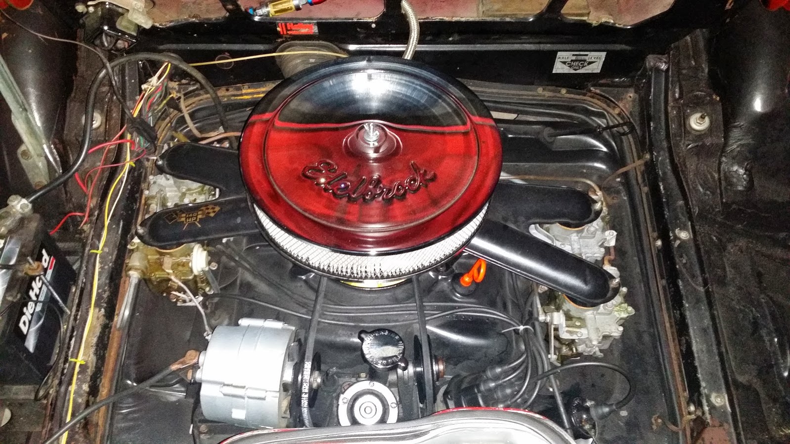

Painted the x tube bought a 2 barrel adapter plate that fit exactly the size if the x tube then chrome air cleaner. Maybe $30 dollars for the job.
Re: Those with 140s, let me see your air filter setups!
Nice look Mark
