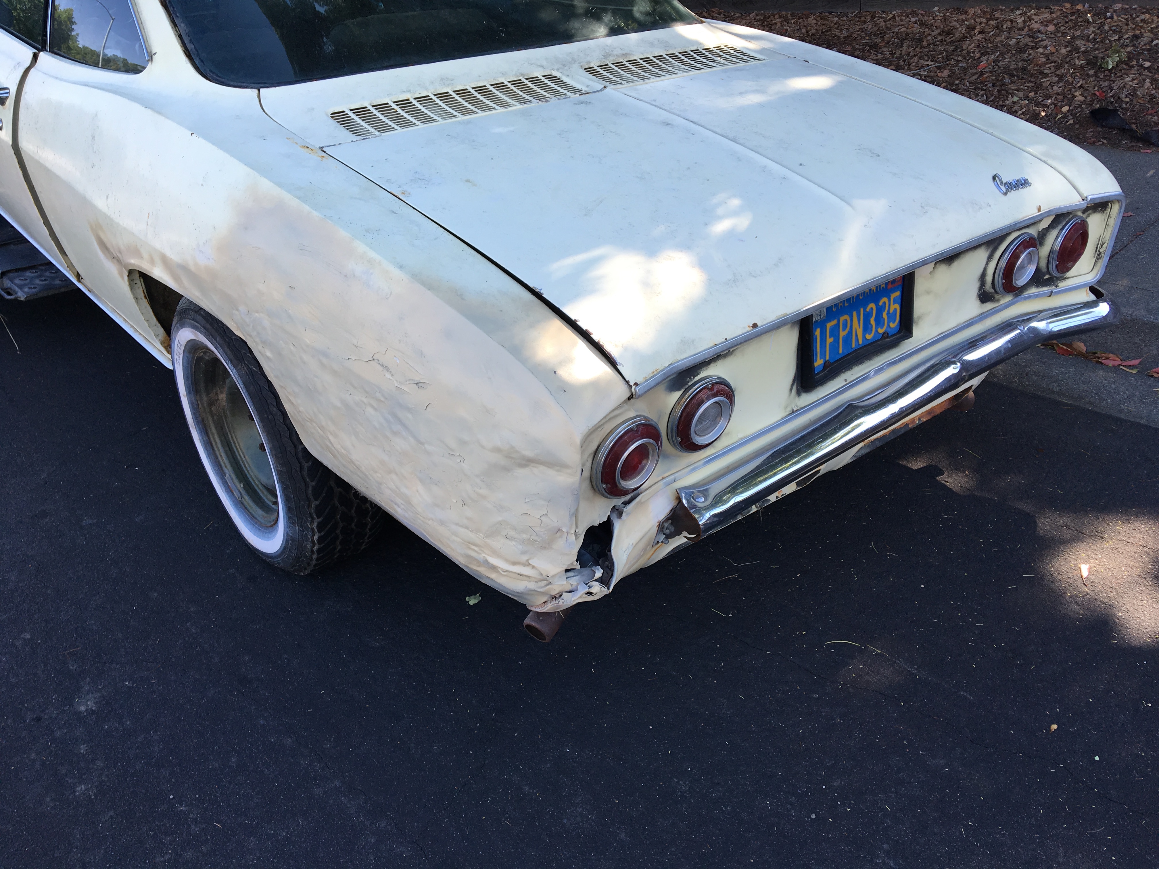

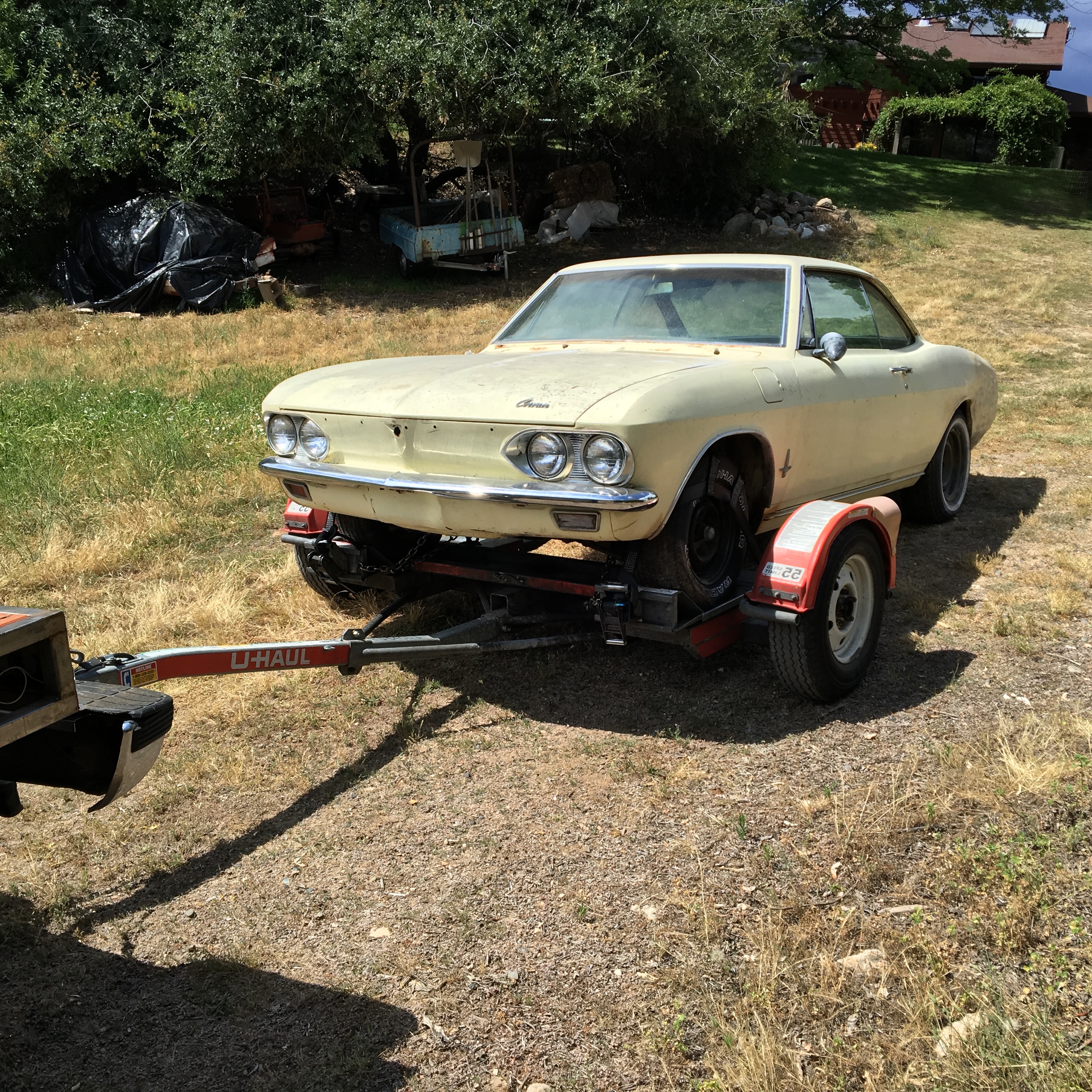

Well I picked up a parts car today with a 140 and a 4 speed to swap into my 67, problem is I may have jumped the gun a little bit here. The parts car is a 65 ( at least thats what i was told, i havent checked the body tag for myself yet) and after a little bit of reading I'm realizing that the pedals dont cross over from a 65 to a 67, is that true? and is that all that won't work? but I guess even if that wont cross over at least I got a windshield out of it and some good emblems and latches/ door handles. Paid 800 for it, and it runs and sounds great.

True story, the wider column on the '67 prevents using the pedal assy from a '65-6. Some other parts are a little different too but since you have a donor car you'll have everything you need. If you want reverse lights, let me know and I can walk you through how to make that happen. 65 4-sp is different than 67 MT and both of those are different than PG.
You'll want to round up a pedal set from a '67-9. Ideally a '69 so you can take advantage of the 1-year clutch cable with a heim-joint end rather than the trouble-prone ball end clutch cable.

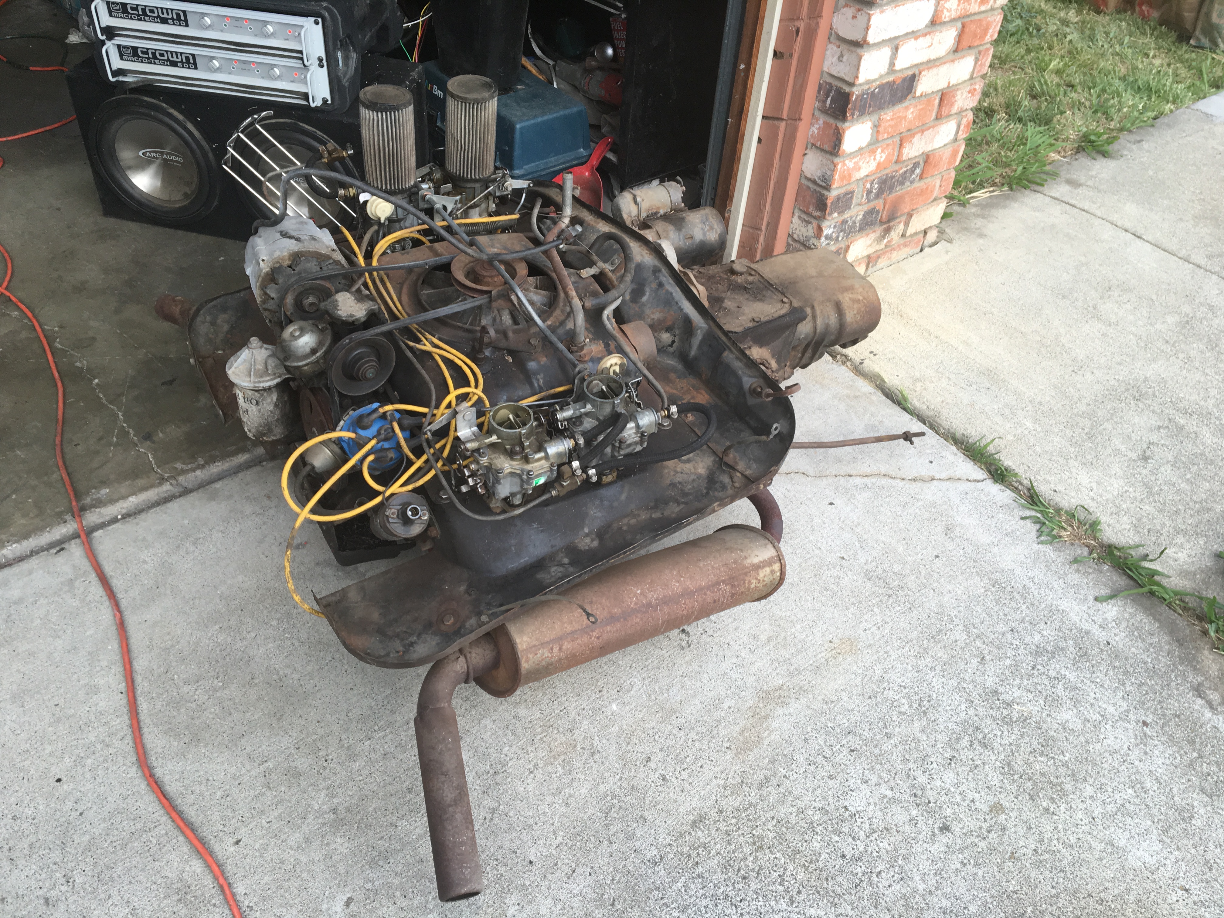

Pulled the engine, trying to decide how much of it I want to go through right now since it was sounding really good. May just throw it in and wait until winter to rebuild it. Get some drive time in this summer:)

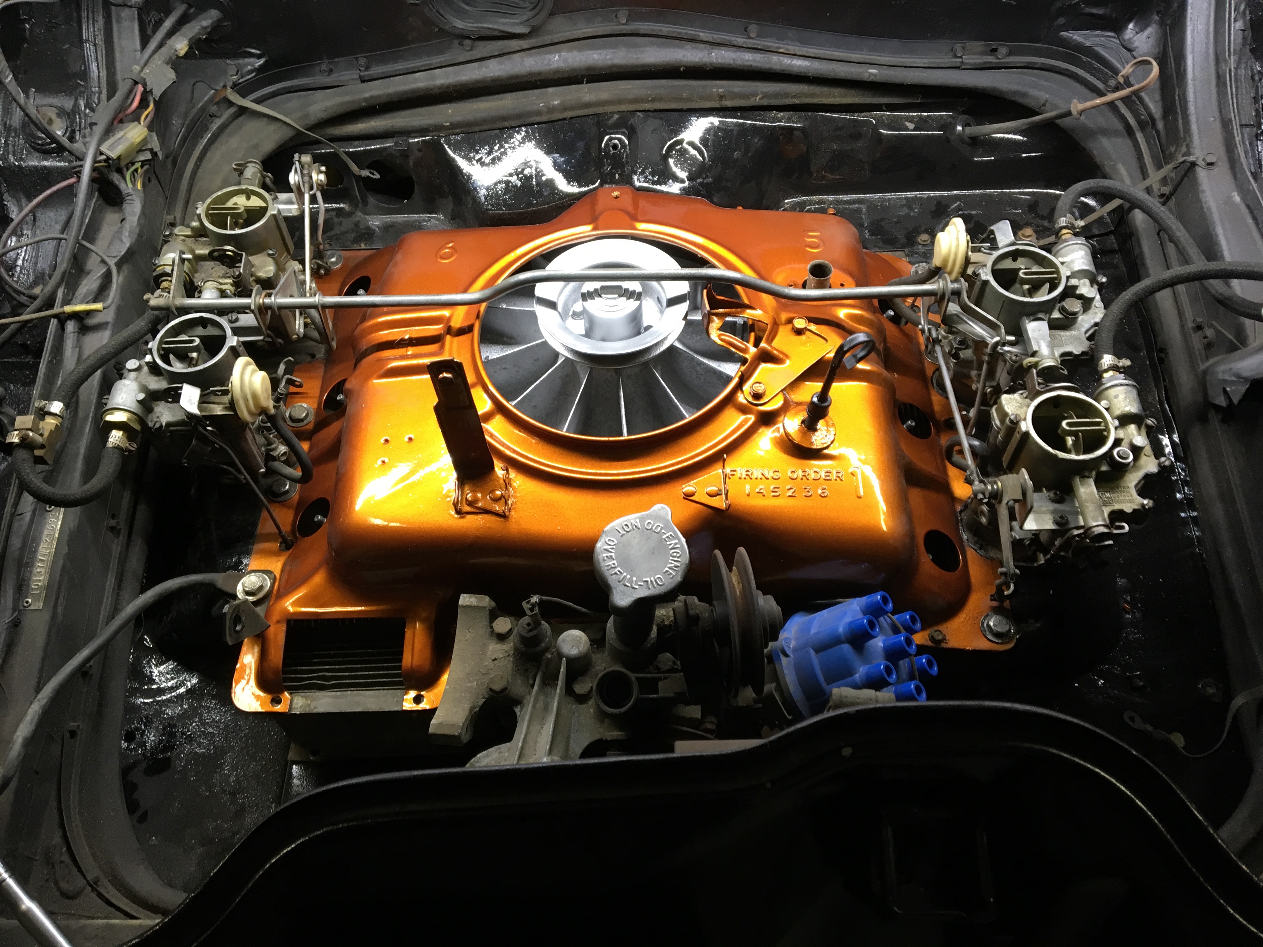

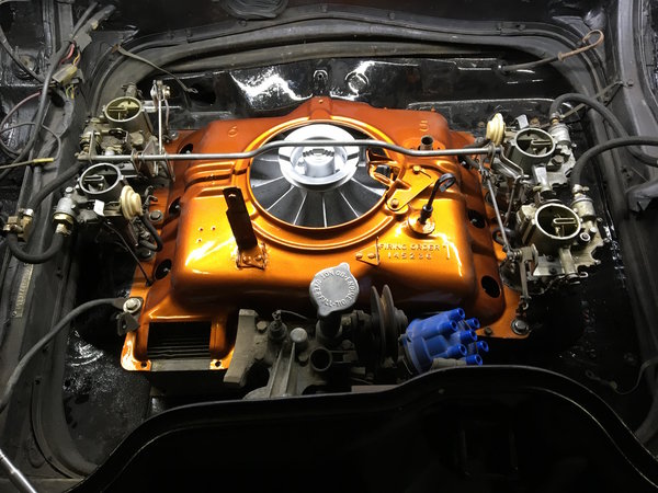

Well It's Finally running! heres the proof! hah

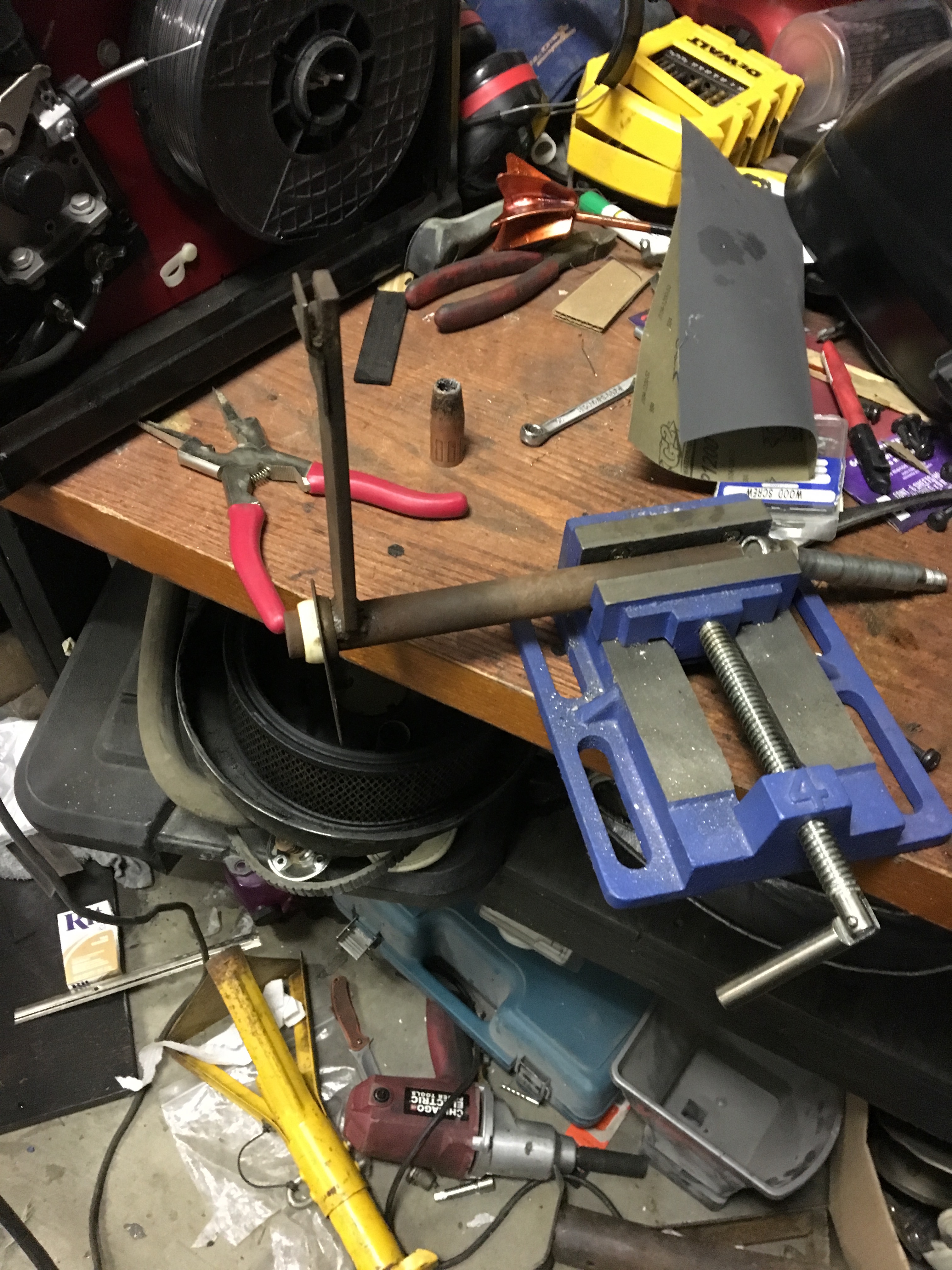

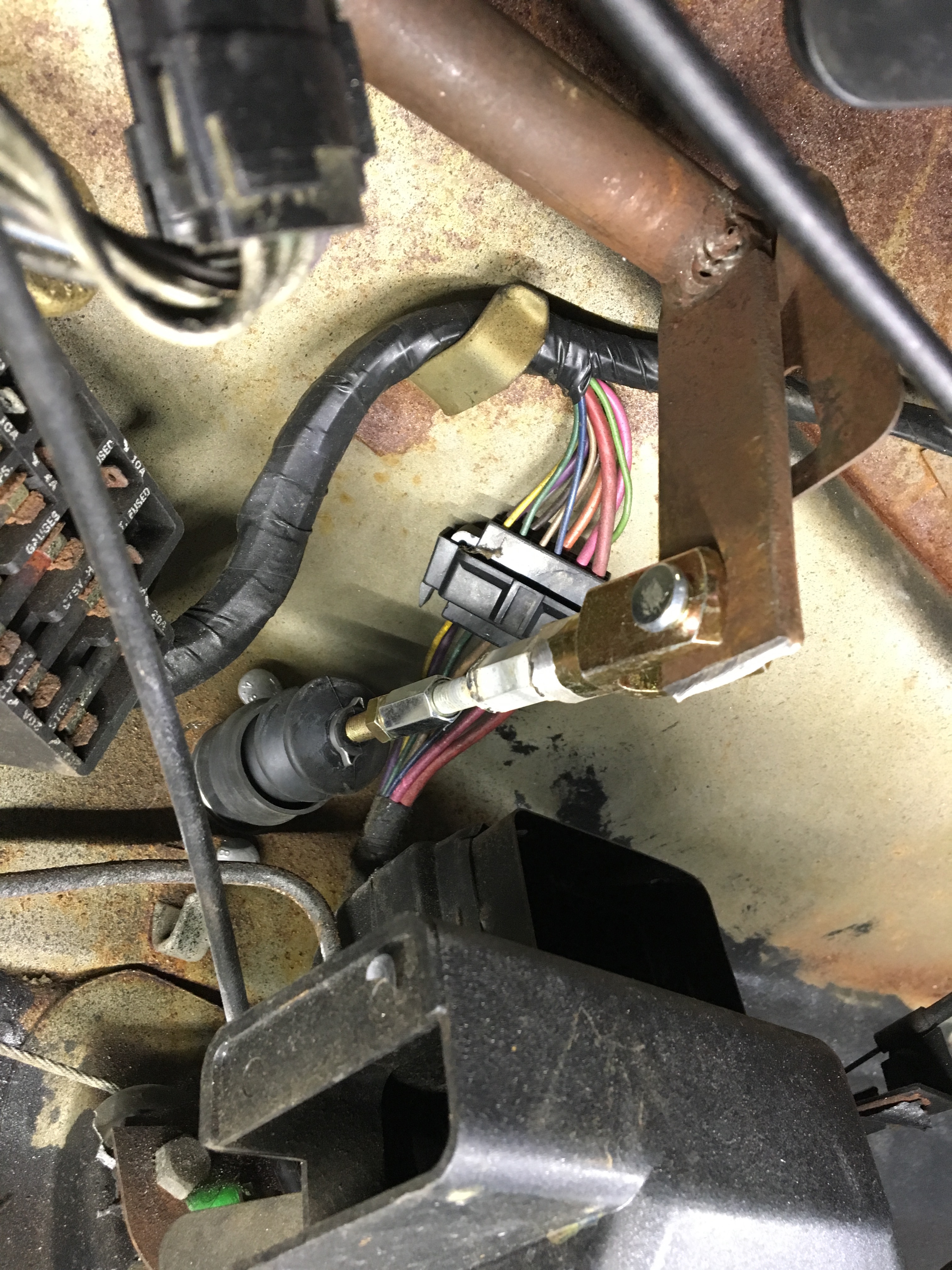

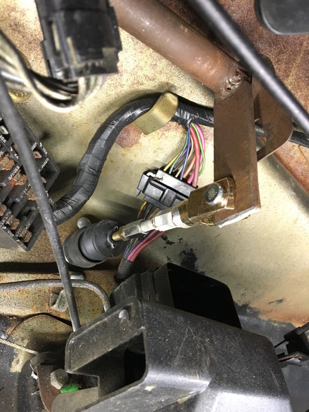

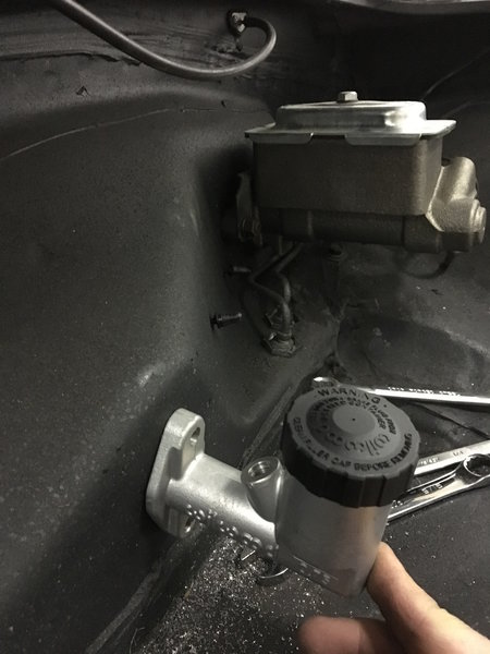

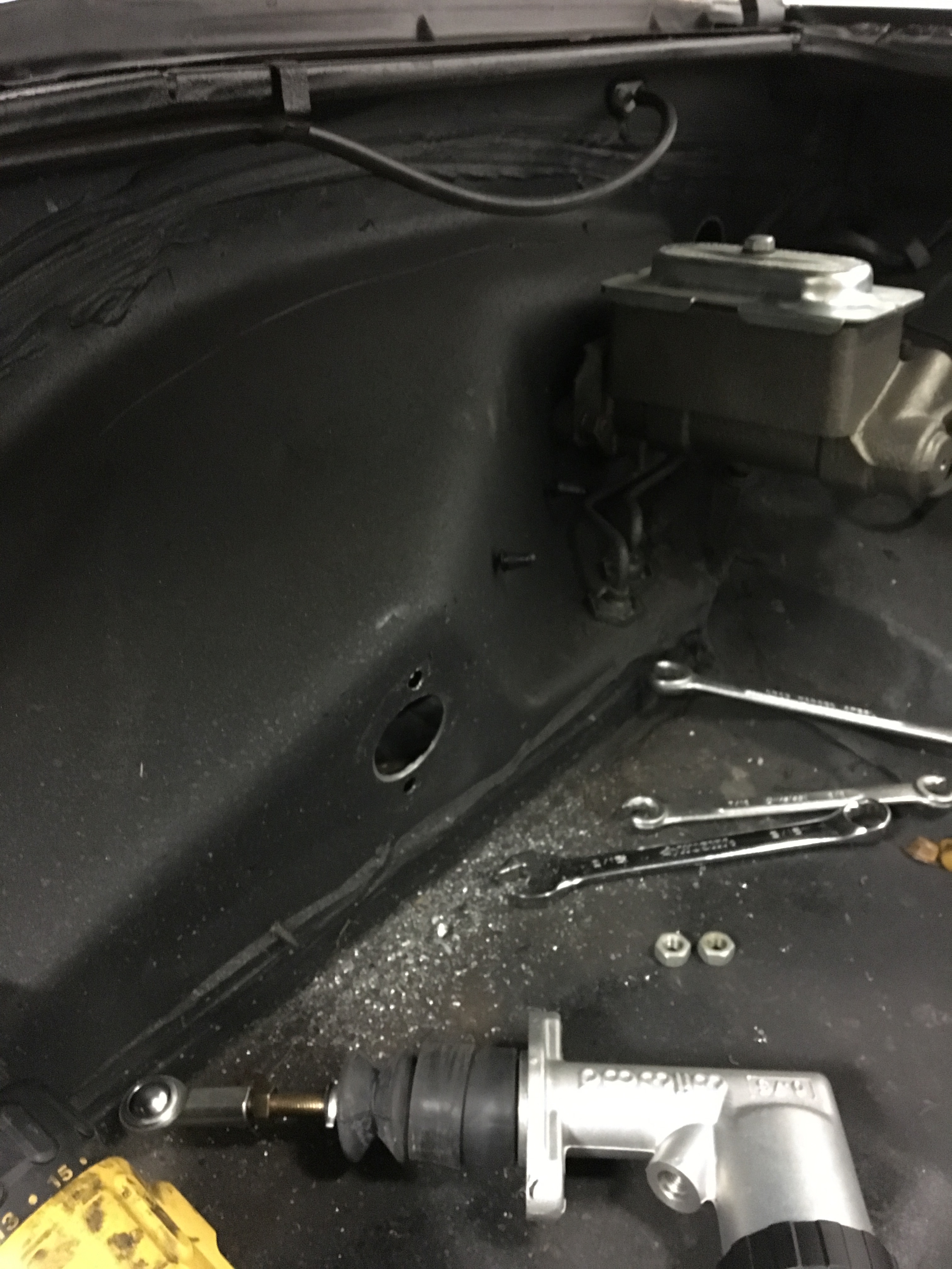

Saw a post on the corvaircenter forum of a guy that made a hydraulic clutch and I decided to go ahead and do that with a few modifications. Here's some progress from today. got all the parts I need so far for about $140.
Also I've been tracking the cost of this build and for everything so far including purchase price of both corvairs I'm at about $2300. Definitely the cheapest build I've done yet, and I honestly think one of the higher quality ones too.

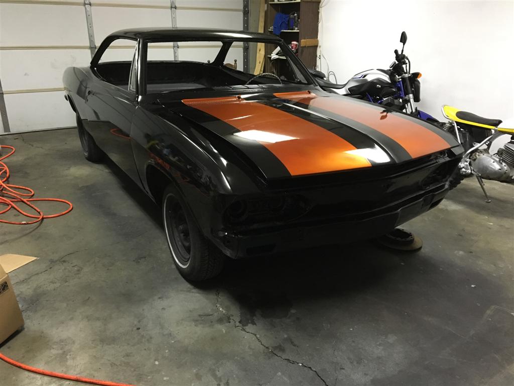

Post by God.favored »

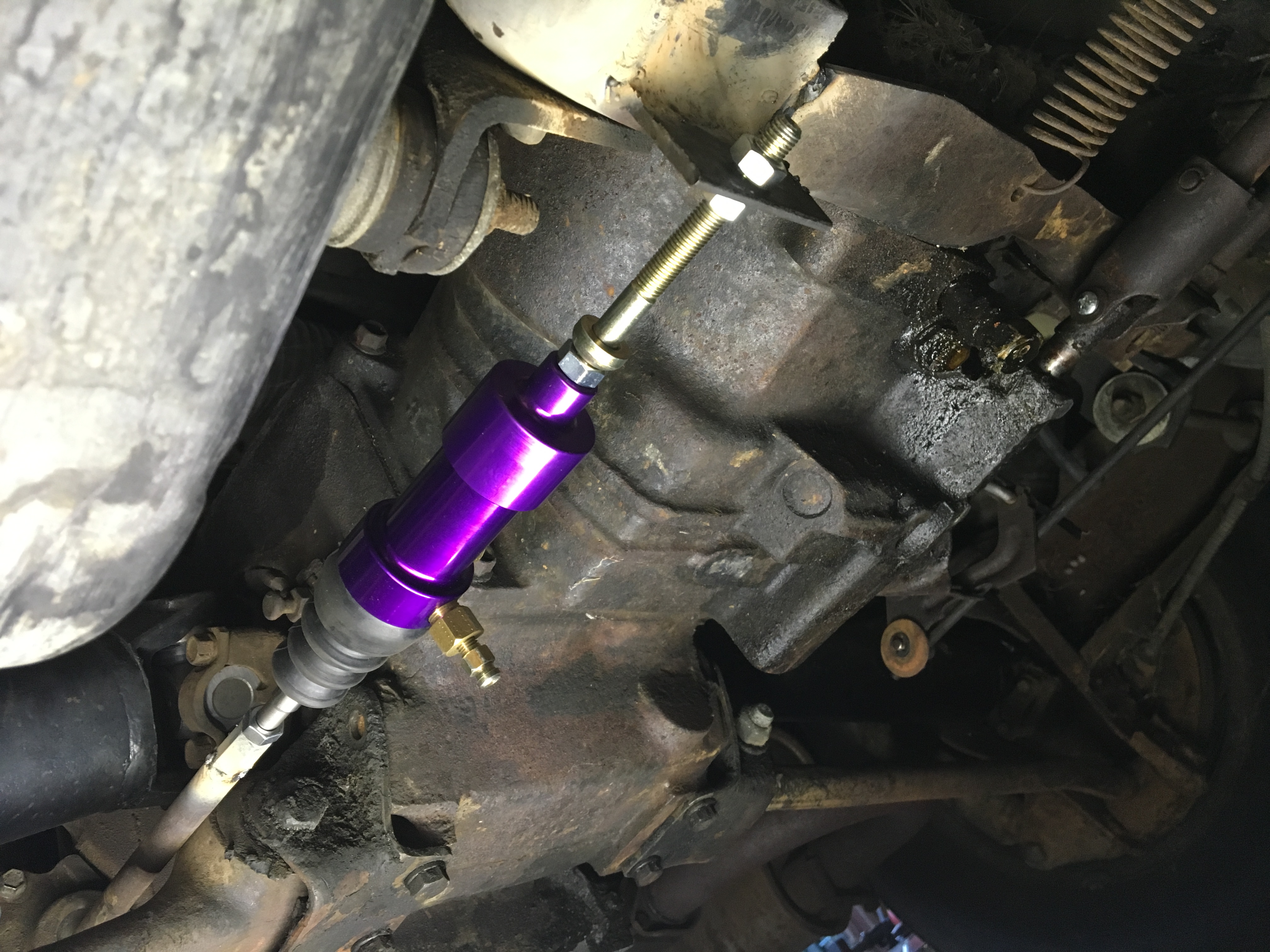

More progress, its been too hot to want to do much during the day. Just need to run the hose back now.
