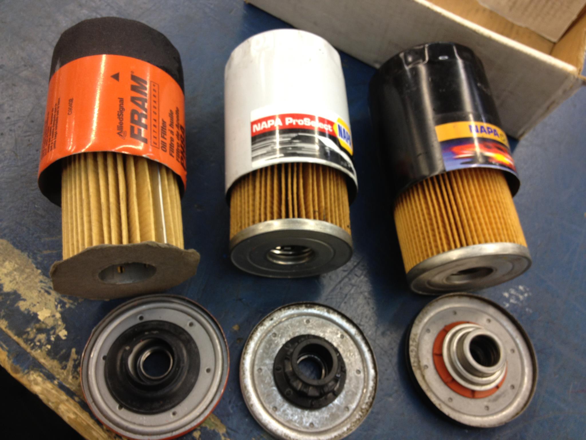

NAPA 1038 / WIX 51038 - WIX is the OE vendor for AC Delco labeled filters and it's also available as NAPA 1038. This is likely the best available filter unless you get an adapter to fit Donaldson. Avoid Fram.
Fram on left - much less filter material, cardboard end caps. NAPA/WIX Gold on right
