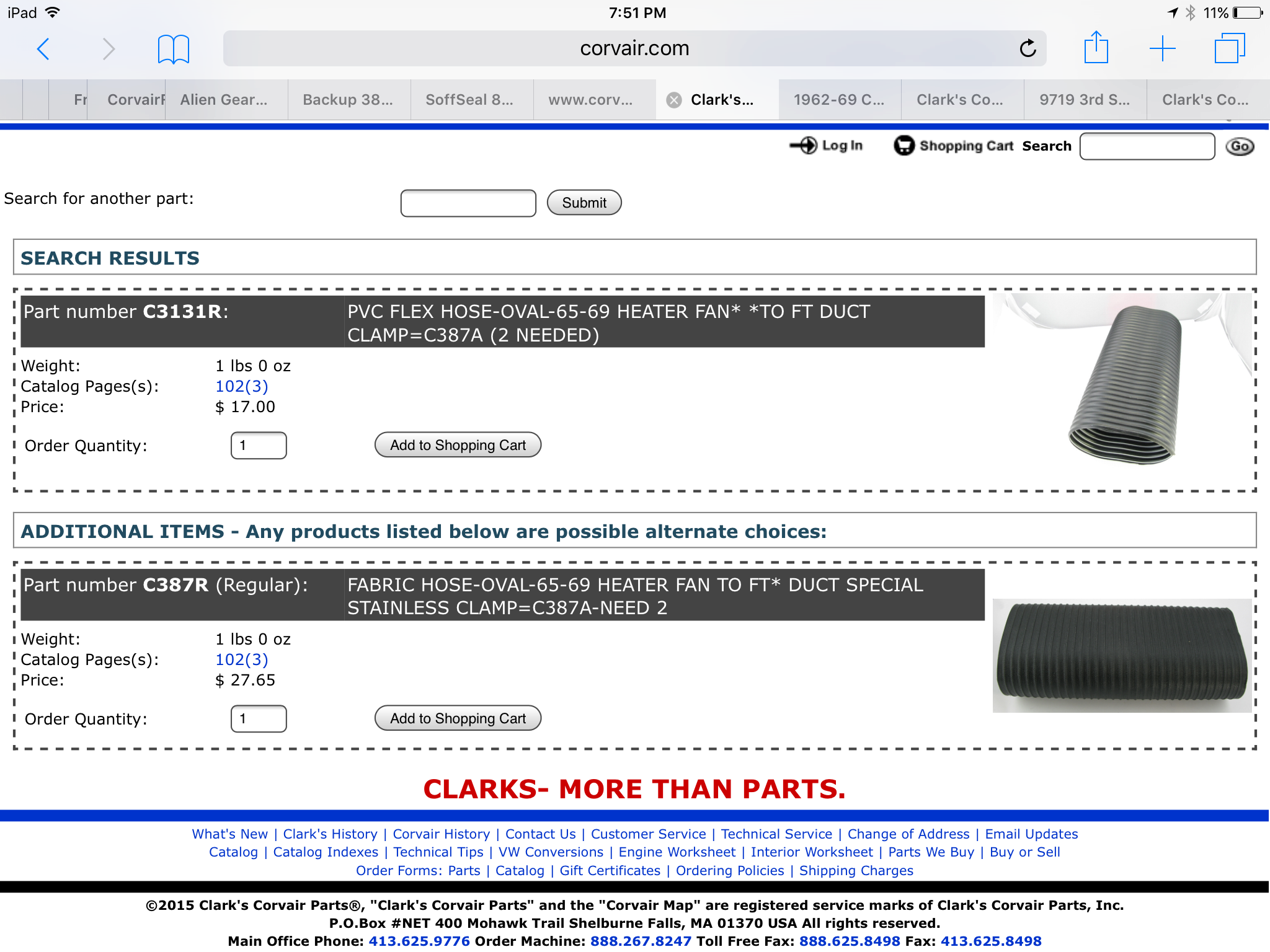

Just wondering if anyone out there has ordered/used the PVC version(pt#C3131R) of the oval heater hose from Clarks? I've seen the fabric version, in person, and it looks like good quality, but haven't seen the PVC version and sometimes it's hard to tell from a picture. It is about $10 cheaper, so if it is decent, I'm ok using that one. But I bought one from The Corvair Underground a few years back (they called it Super Silver) and it was TERRIBLE. Not even usable, had to throw it away. Don't want to make that mistake again by trying to save a few bucks.
Here's the 2 choices I'm talking about from the Clarks catalog.

Actually, I am not asking about the fresh air hose that Mark describes bypassing (for potential cylinder #5 issues, btw, I did had already done exactly as Mark described and installed a filter element)
I am referring to the hose that connects the fan box to the tunnel. ( item #3 - large oval hose, on the following page in Clarks catalog)

Clark's says the original style is preferred so that should be your choice.
