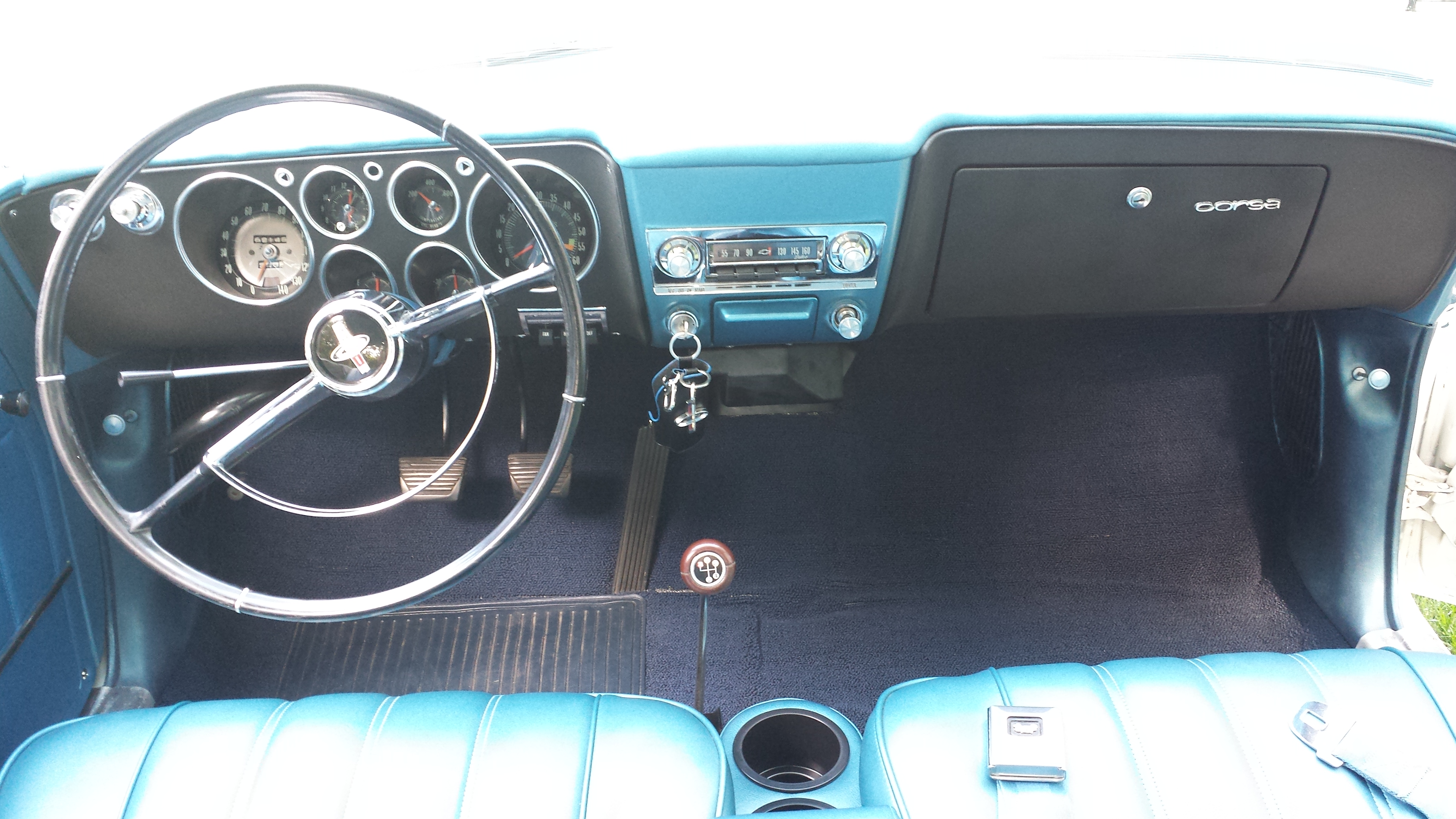

I have a bunch of updates, that I'll get posted Sunday - but, here is my completed dash - glove box door and surround done and installed.

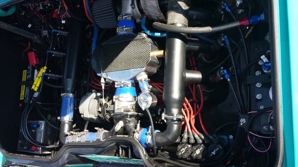

Sorry, haven't done an update on the project, been way too busy with the Woodward Dream Cruise last weekend and the Detroit Area Corvair Club Homecoming this weekend! Truely a great show, met a bunch of great people, picked up a few parts and looked over a bunch of great Corvairs...
Somehow, when I do something like these shows I don't pull out the camera much, a few cars were beyond the normal - so I got snaps of those... This first one is a 65 Corsa that is as sharp as they come... This car must have as many hours being block sanded as I have in my project overall! It also has a 140 set up with Blow-through Turbo! Unbelievable!
CorvairWild on YouTube managed to record a ride in this vehicle at the following link, and, at ~2:40 into this video, that is me heading out Saturday evening!
If you want to seem more of the DACC show, look at CorvairWilds other videos, which include a showing of fellow forum member rv6aaviator (Jeff Sandor) with his two beautiful EMs and Norm Witte with his Corsa Turbo Vert.

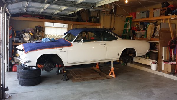

Fortunately the Corsa is in the garage, in the air with blankets on…
And I got some work done, the rear suspension removed and beginning to make parts lists.
I'm kinda surprised at the prices to have the rear bearings and strut rods rebuilt. >$700 after cores but without shipping?!? I will be looking at the options to reduce this. Suggestions? Are rebuilding the strut rods with rubber really that difficult? Any thoughts about the Clark's C7874 "Easy" Strut Rod Bushings? How much of a compromise is that?
I'm going back to stock exhaust, carbs and tins on the engine - need to remove it to address the input shaft seal anyway and would like better dirveability and more quiet for next summer. I could keep futzing with these Dellortos, but for what I can sell them and the headers for, I should be able to buy most of what I need to return to stock...
Headers already sold for $200. Going to pull the Dells of this weekend, get some good photos and get them listed. The BEST use of these are on VWs - any suggestions where I should go to list? I really believe these come to life on an individual runner application, not on a plenum application like the Corvair.

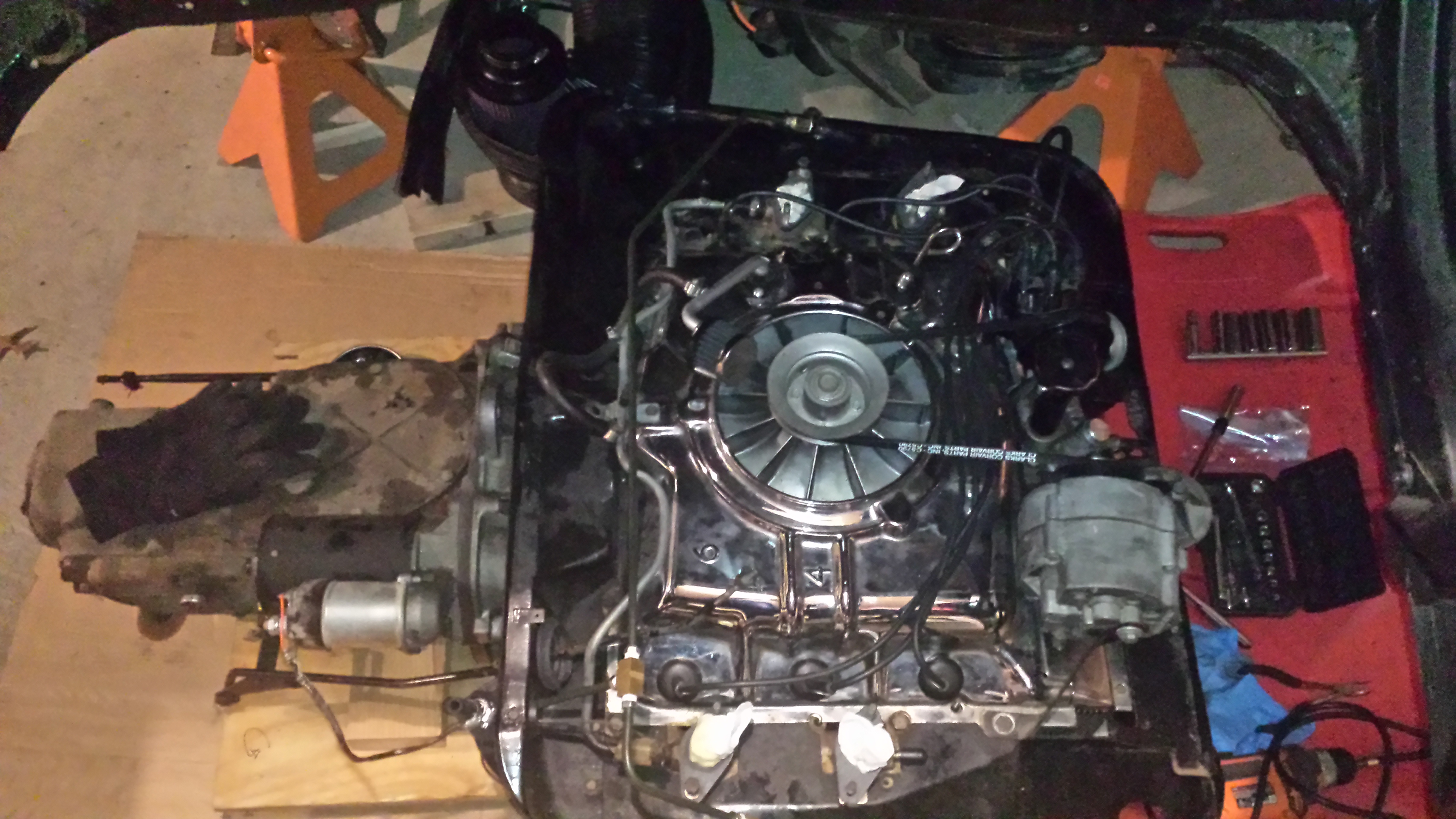

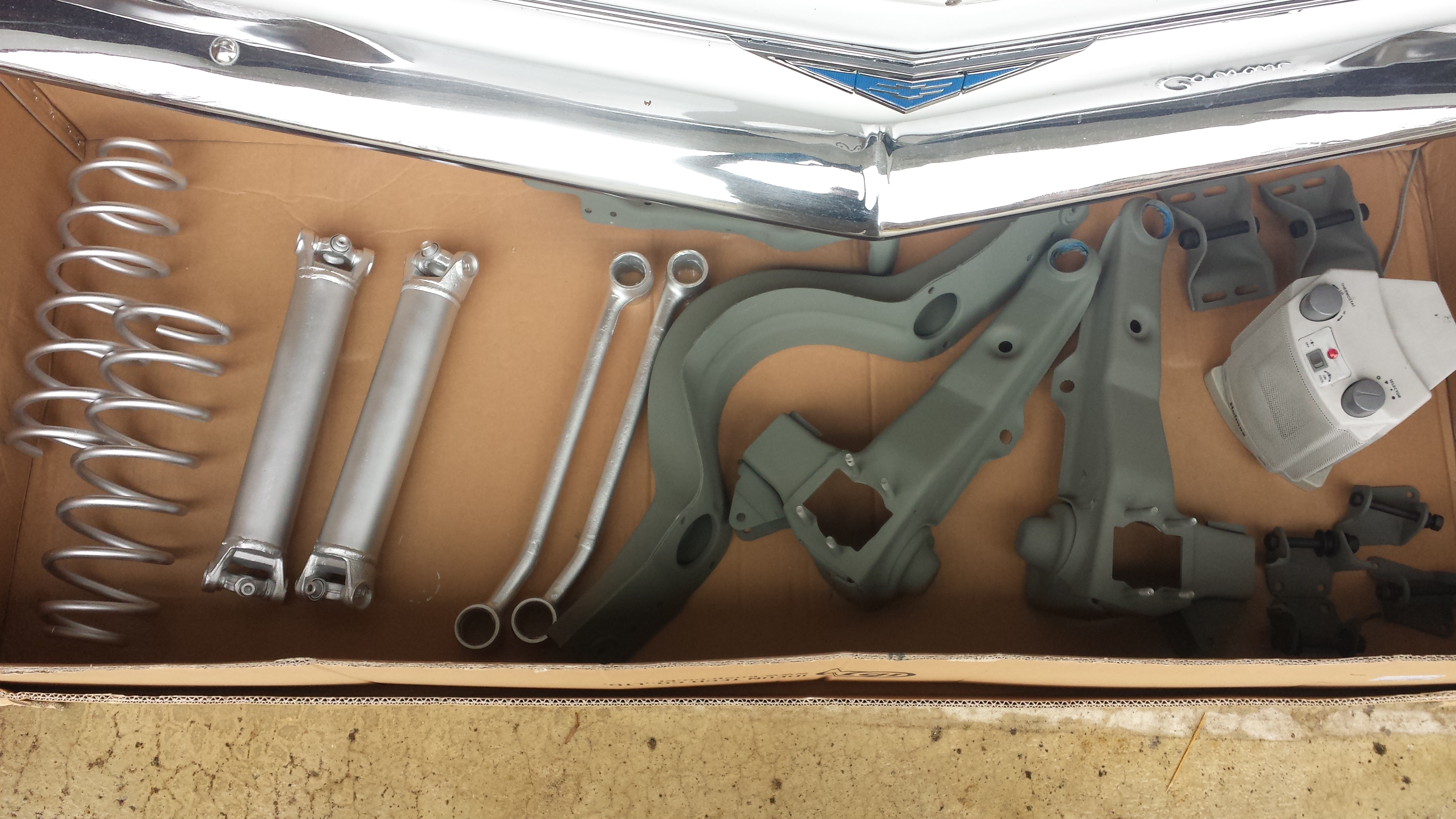

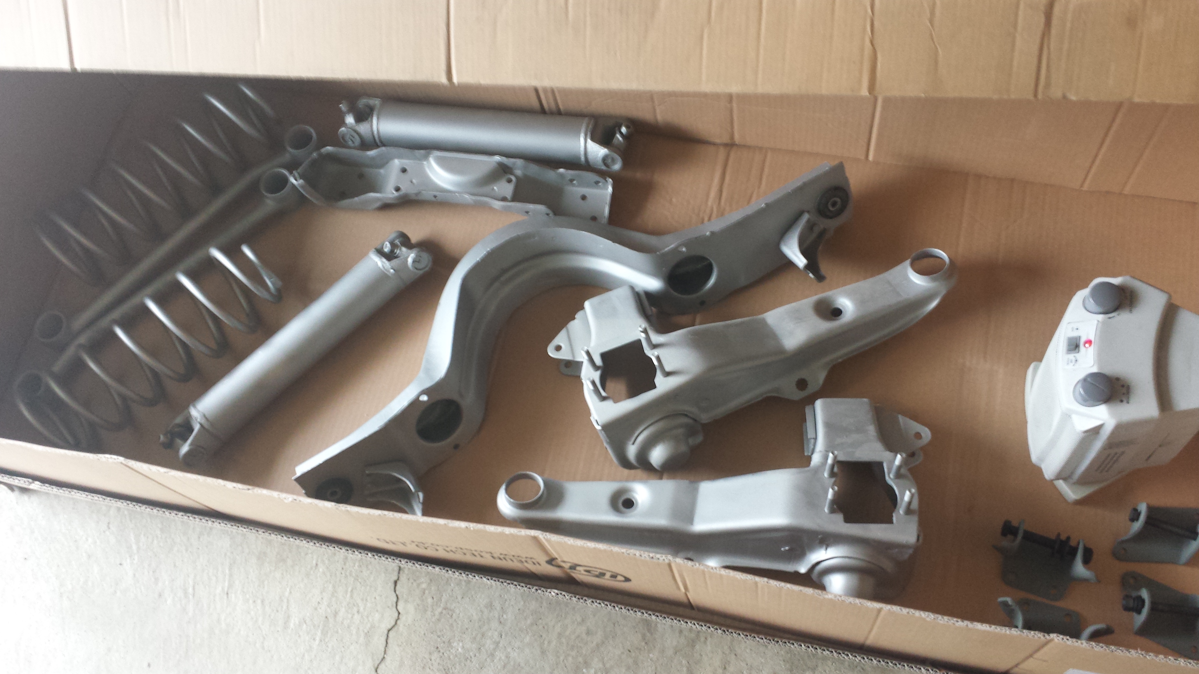

Well I’ve been busier on the car than I have been on the web… On the Saturday after thanksgiving ‘Caveman’ Pete Koehler came by to oversee the removal of the powertrain. Everything was ready for the drop – just had to place the jack at the ‘sweet spot’, loosen the 2 rear motor mount nuts and the 4 bolts from the trans to the cross support. Took less than 20 minutes – having Pete’s experience guiding this, my first removal, was a great confidence builder.
Was expecting some warm weather in December, so I took the Torque Arms, Struts and pressed the old bushings out – then took to have them blasted… Got them home and primed and painted all of the following suspension bits..
It feels good to put clean, freshly painted parts in the basement, ready for reassembly!

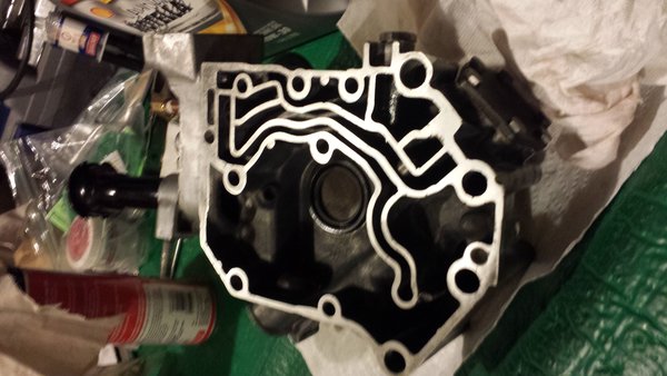

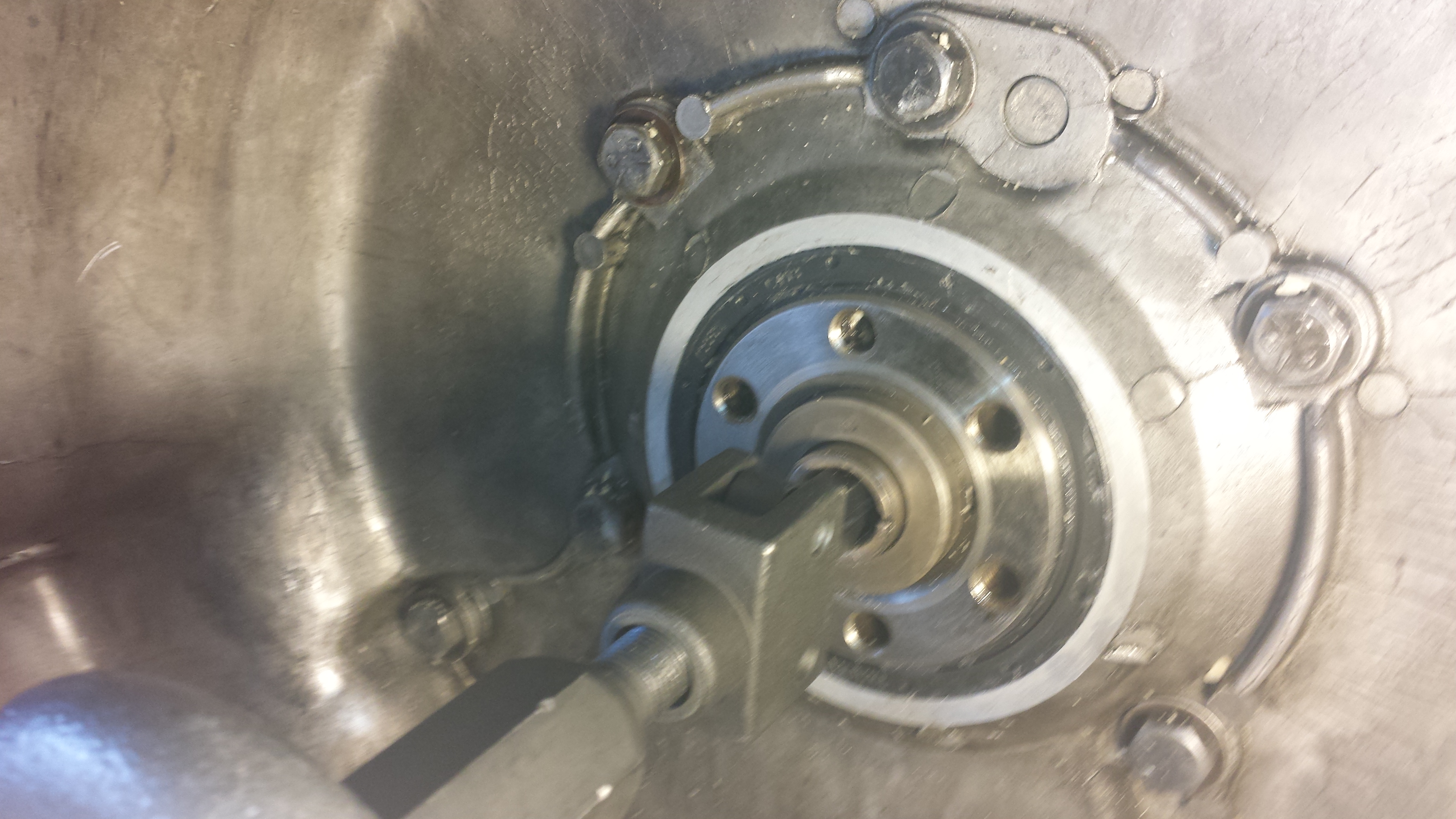

Today I pulled the trans side cover and diff top cover and pulled as much lube as I could out of each. Looks relatively good in there – what do you think?
Then I set up to remove the transmission from the engine.
Well, I think I know some of the reason for the input shaft leak – the good news, the snout is not broken… But there is no sign of a split ring retainer for the seal, and the seal ‘fell’ out with the input shaft…
I have some questions about the ID of the bearing support – posted another thread on that (here--> viewtopic.php?f=55&t=10923#p74814).
I also found the clutch fork not installed to the throw-out bearing uniformly – which is correct?

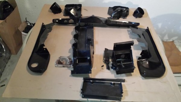

I also managed to clean up all the shrouds – nearly ready to reinstall.

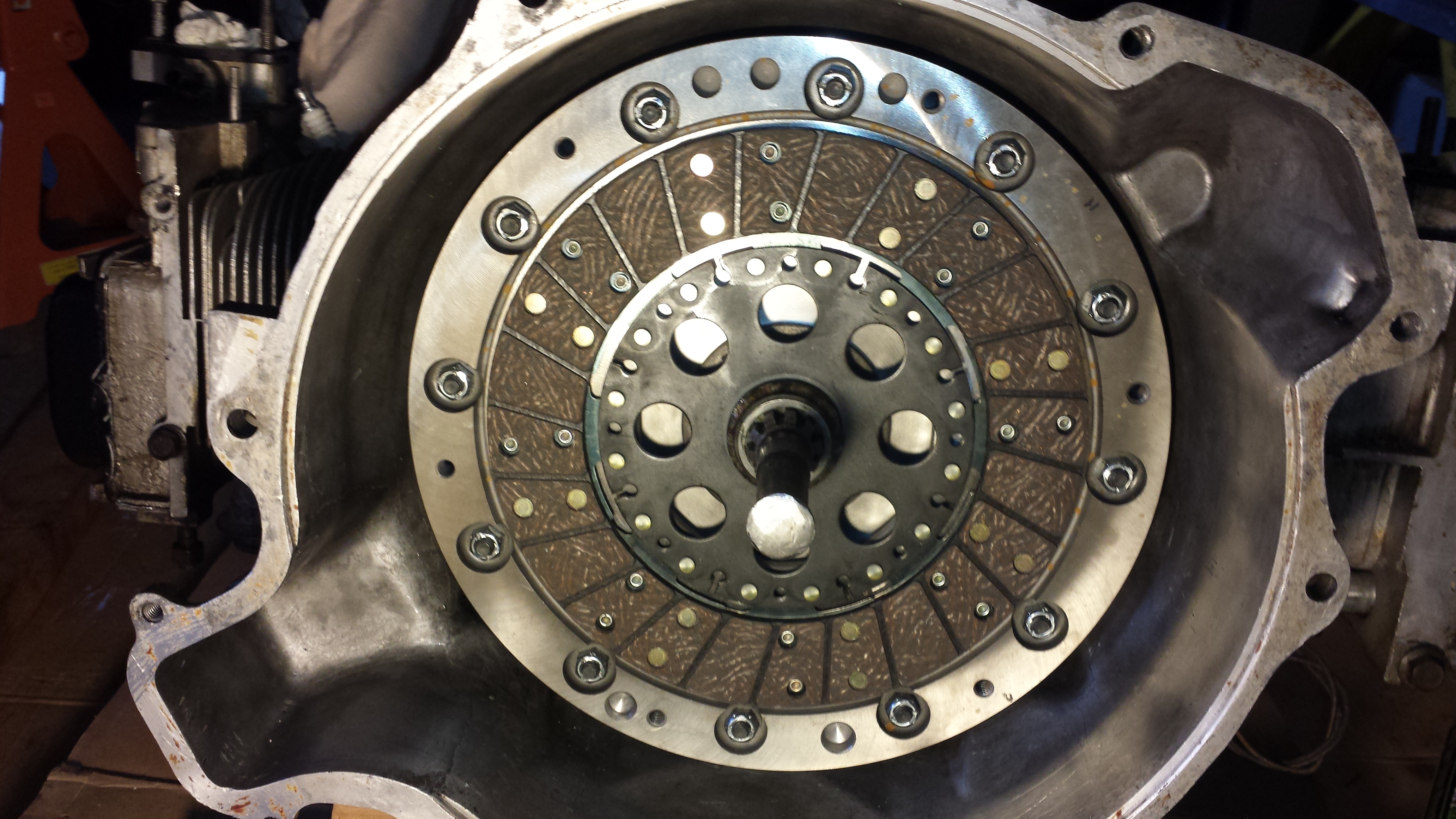

This weekend was relatively productive!

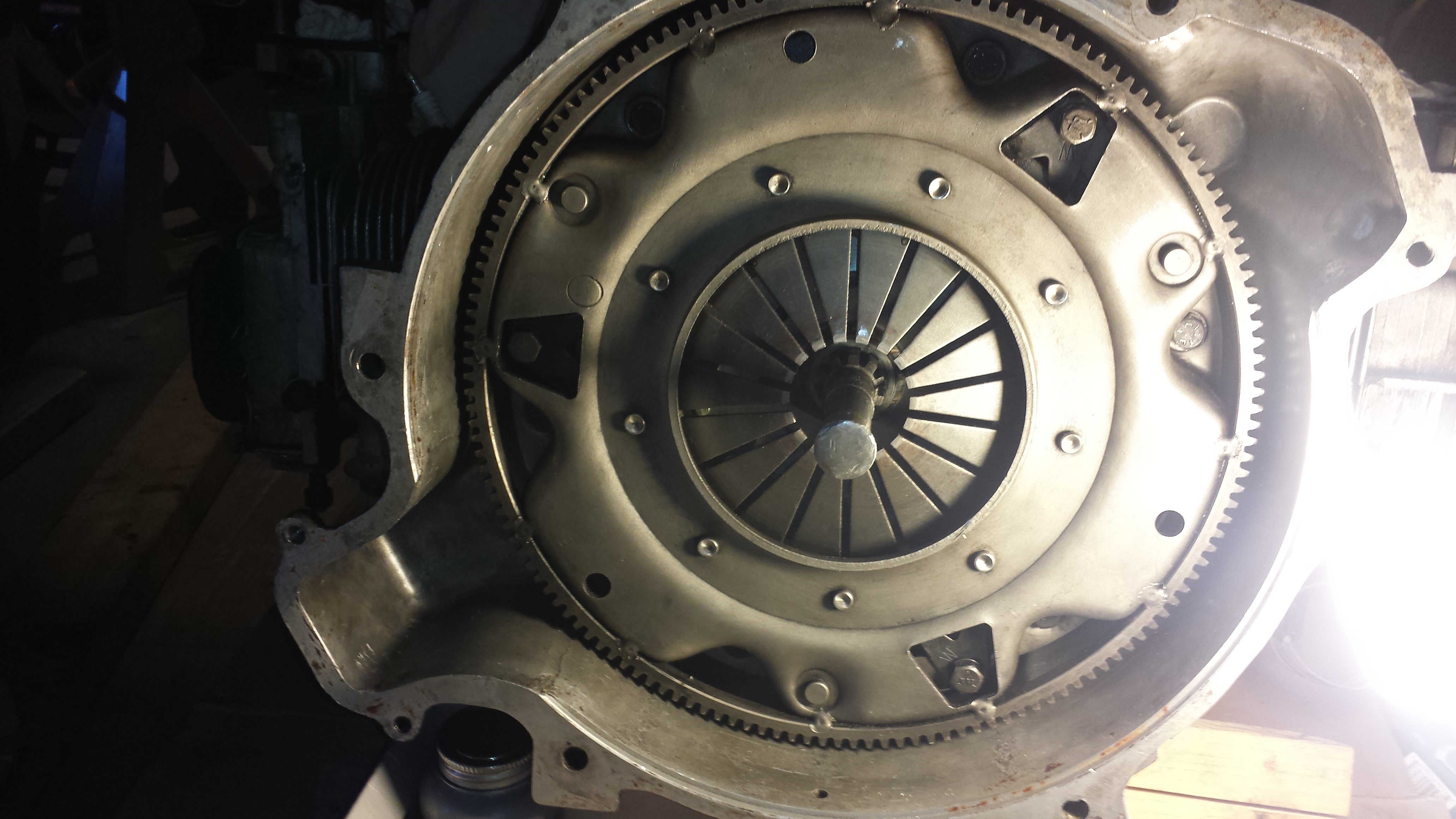

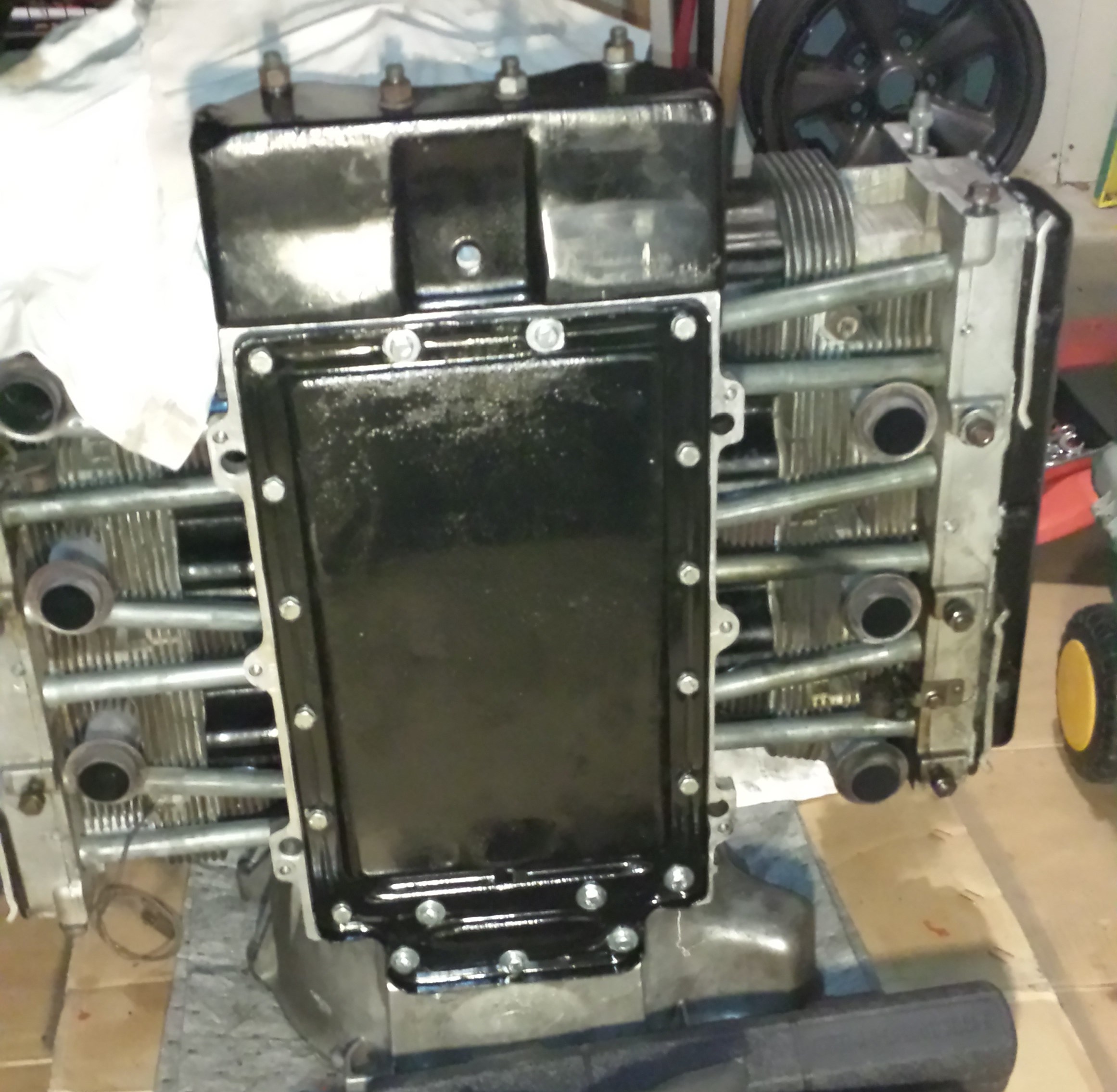

I wanted to finish closing up the engine, first order of business was to replace the Pilot Bearing. I tried the bread thing, with no success… Then went to O’Reilly’s and checked out their “loaner tools” and found they had a nice pilot bearing puller attachment to their slide hammer. This a great service for us DIYers..
Mounted up the new bolted flywheel, and clutch disk – added the pressure plate and done… I was advised to NOT use washers on any of the 4 lower bolts from the clutch housing to the block – due to possible contact to the riveted or bolted flywheel…
Next I cleaned up and painted the pan and the new harmonic balancer… Pan installed and balancer yet to do… Then can do Logs, Fan and Tins... Getting closer to trans clean-up...
As always, more to come...

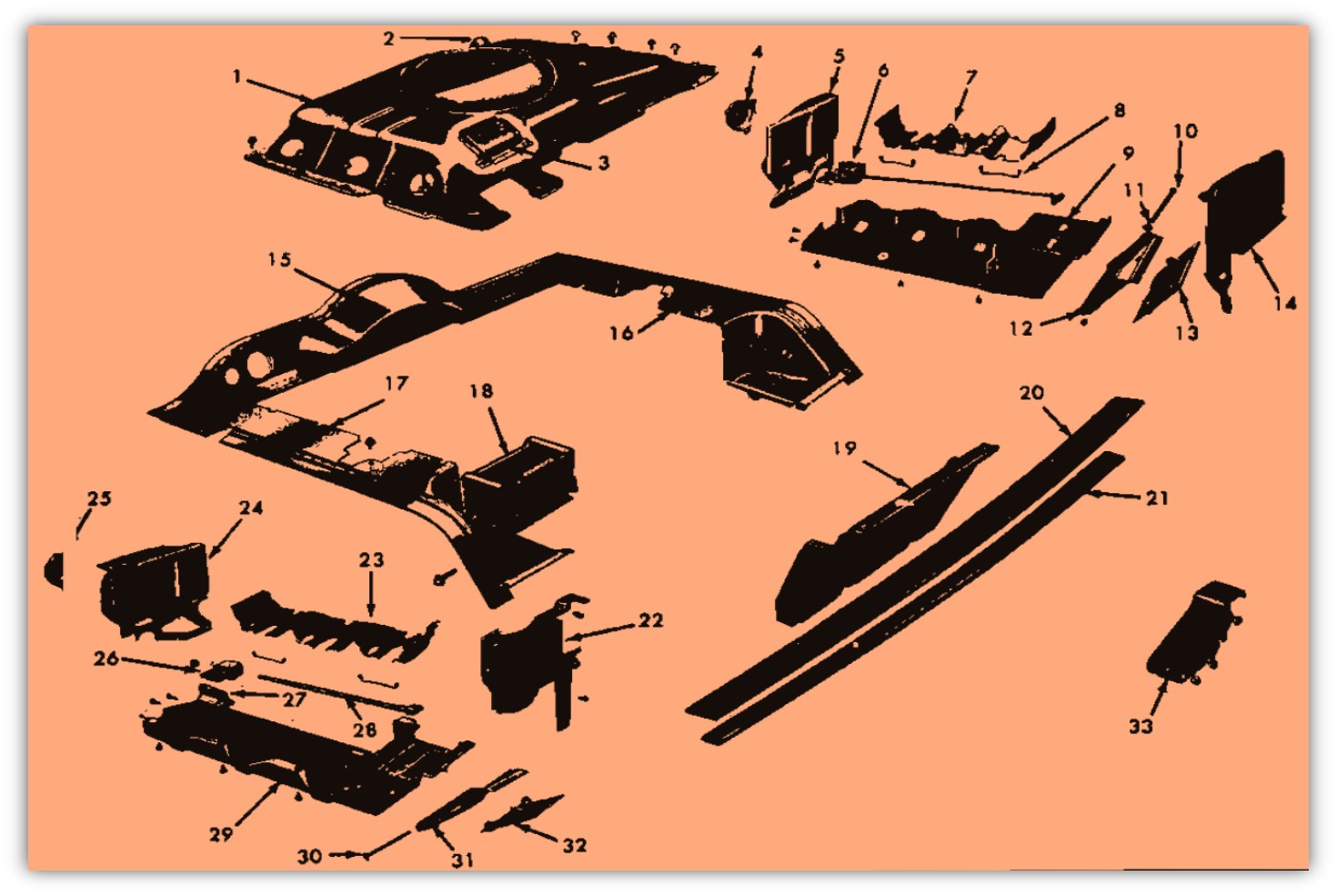

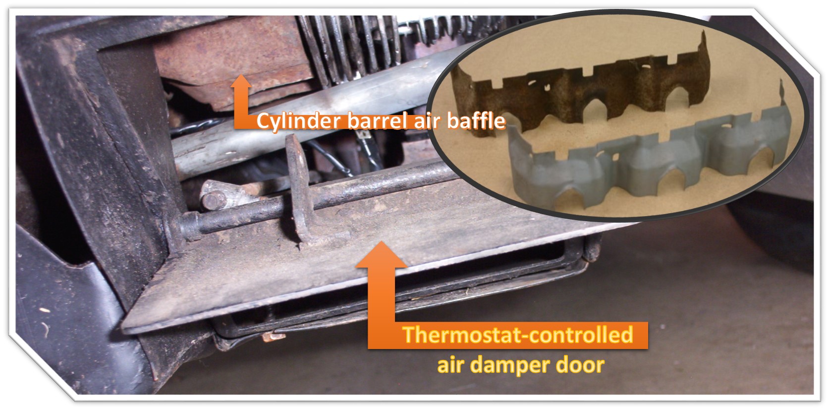

The sheet metal baffles are each held in-place by two metal spring clips (shown below)...
Each baffle is positioned between the three cylinder barrels and the six push rod tubes, so removal and installation requires the removal of the push rods and push rod tubes. See items 7, 8 and 23, below...
How important are Cylinder Air Baffles?
