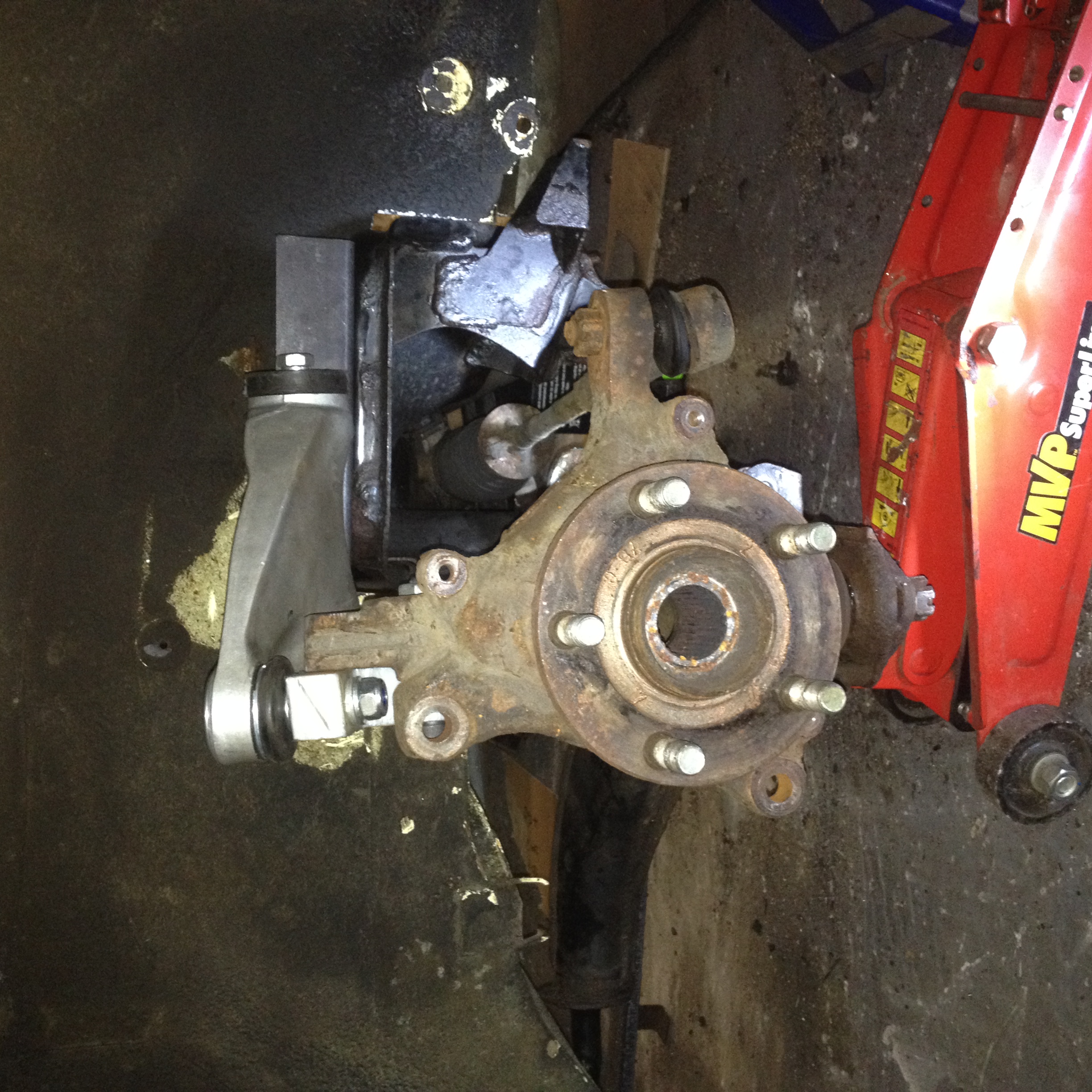

Got the front RHD suspension mocked up, and looks to be viable :)
Got a few more tweeks to do with the geometry, but not a bad starting point!

Front suspension tweeked & coilover mounting mocked up.
In my defence, the brackets you see here are knocked up out of scrap; to hold the components in the correct alignment with each other. Once I am happy, I will remake everything properly :)

Just in case anyone was wondering....
This front suspension design uses:
WRX knuckle, w/modified mounting
WRX hub, bearing, calliper, steering rack, crossmember, ARB, lower wishbone and bottom balljoint
Top wishbone and brackets are a work in progress ;)
AVO Coilover operating at 2/3 LCA length
Geometry:
KPI - 5 degrees
Scrub - 20mm on WRX wheels
Castor - 7 degrees
AntiDive - Aprox 30%, depending on final weight distribution
Turning Circle - Similar to WRX?
Seems to have a little toe-out under compression, but will have to wait until front suspension fully anchored, before I can measure this on the alignment gauge...
